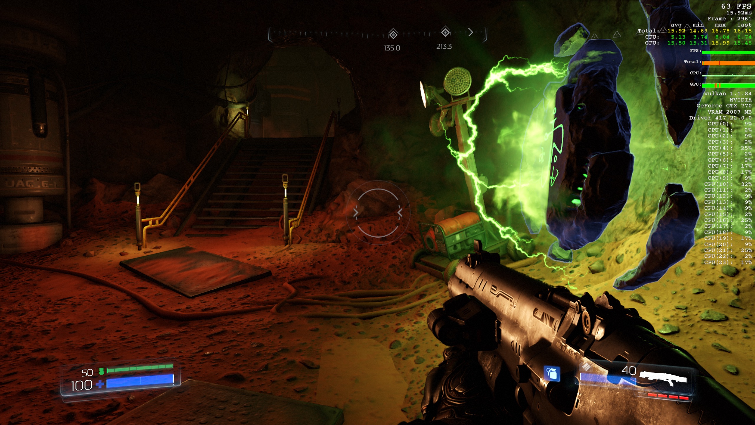

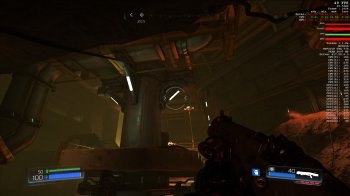

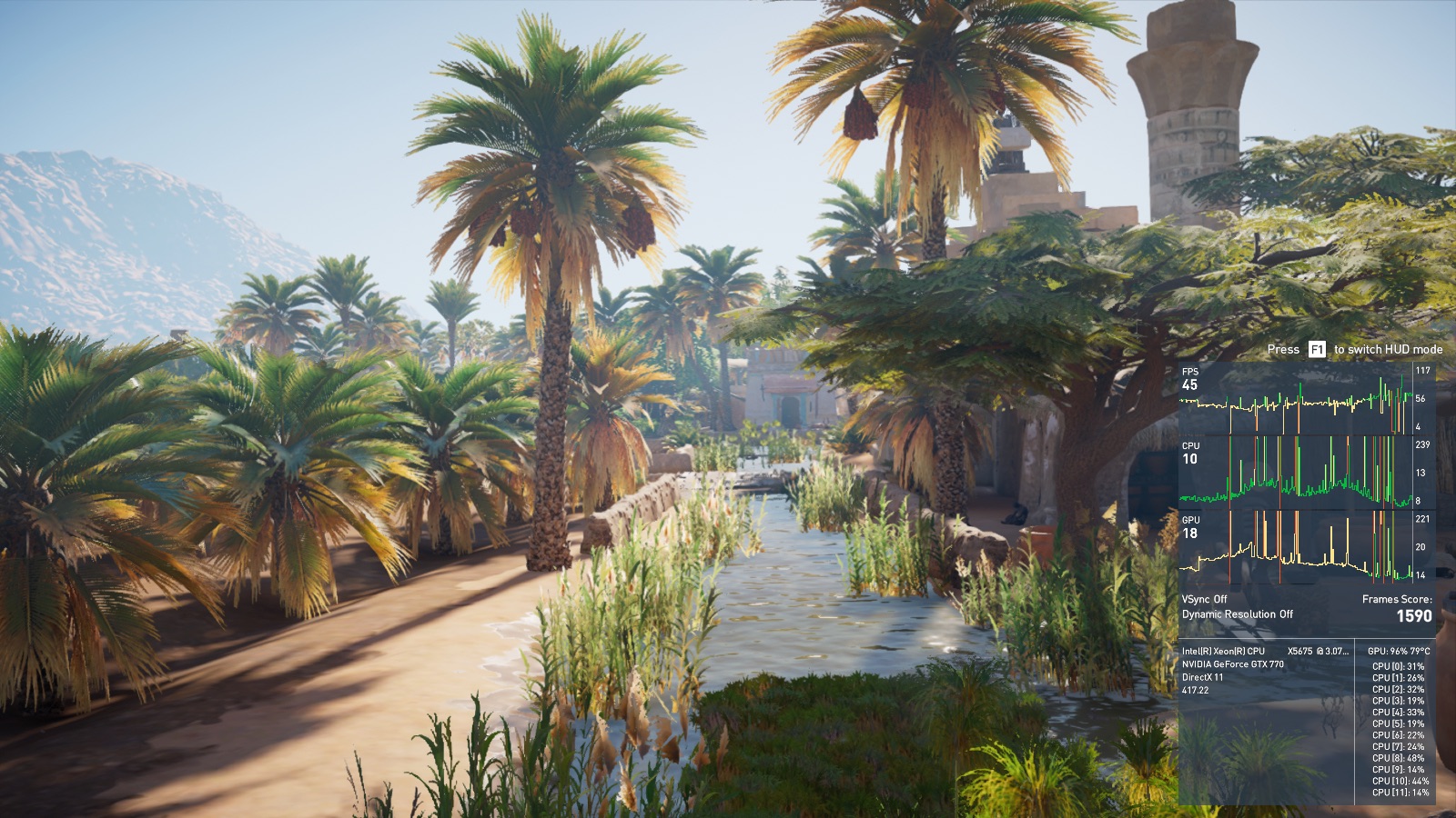

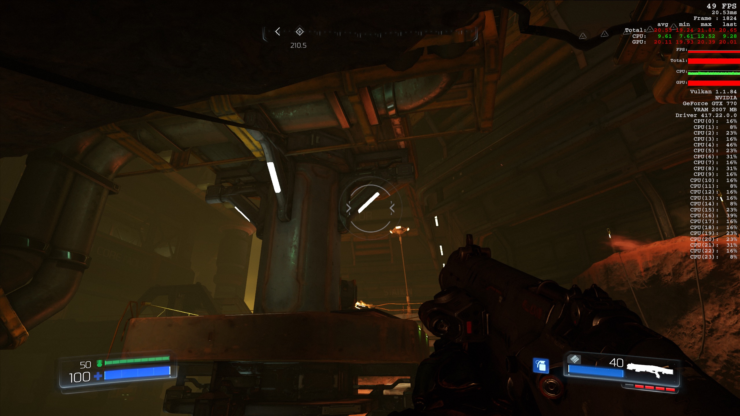

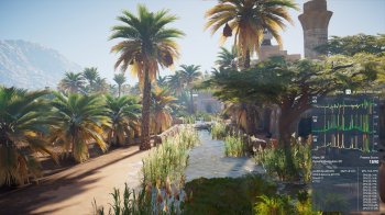

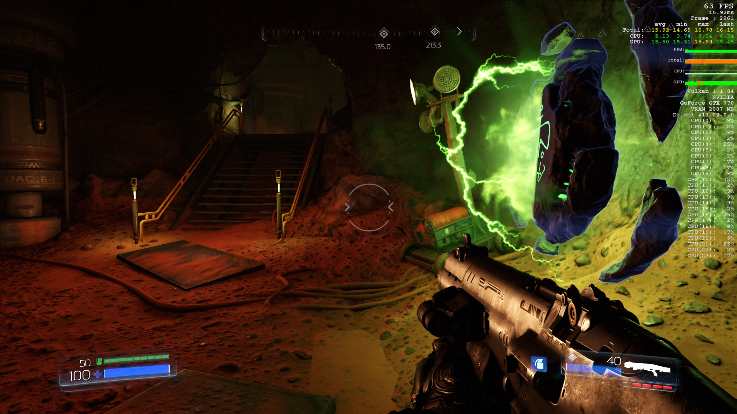

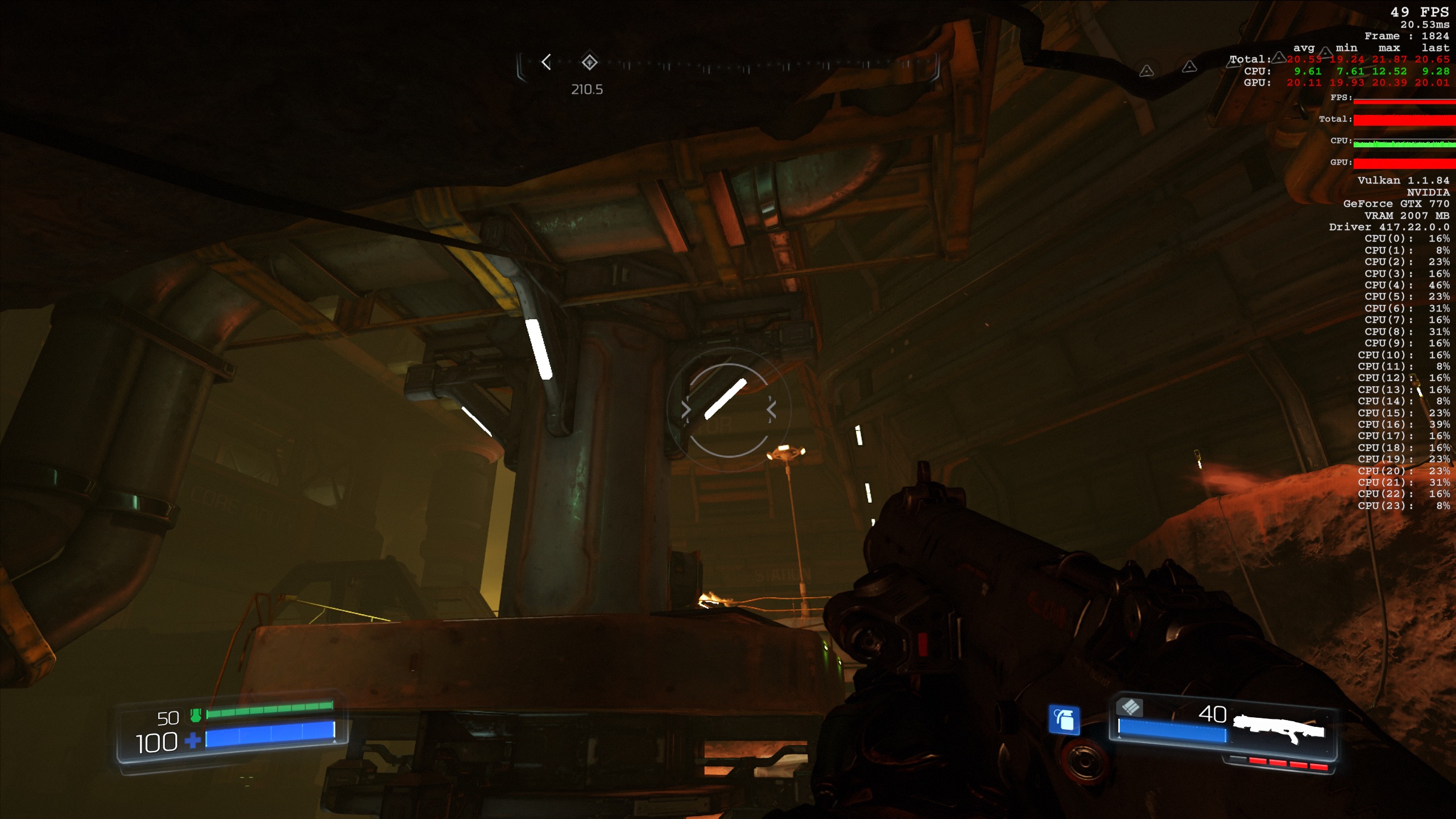

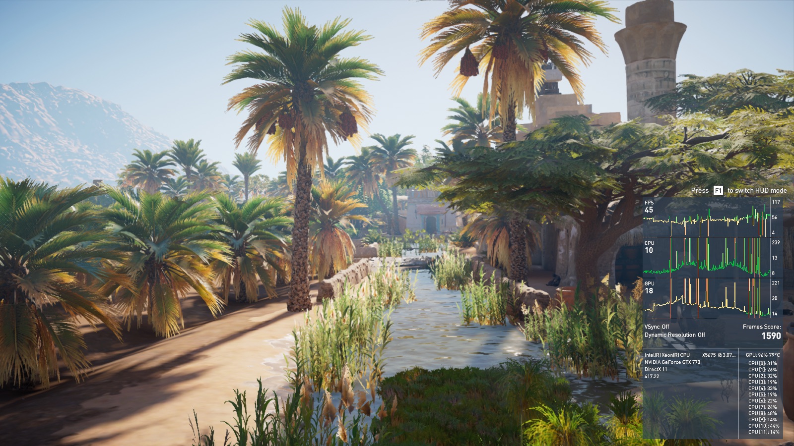

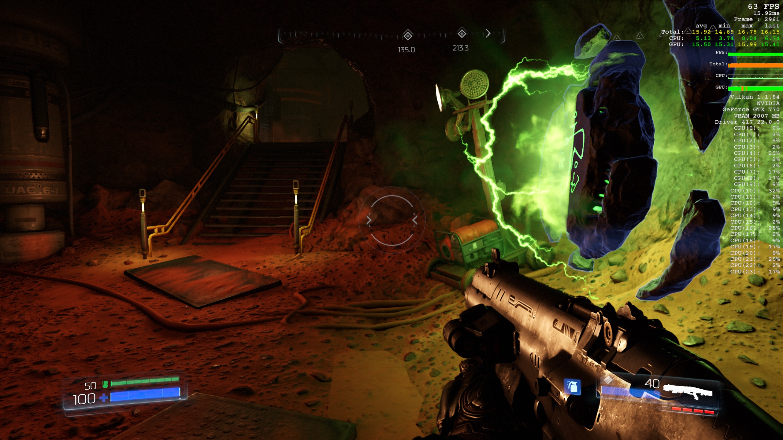

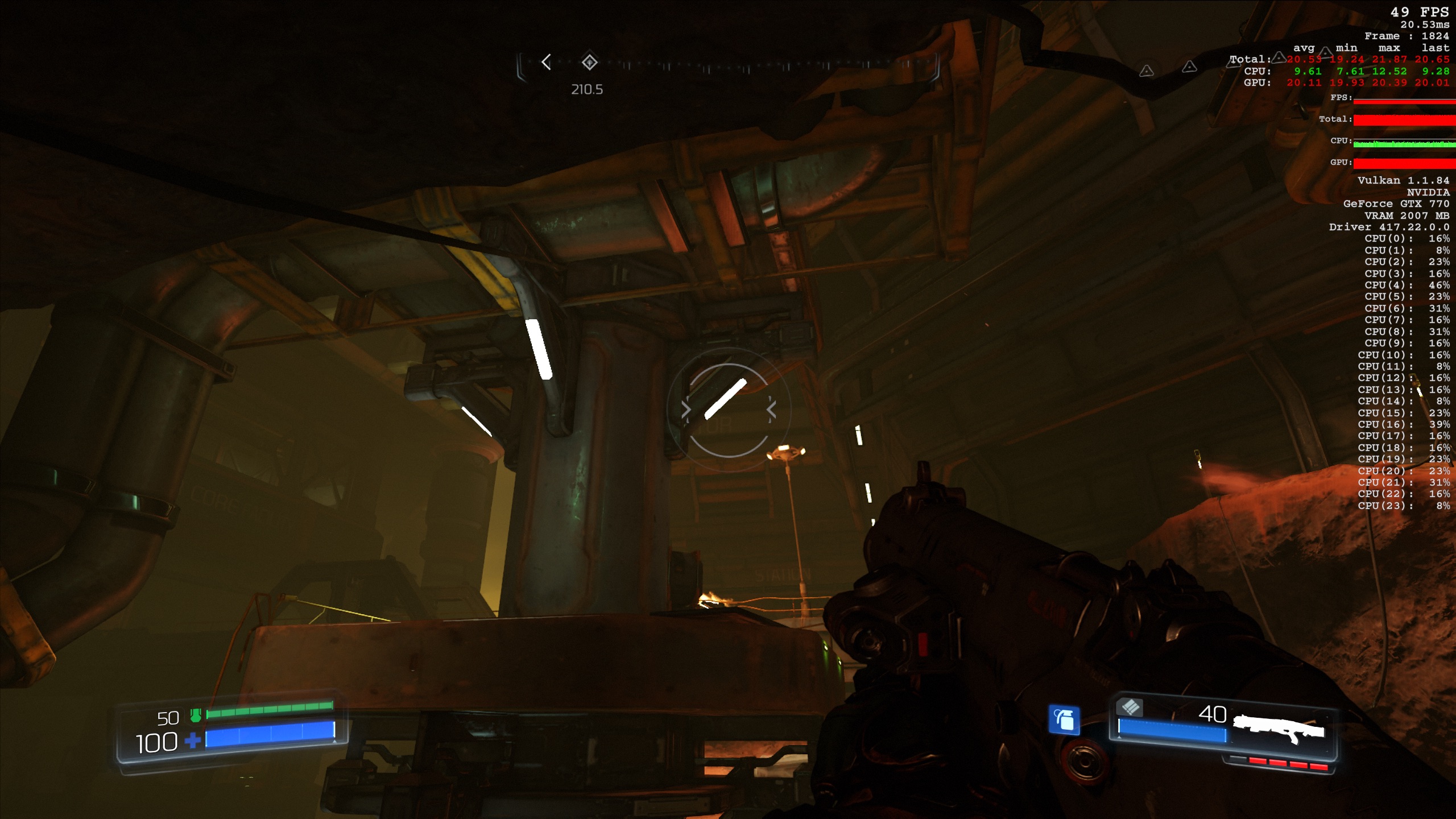

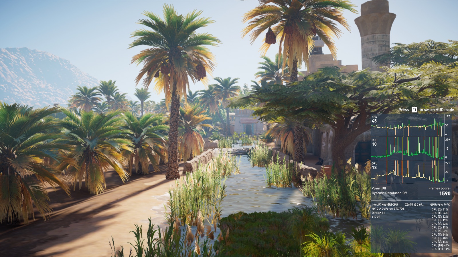

Additionally, when this tech came out everyone in the gaming community was dogging on multi-cores not being utilized, but most modern games recognize all 12 cores and some even hyperthreading at 24. I've never experienced a bottleneck beyond a hiccup yet, but I'm limited by my card- it isn't anywhere near 1080Ti or 2080.
I try a lot of games, but only play a couple long-term. I have never seen a game utilize 12 cores, much less 24. Please provide examples.
Reactions: h9826790
Doom (2016) is the most recent that I've played, and only recently noticed it recognized 24. I'll grab a screenshot-you have to set the stats setting to ultimate to see it though. It cycles the load on the cores pretty fast.
The Hitman reboot recognized 12 but wasn't hyperthreading natively.
EDIT: Uploaded Doom (2016) screenshots taken at 1440p Low settings Vulkan API rendered at 90% both high and low loads-as well as Assassin's Creed Origins benchmarking at 900p High settings DX11 at 100%.
Wasn't Hitman, AC Origins was what I was thinking.

Doom (2016 )is the most recent that I've played, and only recently noticed it recognized 24. I'll grab a screenshot-you have to set the stats setting to ultimate to see it though. It cycles the load on the cores pretty fast.
Sounds like you misinterpret the CPU loading.
Even single thread apps loading can cycle across CPU cores, and switching fast. That's the CPU's load balancing, nothing about multi thread.
So far, I never see a game can really use more than 6 cores (consistent 600% CPU usage or more during game play).
See prior post-for uploaded screenshots. It's always entirely possible-I'm human after all. LOL. I was referring to load cycling though, just in the sense of transitioning between low-high load scenarios.
If any processor is hitting max percentage, then its bottlenecking at the core-then your latency is going to go south fast. I've never seen 2400% in Windows-maybe 1600%. I don't really monitor macOS since I'm limited by the OS rather than hardware in most cases-except my current GPU. Which is why the idea of a RTX over a RX/Vega is such an exciting prospect if we could ever get some support from the manufacturers. Hopefully, as many have speculated in the thread, this didn't happen by accident, and I look forward to the day I can see a RTX and boot screen in my 5,1. LOL. Even if there is bottlenecking at the PCIE and you can truly never reach full load, your GPU will run under less high load stress- and less likely to need a power mod since a 2080 is already pushing 215w TDP.
