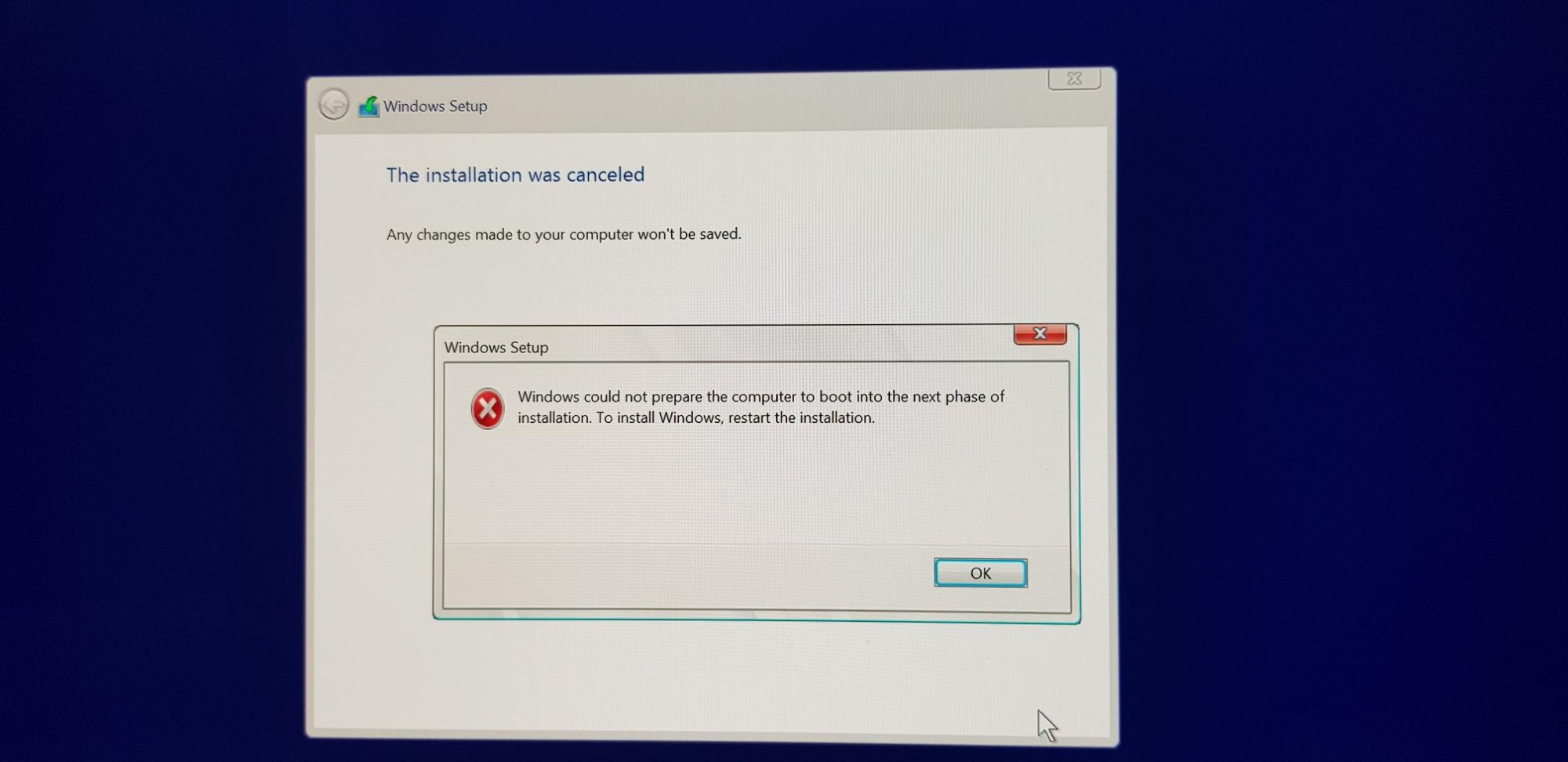

Hi i've tried so many different ways to get windows 11 installed and this is the closest so far. Any idea how sort this out.

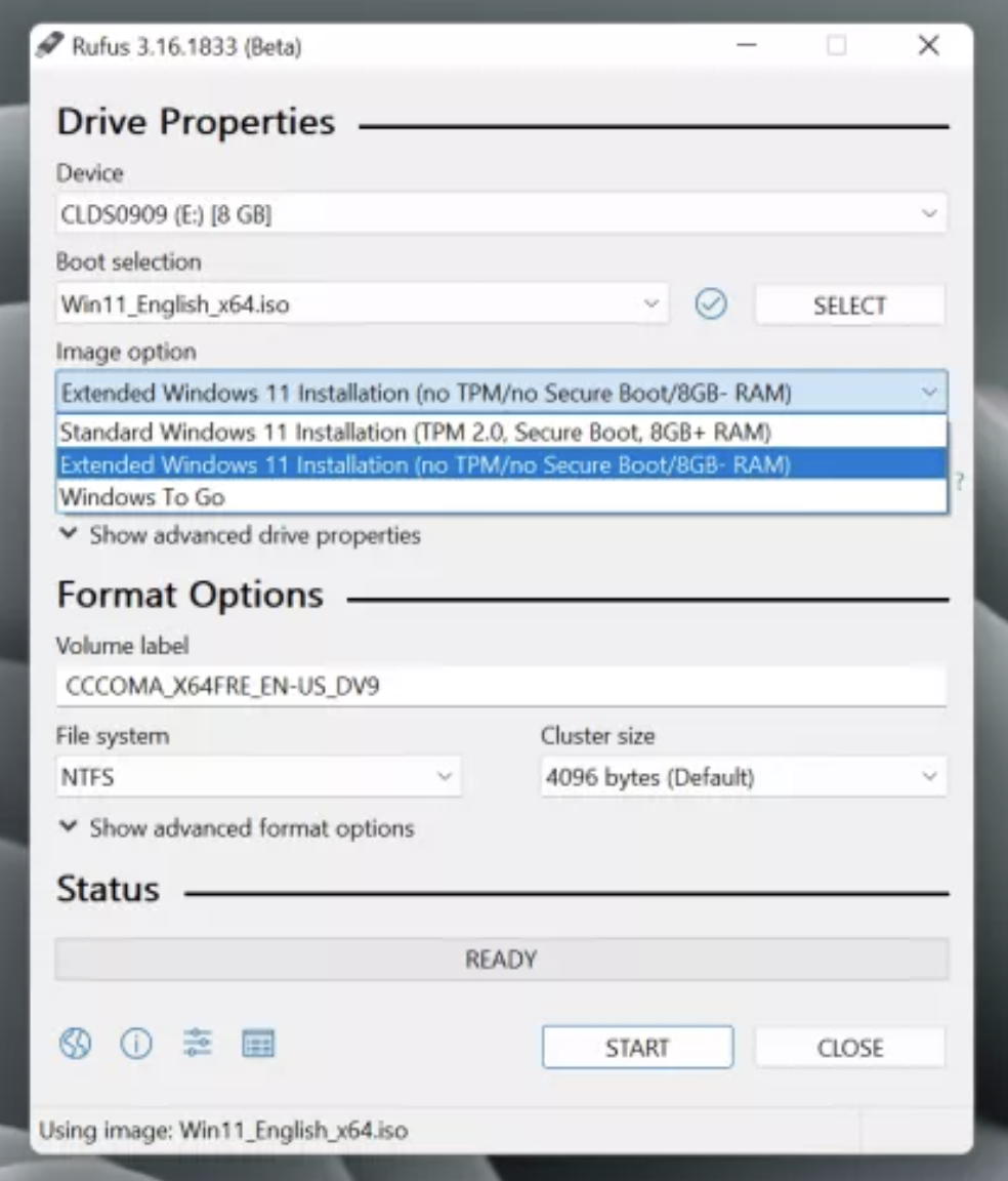

FRESH INSTALL -
My Steps where as follows
  • Download Windows 11 ISo and Bootcamp support drivers (the later via bootcamp util)
  • On a Windows Machine (baremetal or VM) download Rufus
  • Burn the ISO to USB with Rufus and copy accross the Windows support tools downloaded in step 1
The new version of Rufus has a new feature added thats easy to miss, when you drag the windows ISO to the Rufus window, there is an option to do a standard install or an EXTENDED Install. This Extended install removes all TPM / Ram/ Secure Boot checks and then burns to USB
  • Create a exfat partition and name it something memorable (Windows wants 75gb recommended for 11, i set up with 50GB
  • Reboot machine (holding option) with the usb stick inserted AND a MOUSE
  • Select Efi Boot for Windows install option
  • When you get to Custom or upgrade select custom
  • Delete the parttion you created earlier and select the unallocated space to install Windows (in my case it warned its below recommended size but worked fine)
  • Install Windows as Normal
Now after a few reboots Windows 11 Setup screens starts but the Keyboard and Trackpad are unresponsive,hence the USB Mouse. I used this and onscreen keyboard to get to desktop
Once in the desktop, open the Windows support drivers and click Setup, now all the devices will work and you can reboot

Hi i followed your instructions but i get an error at the stage where it is updating (Windows could not prepare the computer to boot into the next phase of installation. To install Windows , restart the installation), which i had before. Anyway to by pass it. I have disconnected from the internet and this made no difference.
My instructions where for a fresh install where you trying to upgrade an existing? if so see Fsampei link, if you have a usb already created he has a tool lower down the page that just does a quick fix to an existing usb iso image
At which point, i never faced this issue myself, it does a small update (not sure it actuall does as no drivers loaded) after it's copied the files from install to partition and before first reboot.
Should be noted i always complete Windows with offline account (what they stupidly call limited account) which would be needed as the wifi drivers unlikely to be loaded at that point
Did you use Rufus to create the usb drive (with extended and UEFI Boot defaults not csm, unless it's a really old non uefi mbp if they even exist)
yeah i was reading up on that yesterday as that was my plan of action until i saw the entry in rufus whilst burning the image so tried that first. He also has one lower down the page that converts an already created windows 11 usb which i think is doing the same as rufus, i.e switching out to a server flag which then bypasses the tpm requirements without having to redownload

Hi mine was a fresh install and i followed exactly what you laid out, only difference was the size of the partition. And with Rufus it was same as the instructions you provided.
I just nuked my install and recorded the following to see if i could get the same error, wonder if the latest ISO has a different check? Mine was Downloaded 3 weeks ago

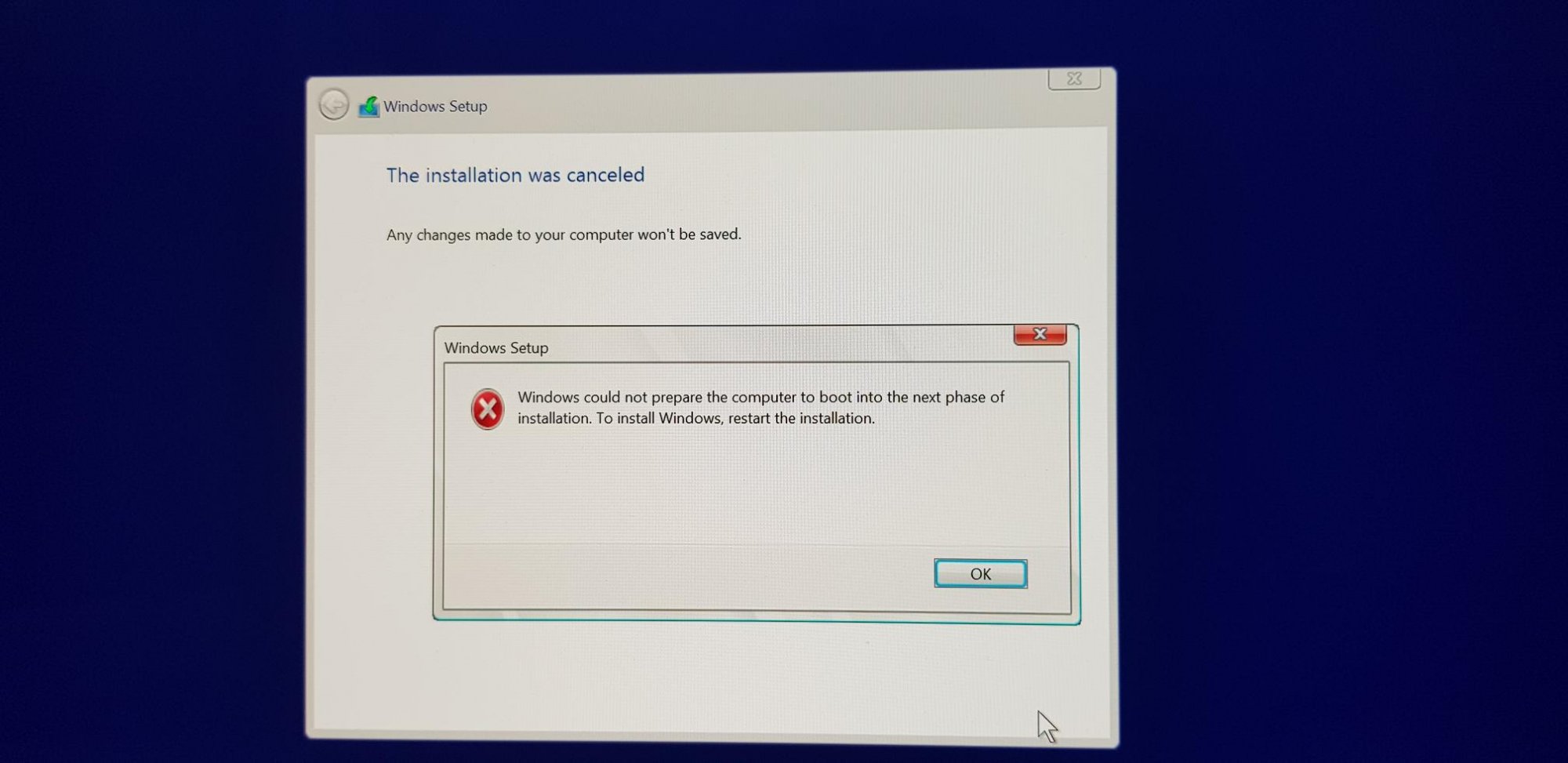

Hi following your suggestion and created a Windows 11 USB bootable and the only difference was that I didn't need to change country settings as it was on UK already. The same issue as before came up (Windows could not prepare the computer to boot into the next phase of installation. To install Windows , restart the installation).
Have you tried a diff usb stick, or is it an external ssd style drive you have burnt the image too?. There are so many reports of this on all Windows installs that it could be anything
Some mention unplugging all usb devices or trying different ones (if you are using a mouse can you switch to a keyboard for the first part incase, others claim success in removing the USB device after it has "copied files for installation (copy or preparing)" not saying either of these may help you but no harm in trying as per video i literally nuked my install today to test and cannot replicate the issue myself.
