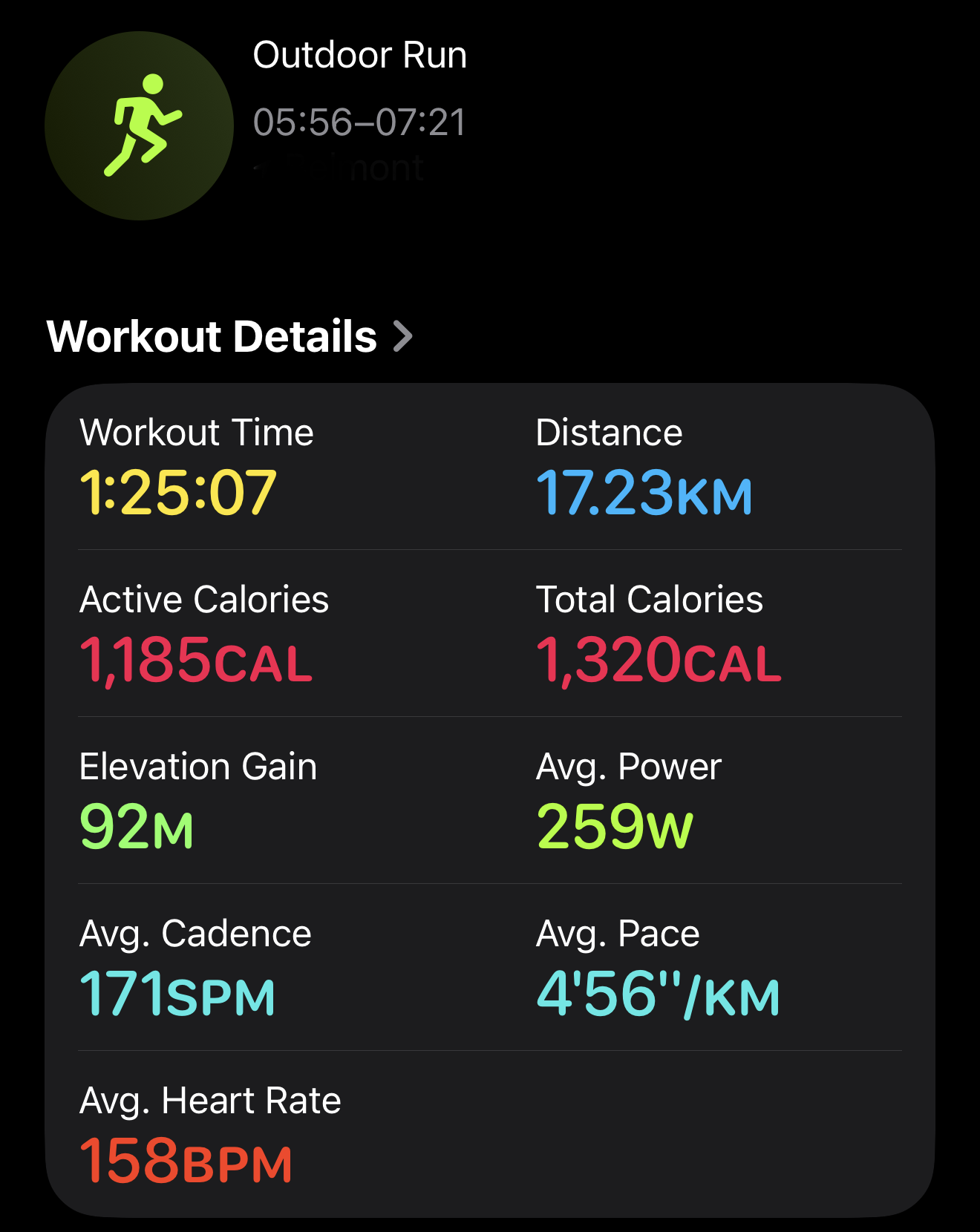

Is anyone noticing that, for custom workouts, total elevation is not being calculated since watchOS 26? The elevation chart is still displayed on the workout, it's just the total that is missing. This happens in the Workout app as well as WorkOutDoors.
It's not every workout but it is most of them. I've created a feedback with Apple, but I've only seen one other report online so not sure how widespread it is.
Custom workout with no elevation gain:
Open workout with elevation gain:

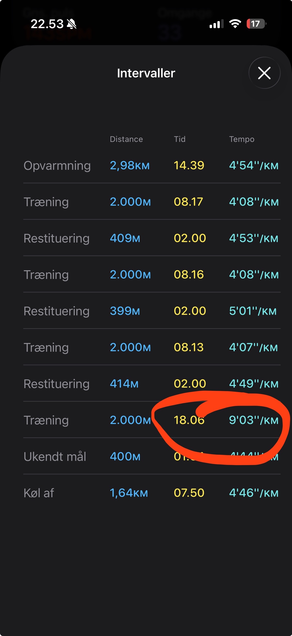

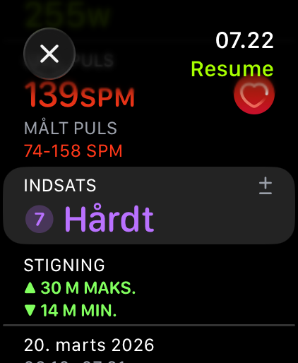

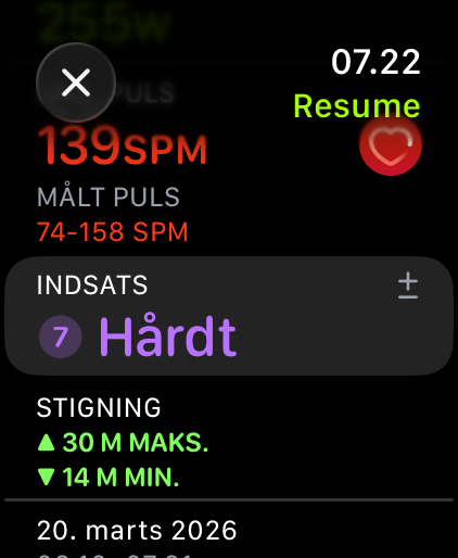

Just went on a interval session today - 15 km with 2 x 3K in the middle (1K jog in between). Noticed the elevation min/max on the resume page.
Paused for 30 seconds to pee in the middle and it completely messed up the middle part of the segments. Total time of the run was 01:09:03 and if I add the below time up it's over one hour and 40 minutes!? Something is messed up
Reactions: NME42

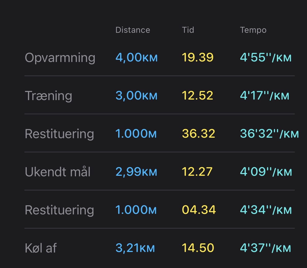

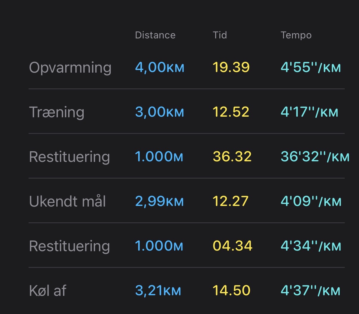

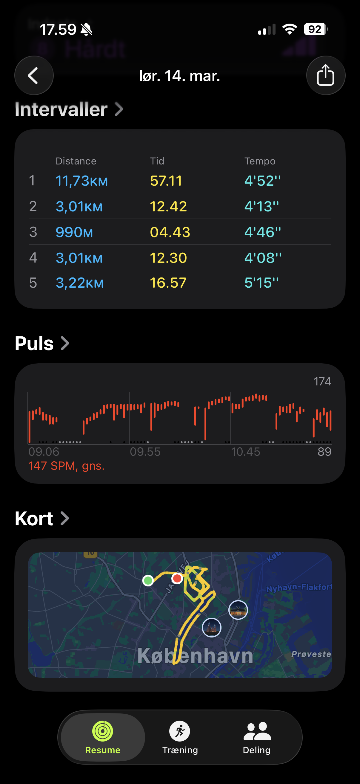

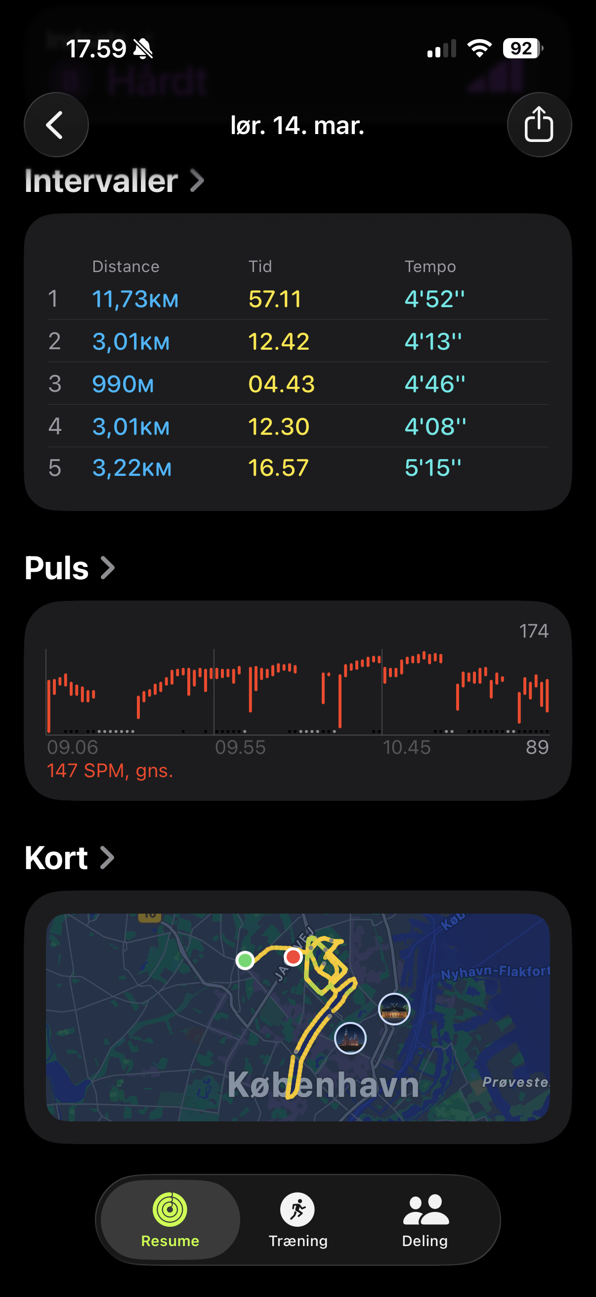

I did the same workout Saturday, although I used the app Watchletic.
Reactions: NME42 and xDKP
