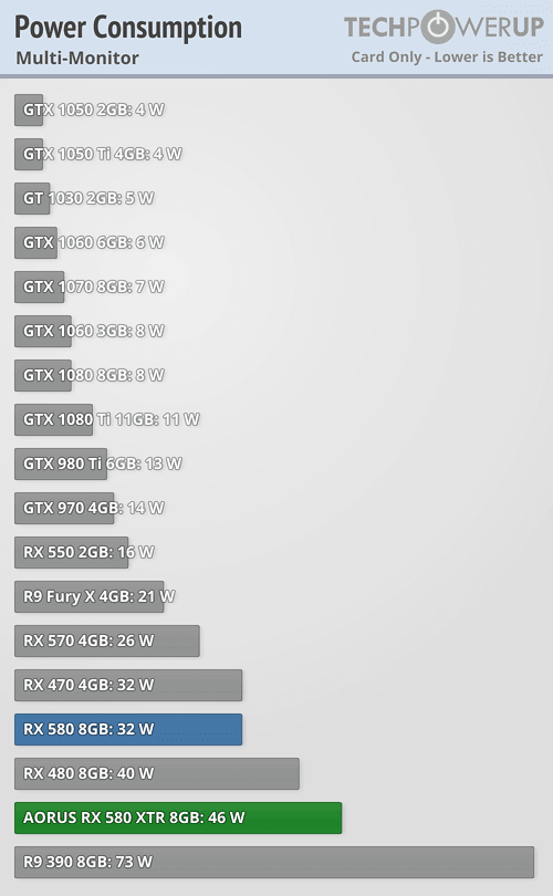

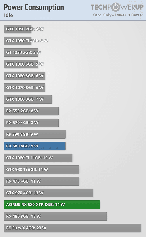

Confirmed - but only for a single monitor setup. With dual monitors, the fans do spin and even ramp up slightly from time-to-time.
It's not directly related to single or multi monitors setup.
The RX580 use about 200% more power (idle) in multi monitors setup than single monitor setup. Therefore, the GPU runs warmer. Depends on ambient condition, and the card's fan logic / profile, the GPU temperature may be just high enough to keep the fans spinning.
h9826790
macrumors P6
Apr 3, 2014
16,656
8,587
Hong Kong
Do they use 3x more with a 3 monitor setup?
No. The difference is only single or multiple.
For single monitor setup, the idle consumption is about 10-15W.
For multi monitor setup, it's about 30-45W.
AFAIK, the difference is due to the GPU will not able to down clock to the lowest power state when multi monitors are connected. However, no matter 2,3,4 monitors are connected, the GPU will stay at the same power level, therefore, same power consumption.
