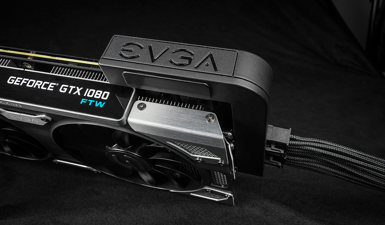

a lot of people use the EVGA power link as well for the dual 6pin to 8 pin
