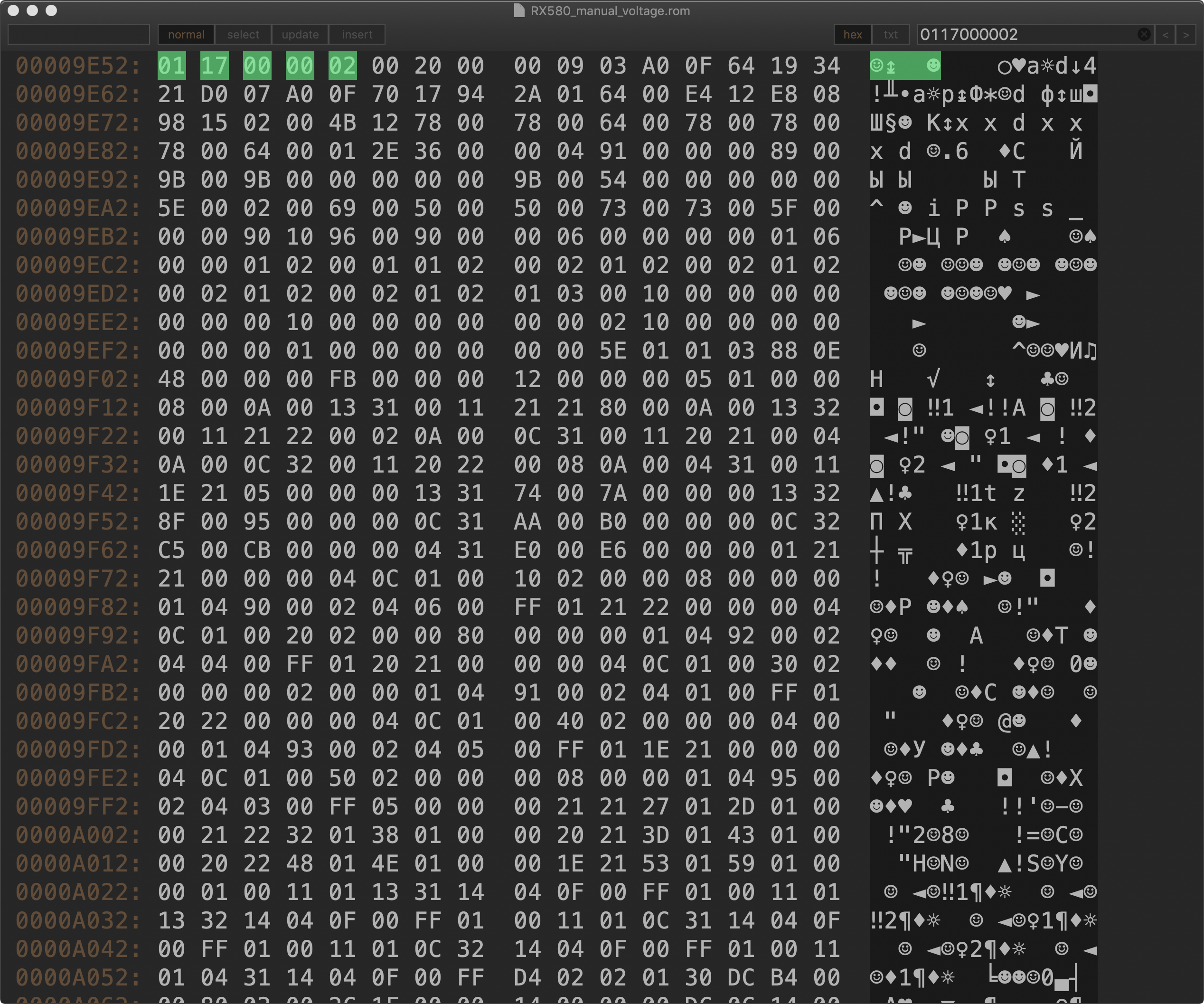

It seems you already found my RX580 VBIOS study thread. The answer is there.

If you don't mind to disable the UEFI GOP, makes your RX580 can't show the boot screen, you can mod the VBIOS to keep the fans always ON, or change the temperature threshold etc.

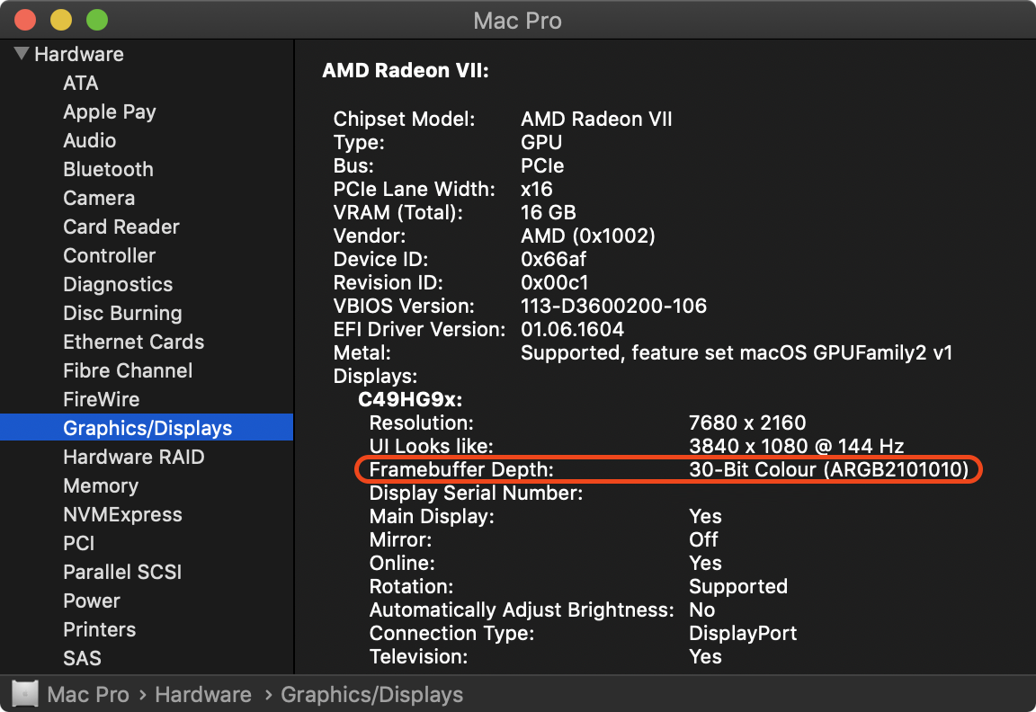

I think you’re onto something here too. I’m still at 24bit color, I’ve seen others with this card doing 30bit I believe.
I can confirm my RX480 is displaying 30 bit colors. Mine is PowerColor reference version, and I love it. Fan noise is acceptable, only utilize single six pin auxiliary power.
I have no any graphical glitch, but I have strange issues after updating to 10.14.6, each I boot it wouldn’t firing up my monitor anymore, I must turn off my monitor on off and then it would displays login screen. Previously it not happened on 10.14.5 Mojave below. My monitor is Dell 4K display.

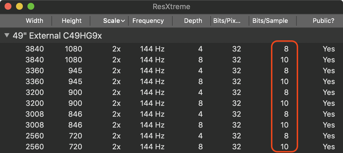

ResXtreme (free apps) allow user to select different resolutions with 8bit or 10bit colours. The following captures are with Radeon VII, but also works with my PULSE RX580. Which means should also work with RX480.
