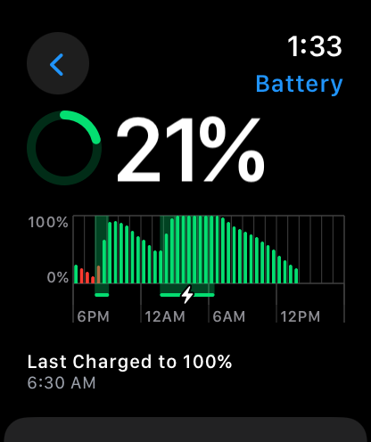

I’m having pretty awful battery life. Using S10 Slate Ti. The only reason I upgraded from the S8 stainless was because I wanted a new battery, so this is pretty frustrating. I’ve not even done a workout yet today and have spent the majority of my time at my desk with walking around the hospital for patients as needed. No tracked workouts or use of the watch other than it being a watch.
I was using the flux watch face which I’ve now disabled in case that helps. But there’s no reason to be at 21% at this time of day with practically zero use.

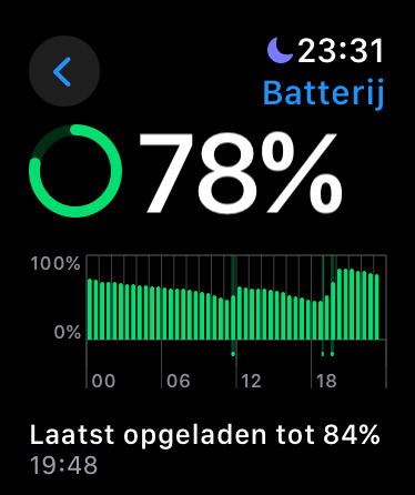

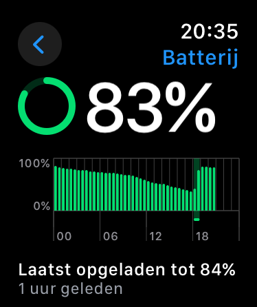

This was my battery graph yesterday and today, I have nothing to compare it to. But I think my battery is fine. I have it since last Friday.
I read that there’s an iOS 18.0.1 update coming. Maybe there’s a watchOS update coming as well 🤞
That sounds like a software bug?
Yes that looks normal.
