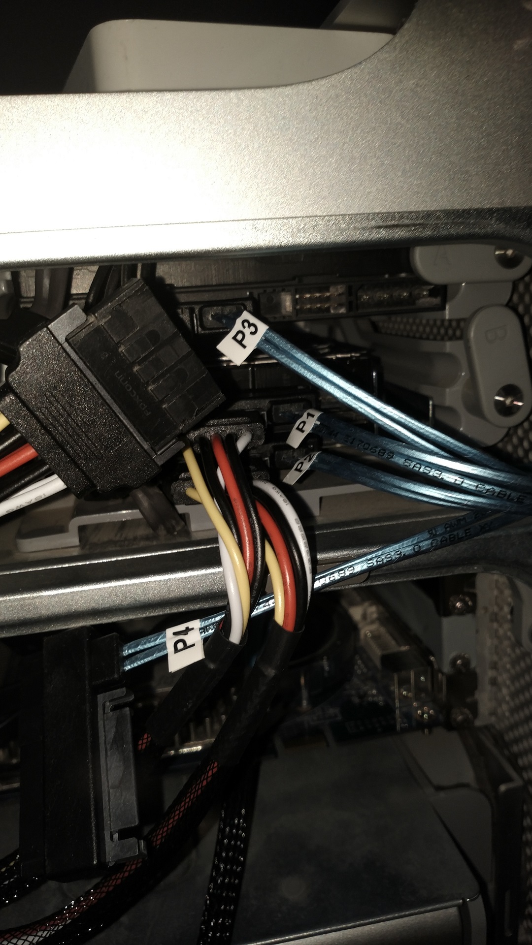

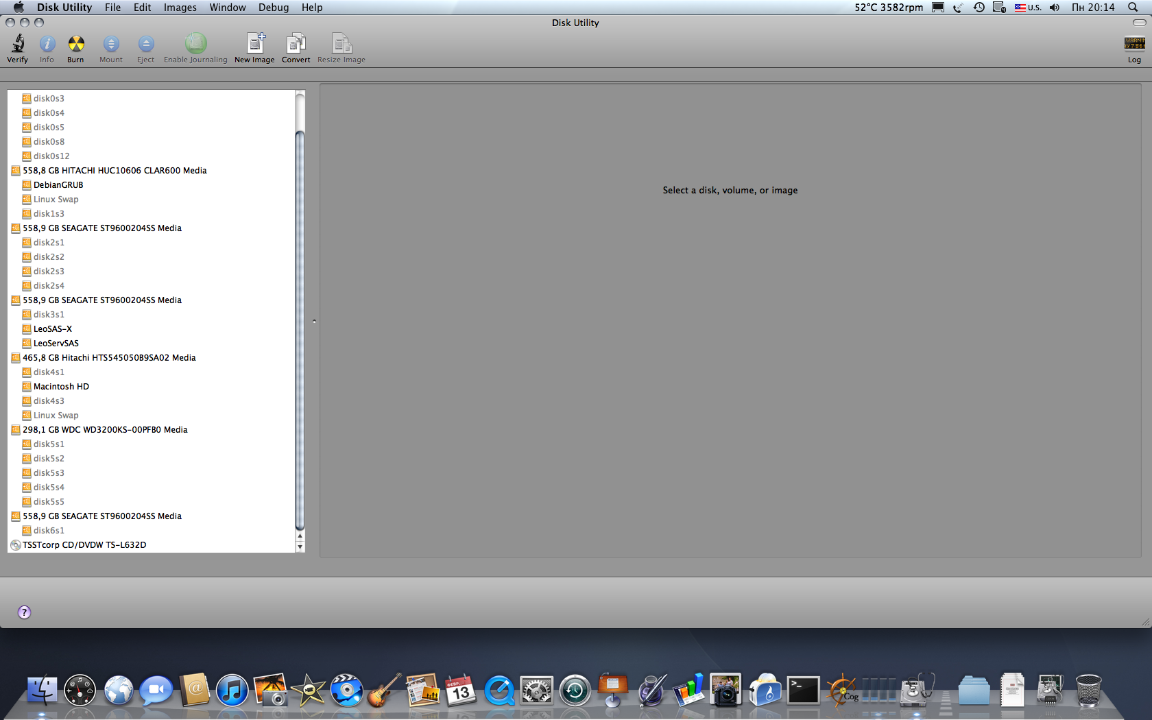

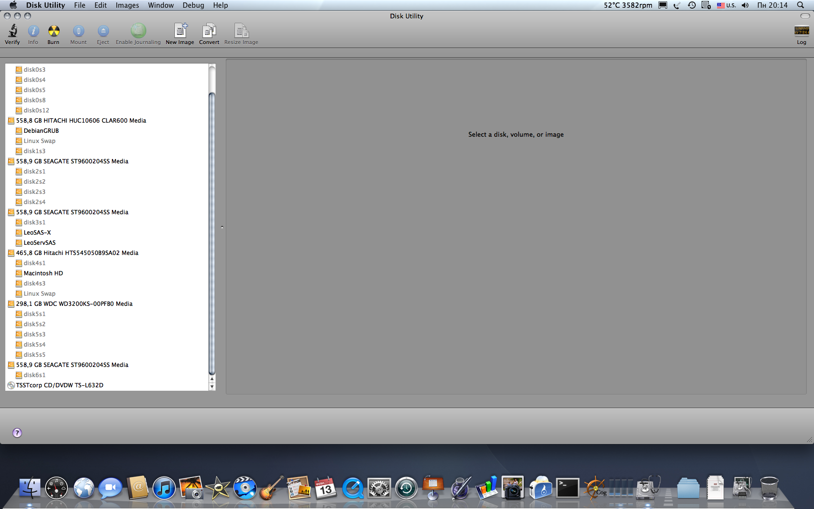

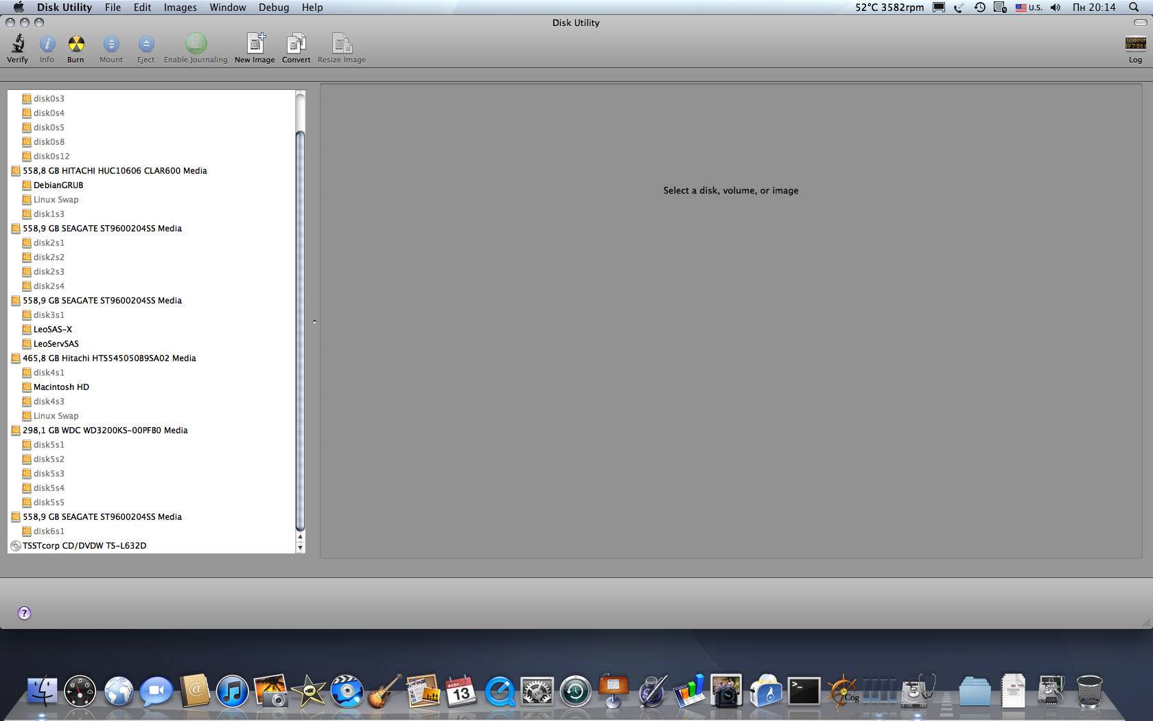

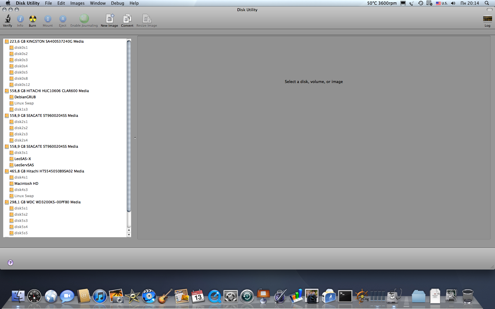

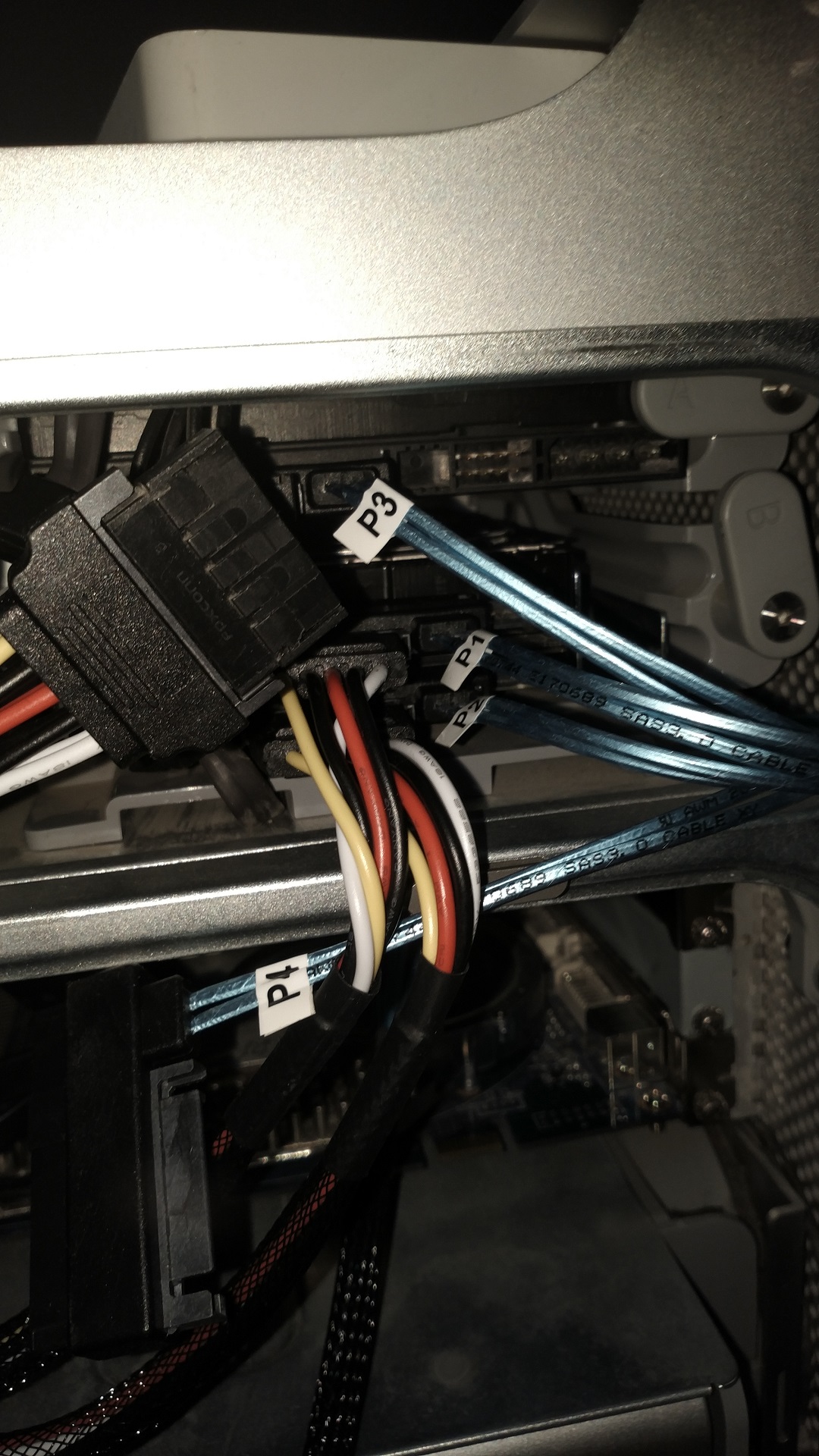

So I've managed to connect SAS cables & some drives 🙂. Excuse me pls for low pics quality 🙂.

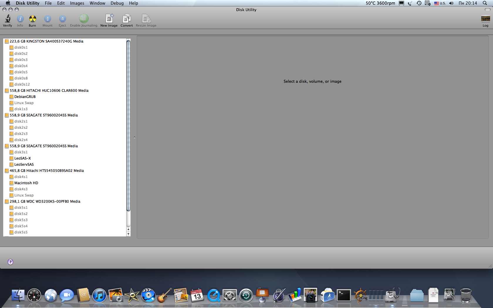

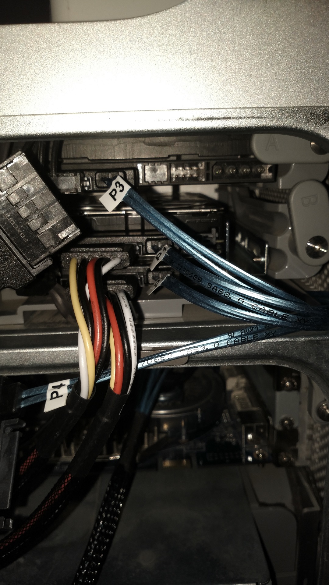

Re-added, cables "a bit" longer than needed 😀.

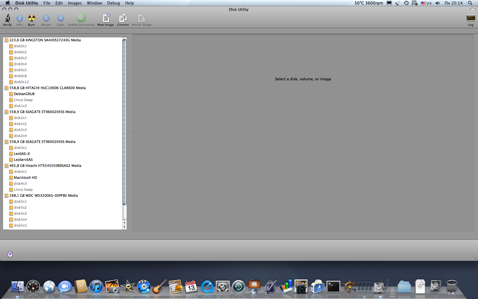

Yes. The thick one is SAS, thin - SATA drive from MacBook A1342 (Snow Leopard there, if I remember correctly). Planning to move from HDDs to SSDs, but it's a bit expensive for me to buy 8 SSDs at once 😀. Well, I also like sound of starting SAS HDDs at power-on 😀.

What speeds do you get out of these?
Hadn't tested yet. It seems I have to buy ifixit toolkit & try to work with cooling a bit.
Strange thing - SATA drive with installed Tiger & Tiger Server not shown in boot picker (it is third on SAS channel). But it was when drive was connected to built-in SATA port.
BTW, which toolkit fits better for G5 quad?
or
I hab frequent issues in particular wit the rearmost of the ports (#0 ?) to be visible at boot or after. Also the LSI seems to be a bit picky about the disks themselfs.

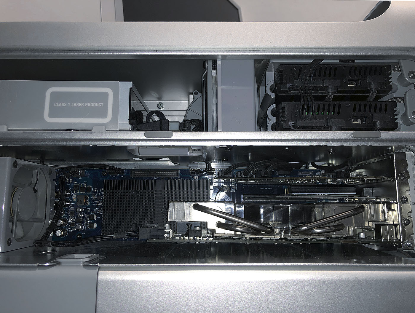

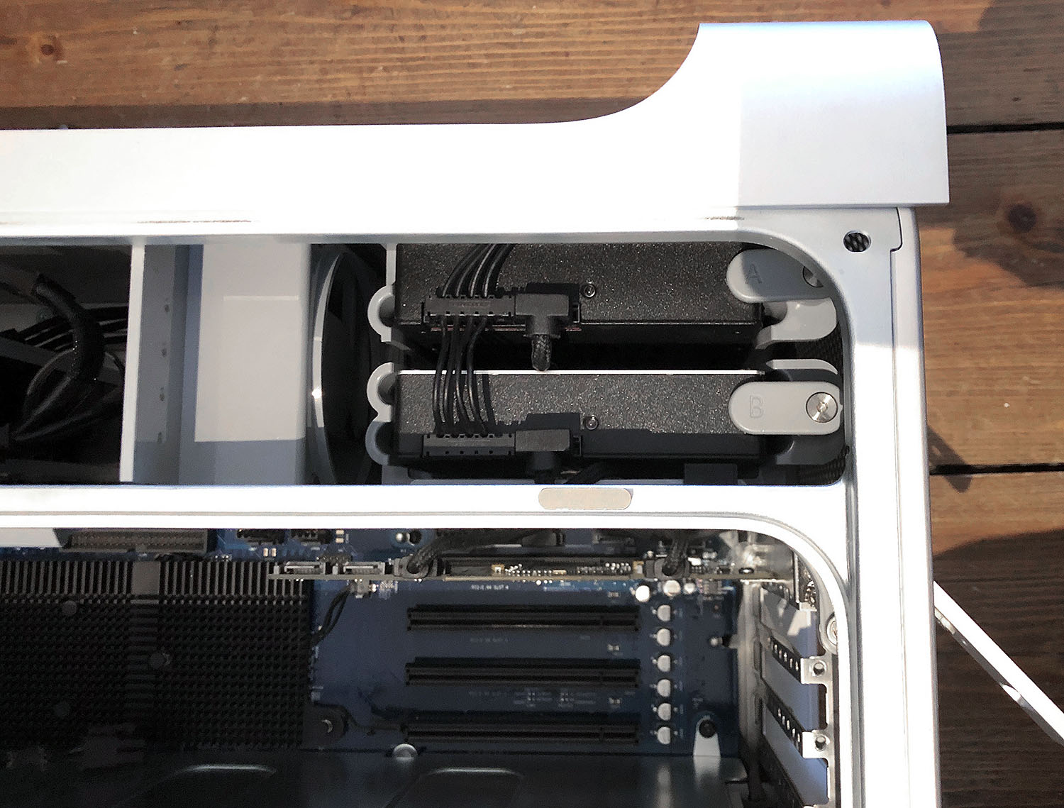

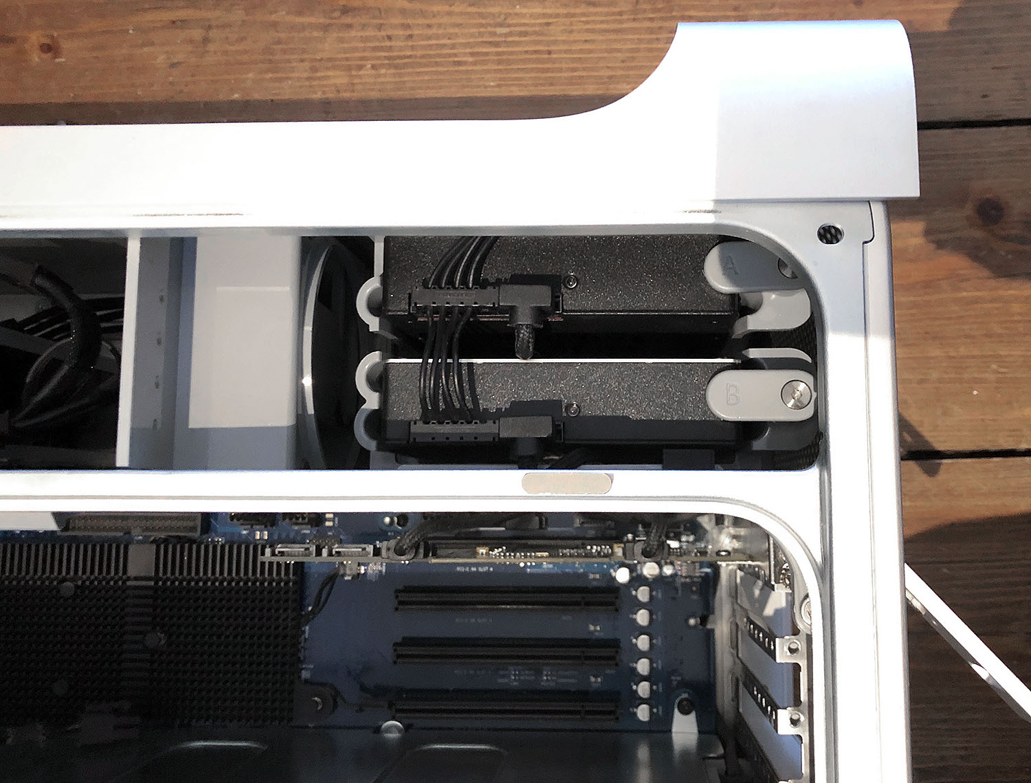

So here's just another "final" upgrade to the Quad!
It went from this...
...to this...

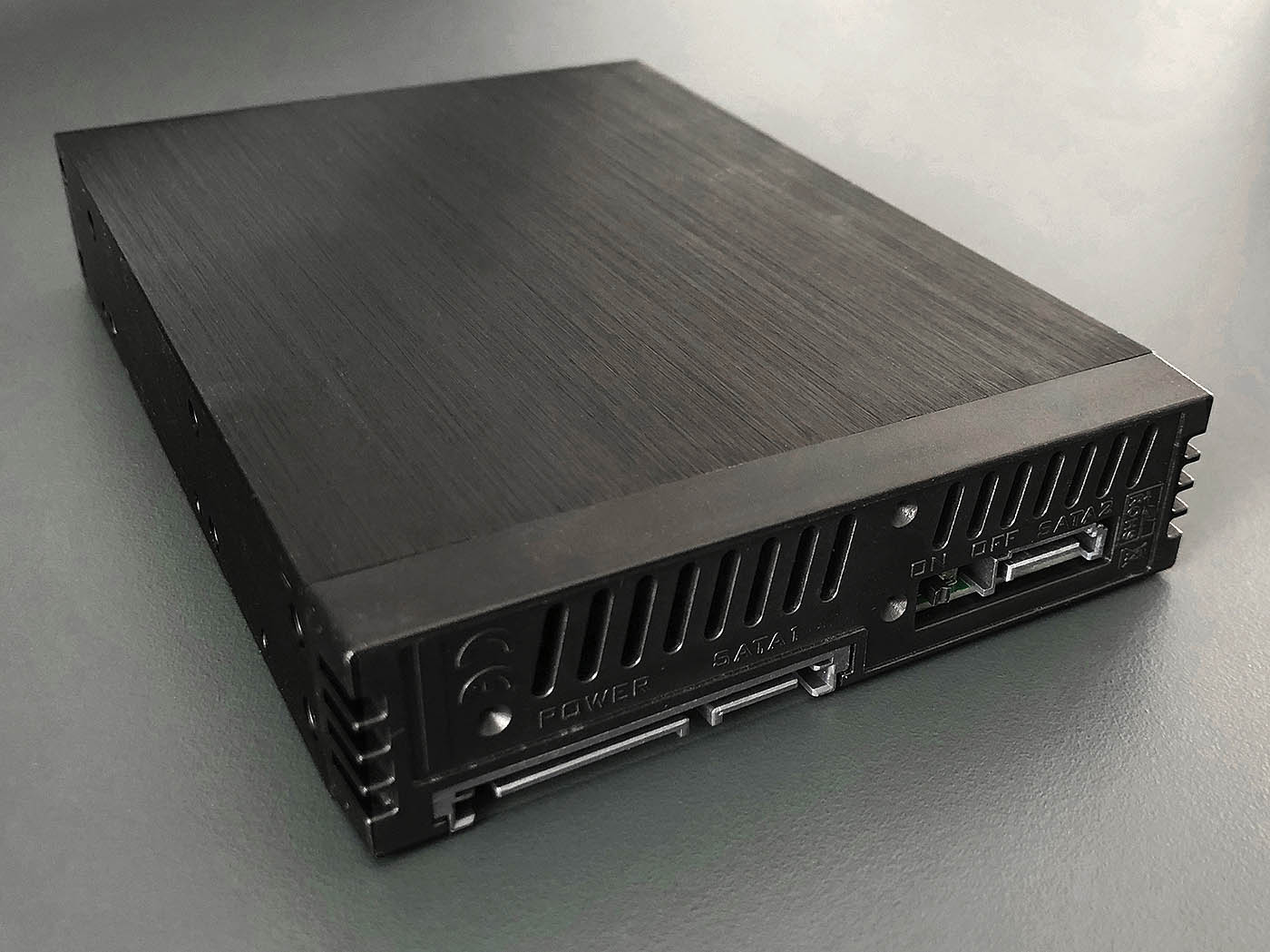

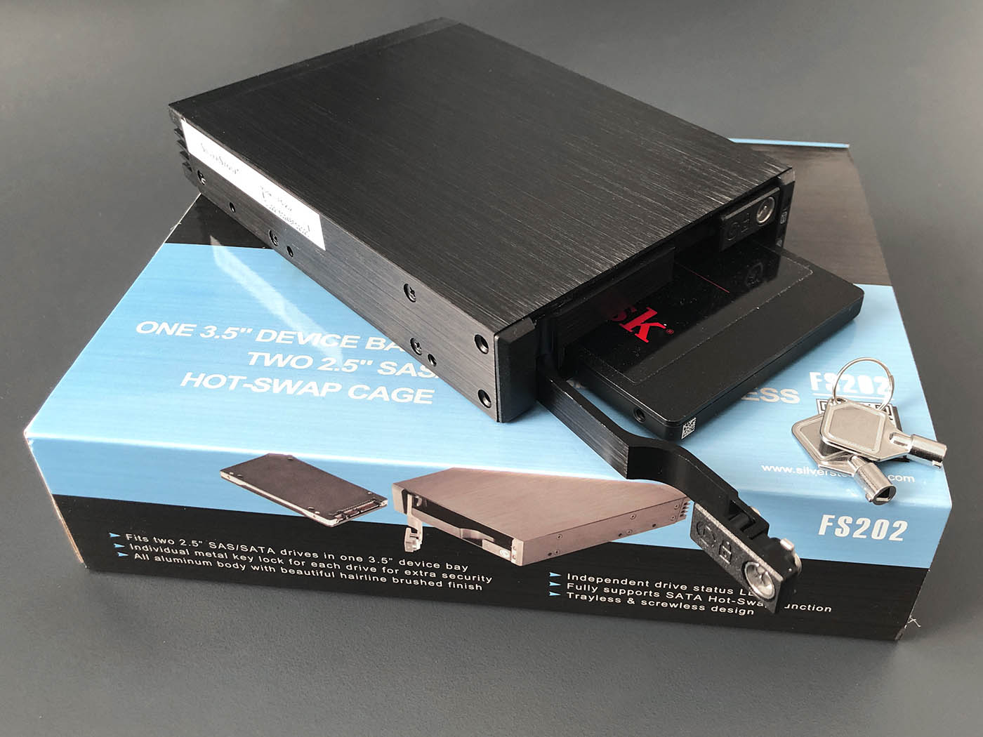

...involving two of these!
They give such a perfect companion to make use of the full potential of these SAS-cards in particular in a Powermac G5, that – again – i could not resist.

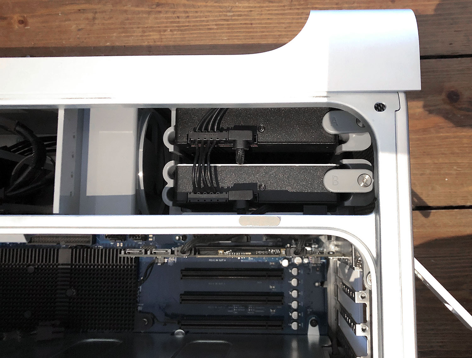

Holding two 2.5" SSDs each in one tray...
...in very solid metal cases. Even with locks for that "professional server looks", sadly not visible when mounted to the G5.
But only requiering one power plug each!
So no additional cables needed, except for data. A perfect match for what the G5 has to offer. Also an on/off-switch is available, if the second drive is not needed.
Sadly they do not 100% follow the formfactor, beeing about 1,5mm too long in the back, causing the lock for the lower tray to not be closeable anymore. So i left both of them open. Held by three cables each, they won't go that far anyway.
I used one of the drives for the main bootdisk, a Sorbet install, one for a standard Leo 10.5.8, along with a backup of the apps and user data and the other two for a RAID 0 mirror of the sorbet disk, which can boot as well.
Main storage for apps and user data is the AHCI-SSD in the PCIe below, which is even faster but sadly not bootable.
So G5 Quad-mass-storage-case should be finally closed by now!
...as long as nobody far more skilled than me gets that FCode driver for AHCI figured.
I wish I could buy that enclosures here... 😀 BTW, does they support SAS drives or SATA-only?
It seems you replaced stock IDE DVD drive with one SATA-conencted? Why not replace it completely with another enclosure, you can get 4 more drives 🙂 (molex-powered, y-type splitter & all is up 🙂 ). I started with 1 such thing, but now 1068E-based controller allows to connect 8 drives 😀.
Yes! Item description says "SAS/SATA-HDD or SSD".
Yes, it's a BluRay-burning-drive. There are no IDE BluRay-devices.
It is attached to one of the G5's SATA-ports. So bootable too.
Because i just don't need any more drives nor have i any more free PCIe-slots available. The only one not used is blocked by the GPU's cooler.
If i'd need mor space in this machine some day i'd simply swap out the drives for bigger ones.
Got it. My primariry goal was not space but number of drives, for several OSes 🙂.
Ok, got your point! 😉
But me, i do not intend to use anything else but Leo or Sorbet. Only other option, running this card, could be Tiger Server which i don't even have. I once did a test-install of the Snow Leo Beta. But IMHO it is far from beeing usable on the G5. So i think i will get along nicely with what i have. 😊
