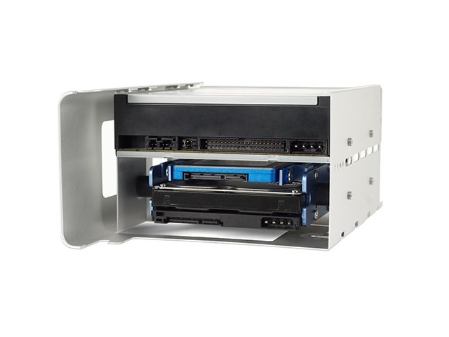

This is actually exactly what I would like to do! I got the OWC multimount, which I assume can handle two drives (in the top bay), and actually didn't even know I could still do a BD-ROM with the pass-through cable (so power is going to 7 total drives, 6 3.5" and 1 BD-ROM?). Any recommendations on a BD-ROM that will ensure fit/function under these circumstances (else I assume this will work)?
From looking at the multi mount photo it looks like it could work just as long as it actually allows you to mount two 3.5in hard drives on it. The photo shows a 2.5 and 3.5, but it might work with two 3.5 hard drives if the holes match up. You really dont even need this, but its upto you. I just have one wd red sitting on top of the other.
As long as you get that power cable splitter that showed you I dont see 6 drives and 1 dvd-rom causing any power problems. Our power supply is really good. The only issue might be if you add a powerful graphics card, then power could be an issue since your already using x5690's. That's just something to keep in mind later down the road.
Also as a side note your drive will only use power when its in use and im pretty sure if your burning a blu-ray your not going to play a game at the same time so i highly doubt you'll have any power issues at all.
I also found a longer version of that cable on Ebay
As for the BD-Rom you really can choose what ever you want. Any 5.25" drive will work. That drive is $50 and an older model (the one you linked) this one is newer and a little faster for a few $$ more.
If you want some really cheap BD-R media, you have to order today. Its only $16 for a 50 pack of 25gb discs I picked up a pack myself. The $10 off coupon expires today!
