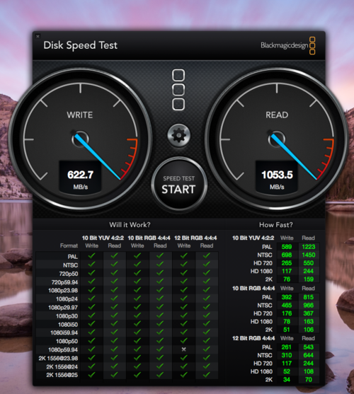

Finally got my SM951 and dropped it into slot 4 alongside an Accelsior E2 in slot 2 as my boot drive. Here are the speeds. Was expecting to hit 1500 but i’m hardly disappointed. Good on Apple for allowing Trim!

i got a kingston predator pcie ssd 240gb for 200 bucks from amazon prime day.
dunno why is much slower here, on my windows pc i was getting 1400mb/s read.
Nice! Does it work as a boot drive? If yes, what kind of boot times are you getting in OS X?
Oh, the difference in speed is likely artificial and caused because you are using different software tools in each OS.
