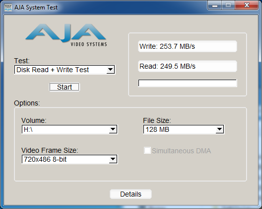

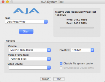

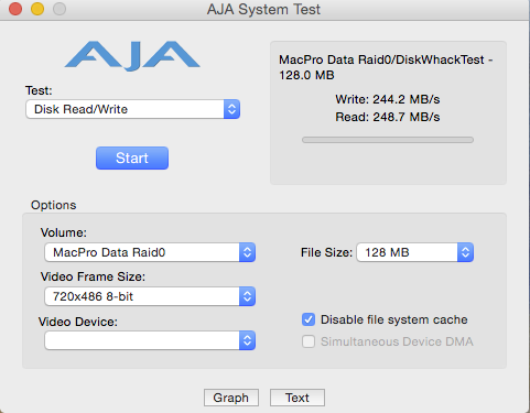

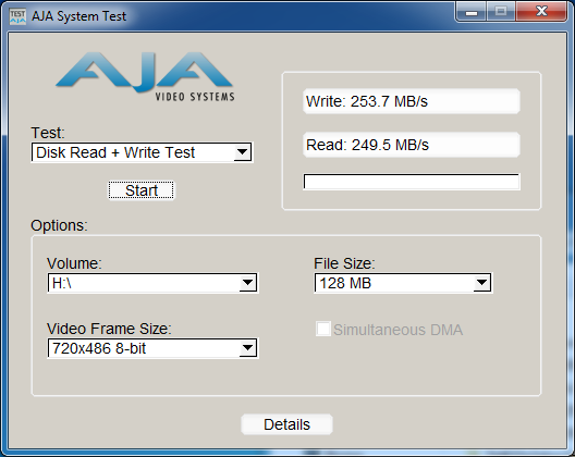

There you are. Fresh results.
test machine: Mac Pro 3,1 - raid0 - sata 2 connections - two drives - macdrive latest version.
Surprising is the win7 result, a little better than OS X 10.10.5
