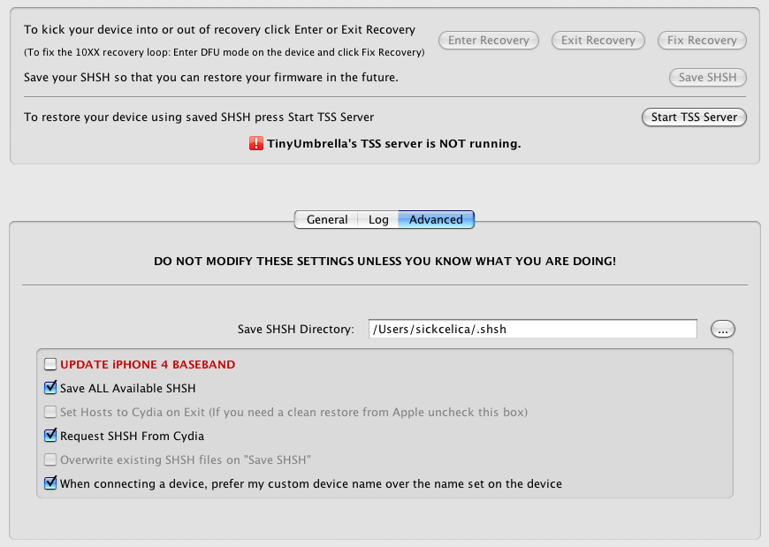

Turn off TSS server inside TinyUmbrella and/or make sure in the advance tab that “Set Hosts to Cydia on Exit" is NOT checked.:cool:
this is the way it looks. still won't do anything
uncheck request shsh from cydia.
Then try again.
That's the reason its not letting you cause instead of communicating with apples servers you're connecting to cydias and the reason its not let you do the restore.
Then try again.
figured out how to restore it. my host file had two apple parts in the blocked section.(not sure how they got there).
question though. because i updated over the air first can i still restore it and save my blobs? or did i screw it up by doing over the air update at first?
Lol, they got there because TinyUmbrella had "request shsh from cydia" activated in the advanced section. ;)
You can go ahead and restore on top of your OTA no problem.
