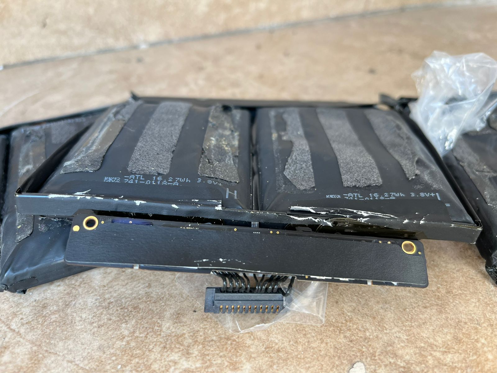

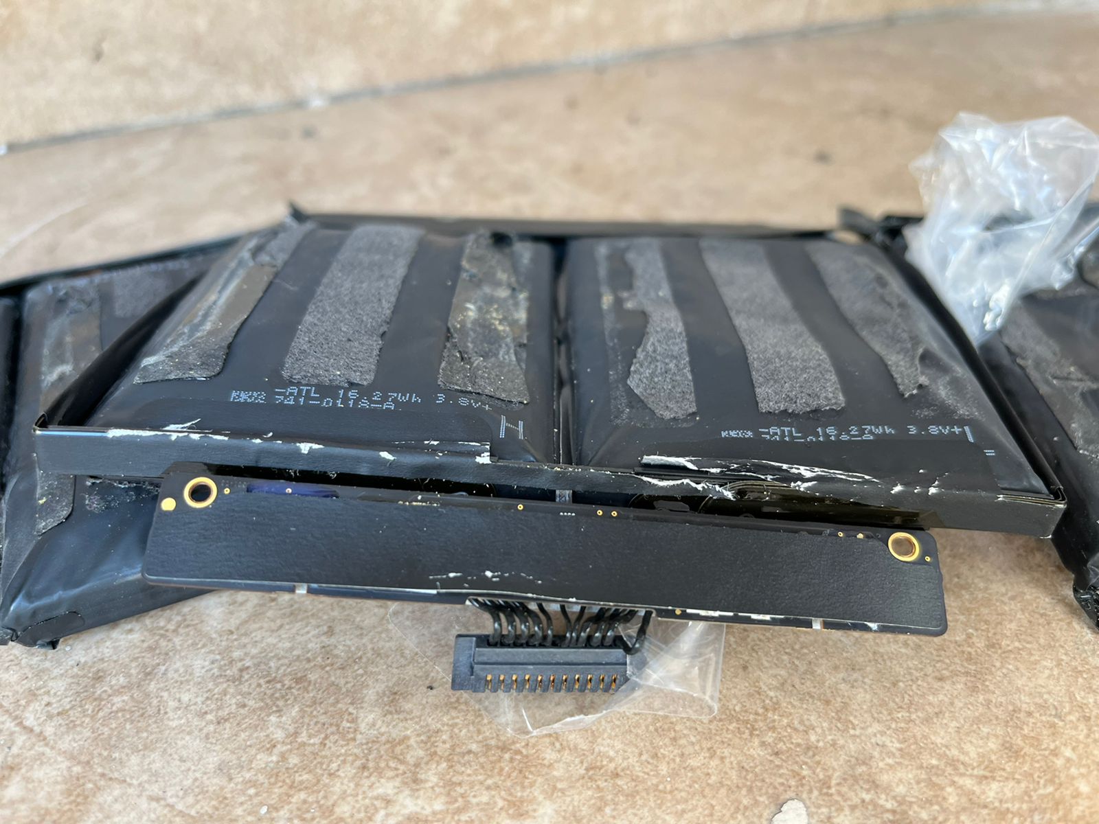

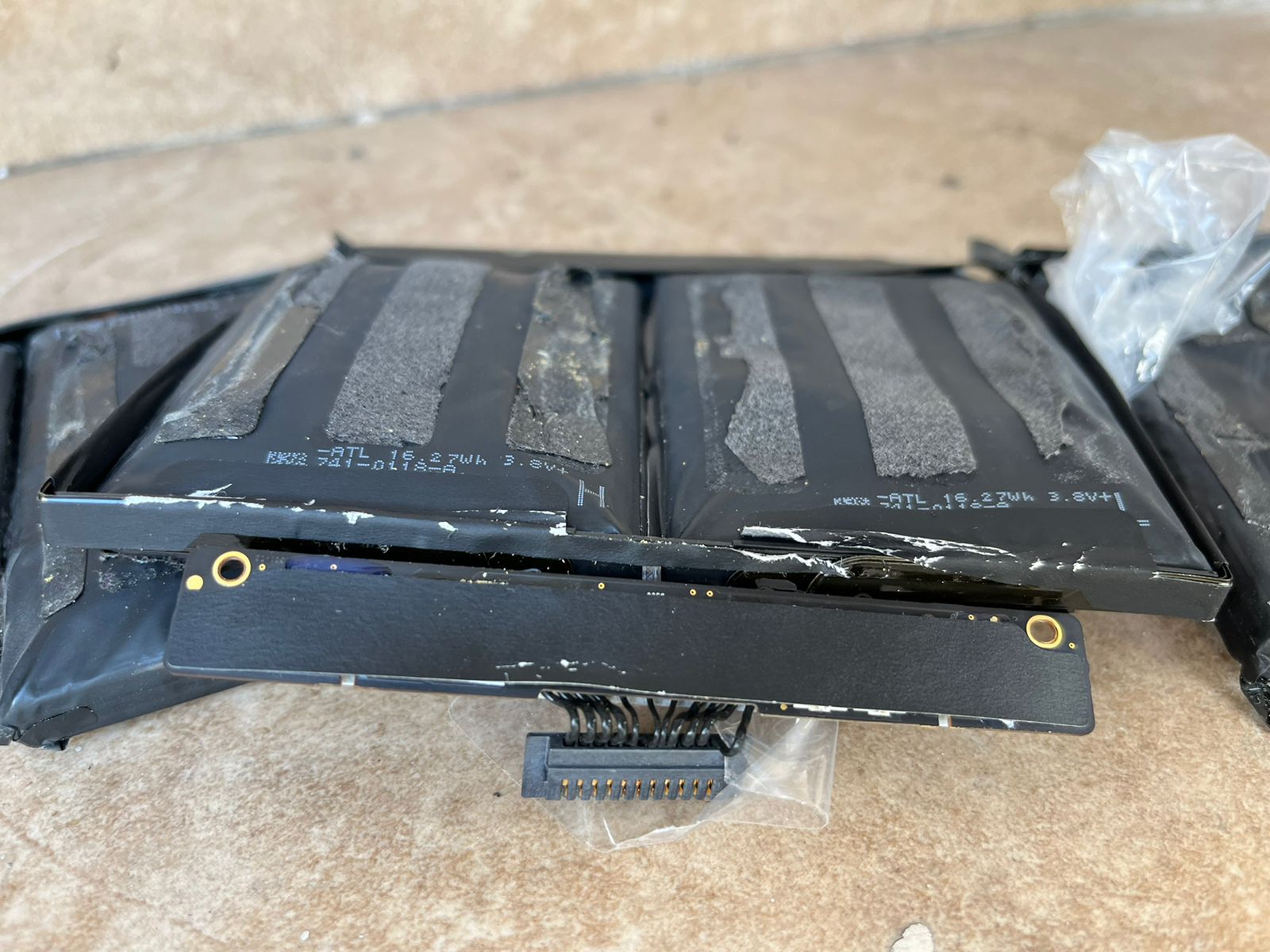

Update: I open it and remove the original battery, yes is very inflated, pics attached.
I replace it with a new battery, and now even the trackpad is clicky again, so yes the inflated battery push the trackpad.
Now the computer return to his standard speed, back to his normal life.

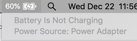

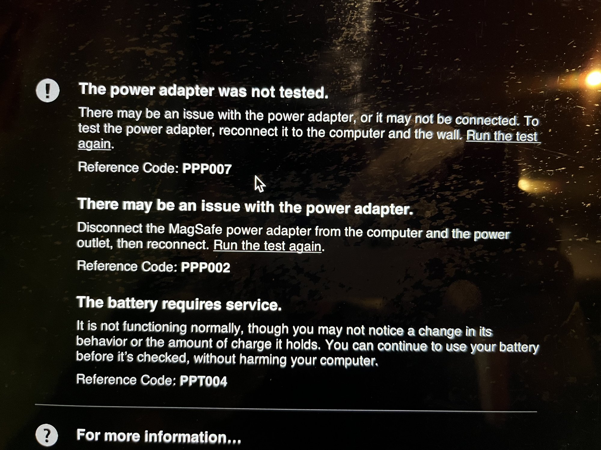

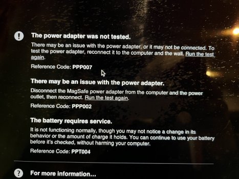

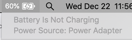

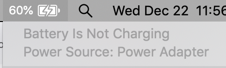

BUT!!! My new concern, the NEW battery says: BATTERY IS NOT CHARGING, why??? is on 60% but don't down any, around 6 hours with the power charger and the battery don't up or down.
note: says power source: power adapter, so the power adapter it seems is fine?

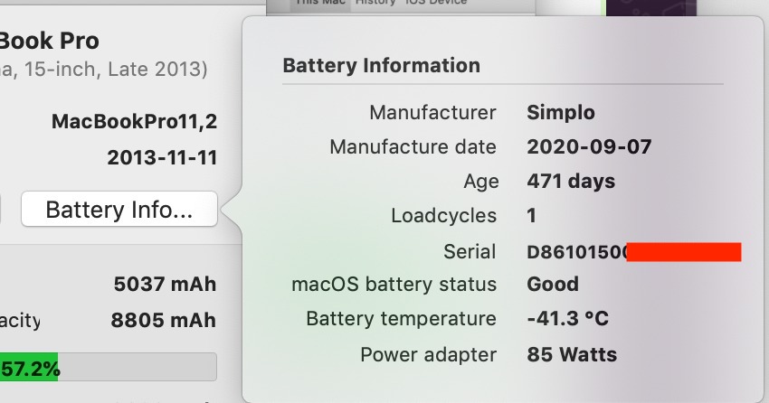

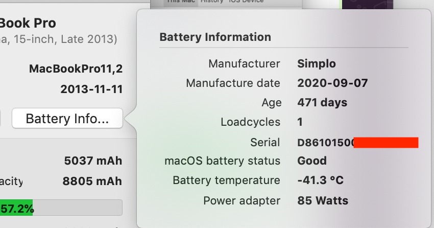

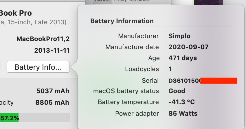

more info about the new battery:
Try to calibrate the battery. From 0% to 100%, or vice versa.
Try SMC reset and NVRAM reset as well.
Otherwise the new battery can be defective. But I do not think so

thanks again, I think the new battery is ok.
calibrate the battery from 0% to 100%? that means dry the battery to 0% without the charger, to later start to charge it?
Try SMC reset and NVRAM reset as well (yes but big problem, the default keyboard don't works lol, I'm using an external one).
note: yes I know this 2013 macbook pro needs a replacement but I want rescue it, is a good machine, runs fine. I'll buy the mini m1 pro on march or when apple release it but for now I'll need rescue this.
Yes, actually I would not recommend to do this however it might be beneficial to do for only one time, so that the battery can be pushed to operate normally.
SMC and NVRAM resets are internal features of MacOS and Macbooks. Try them anyway.

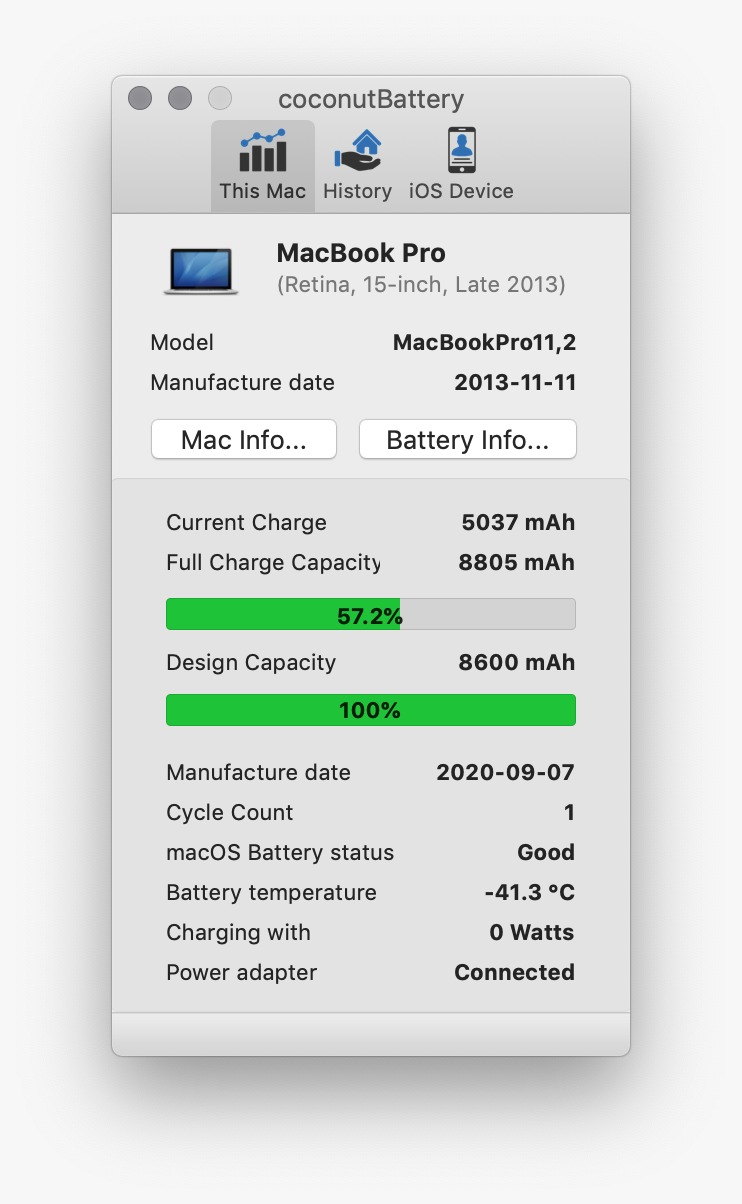

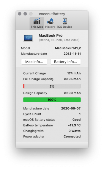

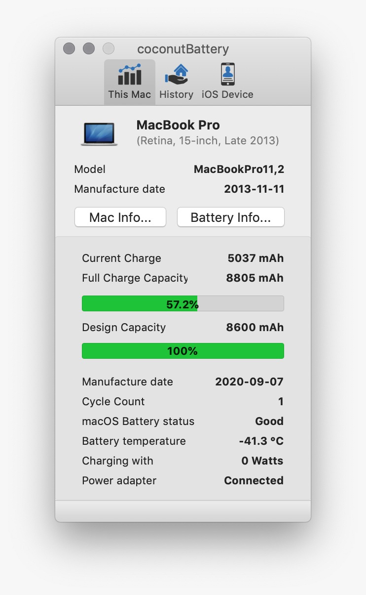

still not charging, after a SMC and NVRAM!
I test the charger with other mac and charge fine, so the problem is not the charger.
the new battery is down to 2% and the mac is slow again!
it seems the battery is fine (screenshot)
I don't know what to do... more 🙁
maybe the connector inside is damaged? or?

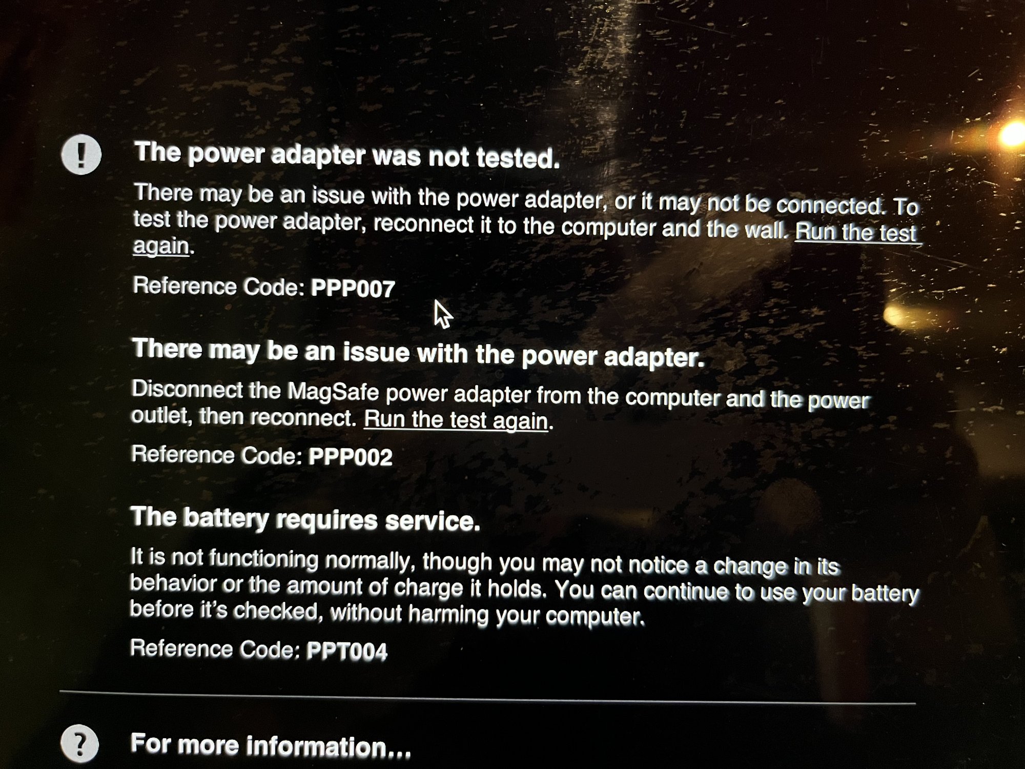

Looks like you might have a problem with your logic board.
You need to drain the battery to 0% dead. DO NOT CHARGE IT FOR 5 hours. leave it alone.
Fully charge it to 100% TURNED OFF. DO NOT USE IT.
When light on charger turns green, let it charge for 2 MORE HOURS.
Turn it on and start using it as normal.
That is a full battery "calibration" from apple and iFixit instructions.

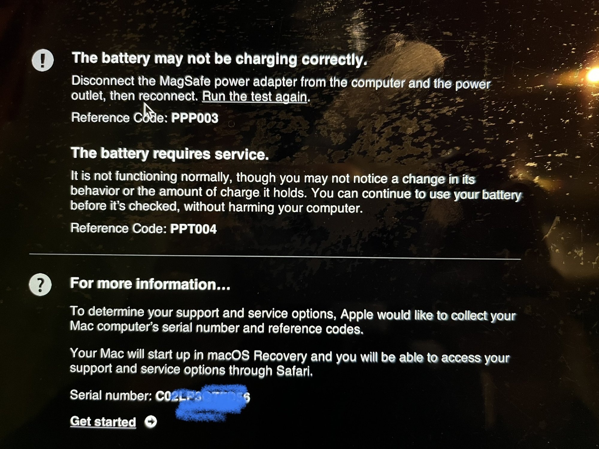

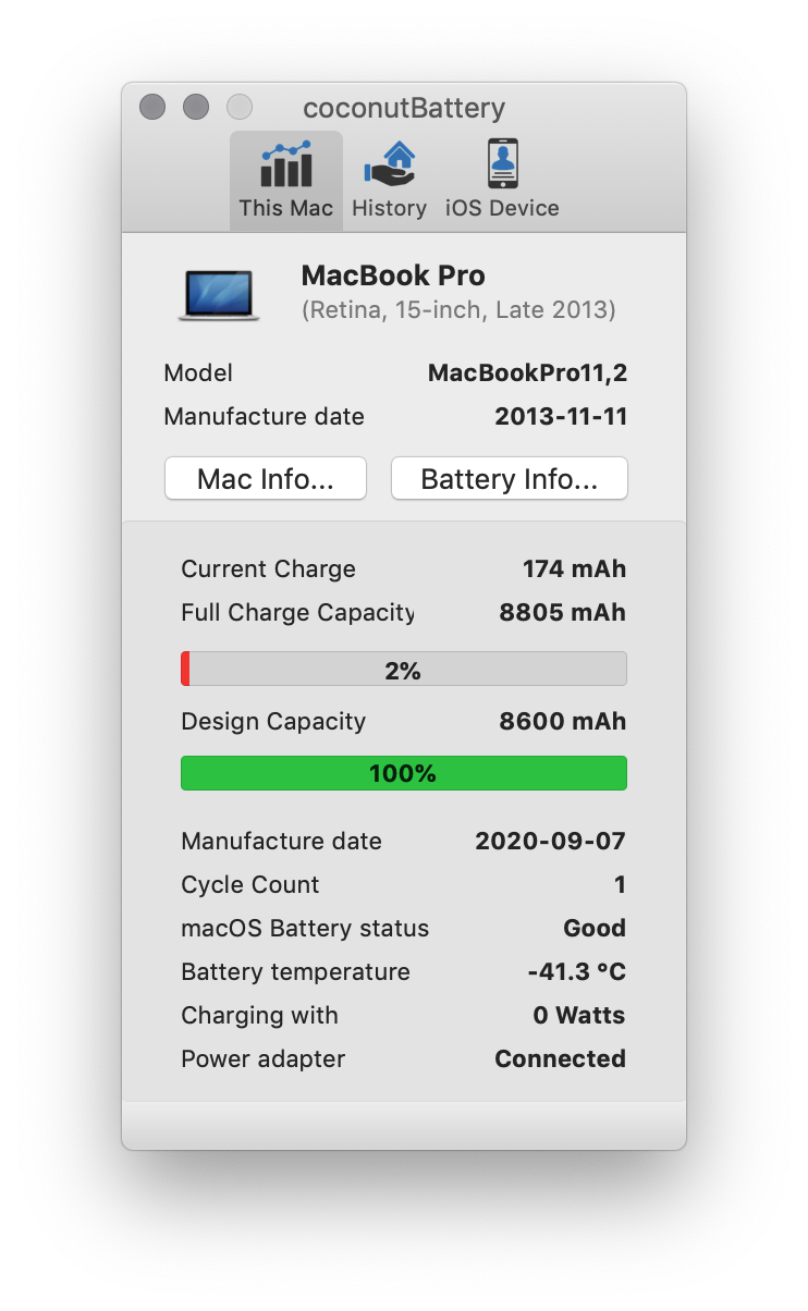

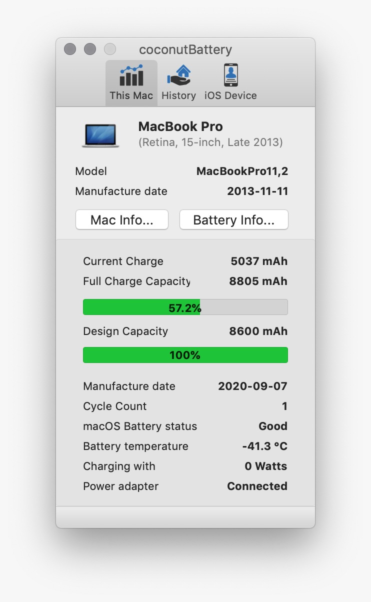

ok after 5 hours with the machine unplugged to try the drain the battery to zero, I plugged for the whole night, now in the morning still see the orange light, I turn it on and I see the same thing as my previous screenshot cococonut app, at 2% and not charging.
So the battery don’t drain to zero?
I feel the battery is good, maybe is other problem with power contact or something? Mmm

your battery is the same brand as OEM/original Apple (SIMPLO).
im not sure, BUT it maybe something wrong with your logic board (a charging microchip) that isn't functioning properly to send electricity/charge to your battery.
you might have to take it to a local computer repair shop and have them take a look at it.
yes, is the new replacement is a brand new batter, same Brand SIMPLO.
