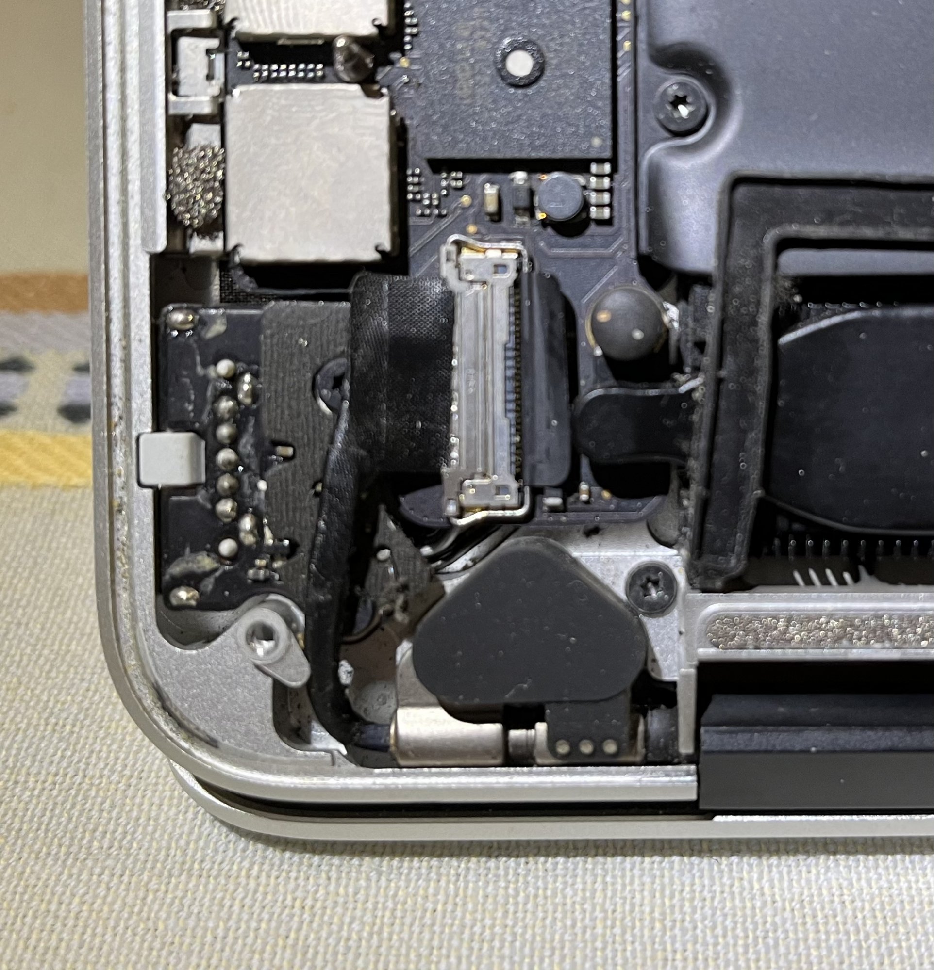

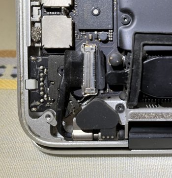

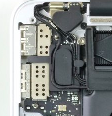

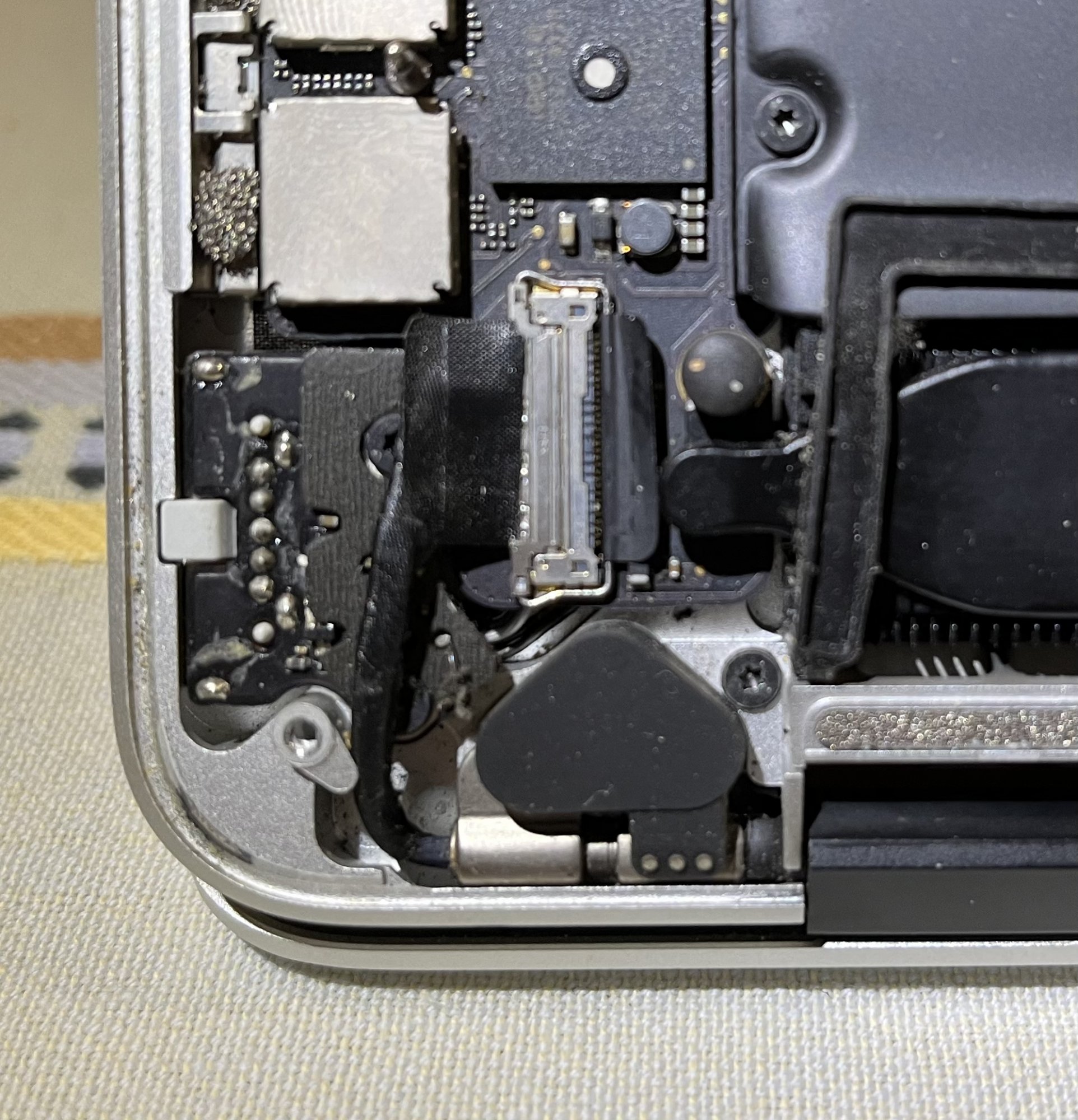

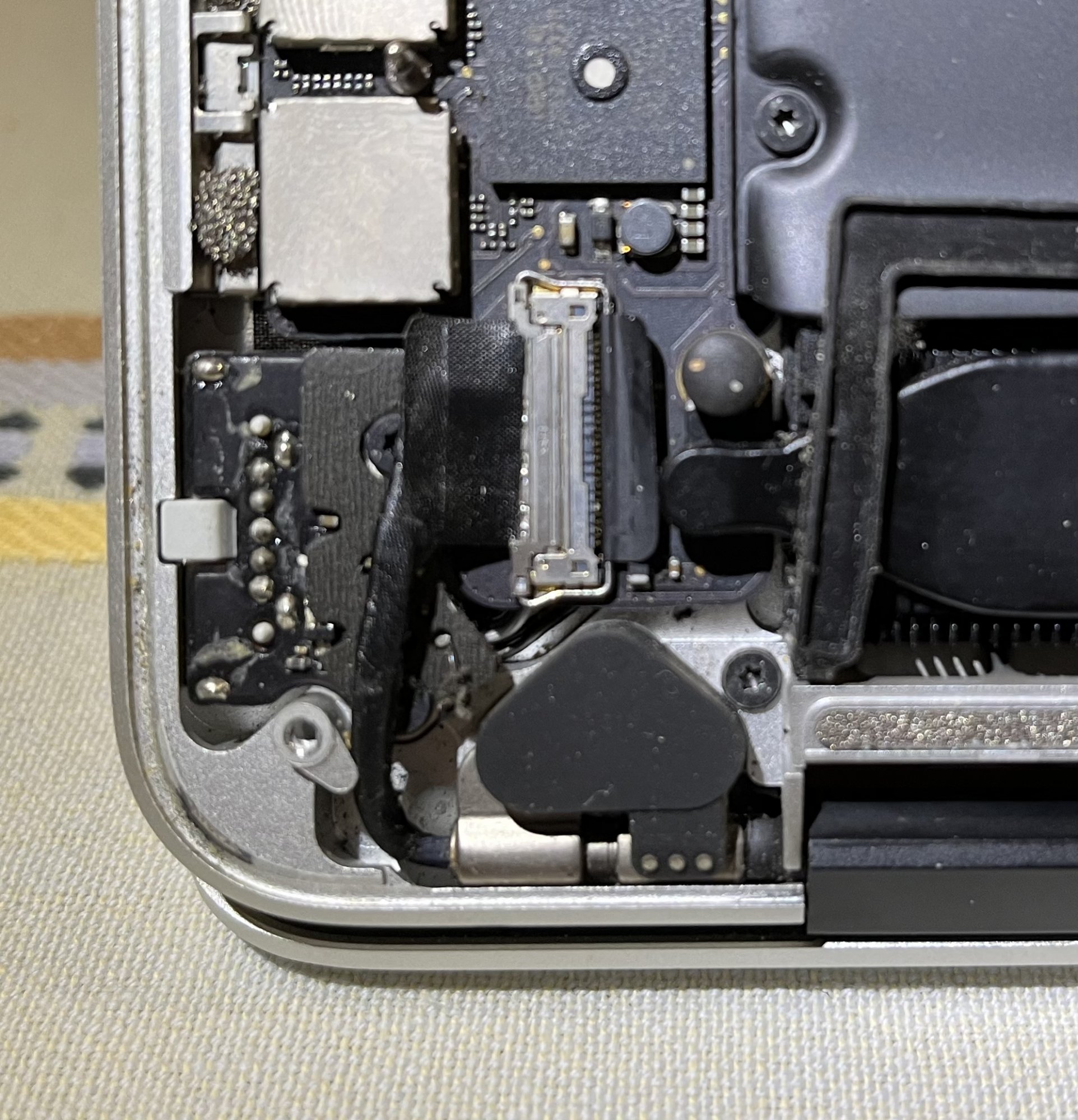

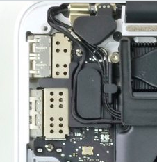

To confirm that I think I need open the machine and check the connector? like this:
Yes. If it were me I would open the bottom of the machine to make sure the battery connector is pressed into the receptor completely. The connector is the piece that connects the battery to the mother board. You can see it in your post # 36. It is the thing on the bottom of that image that has the little wires attached to it. I would unplug fully and then snap it in gently and completely. It's a long shot but sometimes little issues cause major problems.

Yes please check inside

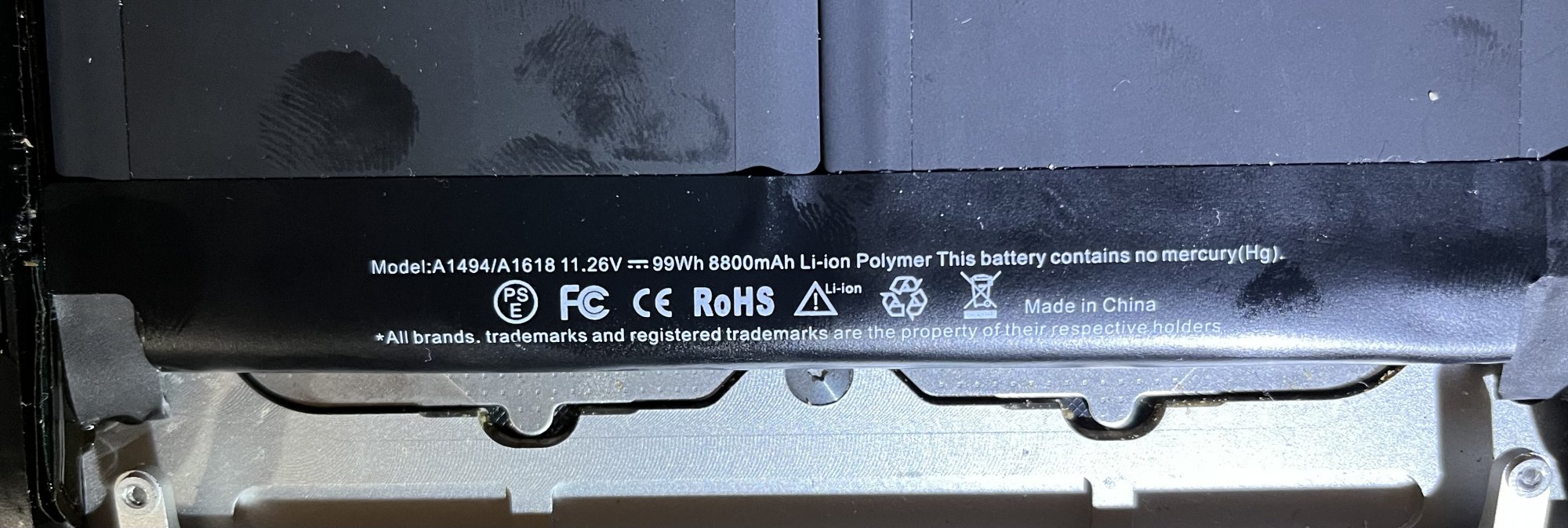

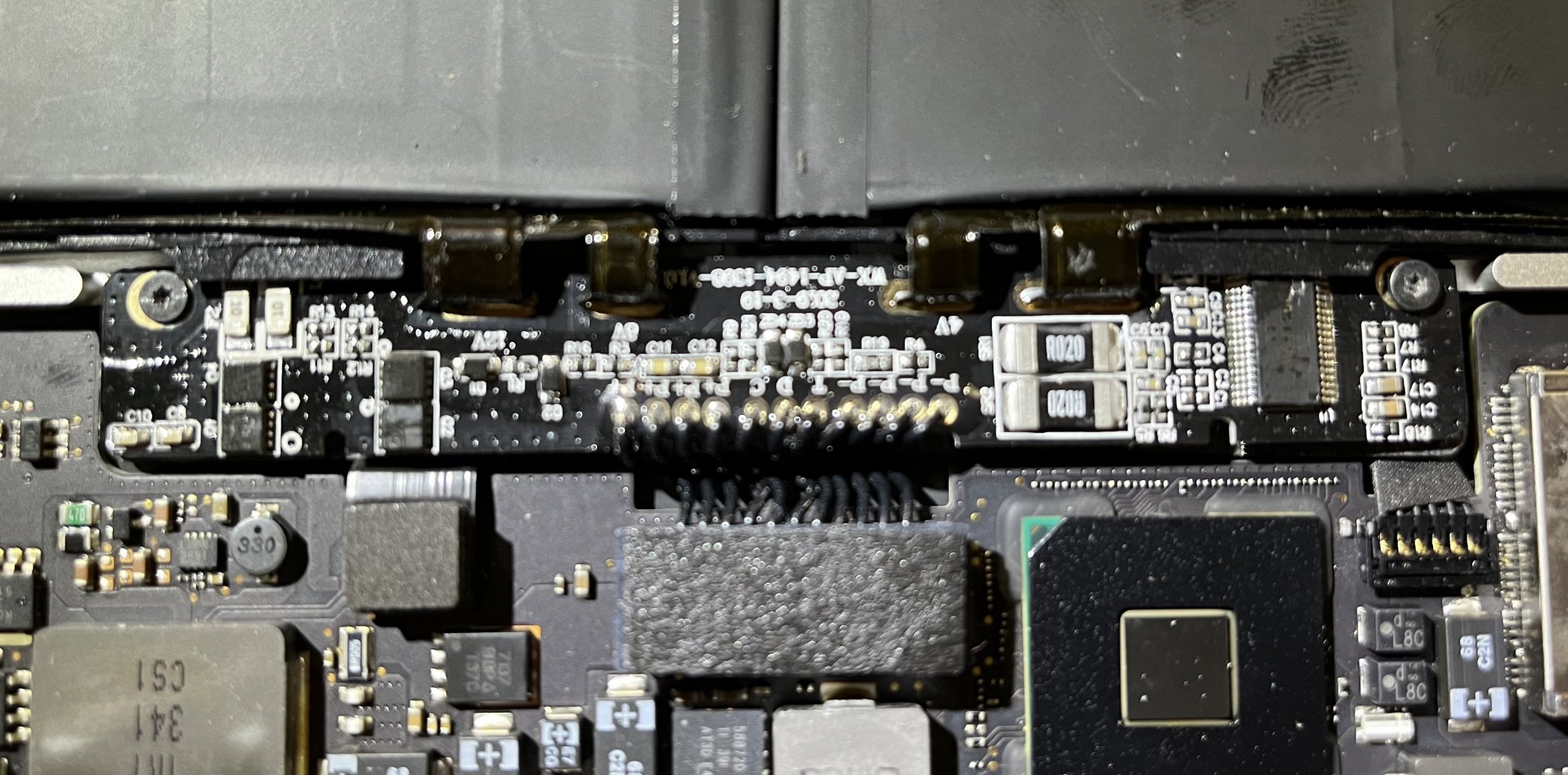

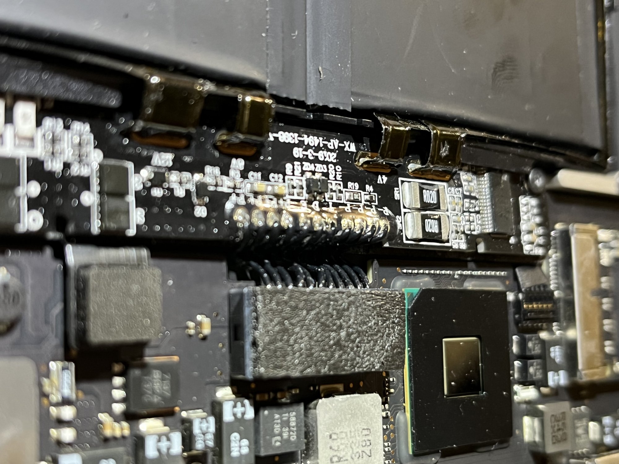

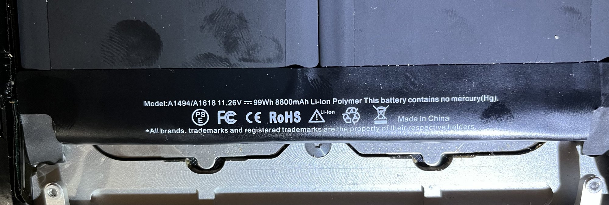

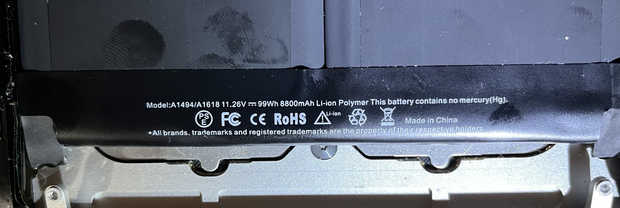

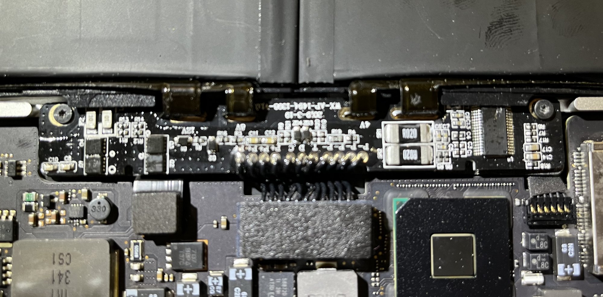

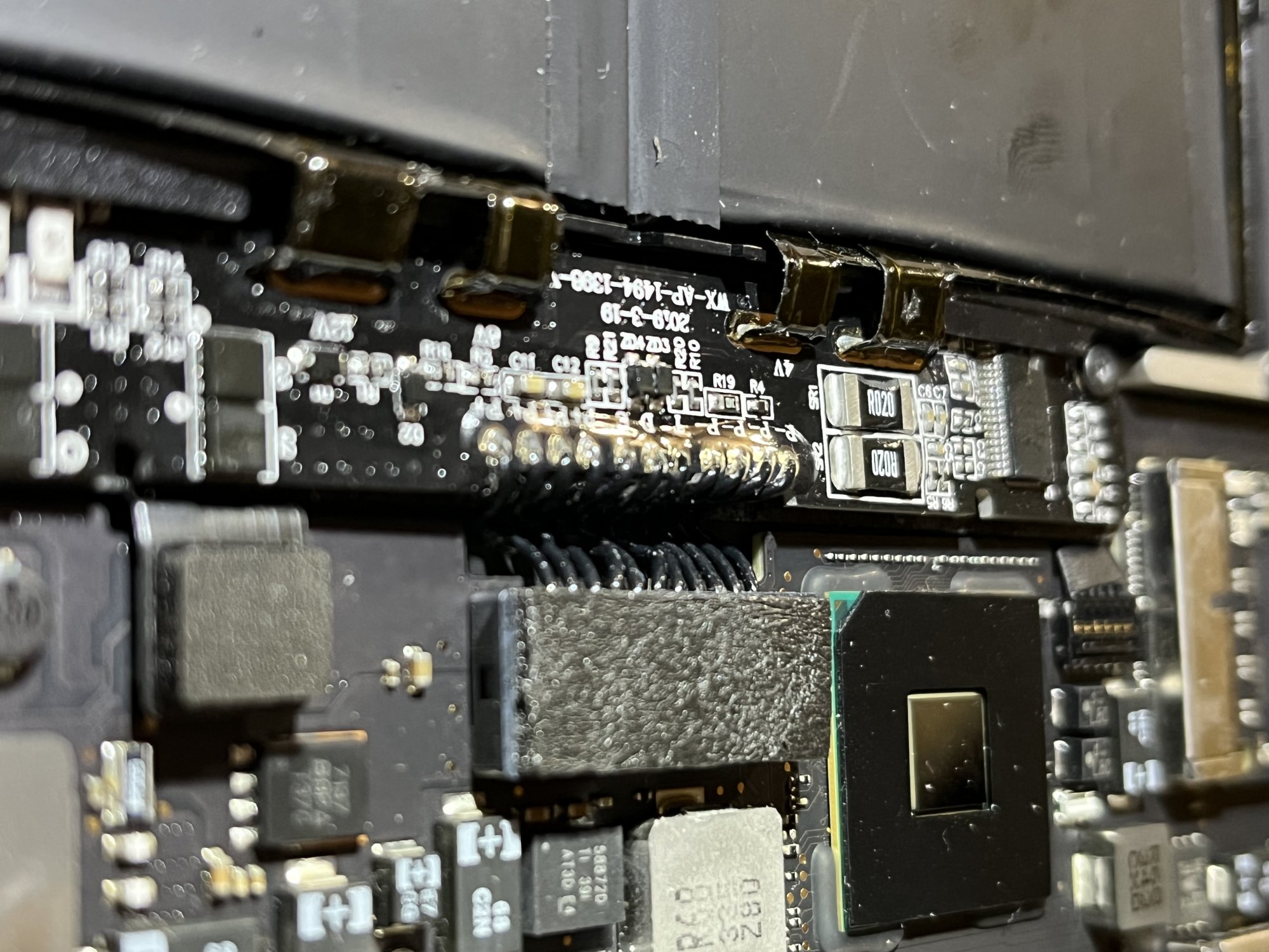

ok I finally can open to check it, here’s some pics of the new battery. I don’t see anything with corrosion or something like that but I don’t remove the MagSafe port due I need remove the whole motherboard ect.

The only thing that I think of it rest is that the battery is defective. This is the only chance we got right now.
You tried everything, and the problem seems like it is related to either the battery itself or the connector. Both options are again battery related, maybe the connector might be corrosive, we are not sure.
If you are able to, please try another battery. Or please try to clean the connector pins, you can scratch them from surface, maybe some of the pins can not be touching each other due to a corrosion issue.

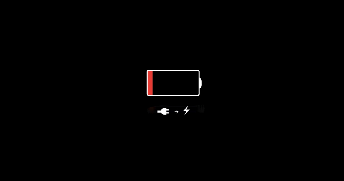

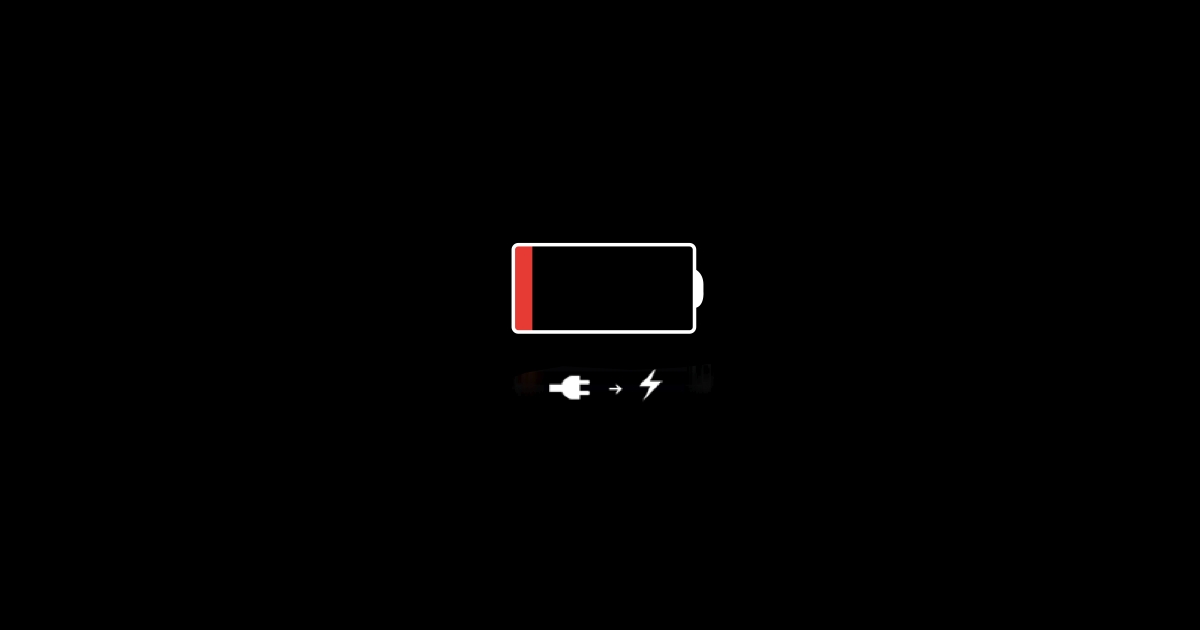

by the way, why If don't charge the battery, why the battery icon continues showing a thunder?
when I go to recovery (command + R) I see the battery on 1% with thunder icon, if the battery is faulty why still show 1% with the thunder icon?
even if I remove the charger, the damn thunder icon continues, I never see the plain battery icon with no thunder.

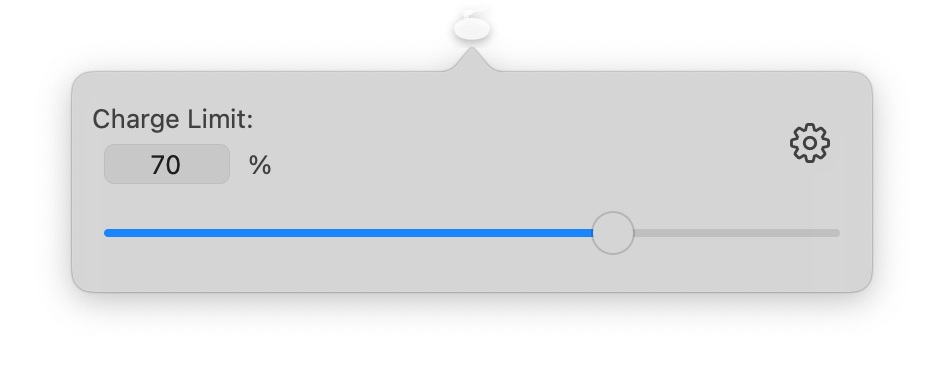

Why if I leave in 70%, the normal macos icon says still 100%? is normal? or I need down the battery from 100% to 70% and AlDente keep it at 70%?

GoztepeEge
I erase and install Big Sur, runs fine!
Yes I want use this computer at desktop, possibly not move it from the desk, so I install AlDente, so I keep it at 70%, is ok?
I see other advanced features not work on this machine, but I think the basic is enough.
That is right. Set it to a level where you want it to sit at (e.g. 70%), then drop your battery to a level lower than your determined level (e.g. 60%), then make sure AlDente is working, plug the charger in, then it will stop once it reaches to the determined level (70%). That is all, simple.
The other features are actually no needed, they are not really "helpful" and necessary.
I am right now keeping my device at 50% all the time, as I always keep it on my desk. I do not need to charge it more, so I just keep it at 50%.
You can keep your charge level in between 40% and 80%, this is the most stable region. The best option is to keep it at 50%, which is in the middle.
But as you said, you can also keep it at 70%, meaning that whenever you need your laptop to take away, it will be ready with its 70% charged battery.
cool and clear! I'll down it right now to 70% to test, later I'll go to 50%.
thank you again!!!
