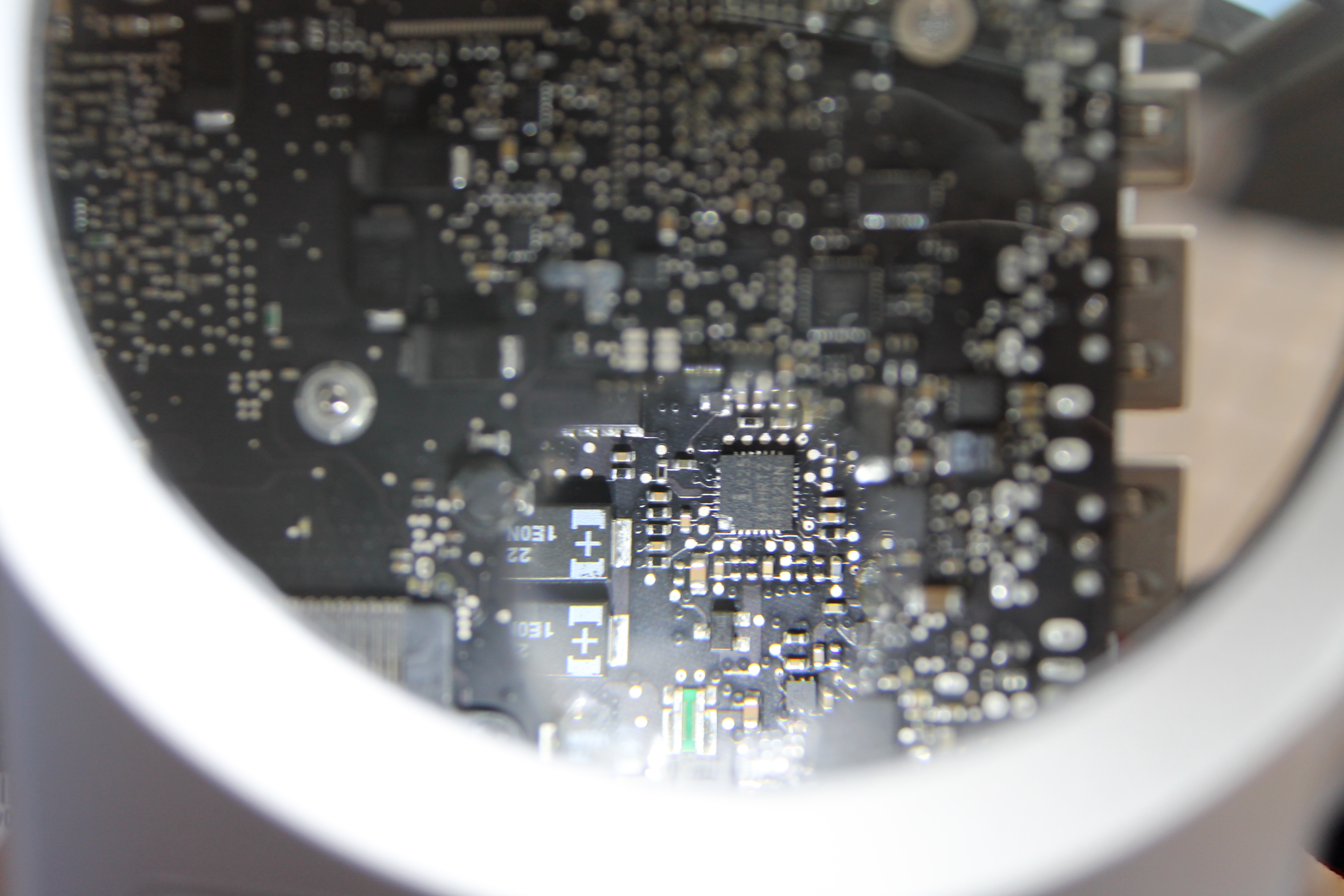

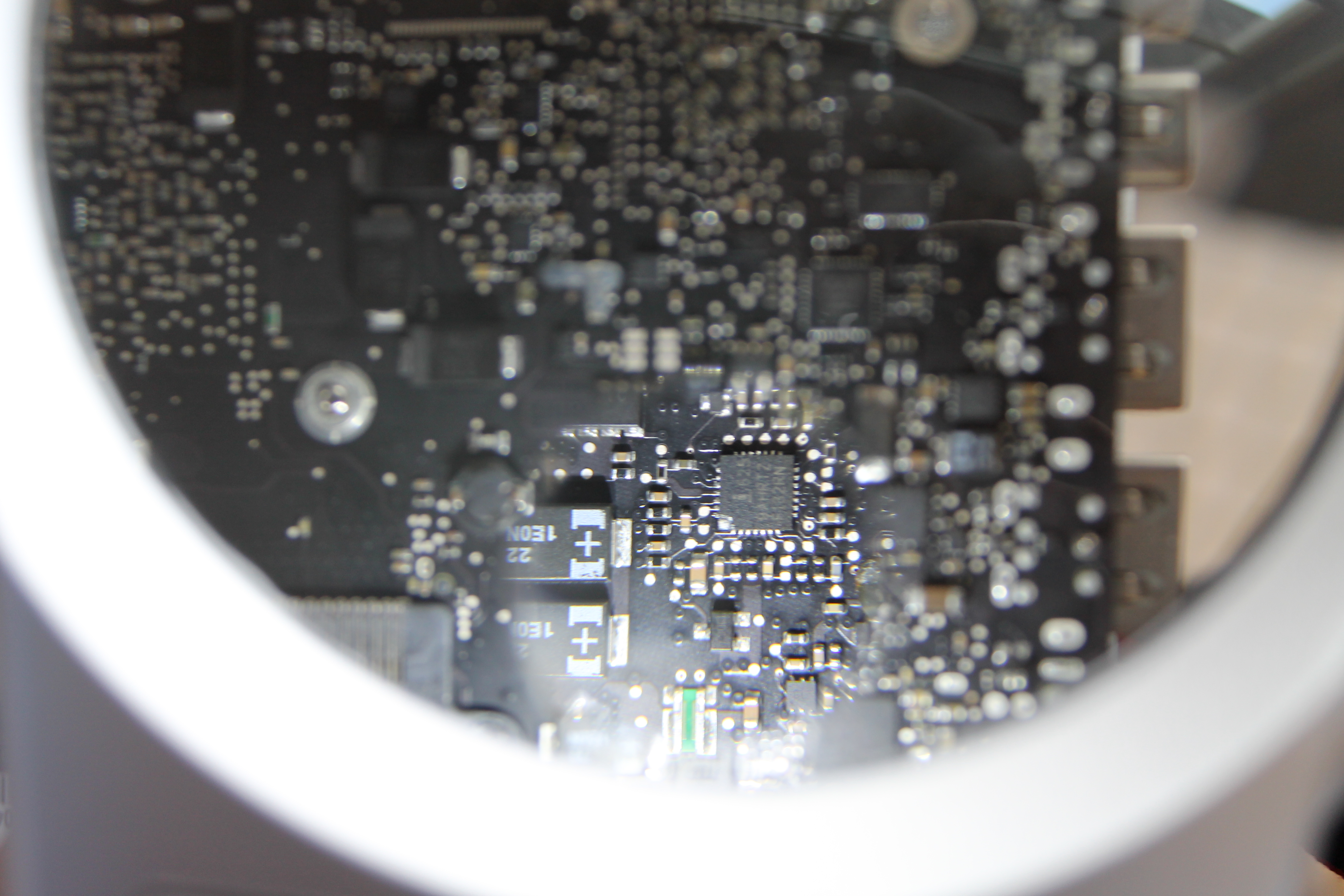

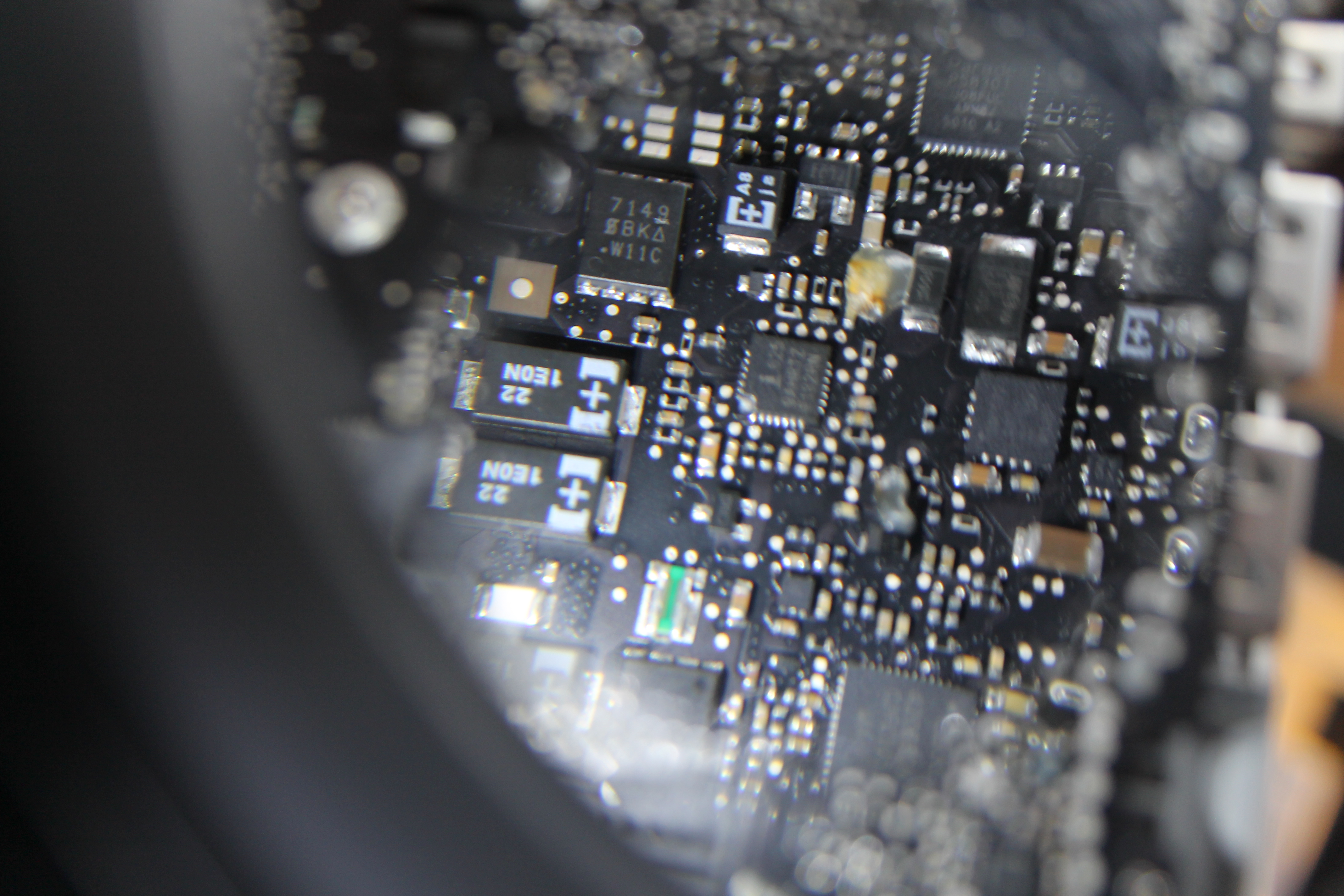

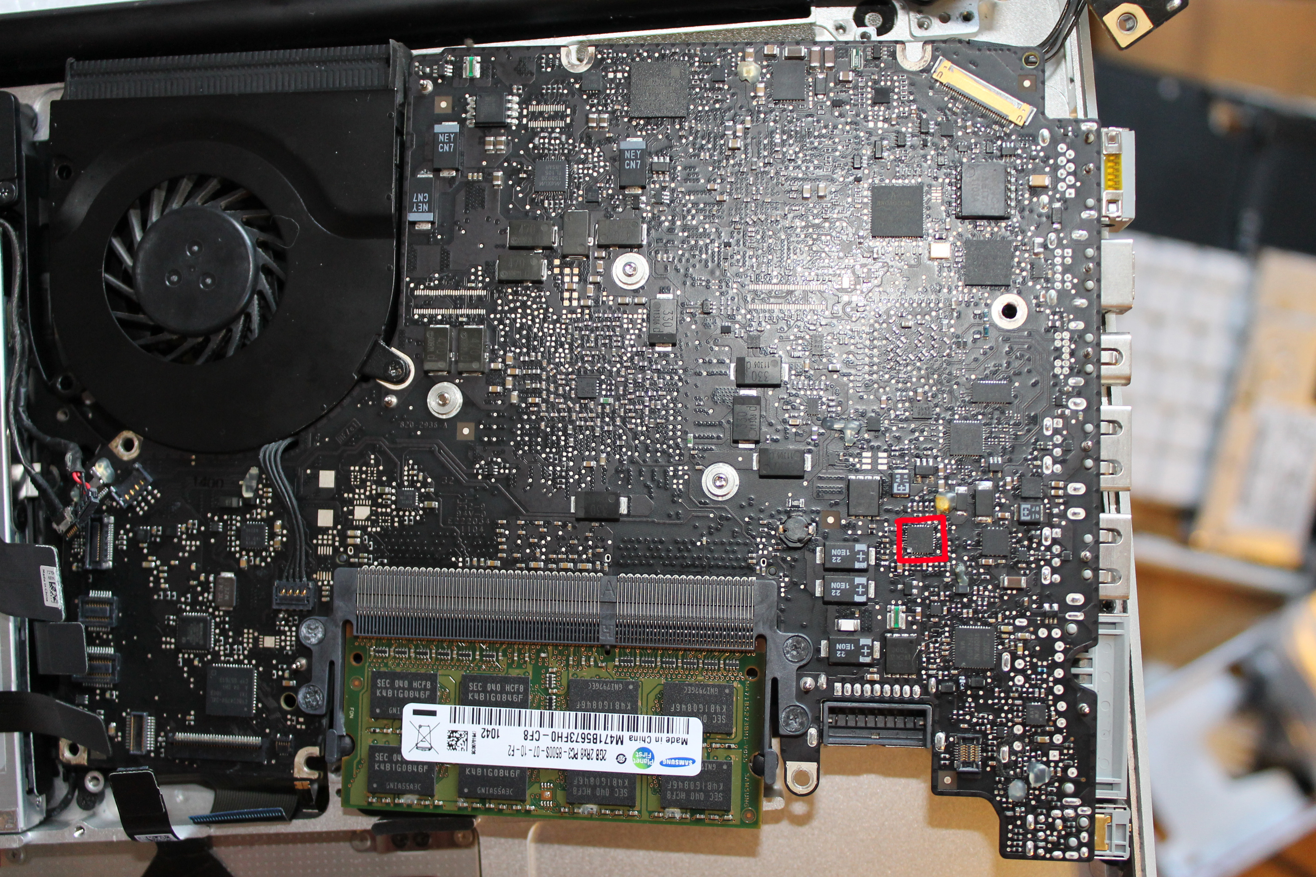

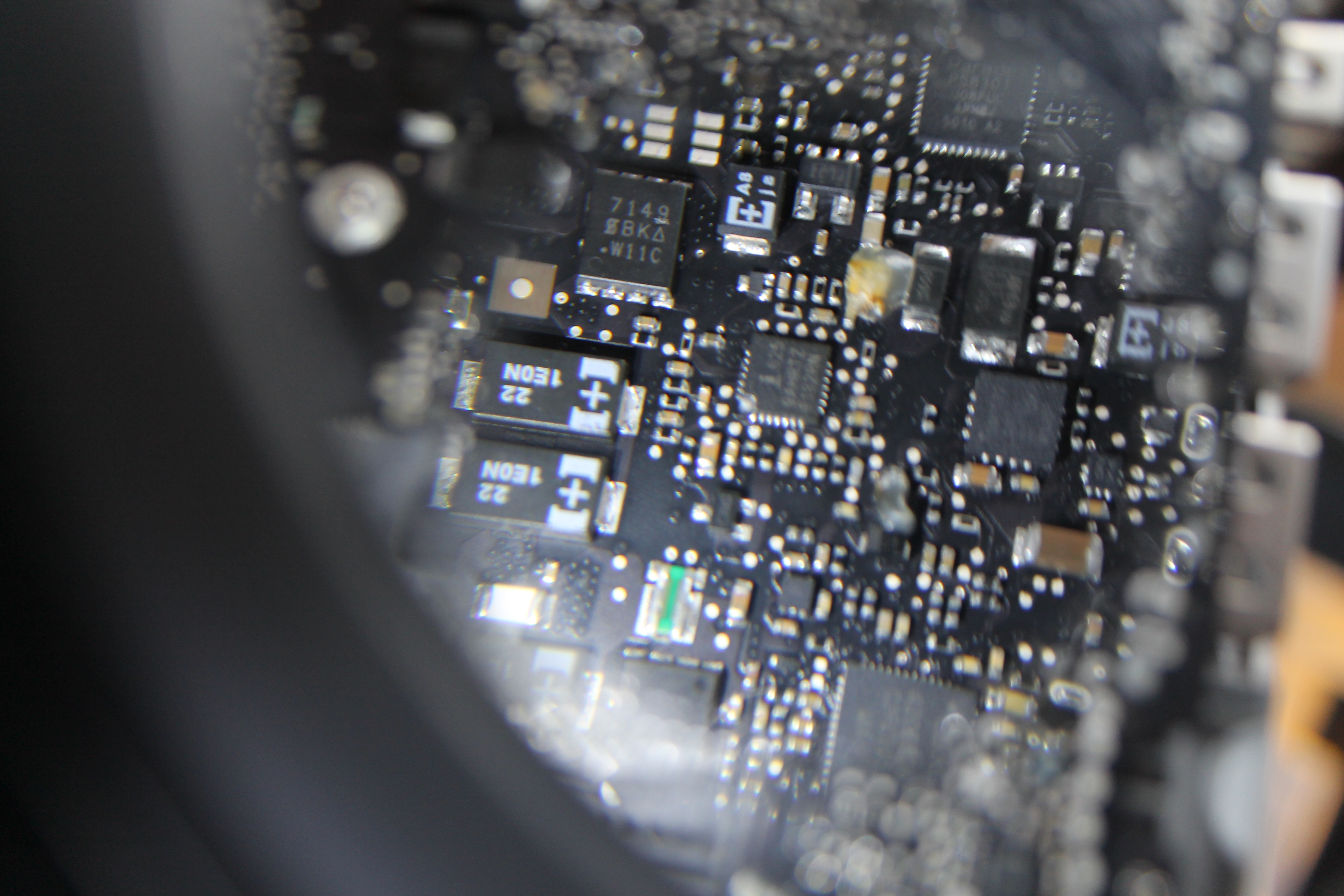

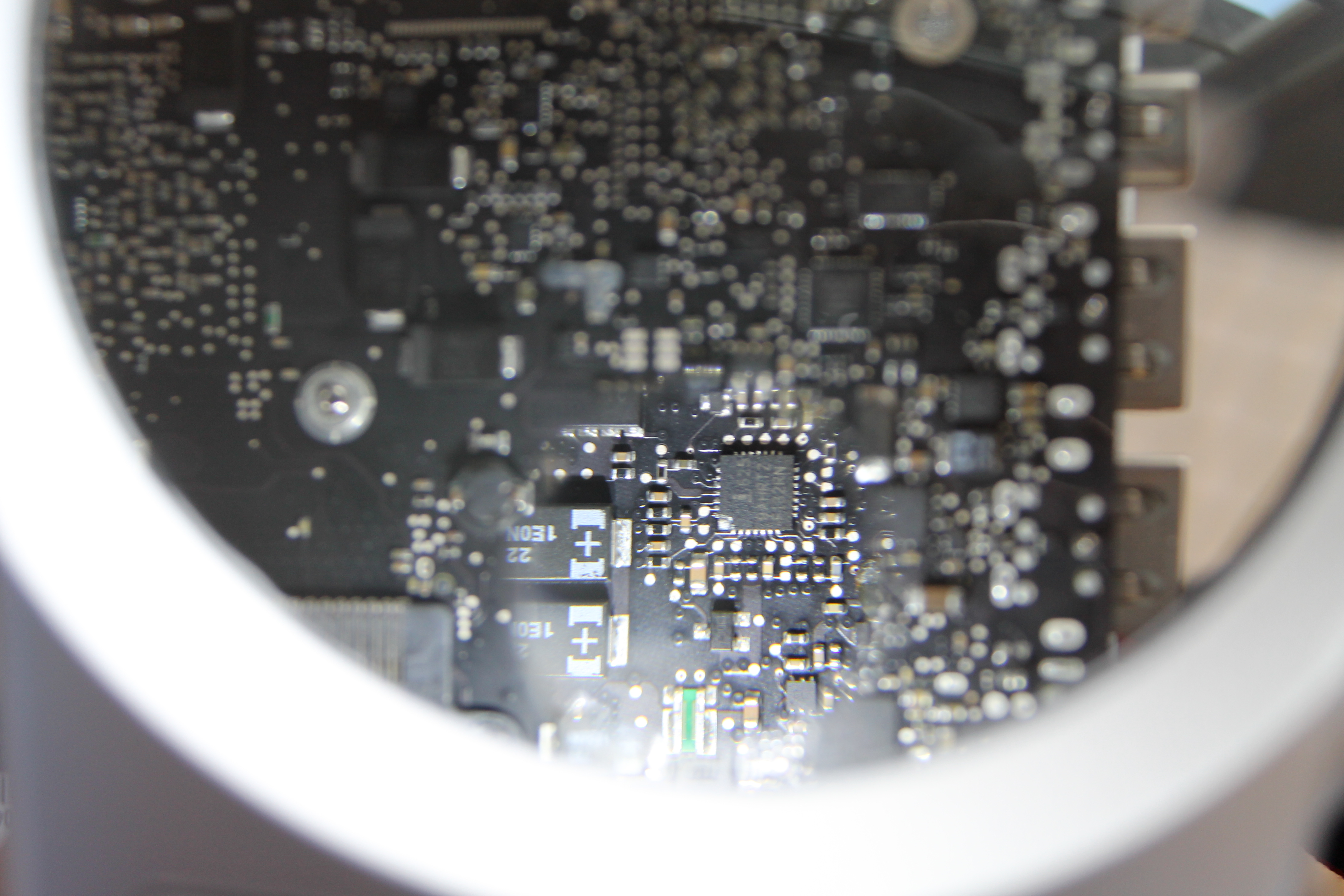

hey there this is an awesome thread, I see theres alot of knowledgable peeps in here so I figured id ask, Ive gotta 13" 2011 MBP and battery icon has the X over it and computer only works when plugged into magsafe. Ive been reading alllllll over and not seeing to much on what part to test on logic board and what part controls the battery being charged (that may be blown/broke), the battery is fine, charges in other computers, and Im very positive its not a simple magsafe fix or new battery like you hear a lot, I have the multimeter out but I really dont know what part controls the battery and what volts to look for, Ive done all the SMC resets etc. n nothing happened and tonight I discovered, as soon as you plug the mac in, it turns on by itself and light ALWAYS stays green, mac works fine, when you unplug magsafe, display goes black but computer stays on, fans, LED in the front is on but no response to waking up, I dont get it, its not charging the battery but when its unplugged it will stay running, you also CANNOT start it from the battery alone, only when its plugged in. If anyone can help id really appreciate it, Im a newb to fixing these things and would love to learn about them but theres not much info out there on certain things. Thanks.
Ive done some testing tonight and it seems I have power down at the battery and other areas, but as I was sitting there not touching anything at all, I watched the magsafe light go from bright ass green to dim green then nothing at all, you can see verrrry faint green if you look hard in the dark, but Ive never seen a mac do that before, now the mac wont turn on at all, great!!! Its been turning on by itself fine when plugged in, but now all the sudden I watched it slowly go out. weird, Anybody else have probs. like this? Im still reading these 100 pages, so maybe Ill find something in the mean time lol.
Ok I somehow discovered, while watching the magsafe light slowly go completely out, that this QFN package (marked i625 9AHRTZ) was EXTREMELY hot, could barely touch it, Im happy I may have found my problem, which also seems to be the "charging chip" for the macbook, which is exactly what I wanted to find, but my question is, would there possibly be a fuse before this chip that is blown or something, which is causing the QFN to get too much voltage or something? Im hoping I can replace the QFN and my charging/booting problems will be solved but I know with macbooks its probably not that simple of course. any body have any clue?
I also found this http://www.ifixit.com/Answers/View/141228/Logic+Board+Repair+625+9AHRTZ+possible

I took a used QFN off a donor board I have while I wait for the brand new ones to arrive that I ordered, which I have no paitence and probably should have just waited but everything soldered great and I got the practice in, but when I tried to power on again I could see sparks jumping across the pins on the QFN and the magsafe light was cutting on and off (green for 5 seconds, then off, then back on) Im hoping the QFN I put on was bad ass well and a brand new one will cure the problem, maybe I had cold solder joints too, Im not sure, soldering looks great to me, but you never know with these little parts.
once i had that i625 9hartz getting hot, and it wasnt bad chip but a shorted component , so before remove it, check for shorted coils.
my problem was Q7035
Thats what I figured, I thought maybe it was something before the i 625, you woudn't be able to point out in my pic. where the Q7035 is? Ill try to test around, whats the best way to test for a "short" Im very experienced with electricity and multimeters but man when it comes to computer boards Im still pretty new to it and trying to learn every way I can to test certain parts. thanks for your input.
it shoul be in the opposite side on the board.
Right underneath the i 625 ? Ill check it out, idk wut it even looks like, a rectangle fuse or something, I could swear I remember someone else saying Q7035 in these posts, Im trying to see. but yea Ill try to see if I can find something, Thanks.

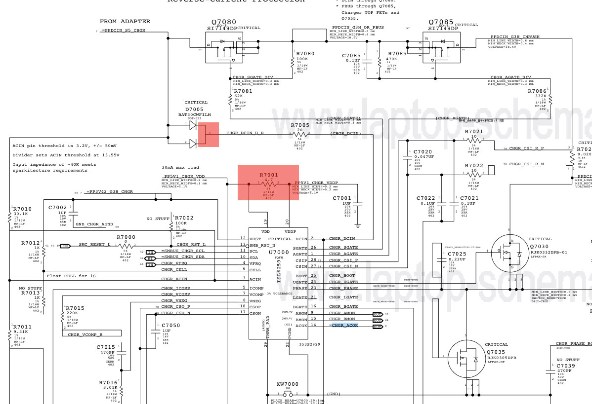

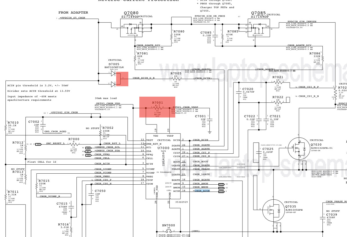

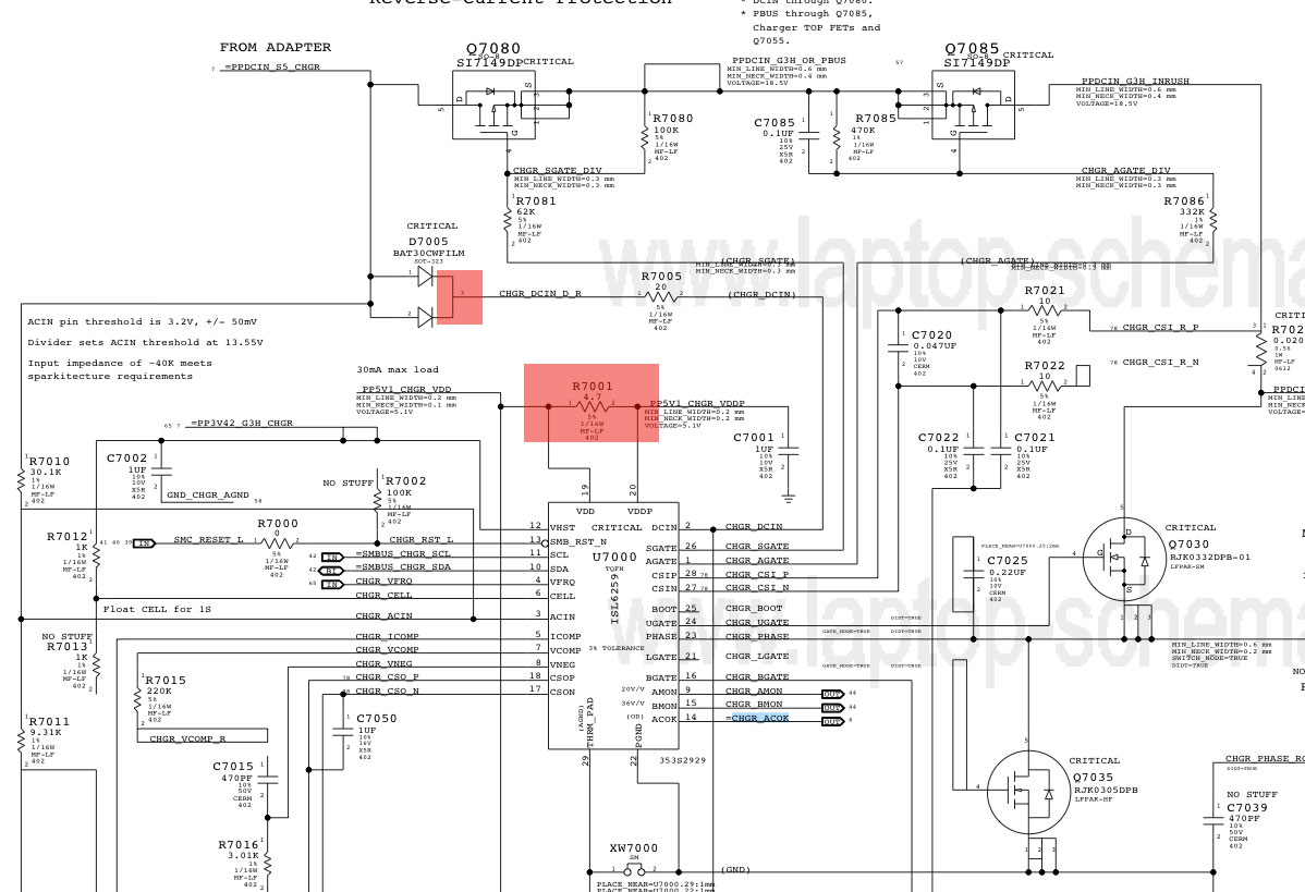

A1278 2.66 Magsafe Blink Green after replace ISL6259
Hi guys!
Now i have a A1278 2.66 2010 Board.
This board show next issue when arrived:
Power on only from Battery connected.
No green light on magsafe.
Taking some measure:
No 16v on first fuse
No g3hot
No 12v on battery fuse
It was easy to think the problem was focused on ISL6259.
After take out and charger connected have green light on magsafe and 3.42v present on g3hot.
Now i just installed new ISL6259 ( NEW)
Green light magsafe is blinking all time.
I measured pin 14 and i dont have 3.3v
Im very lost now. Before replace ISL6259 i measured some pins to ground and found some shorts. Same short in D7005.
With new ISL installed, shorts has been disappeared.
I add schematic image. Thanks!!
