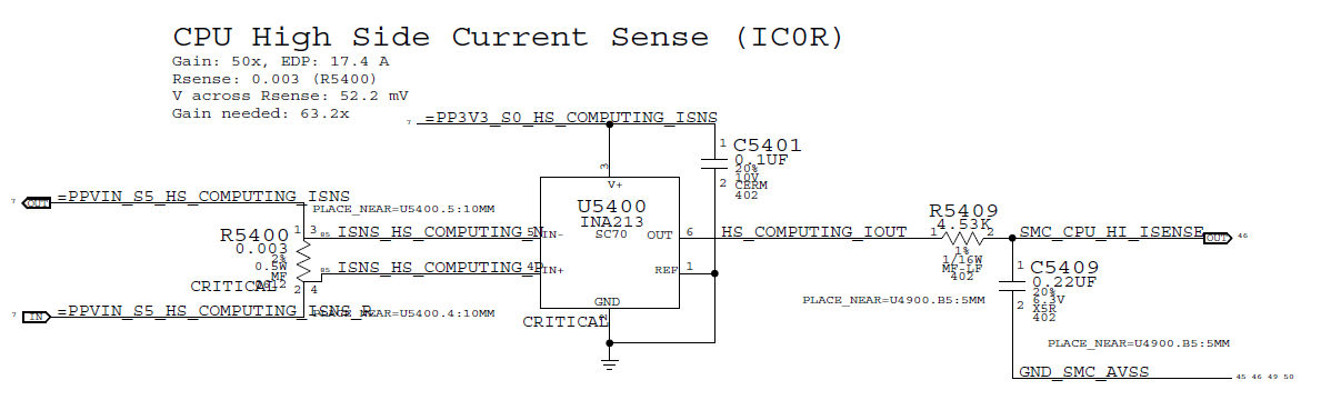

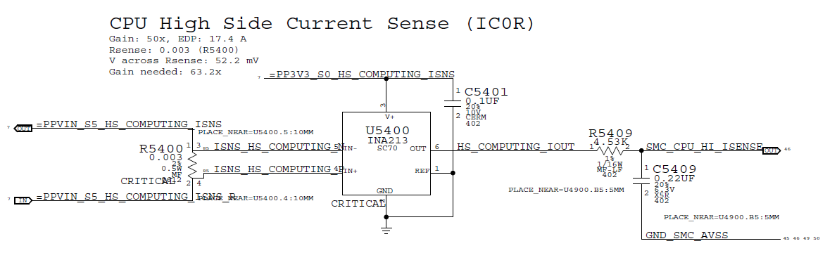

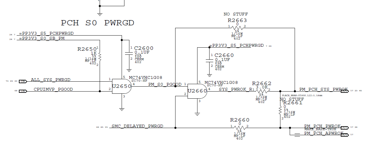

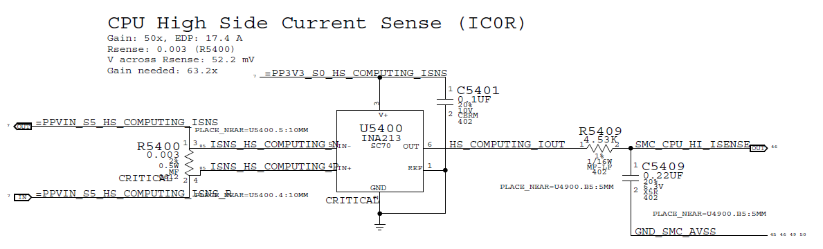

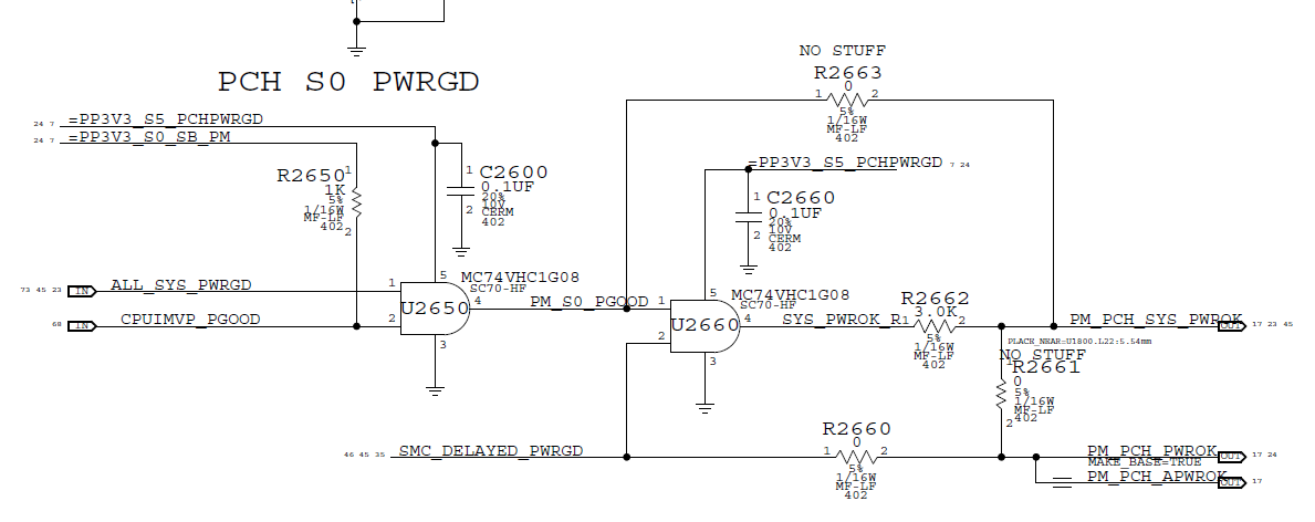

That signal appears to be called PM_PCH_PWROK (not PM_PCH_PWRGD) on my schematic revision (see attached image). Regardless, this signal measures TRUE (well, ~3.4V, a little high but perhaps it's not being driven by a typical logic driver?). PM_PCH_SYS_PWROK also measures TRUE at 3.3V.
Speaking of bad sensors and the SMC - you might recall from my original post that I replaced R5400, the CPU high side current sense resistor, because it had some corrosion on it and was slightly damaged in the process of cleaning it. I decided to go ahead and measure the output of the accompanying current sense monitor IC (U5400) and only got ~0.56V, indicating much lower current than the schematic indicates should be present (see attached image). Then I realized that I had replaced R5400 with a 5mOhm resistor, not a 3mOhm resistor. This is because the other schematics that I had seen before getting the correct one for my board (820-3115) had R5400 as 5mOhm. I'm not quite sure what affect this can have on the current sensing, but this may be what is causing the SMC to be unhappy - seemingly low current on the CPU high side voltage...
Thoughts?
Thoughts?
Hi BCC777,
A higher value resistor would give a higher voltage drop thus a higher current reading, I would expect. Did you buy more than one resistor? You could parallel 2 up to give 2.5mOhm - closer than 5, to see if this is the problem. However, 560mV is nowhere near the 2.6V expected so could there be some more corrosion in this area?
Regards,
Chigwelldave.

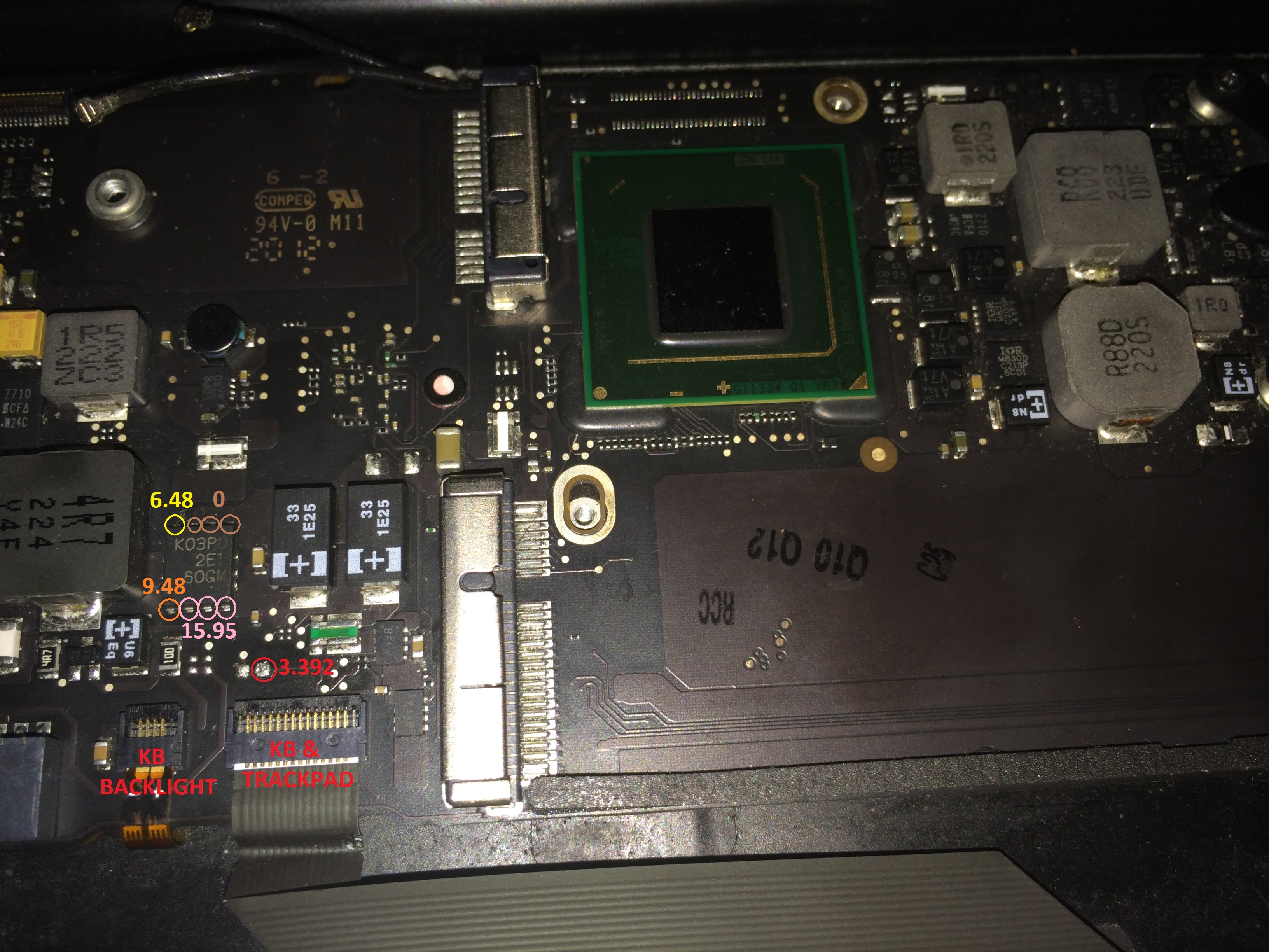

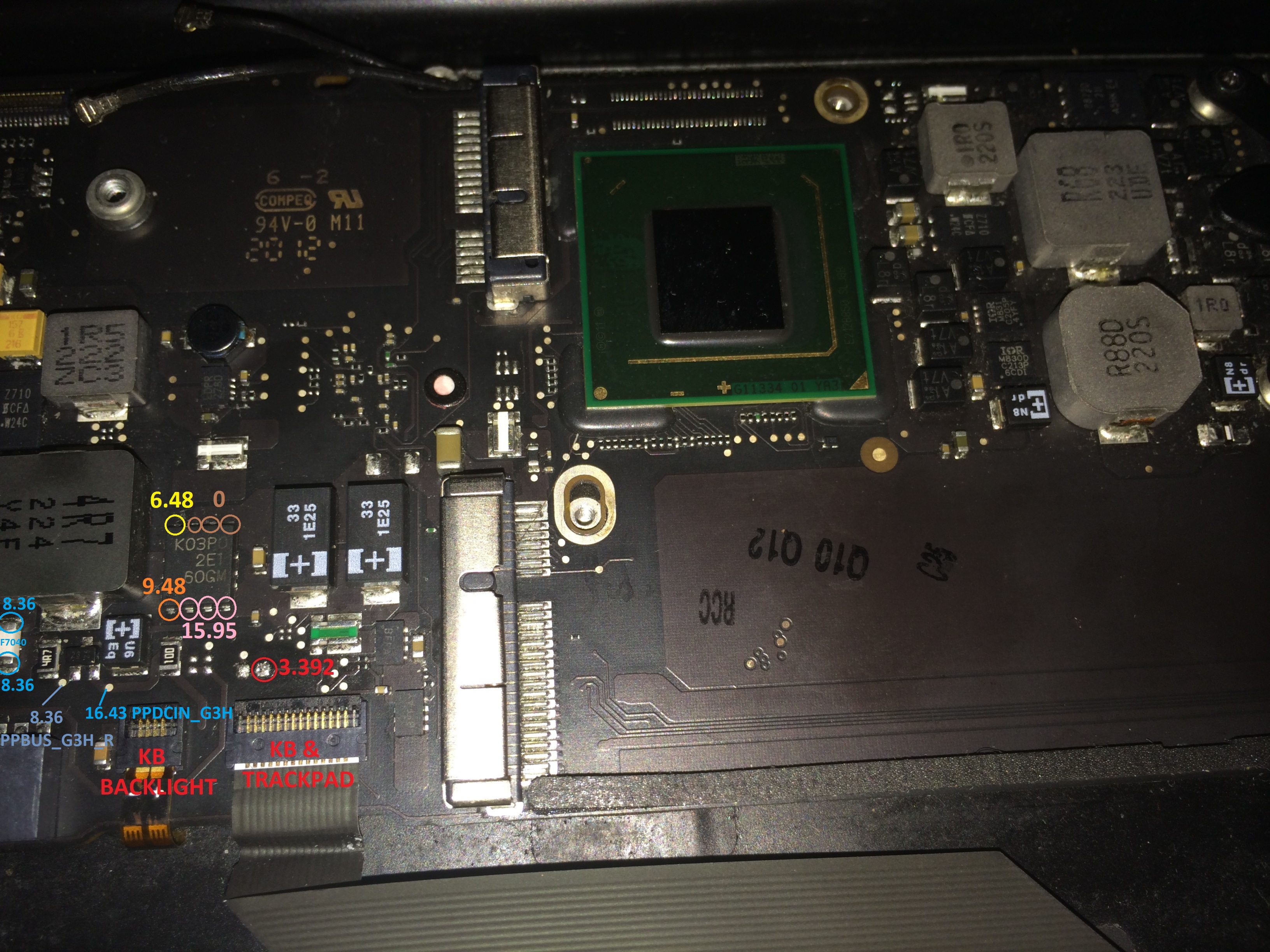

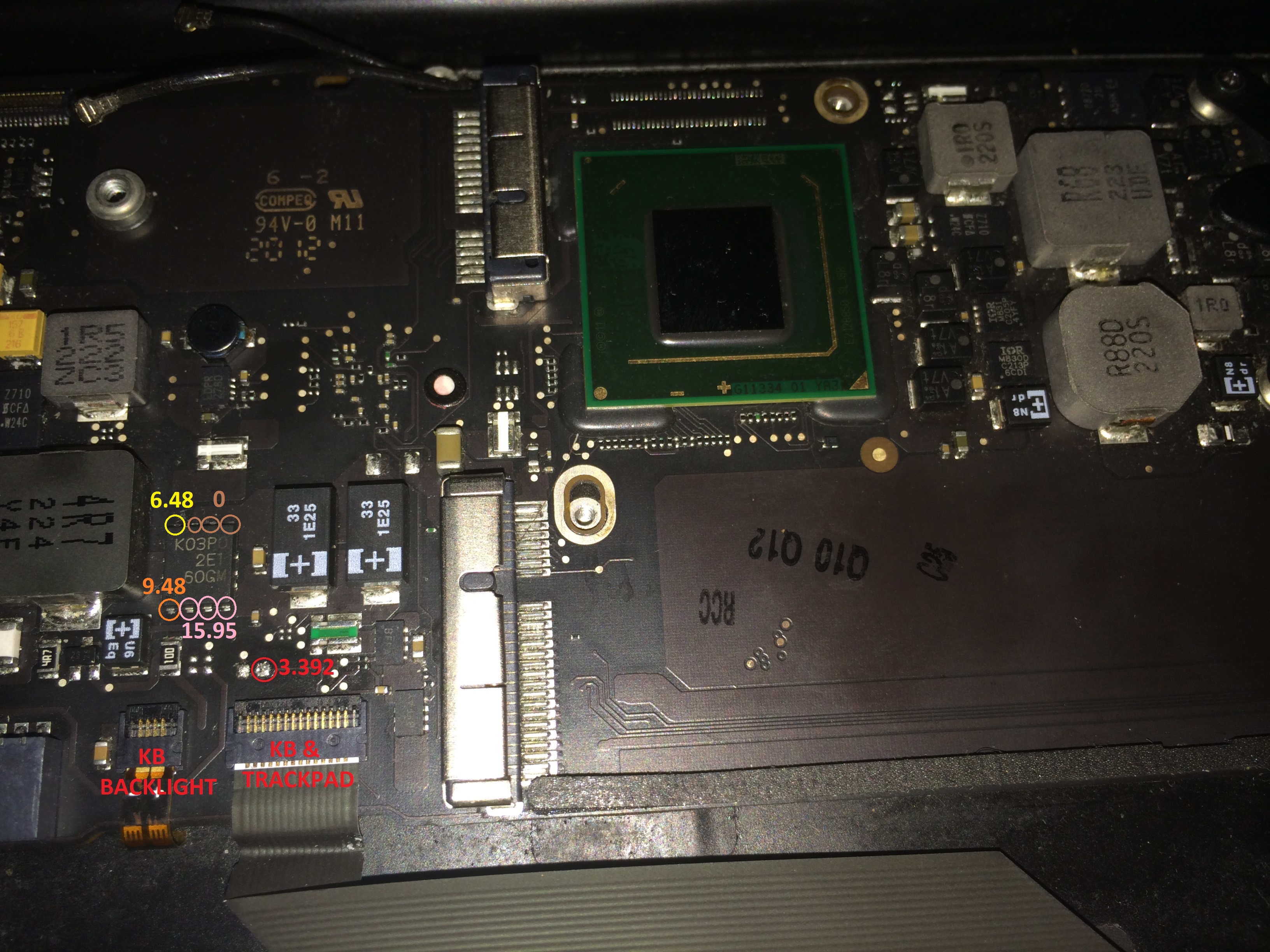

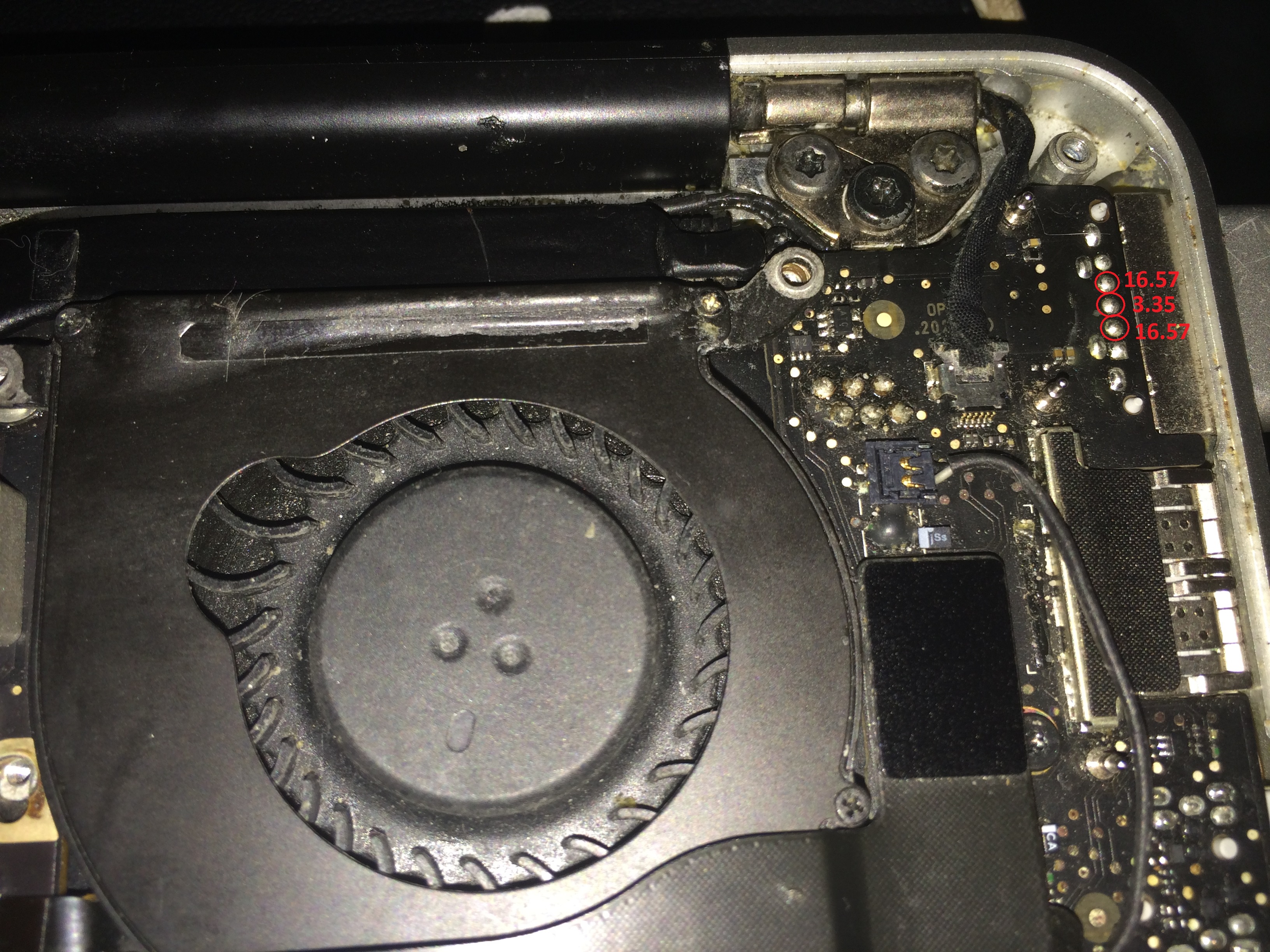

Hi,
OK this might not be the correct forum / logic board for me but looking at the knowledge people have on here, like others have said, I'm amazed! And if there is any hope for me I'm sure that it is right here.

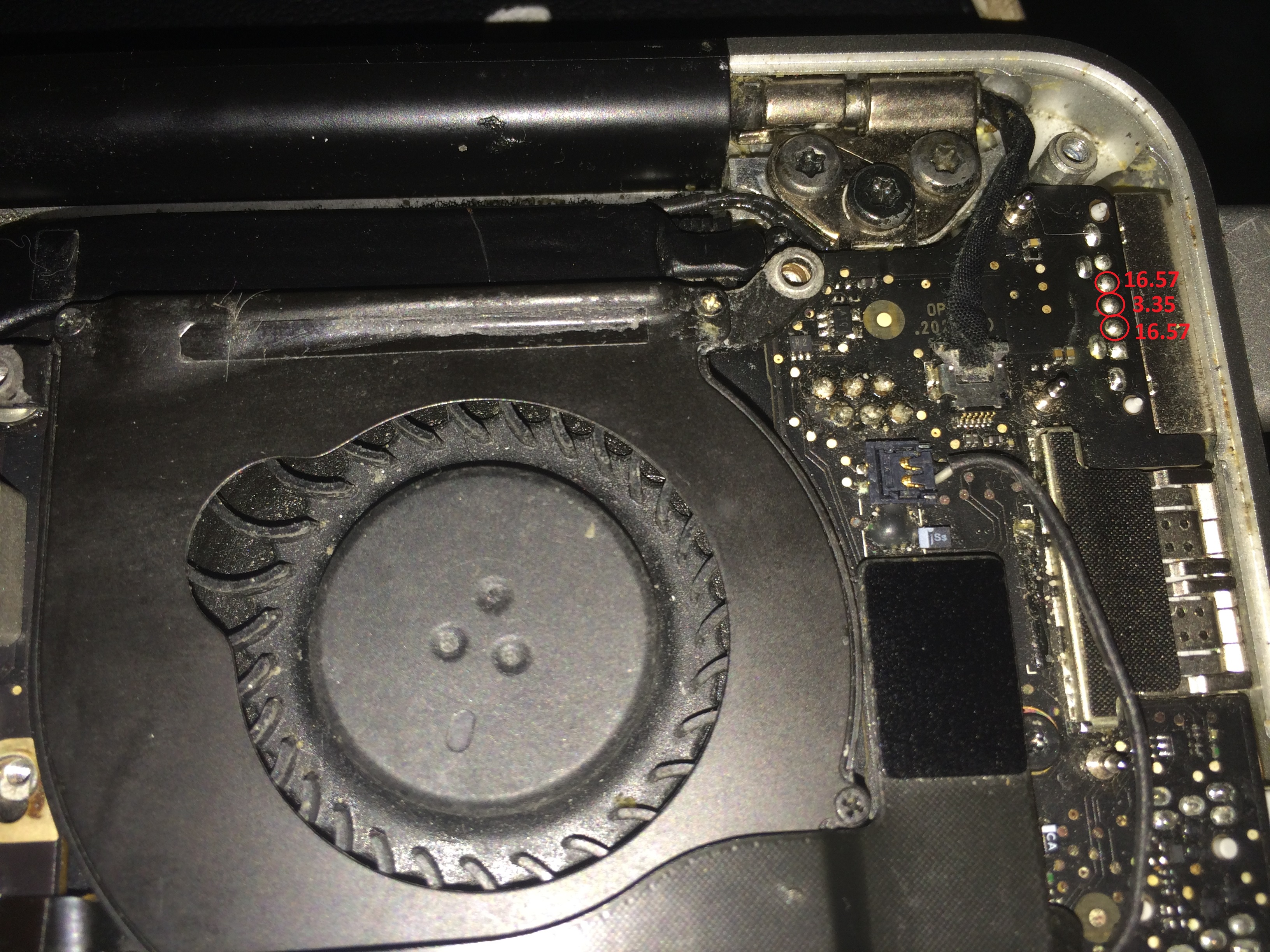

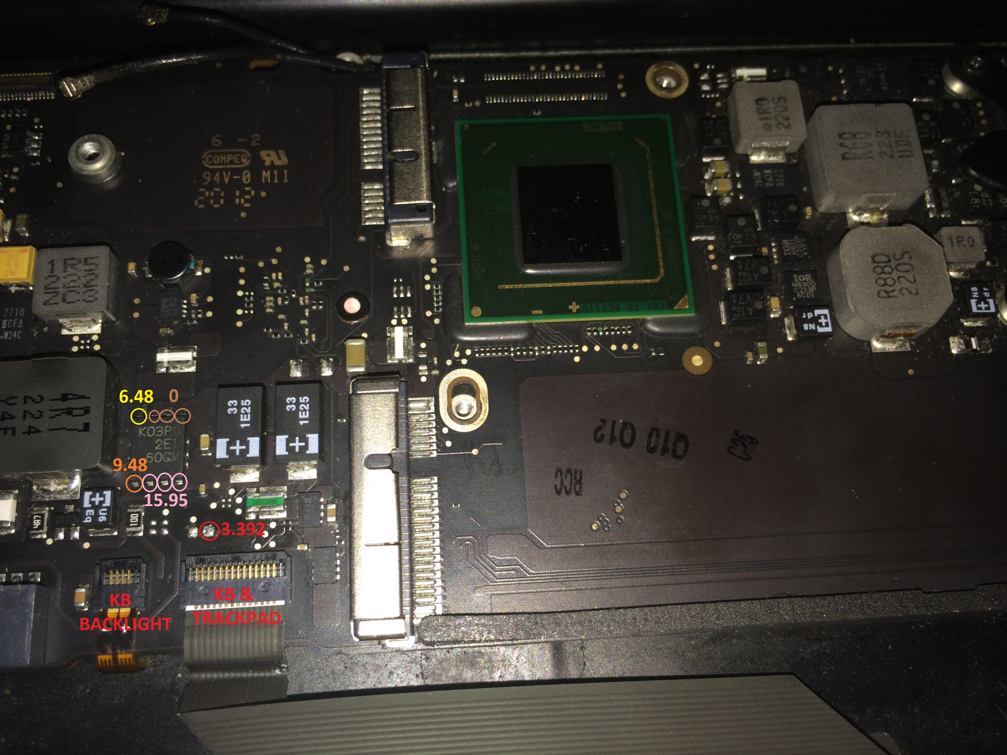

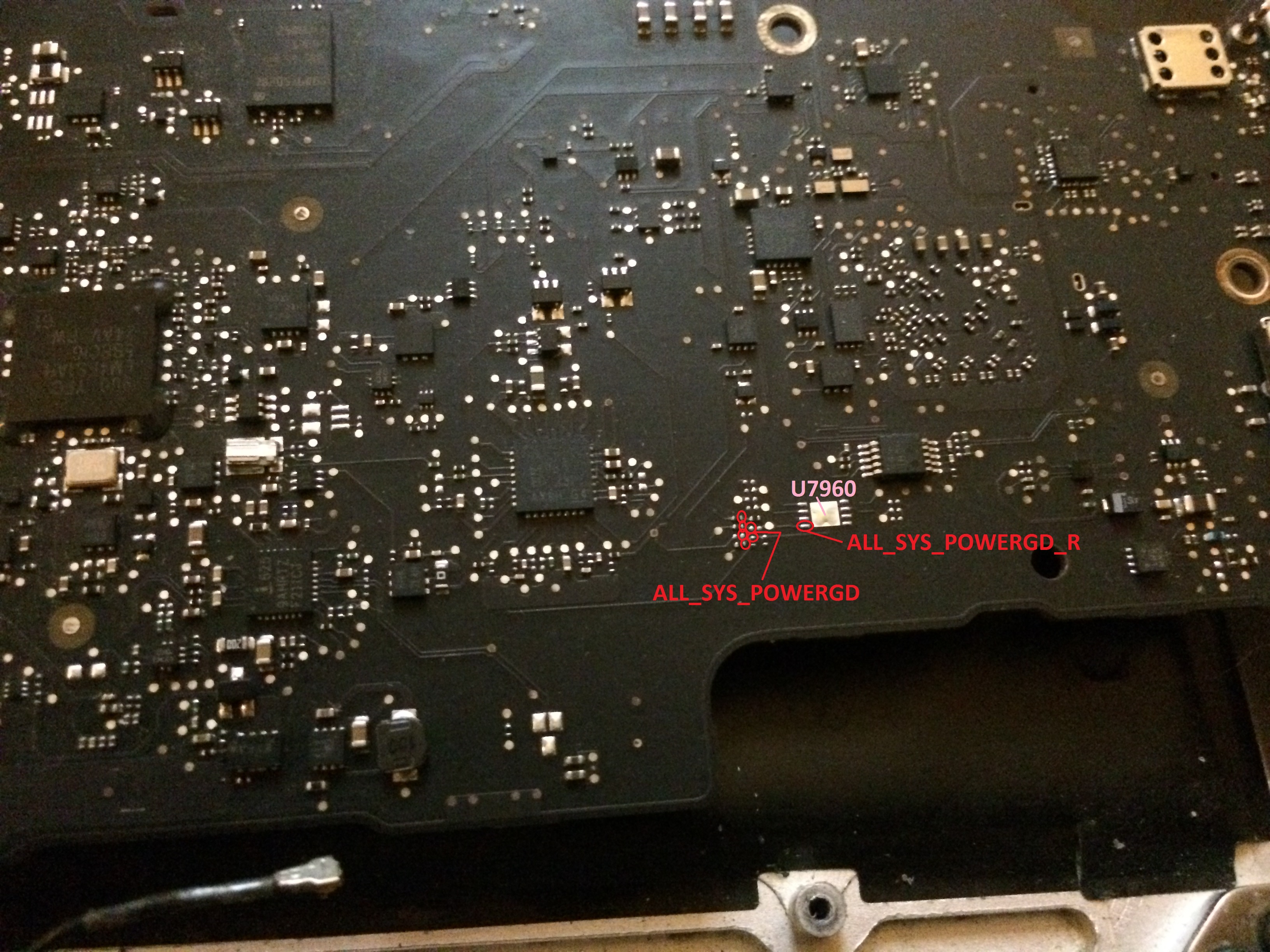

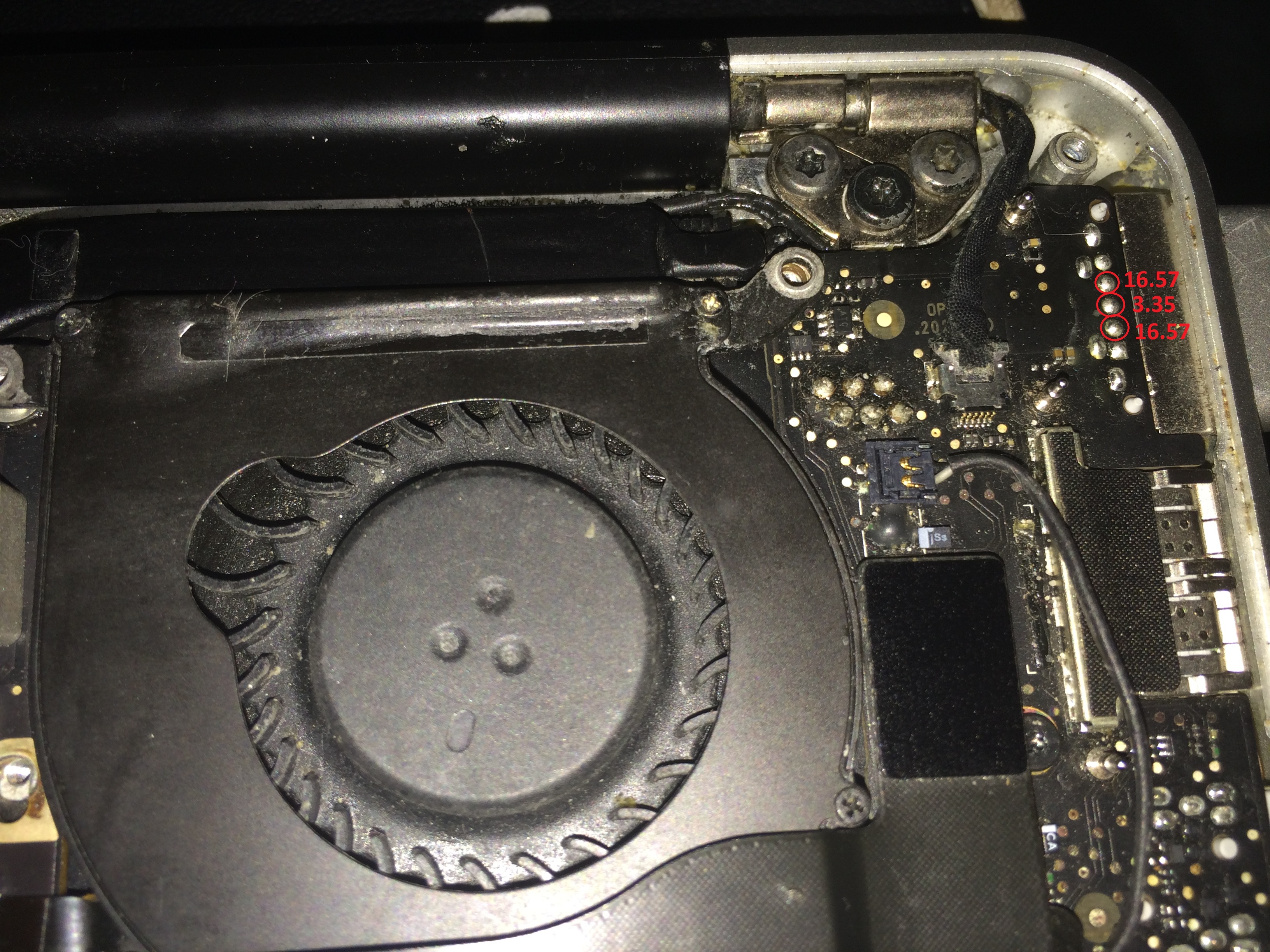

Long story short is that I bought a macbook air 2012 (A1466).
Logic board issue: No power, no fan, no chime.
No known water damage (on photo there is one of the LSI's is a little bit activated where I was cleaning a small area with alcohol & cotton swab)
Have tried (all combinations with & without SMC bypass):
  • SMC bypass - no change
  • Logic board short 2 points - no change
  • Battery out, magsafe in - no change
  • Battery in, magsafe out - no change
Magsafe shows correct light status (orange charge, green full charge) and will charge battery just fine!!
All other components (screen, keyboard, dc board, psu) are confirmed working 100%
Armed with my multimeter I've tested a few voltage points that might be of interest? See pics.
I've also attached what I believe to be the schematics for this board, with board view and this is the first time I have seen anything like this - so while I can probably get by if anyone has advise / more things for me to test then please explain things to me like a noob! 🙂
Thank you for your time!
Hi Snarf,
As you can make it boot with the SMC bypass, try booting from the service diagnostic USB drive and run the sensor and battery tests. This may help track down the problem. You will need version ASD 3S144.
Regards,
Chigwelldave.

Do you have ~9-10v on both side of F7040? Ig the battery is charging OK then at least one side of that fuse ought should be showing the 9-10v. If you get this voltage on both end, check the signal ALL_SYS_PWRGD. It should be at logic true (~3.3v).

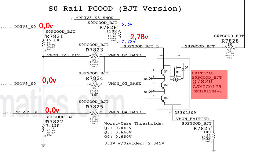

ALL_SYS_PWRGD No Power on A1278 2,4 Mhz
@CMDRDATA
Hi Boss,
I keep working on this a1278 2010 board that no power on.
3,42v present
charge battery
51125 ok
Some post before you mentioned find ALL_SYS_PWRGD.
i take some measurements.
Anyway i replace this component and no change in the board.
Do you know how to follow this line ALL_SYS ?
Need i measure from PGOOD out each Vcore component ( 51125,MCP,CPU,RAM) .
Thanks!

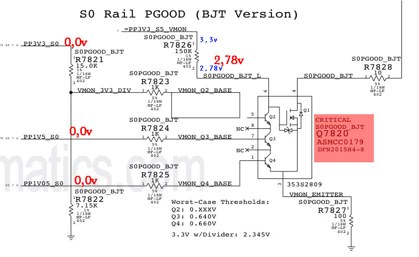

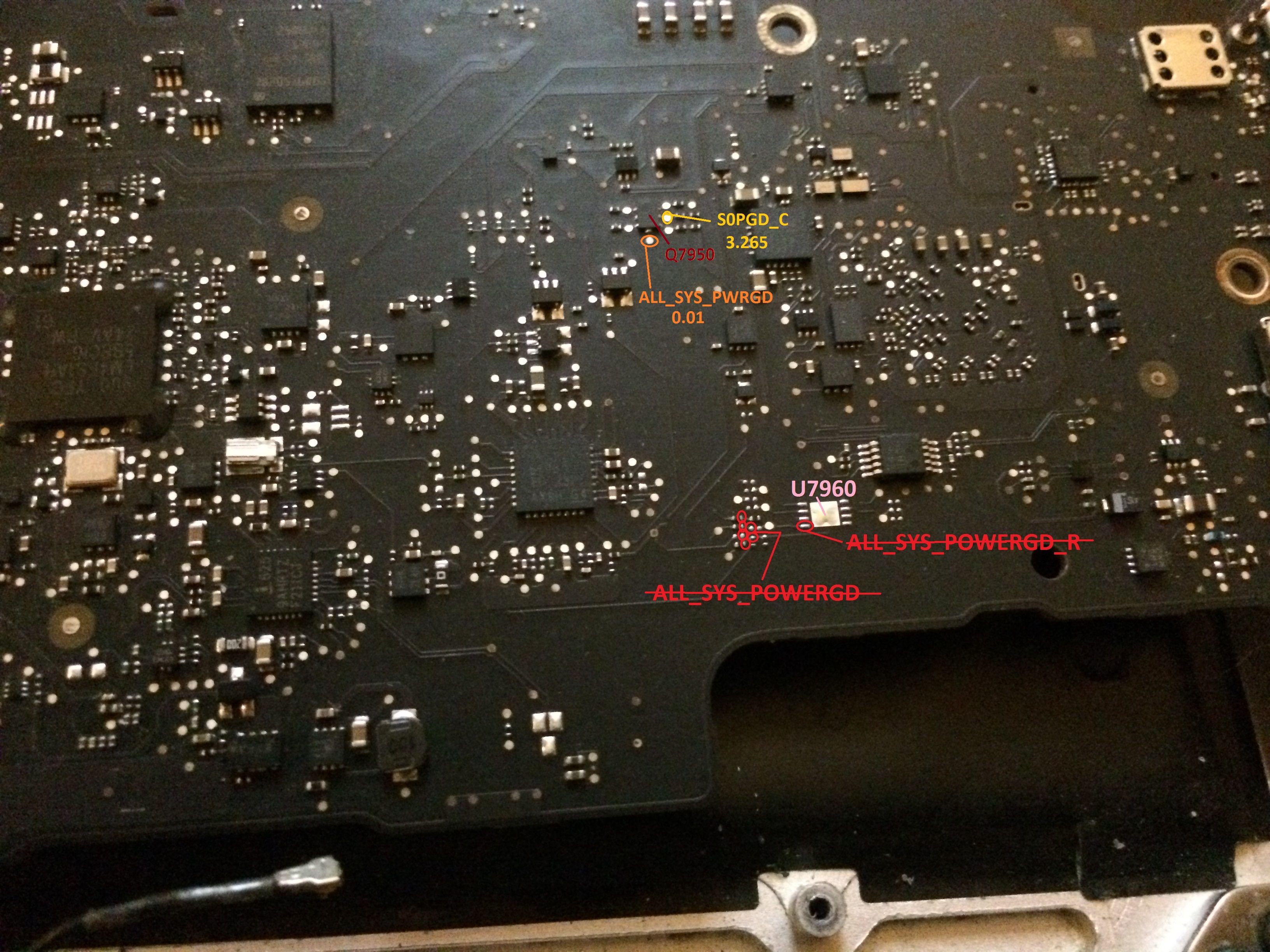

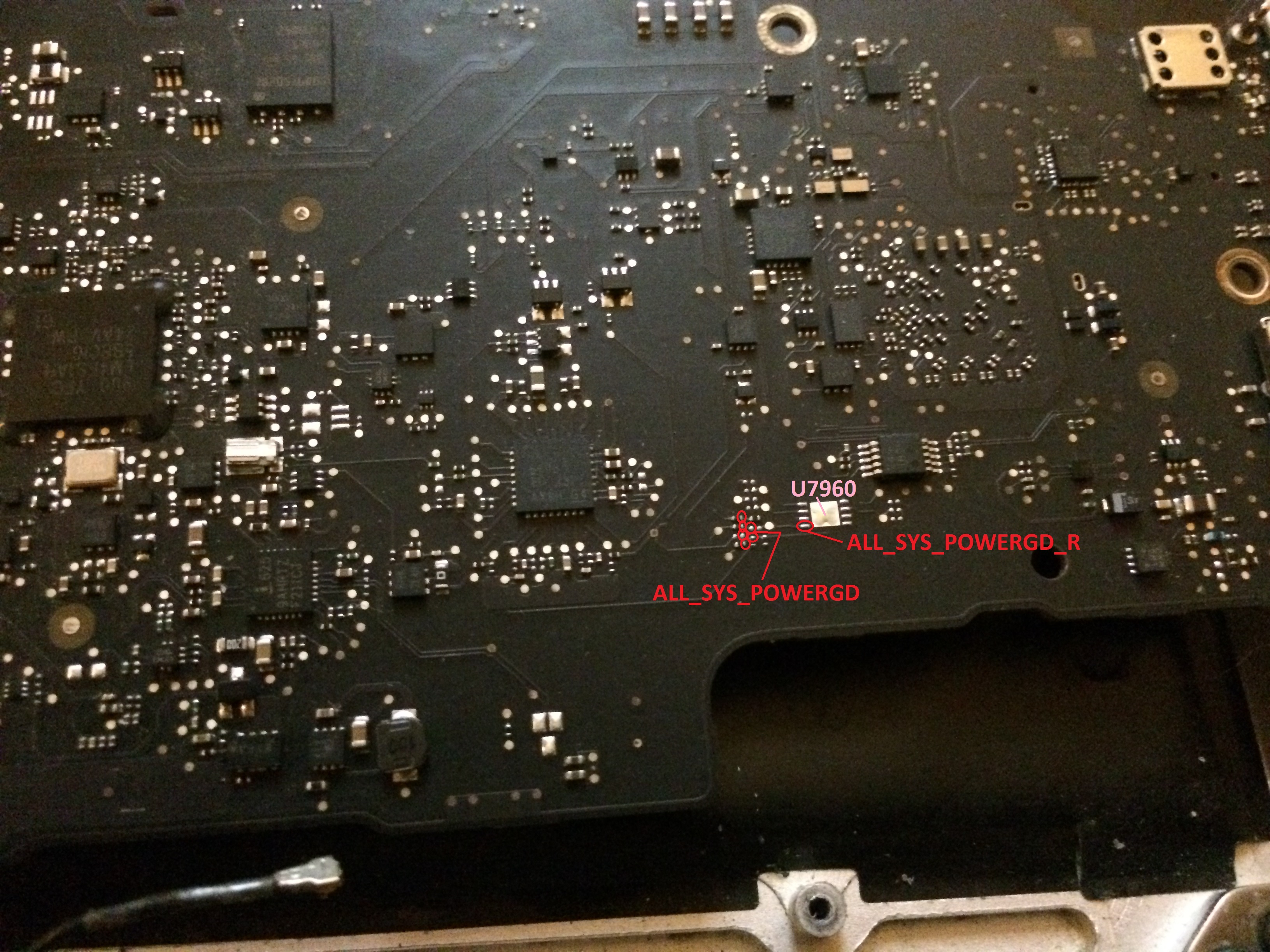

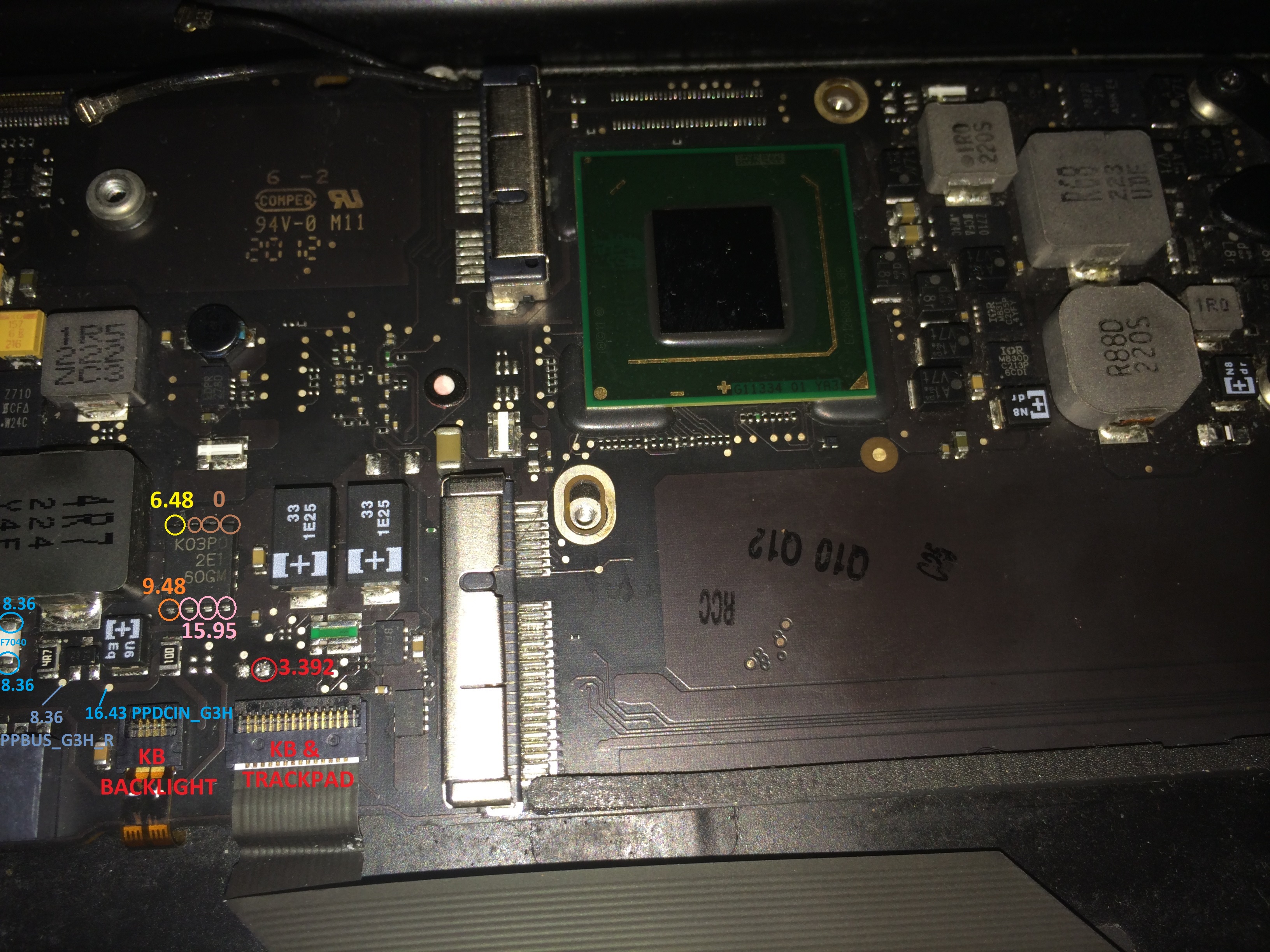

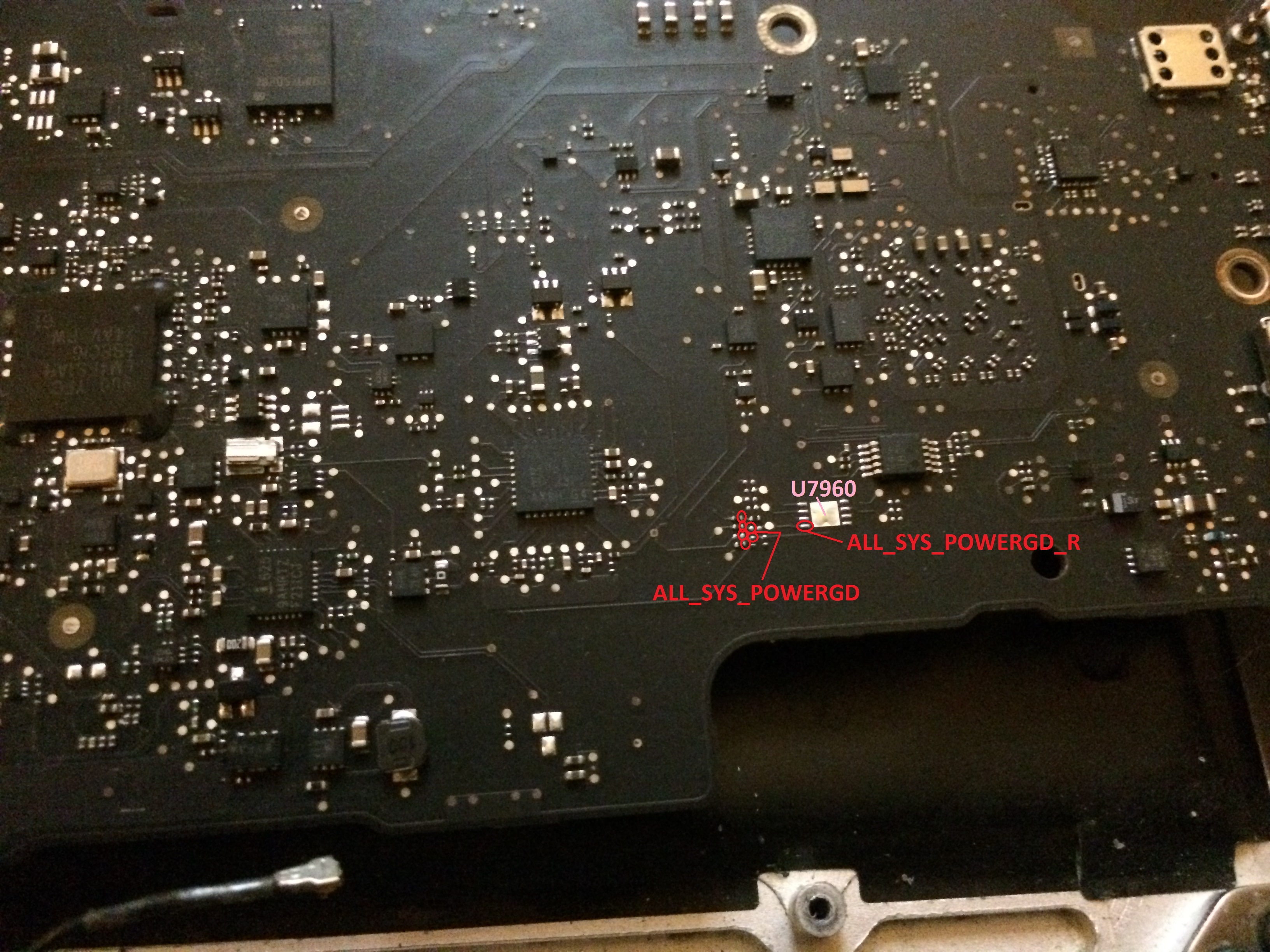

Hi cmdrdata,
So I've checked the fuse F7040, both sides read as 8.36
I think I have found ALL_SYS_POWERGD on the other side of the board. This reads at somewhere like 0.010 and appears to drain slowly to 0.000. I have tested the points (see on the photo) a few times with same results..

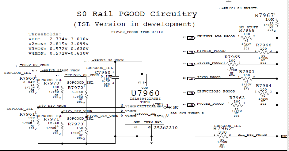

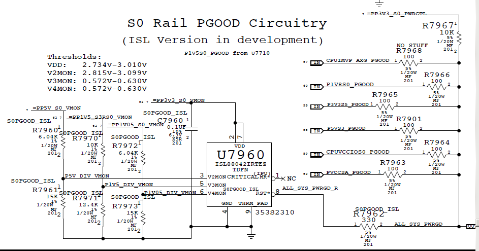

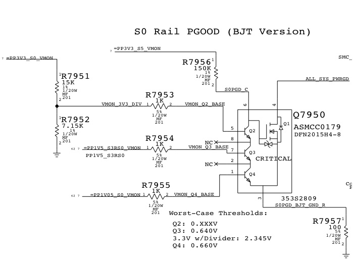

I think you are wrong.
U7960 is not in your board.
Aternative ic is Q7950 (BJT version )

Hi nicoar10,
You may want to go back a stage here and test two of your main power rails: 3V3 and 5V0. The 3V3 should be enabled early in the boot sequence (measure across C7251) and the 5V0 towards the end (measure across C7291). Both of these are well before ALL_SYS_PWRGD.
Regards,
Chigwelldave.

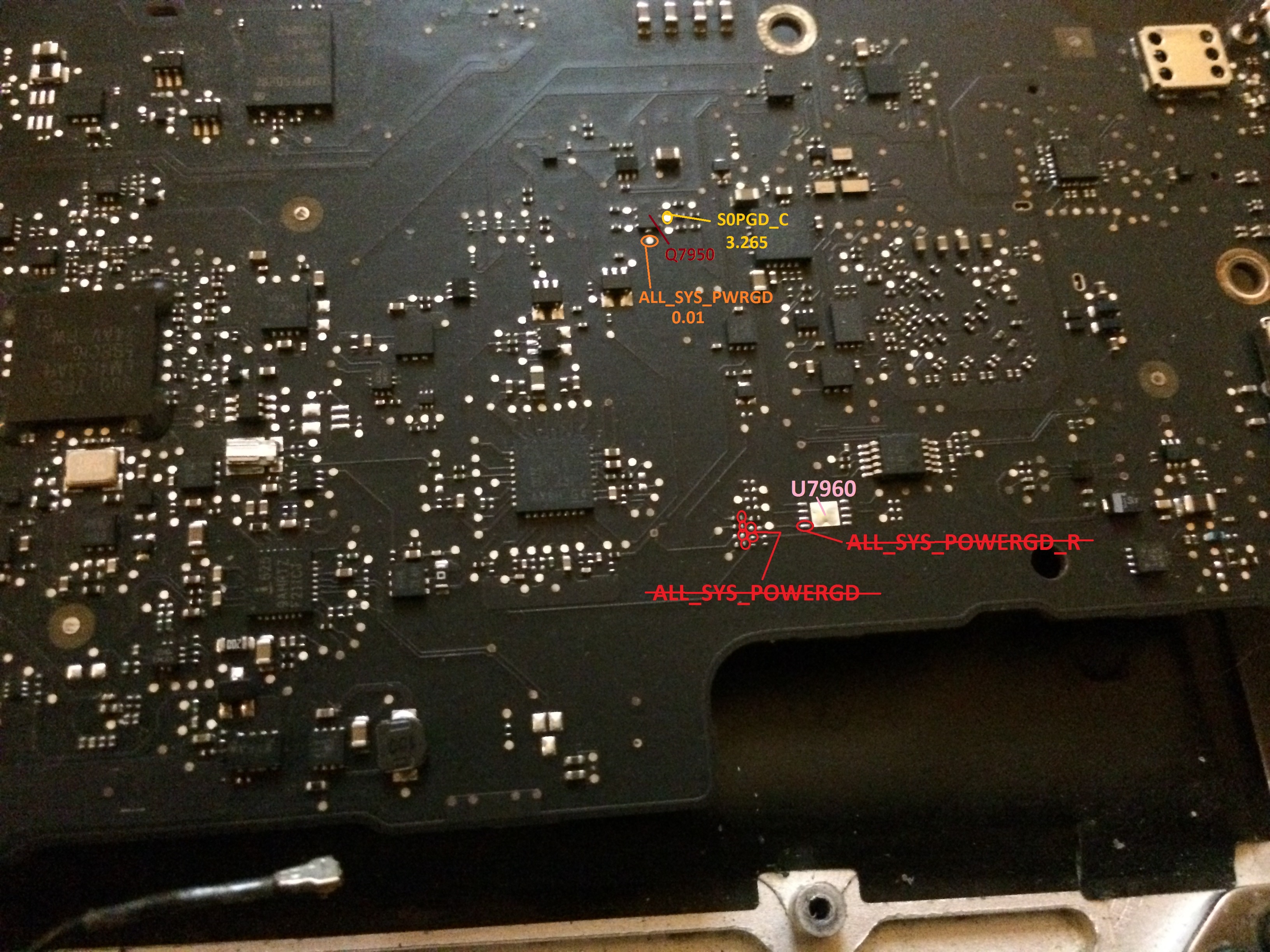

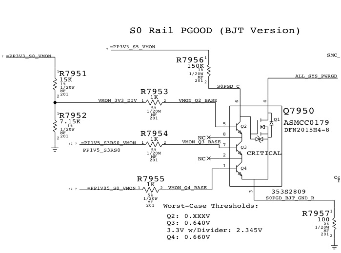

Hi nicoar10 and cmdrdata

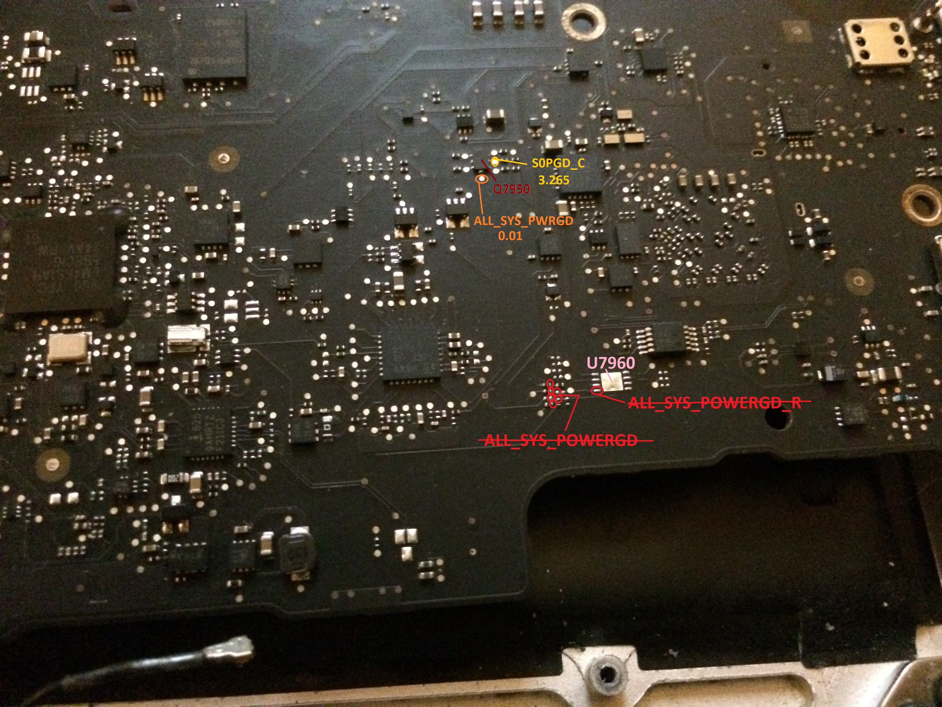

I've tested Q7950 points, and point S0PGD_C reads 3.265. The other point which I think is the correct point now (? check pic) ALL_SYS_PWRGD still reading at 0.00
I guess its not looking good?

Chigwelldave.

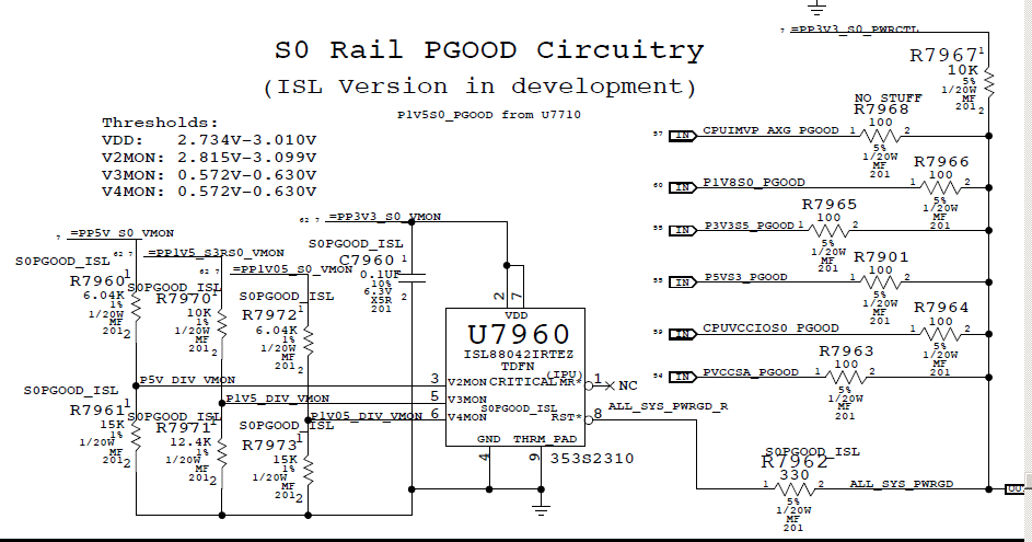

Hi cmdrdata,
8.36v is a bit low (MBA uses 3 series Li-Ion batteries (and parallel, for current capacity), thus it should be a little over 10v for fully charged state). In any case, ALL_SYS_PWRGD is a "wired-OR" signal, active/true state is logic 1 (~3v). It can only be logic 1 if NOT A SINGLE ONE of the signals OR'ed together is pulling it down to logic 0. Look at the attached diagram. The following signals are potentially in a logic state 0:
- ALL_SYS_PWRGD_R (output of U7960/R7962)
- CPUIMVP_AXP_PGOOD (R7968)
- P1V8S0_PGOOD (R7966)
- P3V3S5_PGOOD (R7965)
- etc.
To isolate which one or more is causing this problem you have to unsolder the resistors one at a time and test which signal(s) is the culprit, and then work your way back to the source.
EDIT: OK, re-looking at the picture you attached, it seemed that your MBA has the BJT version of ALL_SYS_PWRGD logic (U6950 looked empty and Q7950 populated. However, the explanation I stated above is still valid. One other thought: Check R7967 (10KOhm). this is the pull-up resistor that raises ALL_SYS_PWRGD to 3v if all the supply status signals are not being asserted.
Hi SKRMobiletech,
Sounds like you do not have your stage0 3V3 main supply. Check the 3V3 comes on early in the boot stage - measure across C7292.
Regards,
Chigwelldave.
Hi Chigwelldave
So I've checked the C7292 and I have 3.33V at PIN 1. Any idea where the problem is. Thanks Chigwelldave for your time and effort.
EDIT: Also check the Q7220 from Pin 1 to 4 = 0.0v Pin 5= 12.60v and Q7225 from pin 1 to 5 = 0v nothing. C7565 is 0.0v and C7568 is 0.0v nothing. Q7565 pin 5 = 0.0v
Diagram and board view is here https://forums.macrumors.com/posts/14888012/
Regards,
SKRMobiletech
