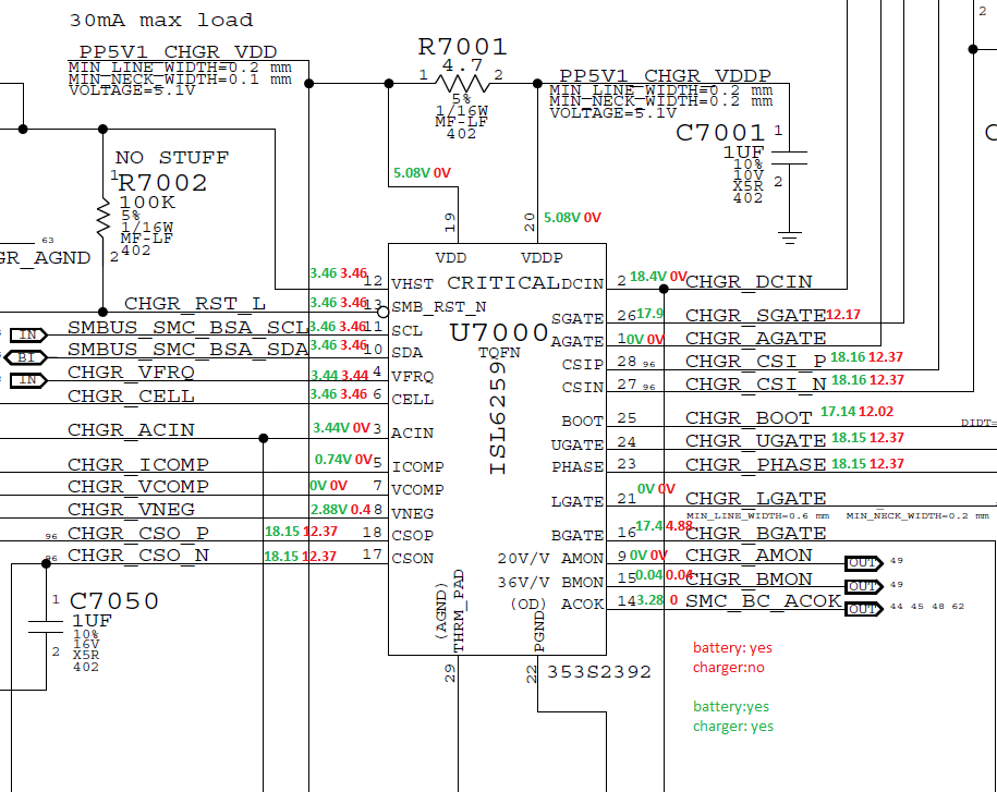

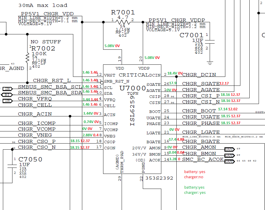

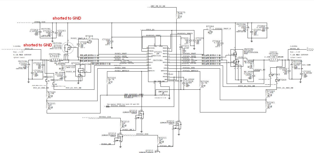

My A1286 820-2850-A logic board cannot power on after coffee damage
First I checked 51125 Vin and found Vin is shorted to GND first(check without DC and battery). Then I checked ISL6259 chip. The pin 23 is shorted to GND.
I checked some voltages of ISL6259 chip(with DC in and without battery, please see the schematic of the following picture):
Pin 2 16.5V
Pin 19 5.05V
Pin 20 5.06V
Pin 12 3.4V
Pin 23 0V
I checked the resistor between 23 and 22.
0 ohm. It's shorted the output. What's the next to check?
Pin 2 16.5V
Pin 19 5.05V
Pin 20 5.06V
Pin 12 3.4V
Pin 23 0V
Hi first and look at c7039 and all caps right side of Q7030 & 7035

I just finished my testing of these 3 components and they seem ok, what else should I check???
Pin 2 16.5V
Pin 19 5.05V
Pin 20 5.06V
Pin 12 3.4V
Pin 23 0V

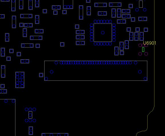

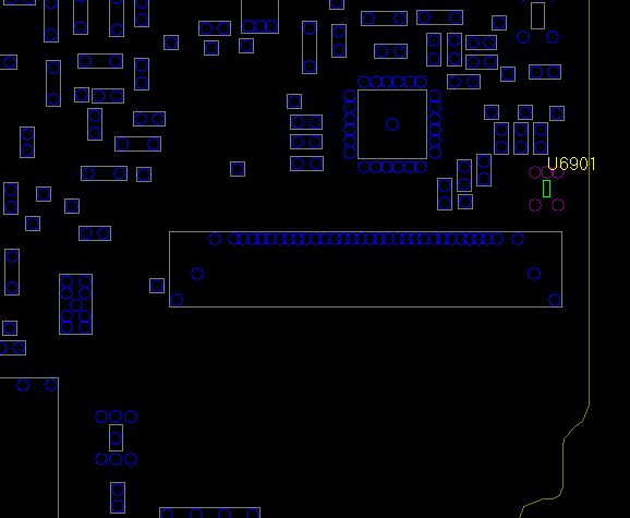

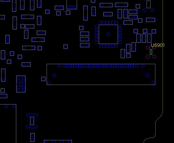

Hi,
I need to replace U6901 , I have no clue how to find it on Inet. Would be possible on Mouser.com? Any help?
For the 820-2879
I was thinking to get a faulty logic board on ebay just to get this component, i guess must have another way though. 😉
Thanks in advance

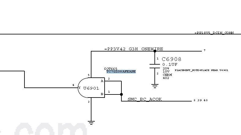

Hi,
For the 820-2879
Thanks in advance

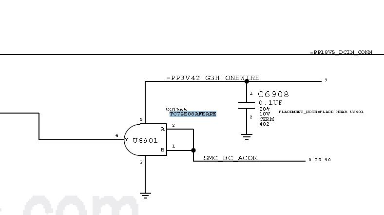

EDIT: Having a look on the pdf file I found SOT665 TC7SZ08AFEAPE
I googled it and iguess i found it on ebay. Looks exactly the same. I would like to get it from Mouser/similar or I have to order it through eBay?
thanks in advance
EDIT2: already ordered on eBay. This thread is amazing! Thanks a million for all the information posted. I´m pretty sure I´m comming back to ask for more help. 😉

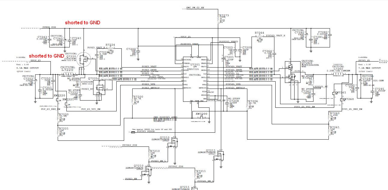

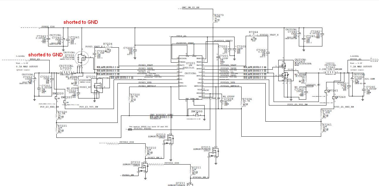

When I removed F7040, I checked the left side of F7040 is not shorted. But the voltage of Pin 23 is changing from 16.5V to 4.5V and go back to 16.5V and loop. Is is normal or ISL6259 damaged?
The right side(PPBUS_G3H) of F7040 is shorted GND. So I began to check 51125. Please see the picture. As I removed 51125 chip, I found PP5V_S3 is shorted to GND too. So PP5V_S3 and PPBUS_G3H are both shorted GND. So I doubt the Q7220(D and S are shorted; D and G are not shorted, G and S are not shorted) and Q7225(D and S are shorted; D and G are not shorted, G and S are not shorted) are damaged. Am I correct?

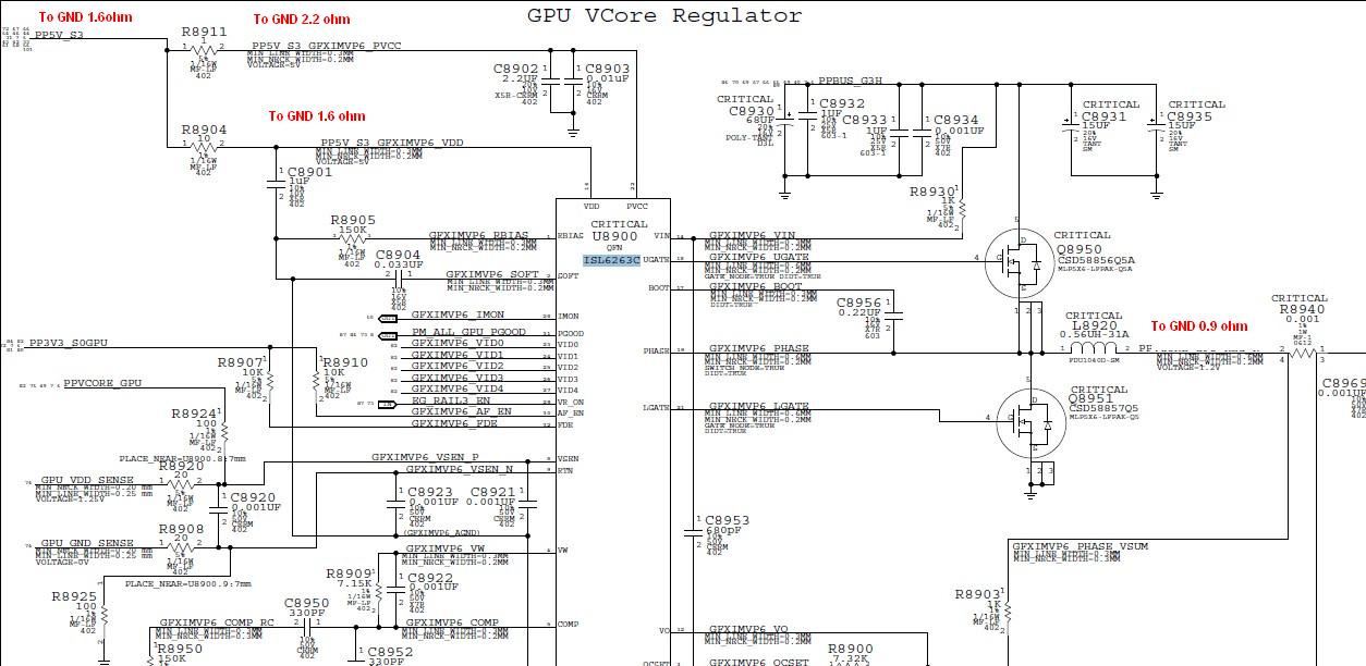

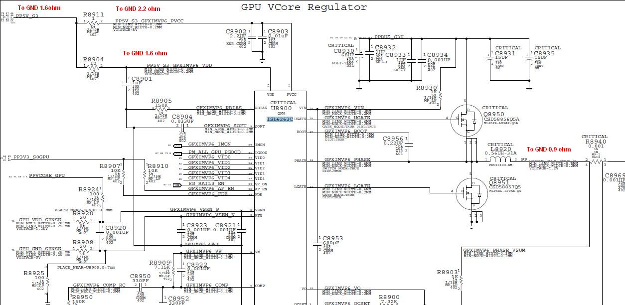

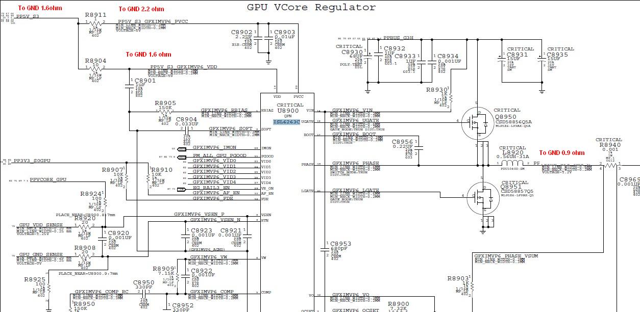

Hi Chigwelldave,
As PP5V_S3 is shorted GND, today I also checked GPU VCore Regulator. I found the Pin 16, 22 and 19 of ISL6263C are shorted to GND too. Please see the following picture.
I'm sure the ISL6263C is damaged. Because the ohm of 16 pin to GND should be more than 10 ohm and should not be 1.6ohm if the other places of PP5V_S3 are shorted.
I also doubt Q8950 and Q8951 are shorted. I still don't have an ideal how to test.
Thanks
-Soyo.

Hi Soyo you are saying pin 23 o volt on u7000 but on the schem you marked
volts down on pin 23?
Do you get G3hot? Was the board water damaged?
The schematic is a standard voltage should be. I do get G3hot. Yes, water damaged. Please see my recent two updates. I found new shorted parts.

Hi Chigwelldave,
Thanks
-Soyo.
Hi Soyo,
If your PP5VS3 is short then pin 16 of the ISL6263 to ground should be 10ohms. If lower, check C8901 as capacitors are easier to remove than QFN chips. Also, when checking the FETS, many of them have built in diodes and so will conduct D-S in one direction when tested with a meter in diode test mode.
Regards,
Chigwelldave.

Hi Soyo,
Regards,
Chigwelldave.
I'm using 200ohm mode of multimeter. The reading value only has 1.5ohm. If it conducts D-S, the value should be more than 1.5ohm.
