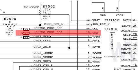

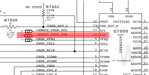

A1278 2011 Liquid damage NO BATTERY DETECTED
Hi guys, another liquid damage board arrive.
After clean board and repair backlight issue, a new problem appear.
Battery is not recognized and no power on from battery.
3,42v present when battery connected. 3V and 5V present , 12v too.
I measured some places in board.
i got short to ground on pin10 U7000 =SMBUS_CHGR_SDA
following all this line and remove components to find out where is the problem i can not find it.😡
I tried replace u7000 for new one but still shorted.
I saw 2 pull up resistors but these measure ok
Hope you help!

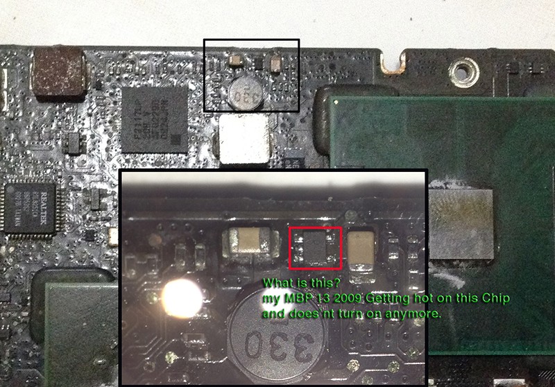

Hi Everyone, newbie here.
Anyway i have MBP 2009 Water damage, and i found some chip or dioda (not sure) get burn. this chip Connected with another side 470 resistor.
its possible i get same part from another Logicboard like MBP 13 2010-2011?

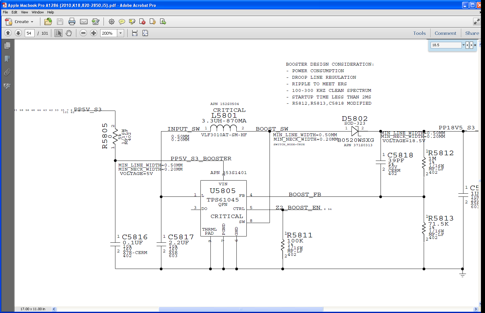

Newbie- 2010,K18,820-2850,i5 No G3HOT no 18.5v U5805

I have a late 2009 macbook pro that suffered a coffee spill. i got a 2010 to practice on for $50 dollars before i destroyed the pretty one.
Apple Macbook Pro A1286 (2010,K18,820-2850,i5)
I have no G3HOT, and traced back as best as i could to find no 18.5v output of the U5805 chip.
My question is "before i rip the chip off of the board, is there some component down the line that would cause 0v output? pin 8 does not short to ground and has 0v is the chip in need of replacement?" 4.99v is at pin 2.
also:
MIN_LINE_WIDTH=0.50MM
MIN_NECK_WIDTH=0.20MM
VOLTAGE=5V
is that info for wave analysis if using a scope or???
thanks
fdk😕
Cheers...
Hi,
Assuming your board is an 820-2530, that's the dual diode for supplying G3Hot from either the battery or Magsafe. It is a SOT665 diode type HN2D01JEAPE, circuit reference D6905.
Regards,
Chigwelldave.
