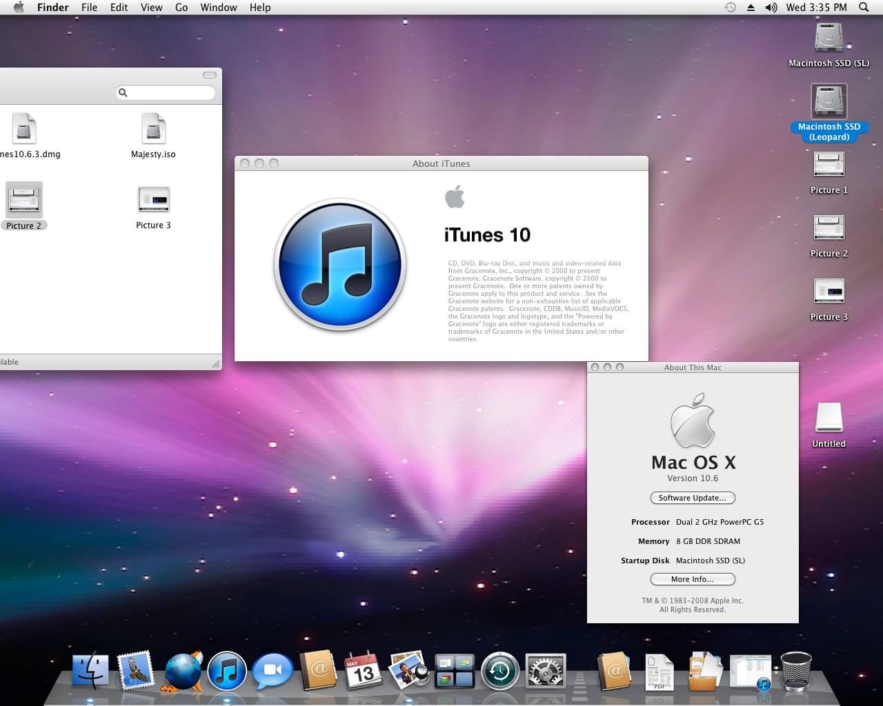

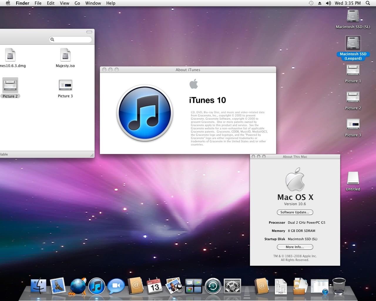

To add to the discussion here, I was able to hack in iTunes 10.6.3 and QuickTime 7.6.4 into Snow Leopard. Works perfectly fine aside from Safari issues with the iTunes Store. Yes I’m aware the FX5200 Ultra doesn’t have acceleration aside from software CI. Might try the above kext to hopefully fix unmounting issues with removable devices. Very impressed with this project.
To add to the discussion here, I was able to hack in iTunes 10.6.3 and QuickTime 7.6.4 into Snow Leopard. Works perfectly fine aside from Safari issues with the iTunes Store. Yes I’m aware the FX5200 Ultra doesn’t have acceleration aside from software CI. Might try the above kext to hopefully fix unmounting issues with removable devices. Very impressed with this project.View attachment 927116
Wow, great news. Could you share how to do it or make the files available, please? Thanks!
(And it seems that you have done the screenshot on an otherwise not patched/optimized system: Blocky background and JPGs in Safari and other browsers... ;-)
Certainly. And actually it wasn't that difficult once you run the installers of both and tell them to show the file list. Simply copy those files to their respective locations in Frameworks and PrivateFrameworks and the Extensions to their proper locations. Will download the installers again and extract them to help a bit. I couldn't extract the installer of iTunes using The Unarchiver fully (payloads failed to extract properly on my Mac Pro) but otherwise QuickTime can be fully Installed with no issues as that fully extracted. Link from my drive will be available soon. As for the "blocky" image, that's directly from my G5 running 10a190.

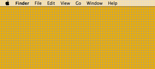

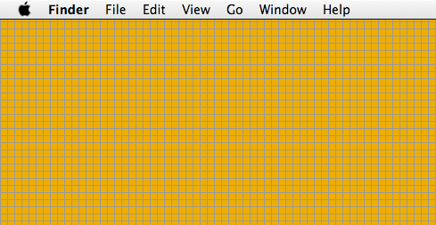

Hi all,
Well I've just noticed something strange....
After mentioning yesterday the possibility of using Hyperspaces to disable transparency
this happened today after rebootiing
Any ideas?
Best regards,
voidRunner
Reactions: Larsvonhier

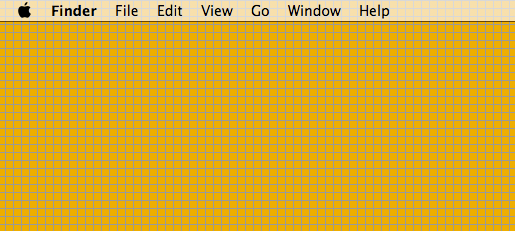

Hi all,
Any ideas?
Best regards,
voidRunner
So essentially you noticed that after turning off transparency with Hyperspaces, you still have semi-transulcent menu bar?
(I assume the grid background was only chosen to show this in a better way?)
Hi @Larsvonhier,
As I mentioned in the first post when I deactivated transparency I got a white status bar like
below
But when I rebooted transparency is still deactivated but my bar was translucent.
When I ran Hyperspaces again and "Activated"/"Deactivated" transparency again I got
the white status bar like above.
I think this only happens when you startup / reboot.
Best regards,
voidRunner

Hi @Larsvonhier,
I did another test regarding the transparency option and
after a reboot "true" transparency returned. ;-)
I also tested changing wallpaper after rebooting and transparency
keeps working.
Best regards,
voidRunner
