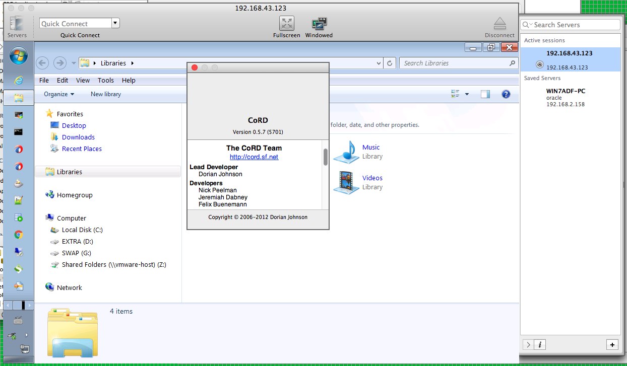

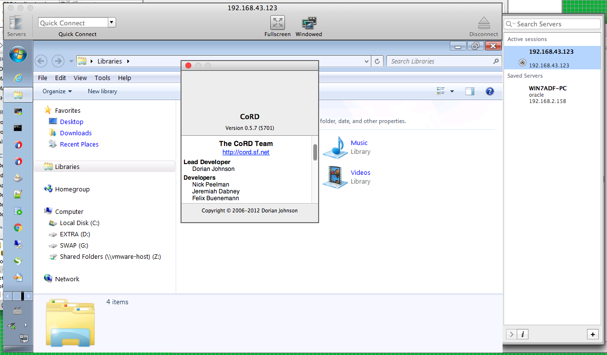

Yes we can build newer software ;-)
CorD 0.5.7 on SL PPC previously only available for SL Intel.
The source code
PS. some code changes need to be "finished"/"fixed" not a lot I did this in a few hours this afternoon.

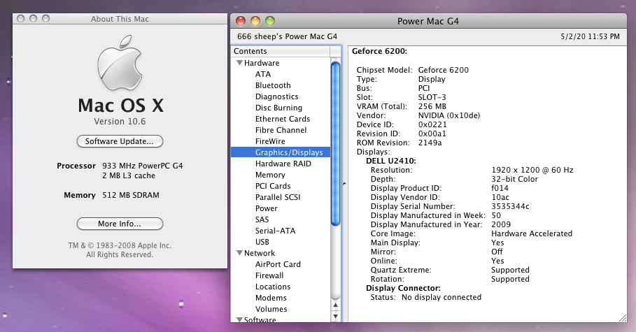

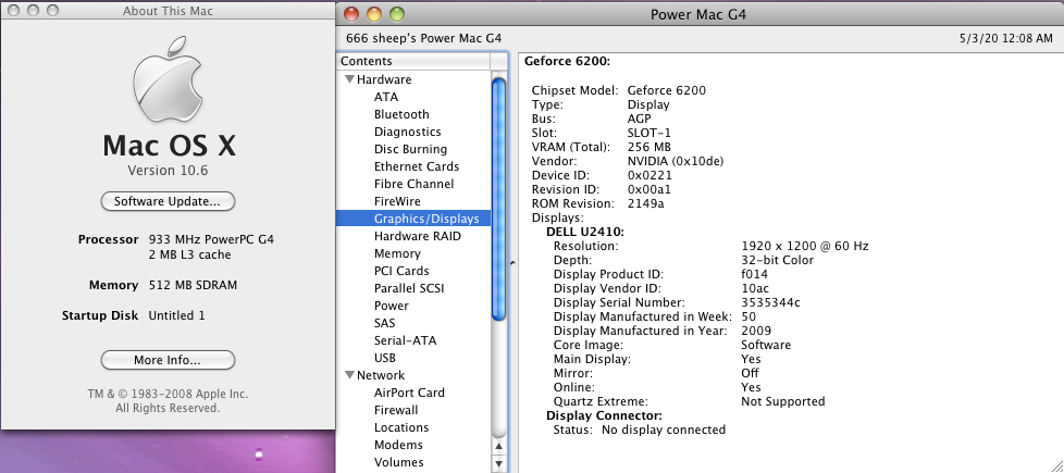

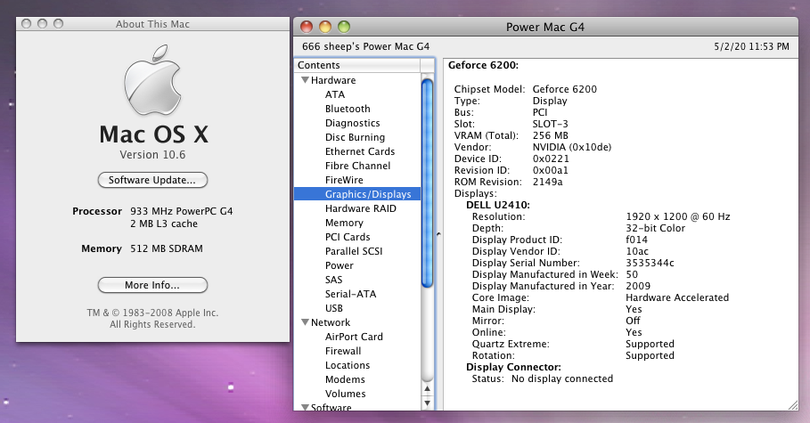

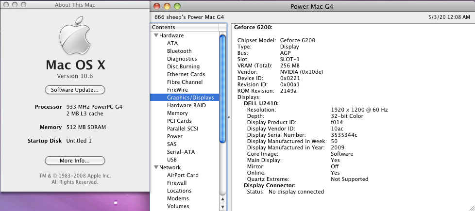

I made some more experiments over the weekend for finding more about GPU QE/CI hardware support.
Our assumption that SL killed AGP support seems to be only half of the problem!
I managed to repair an iMac G5 (iSight 20") with an ATI X600 GPU. As it is a PCI-E version, my hopes were high to have full support from 10.6. straight out-of-the-box.
But it turned out that it´s only semi-supported as all the other ATI 9x00 cards (that are AGP version in most PowerBooks). The X600 sounds like a far superior card than the Radeon 9x00, but actually it´s quite comparable to them. Kexts are all loaded, but no quartz extreme hardware accel.
I also tried another approach to sort things out, as I found an old ATI Rage128 (16MB) card for plain PCI slot.
If I install this into my PowerMac G5 (as the only GPU), the ATI128 drivers load (those found in 9A343 build of Leopard), produce the same known little artefacts (mousepointer) but generally work pretty well - but again only semi-accelerated.
So in both cases we have no acceleration with certain types of GPUs, even if they are PCI / PCI-E versions of their PowerBook AGP variants.
(So they add to the list of many NVIDIA GPUs that are on PCI also and do not work).
There must be something more that we overlooked...
