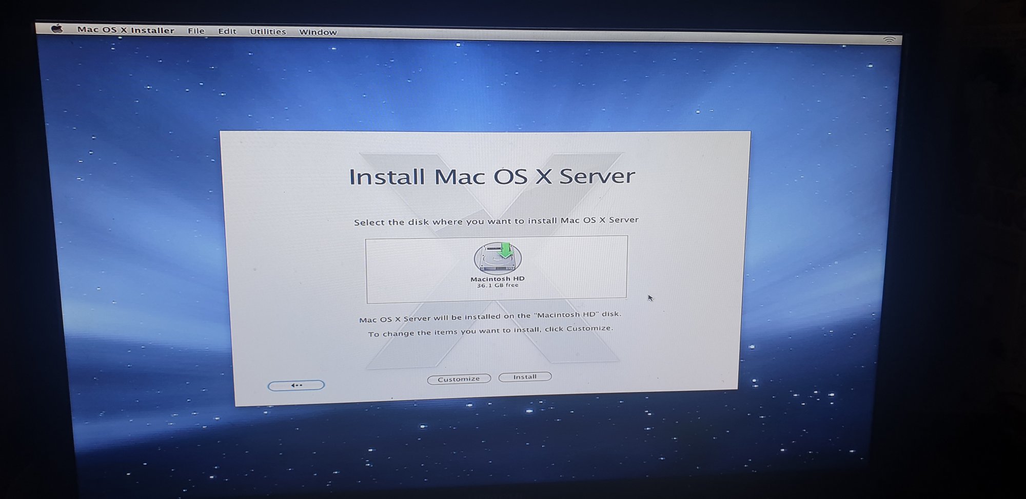

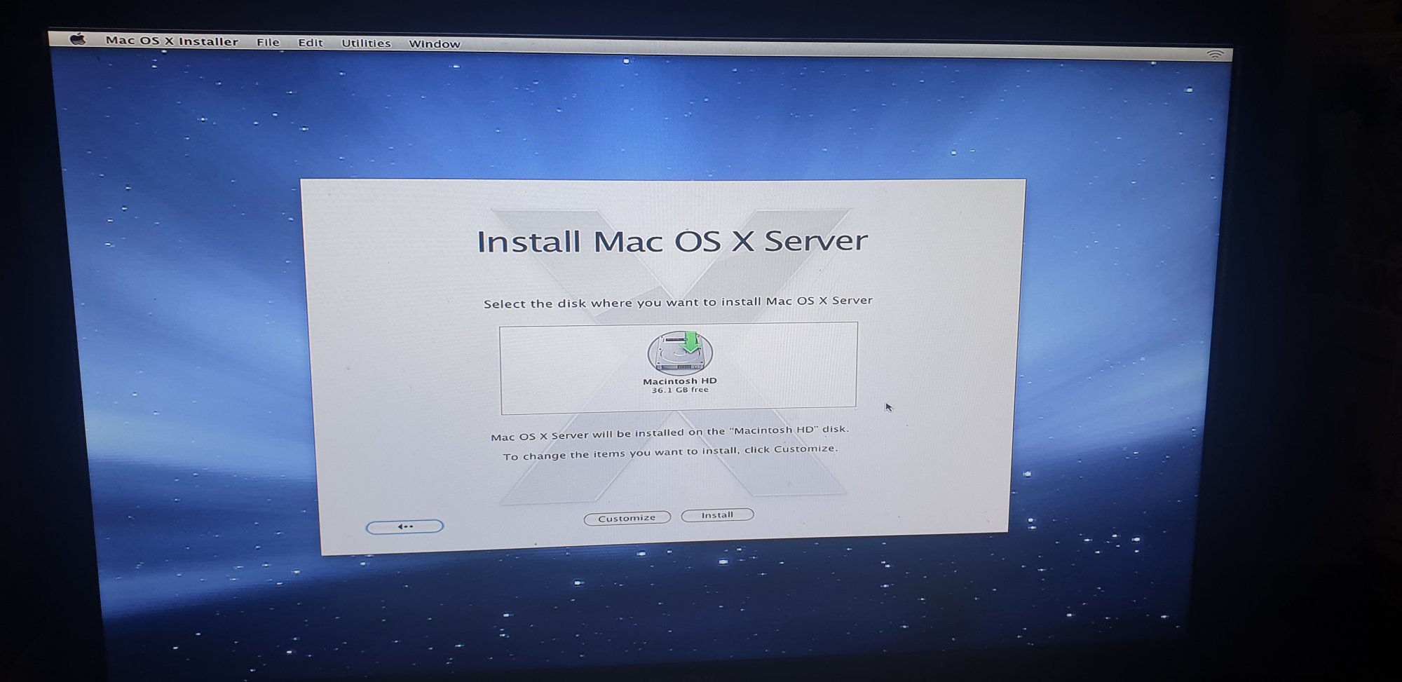

Did you patch the installer yourself (manually or script) or did you try the pre-patched installation?
I patched it with the script, I'll try again, I've managed to boot the pre-installed one from post #200 from usb so not sure why I can't get the installer working. I can't image the pre-installed one either because its 80GB and my hdd is 40GB
Got it. The patch worked this time.

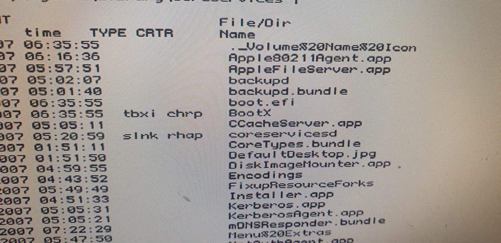

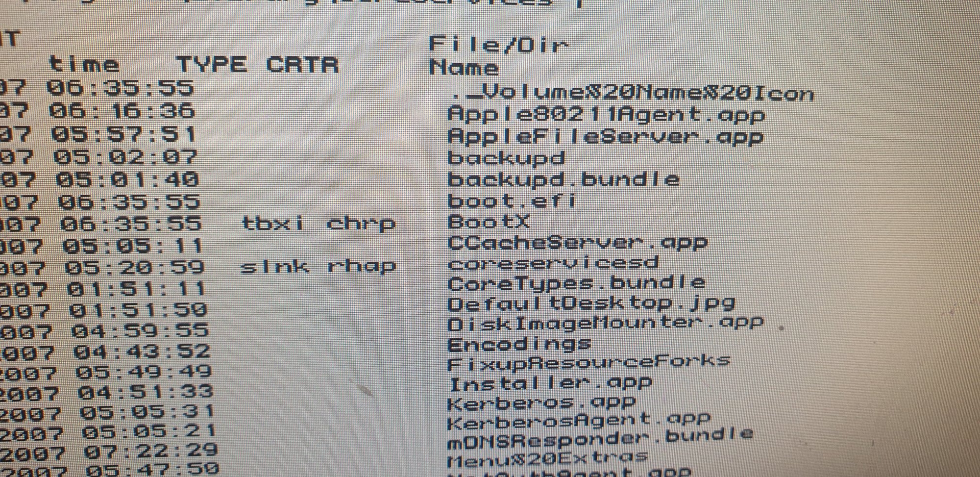

What kind of AirPort card you have? What chip inside?

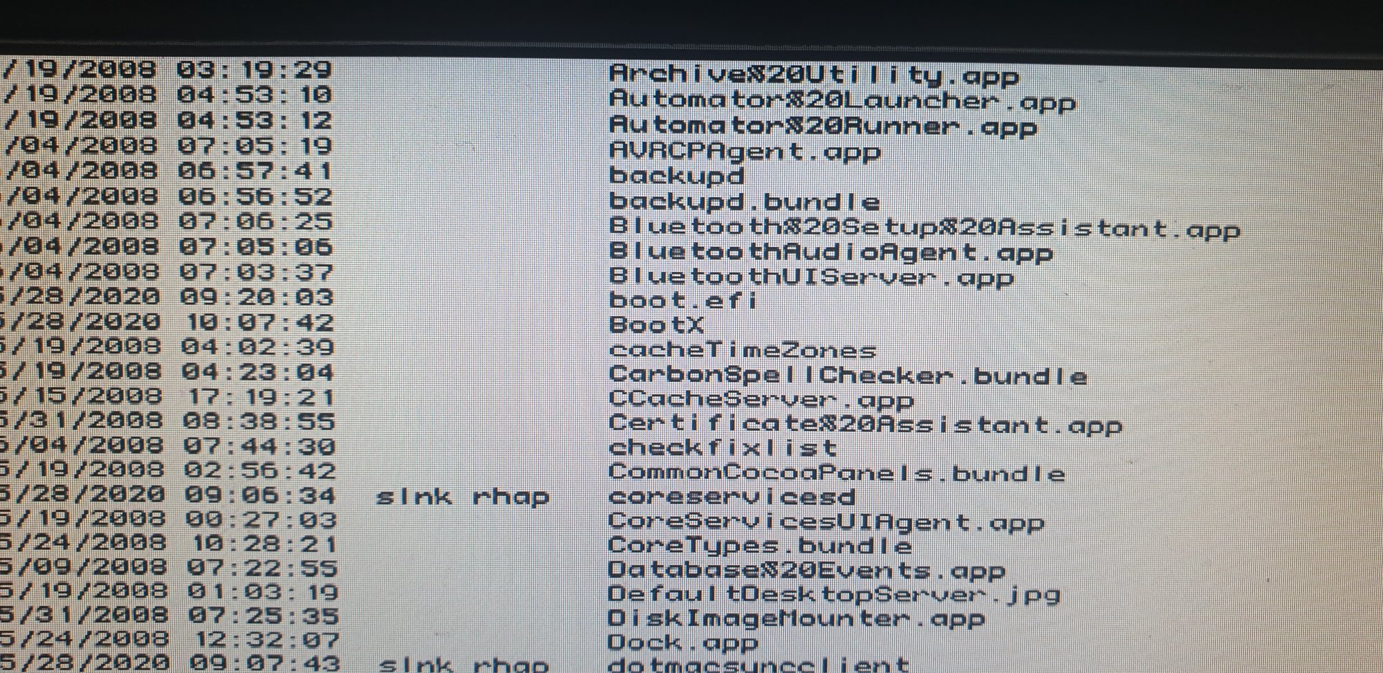

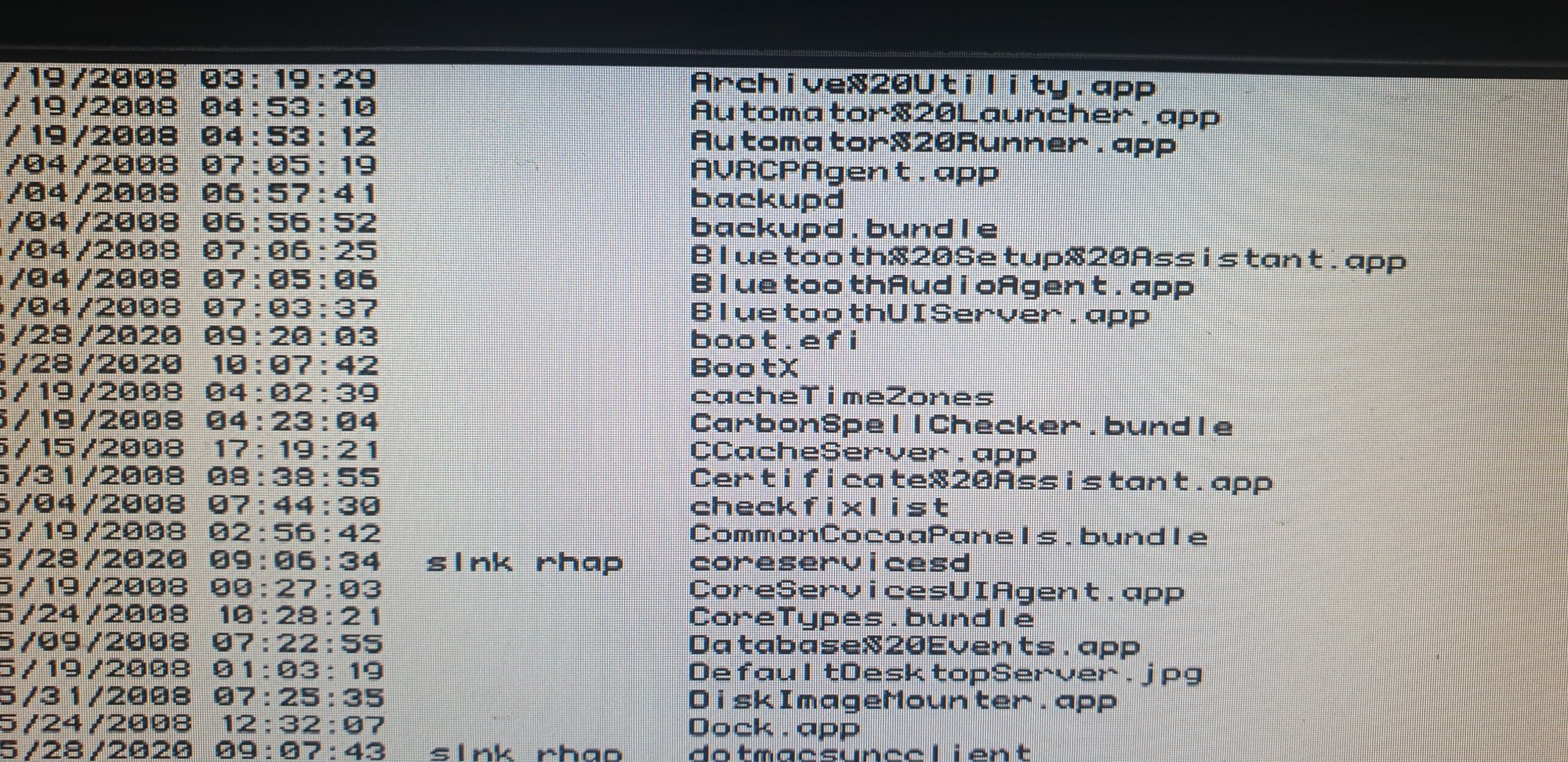

Its an a1027 but that doesn't matter now because the bootx file doesn't have the tbxi type and chrp anymore. This is my leopard installer
And this is my 10.6 drive
It refuses to boot and brings me to the blinking question mark system folder.

Its an a1027 but that doesn't matter now because the bootx file doesn't have the tbxi type and chrp anymore. This is my leopard installerView attachment 919372

Doesn't work, the bootx file was corrupted after running the snow leopard patcher from github

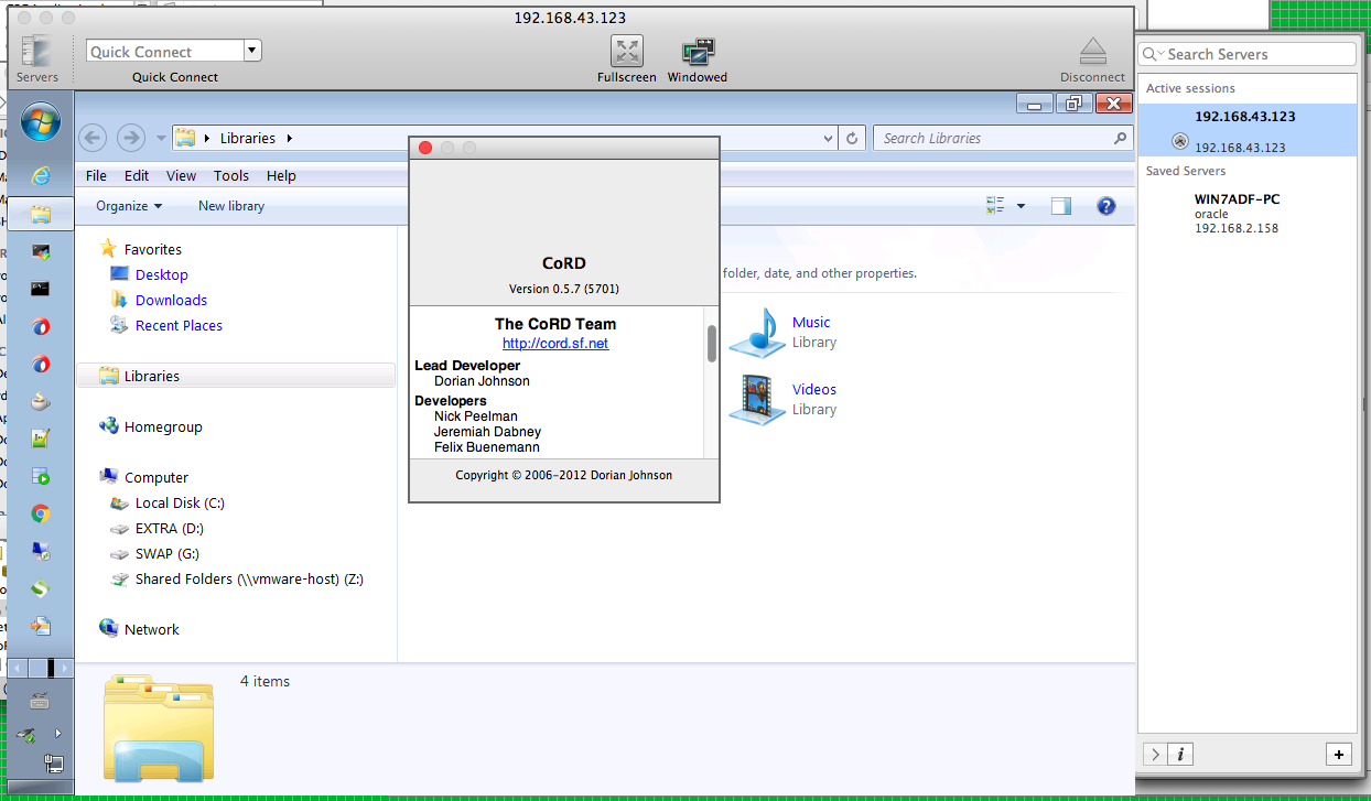

Hi all,
Yes we can build newer software ;-)
CorD 0.5.7 on SL PPC previously only available for SL Intel.
The source code
PS. some code changes need to be "finished"/"fixed" not a lot I did this in a few hours this afternoon.
Maybe now we can add newer code to connect to more recent Windows versions with added
security requirements.
Best regards,
voidRunner
