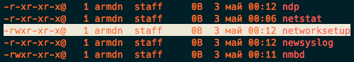

Try in Terminal
Code:
networksetup -setairportpower en1 on
or whatever en number your Airport is.
Cheers :)
Hugh
EDIT:- no that doesn't work :(
Of course it WILL NOT work, because it is EMPTY (sic!)! ))
Something inside me, tells, that we HAVE TO replace this 0B binaries with not empty from 10A96/10A222...
[automerge]1590321912[/automerge]

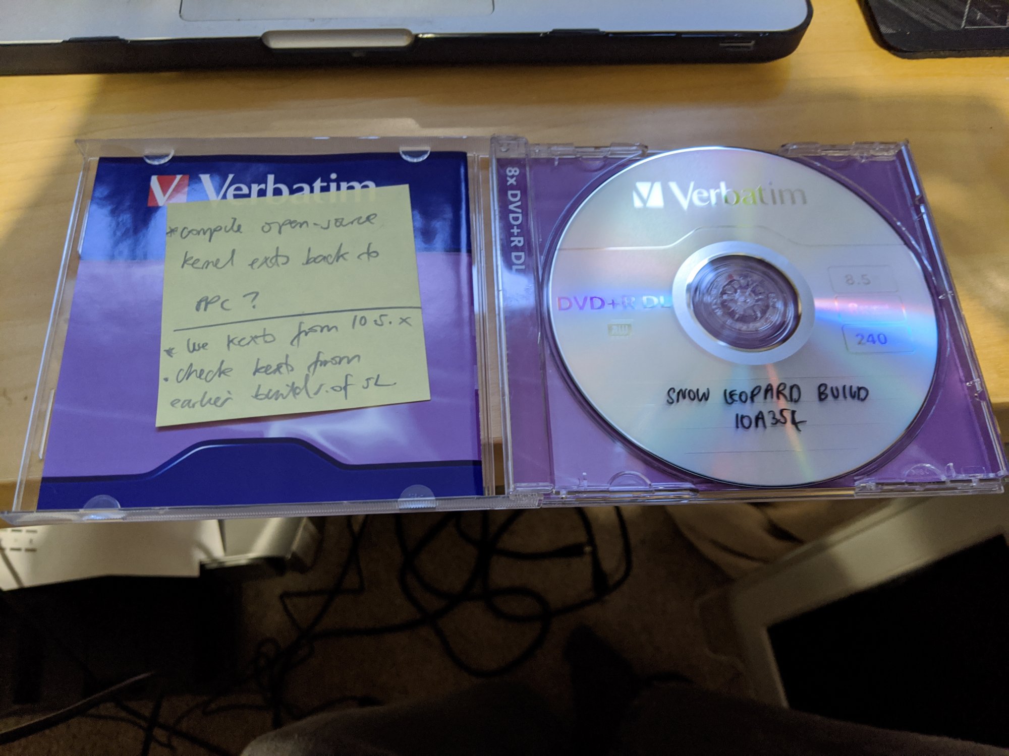

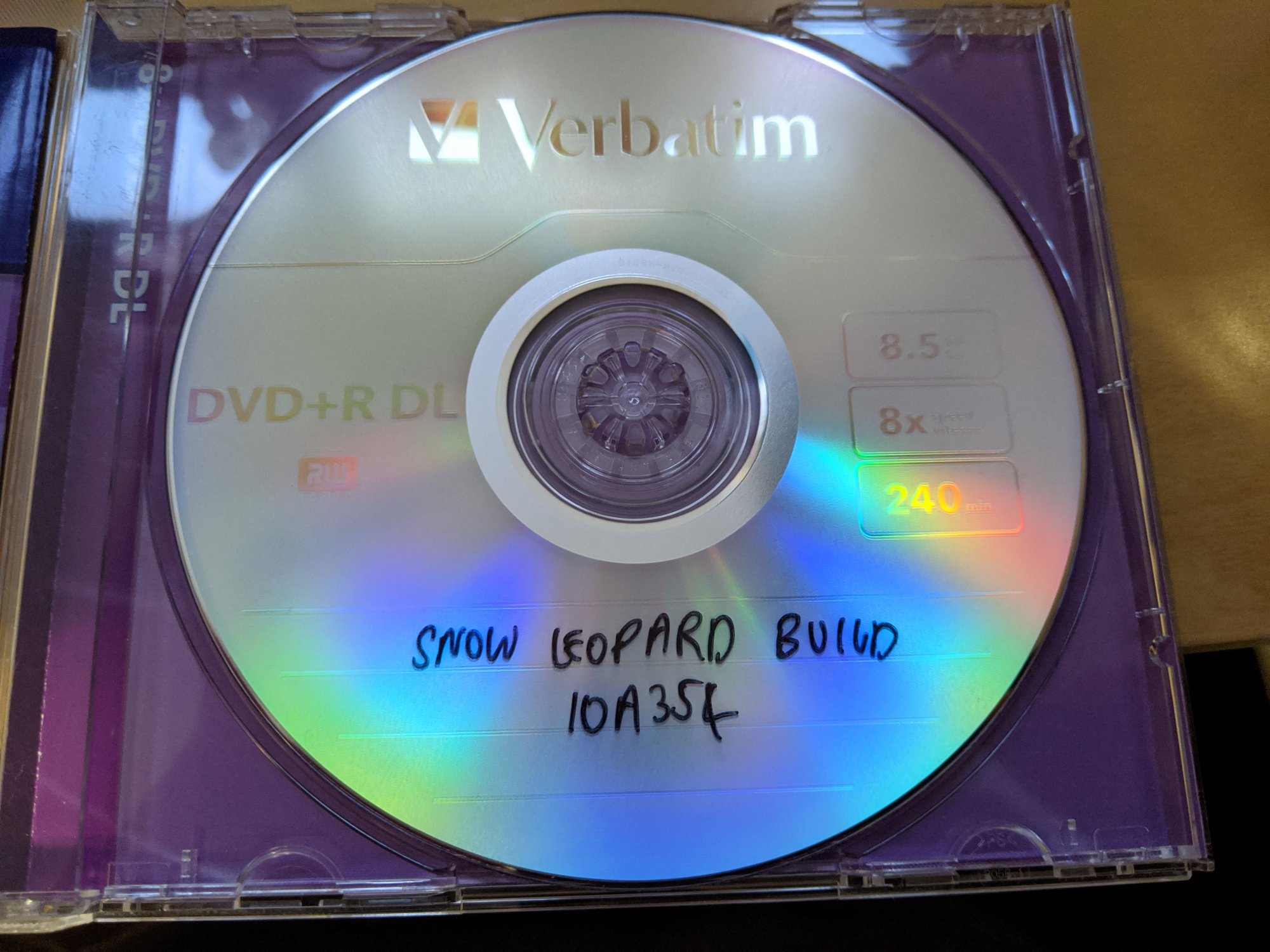

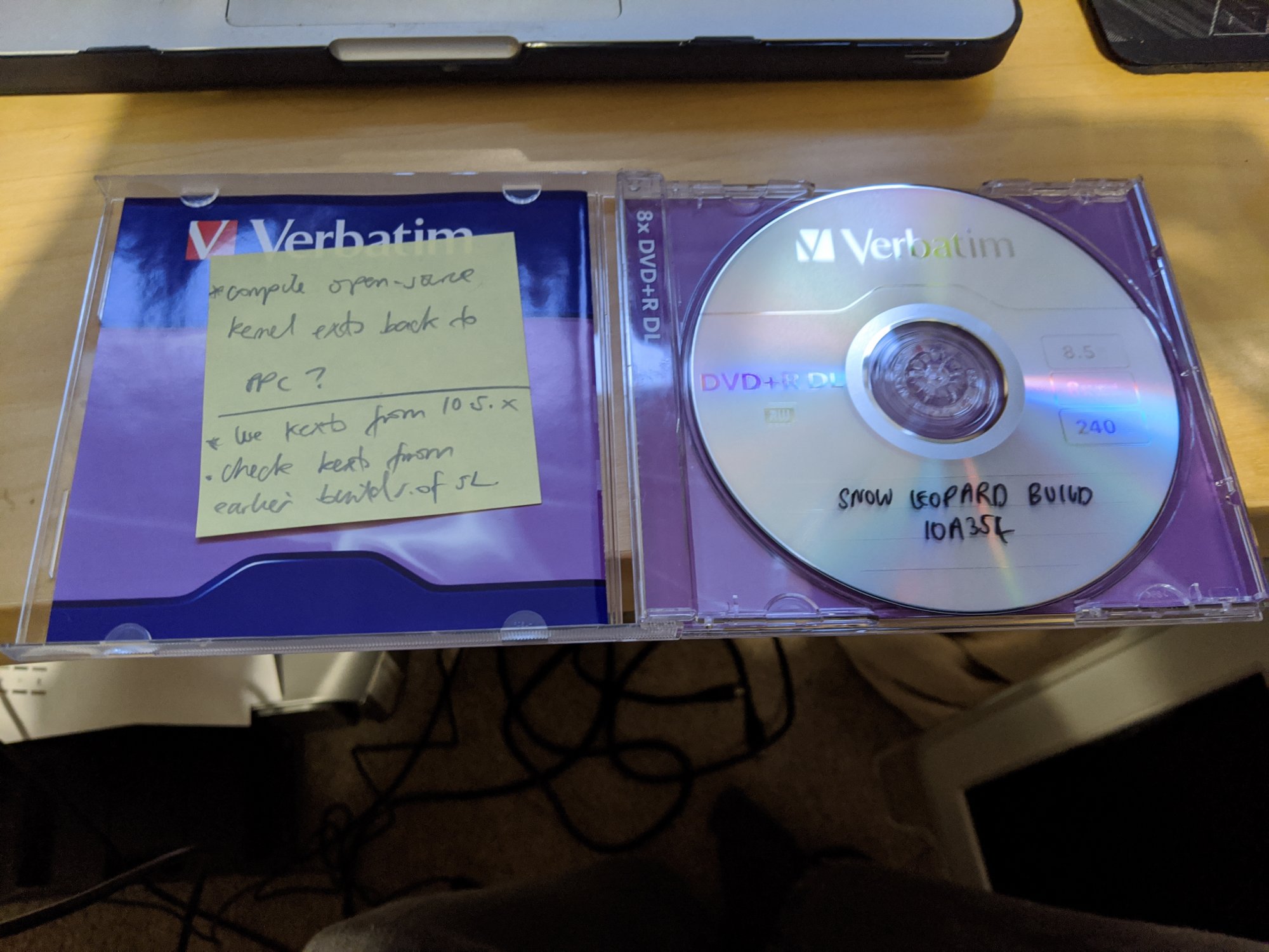

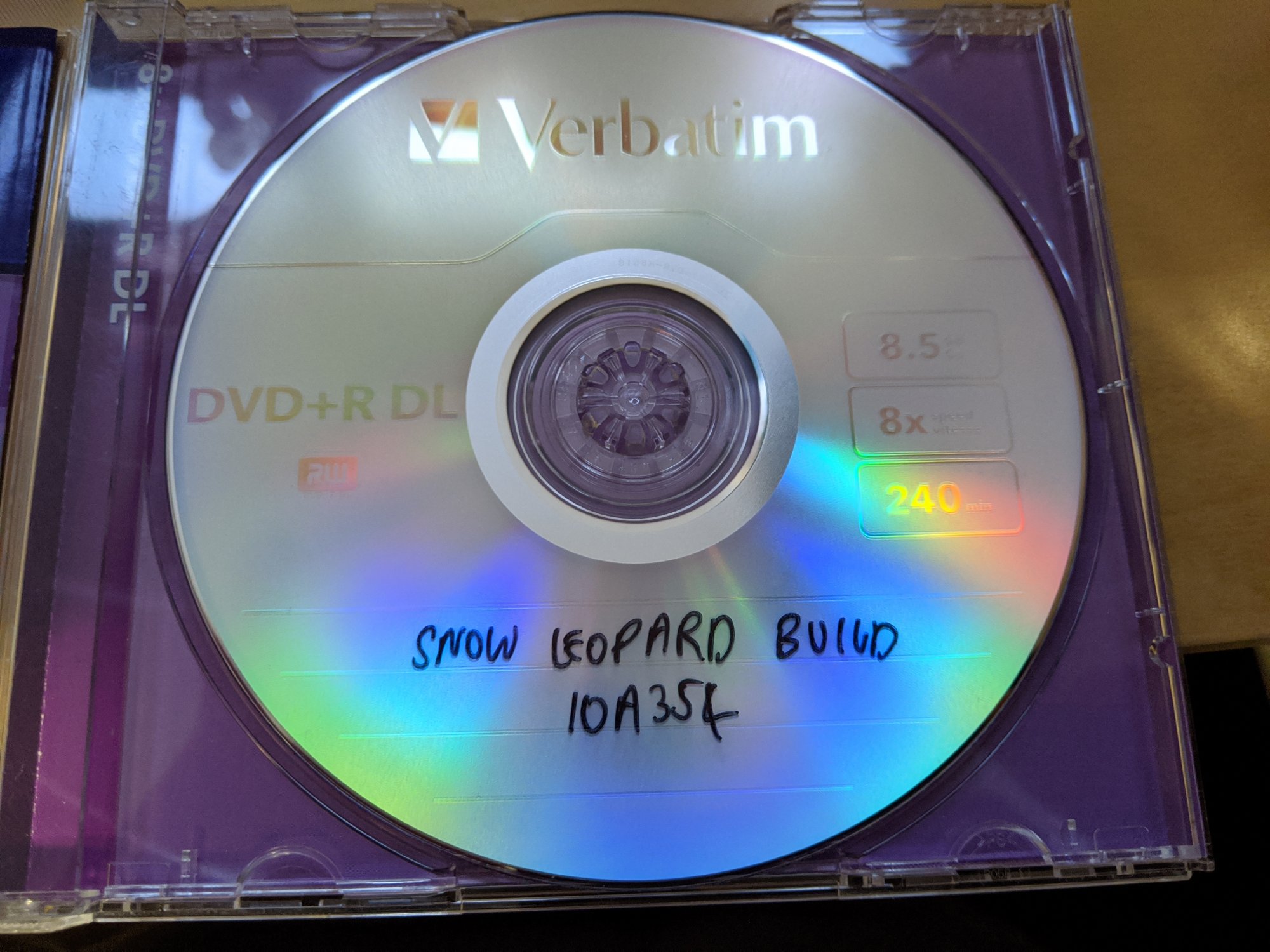

Hello!
I've done some more digging and have found the following, which I'd forgotten all about:
1) I have A10354 burned to a dual layer DVD sometime in 2009. I've updated the wiki page and will find somewhere to upload it, as I guess it still might have some PPC stuff on it which could be useful.
2) Have found the following musings from 2009 on post-it with the DVD;
"Compile open-source kexts back to PPC" (NB - Great to see that the kernel could be done for this. Might be worth looking at the OpenSource kexts still available if any are missing/not supported in later versions, but the source is.)
"Use kexts from 10.5.x"
"Check kexts from earlier builds of SL".
Looks like the intention was there back there then to poke about with PPC stuff even further with Snow Leopard - but alas this build I'd picked/had access to was way past the PPC being stripped out of it, so probably stopped progress there. I remember spending a while on Vuze/Torrents trying to get this to download back then.
I've also updated the wiki with the details of the Digital Audio boot I got working - as this also had an ADC card in from a PMG5, modded to work in the G4 AGP/ADC setup (pin 21 mods).
Again, so glad this thread exists and that progress has been made, and get to contribute to it all these years later! :)
It's interesting watching/contributing developments to this thread and then seeing mentions on various FaceBook groups and YouTube!
James.
Hello!
I've done some more digging and have found the following:
Looks like the intention was there back then to poke about with PPC stuff - but alas this build I'd picked/had access to was way past the PPC being stripped out of it, so probably stopped progress there. I remember spending a while on Vuze/Torrents trying to get this to download back then.
James.

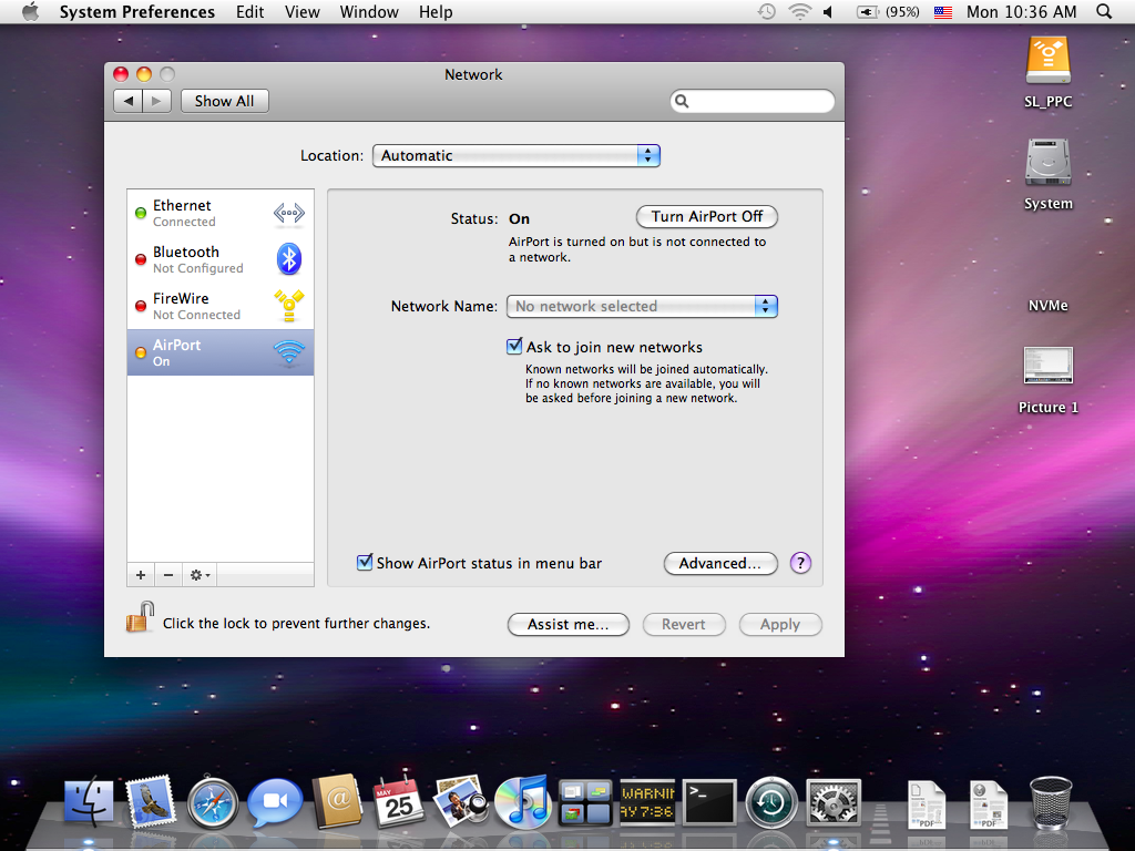

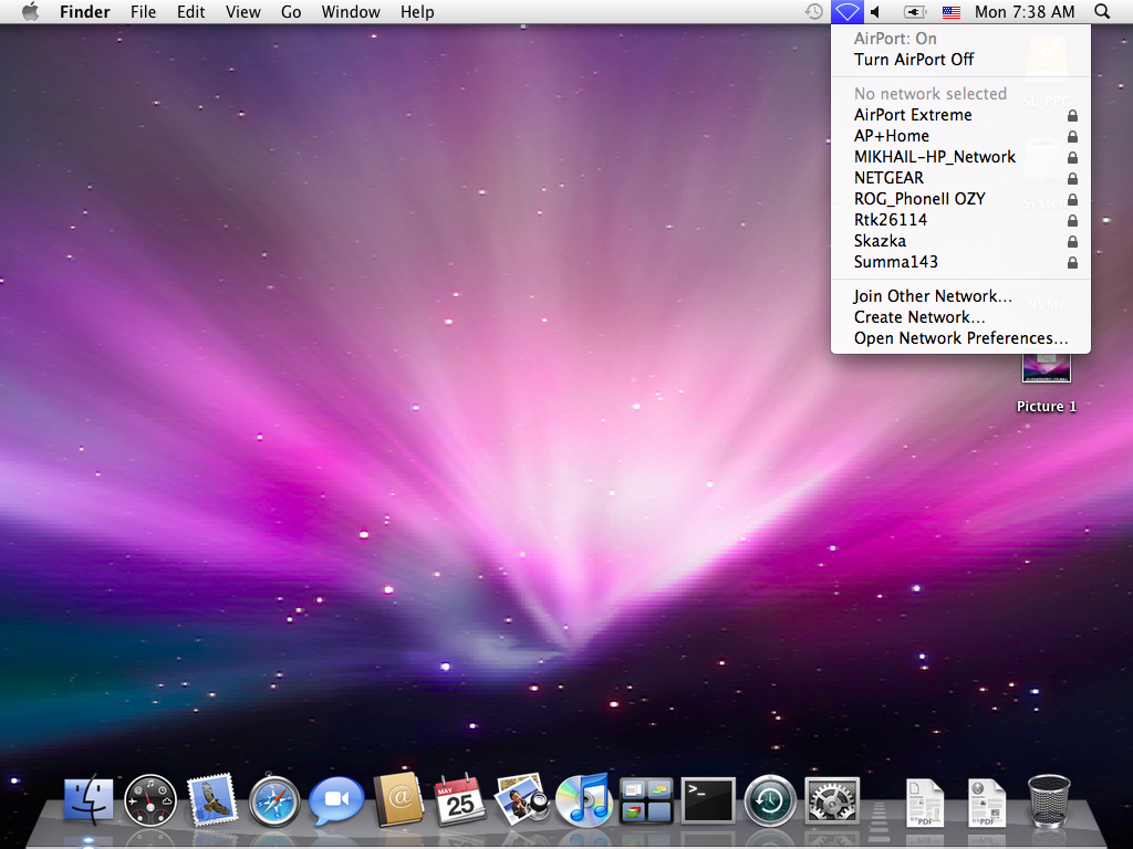

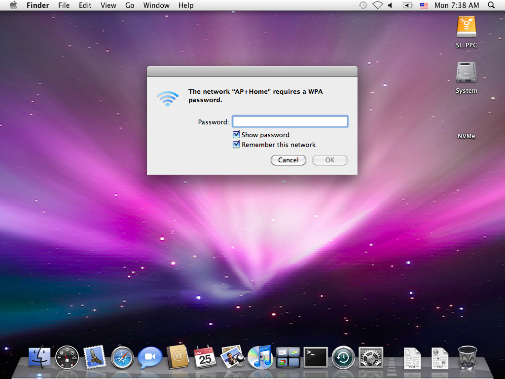

Well i have a some news about Wi-Fi in SL. It is start to work. Partly. As i don't have a 10A96, i placed Apple80211.framework from Leopard, and AirPort Extreme now powered On, and detect some Wi-Fi networks, but can't connect to them, as i understand, some tools to make that connection is not present, but it is a progress, private framework not caused Kernel Panic!

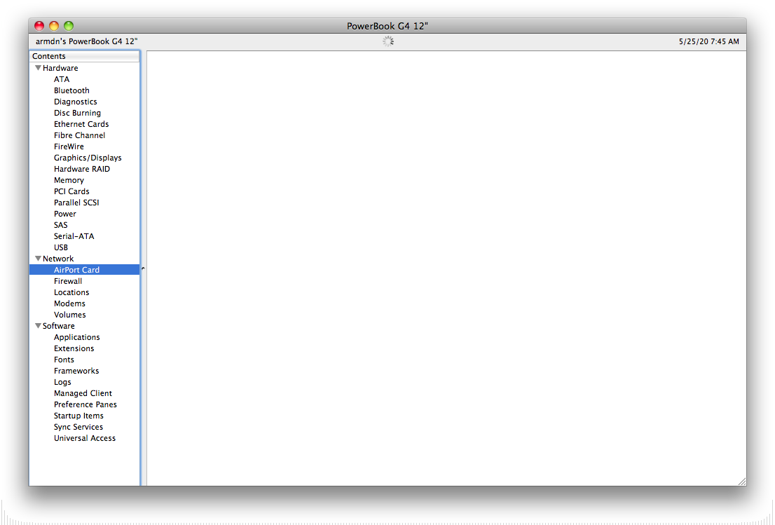

But, system profile can't get actual information about AirPort card. I suppose some tools still missing (AirPort.framework in /System/Library/Frameworks ????)
Also i see, that 10A190 present an empty AppleAirPort.framework. So i bet, that in 10A96 AppleAirport.framework, and Apple80211.framework will make AirPort Cards fully functional as expected!

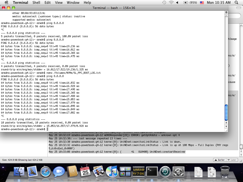

Another news. Ethernet start working, but i've done nothing for that... 😅
Right after that, ntpd daemon goes into crush loop...
About AirPort. I at last downloaded 10A96, and replaced AirPort.framework and Apple80211.framework, as well as networksetup cli util from 10A96 to 10A190. But it still can't connect to Wi-Fi networks. airportd failed to list network interfaces...
here is a full boot log:

May 25 10:26:30 armdns-powerbook-g4-12 SystemUIServer[103]: Error: airportd MIG failed = -3903 ((null))  (port = 58879)
May 25 10:26:30 armdns-powerbook-g4-12 /System/Library/CoreServices/SystemUIServer.app/Contents/MacOS/SystemUIServer[103]: GetDYLDEntryPointWithImage(/System/Library/Frameworks/CoreServices.framework/Versions/A/Frameworks/CarbonCore.framework/Versions/A/CarbonCore,IntlGetIsInitIntlValueDone) failed.
May 25 10:27:03 armdns-powerbook-g4-12 SystemUIServer[103]: Error: airportd MIG failed = -3903 ((null))  (port = 58879)
May 25 10:27:03 armdns-powerbook-g4-12 SystemUIServer[103]: Error joining AP+Home: Connection failed (-3903 result unavailable)
May 25 10:27:03 armdns-powerbook-g4-12 [103]:
May 25 10:28:13 armdns-powerbook-g4-12 /Applications/System Preferences.app/Contents/MacOS/System Preferences[143]: GetDYLDEntryPointWithImage(/System/Library/Frameworks/CoreServices.framework/Versions/A/Frameworks/CarbonCore.framework/Versions/A/CarbonCore,IntlGetIsInitIntlValueDone) failed.

As we can see, airportd is failed to connect. I suppose there is something else, another component, which is helps to airportd to connect to selected wireless network, but i didn't understand yet which is...

Interesting side note: Some of my PBs (i.e. 500MHz Titanium) cannot connect to my Airport Extreme running 10.5.8 (!) since I updated the firmware there (or changed settings I do not know). Might be related to airport cards that can only encrypt with WEP instead of WPA/WPA2? Just mentioning this so you might not waste time hunting ghosts when Airport shows up, shows networks but cannot connect?!
I´ll try to prepare a 10A96 non-server version like the A190 that sets in at the registration screen after install.
Might be a couple of days until then, though.
As for the NVIDIA: I do not have any instabilities with my armada of Nvidia PPC Macs. Perhaps it´s your ageing HW or RAM? Is the machine long time stable with 10.5.8 or 10.4.11?
All three installer-links are on page #1, see table 2. edit: You found them! ;-)
[automerge]1590427223[/automerge]
Nope, main OS on PB G4 is 10.4.11 (Universal Binary Server), and it is rock solid stable...
Also, i see, that DirectoryService eating CPU, often. What cause that, don’t know.
[automerge]1590429306[/automerge]
My PB G4 running 10.4.11 Server connects to WPA2-Enterprise wi-fi network, so...

Has anyone revised the beta so that it will support QE/CI and airport on a PowerBook G4 DLSD 1.67 17 inch ? I was told that this works fully with the Quad G5.
