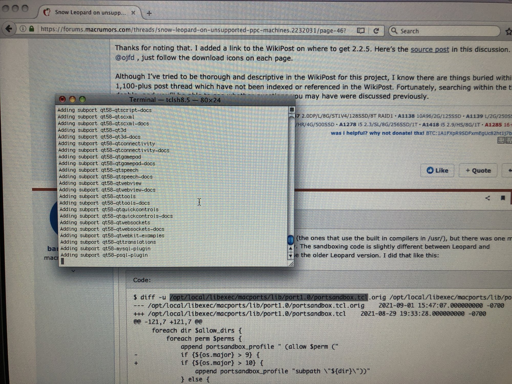

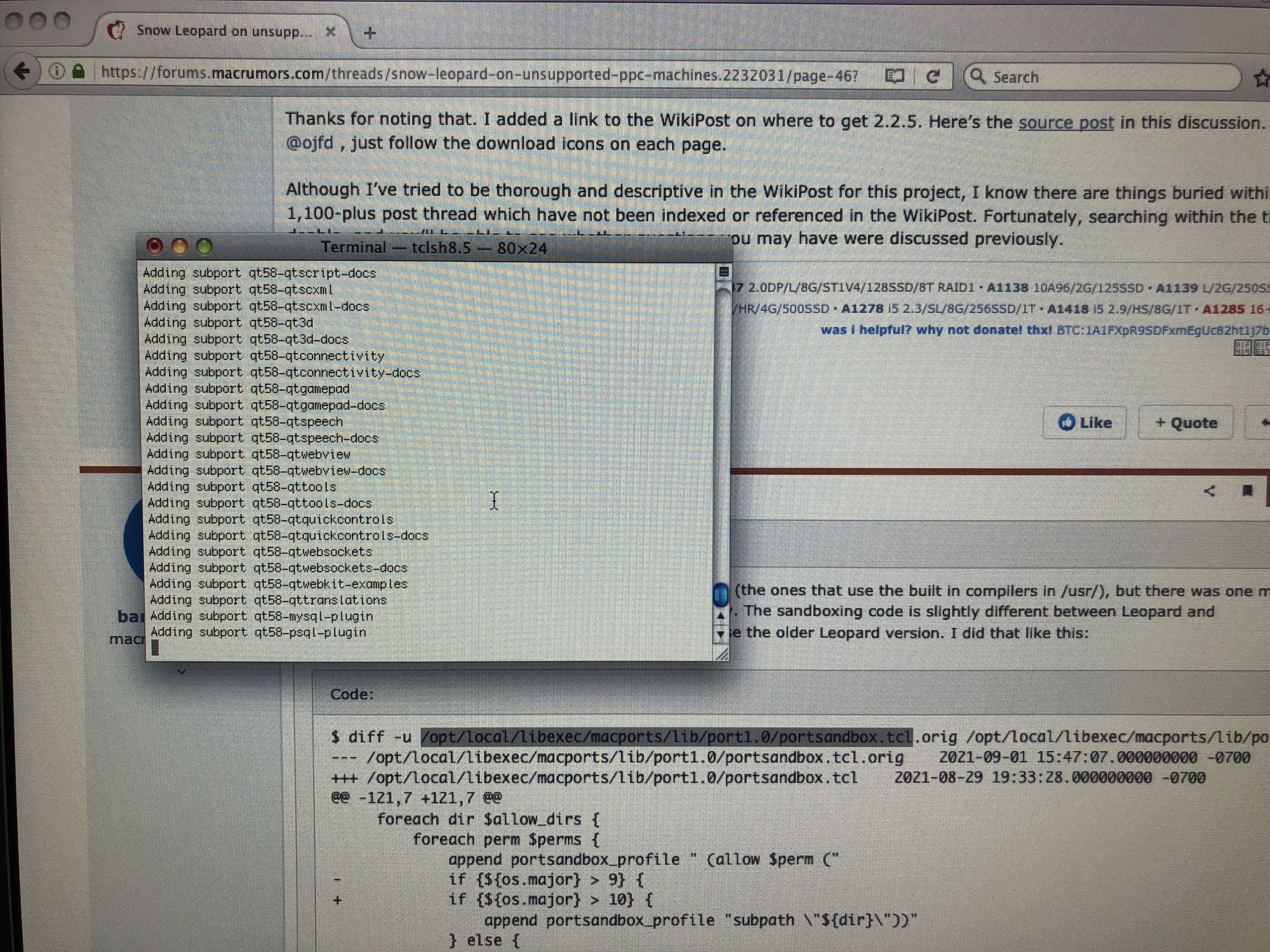

Thanks for noting that. I added a link to the WikiPost on where to get 2.2.5. Here’s the source post in this discussion. Per @ojfd , just follow the download icons on each page.
Although I’ve tried to be thorough and descriptive in the WikiPost for this project, I know there are things buried within this 1,100-plus post thread which have not been indexed or referenced in the WikiPost. Fortunately, searching within the thread is doable, and you’ll be able to see whether questions you may have were discussed previously.
After that, things are close to working for simpler ports (the ones that use the built in compilers in /usr/), but there was one more hiccup to fix before the downloads would work correctly. The sandboxing code is slightly different between Leopard and SnowLeopard, and on PPC SnowLeopard, we have to use the older Leopard version. I did that like this:
Code:
$ diff -u /opt/local/libexec/macports/lib/port1.0/portsandbox.tcl.orig /opt/local/libexec/macports/lib/port1.0/portsandbox.tcl
--- /opt/local/libexec/macports/lib/port1.0/portsandbox.tcl.orig    2021-09-01 15:47:07.000000000 -0700
+++ /opt/local/libexec/macports/lib/port1.0/portsandbox.tcl    2021-08-29 19:33:28.000000000 -0700
@@ -121,7 +121,7 @@
     foreach dir $allow_dirs {
         foreach perm $perms {
             append portsandbox_profile " (allow $perm ("
-            if {${os.major} > 9} {
+            if {${os.major} > 10} {
                 append portsandbox_profile "subpath \"${dir}\"))"
             } else {
                 append portsandbox_profile "regex #\"^${dir}/\"))"
at that point, MacPorts began working correctly. You THEN run "sudo port -v sync" and MacPorts will update it's local copy of all the Portfiles, and then iterate through each one, generating an index of what is happening in the Portfiles. If you run "sudo port -v sync" before you make the architecture changes above, then the PortFiles can be parsed incorrectly (following the default code paths for Intel on SnowLeopard instead of code paths for PPC). So it is best if you generate this Index AFTER you have updated your macports.conf.
Could someone explain how to run this part? When I just copy-paste into Terminal, it does not work.

I have been half-through with Macports set up, but stuck at the last portion about gcc7 here: Sep 2, 2021
I cannot figure out how to use diff, but in earlier cases manual changes via sudo nano worked. Here I do not understand what to do.
Once Fortran compiler is set, I can try building R.
