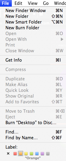

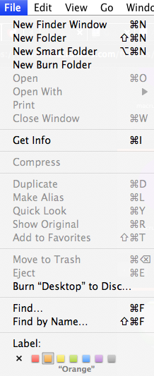

One of the things I’m looking for, UI-wise, is where the label boxes in the File menu and contextual menus live (shown below are the carryover squares from Leopard, as used in 10A96 and probably 10A190 as well). The Snow Leopard 10.6.8 squares are physically smaller, and I’m trying to find those for the 10A96/10A190 UX. If you happen to know, let me know!

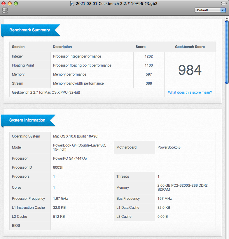

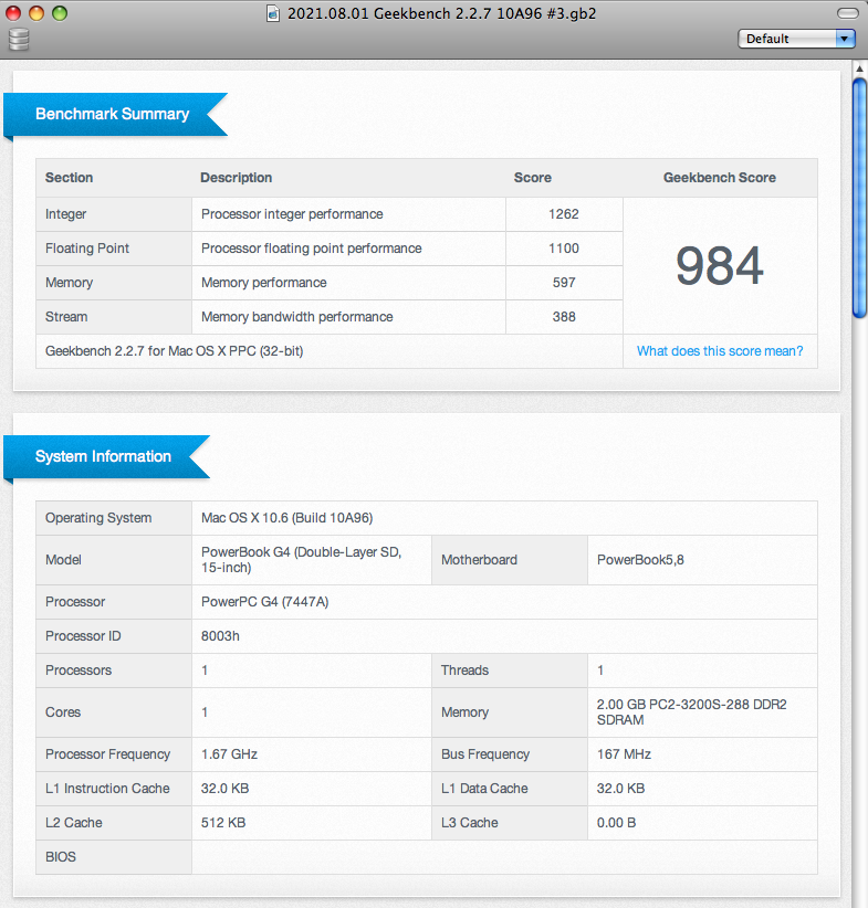

[SECOND EDIT to add: Back in mid-June, I ran Geekbench 2 benchmarks on the test PowerBook which runs 10A96. At the time, the highest scores were repeatedly coming in at 978. Tonight, following all the moves of 10.5.8 Frameworks and other lower-level components to the test build, I noticed the response and turnaround time when logging out, then logging back in and reaching Finder, was perceptibly quicker than much earlier during the project. UI response isn’t something which Geekbench gauges, but it does measure stuff under the bonnet — stuff which stability improvements and updates (from 10.5.8) would probably help. So I did a “best of three” tonight. The lowest was 980, and the highest was 984. It’s a trivial improvement over six weeks ago, but otherwise not bad. As hardware bottlenecks go, I am running PC2-3200/288MHz SO-DIMMs, whereas OEM specs called for PC2-4200/333MHz. At some point, I’ll need to tend to that.]
