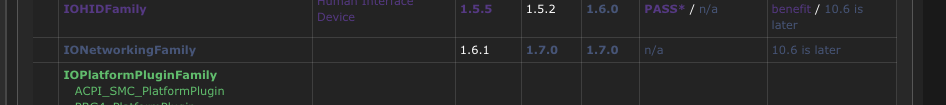

The red-labelled kexts are kexts you should not be sourcing from 10.5.8! The red-labelled kexts are kexts you’re supposed to leave be!
[EDIT TO ADD: I went back to Table 4’s legend to clarify how bolded version numbers only represent the later version number, not whether it’s suitable or compatible with 10A96 and/or 10A190.]
The system still boots up fine with the kext upgrades I did do, but downgrading the networking kext in particular didn’t fix anything and still results in an apipa address under 10.6 (10A96).
I tried downgrading the networking kext and no change.

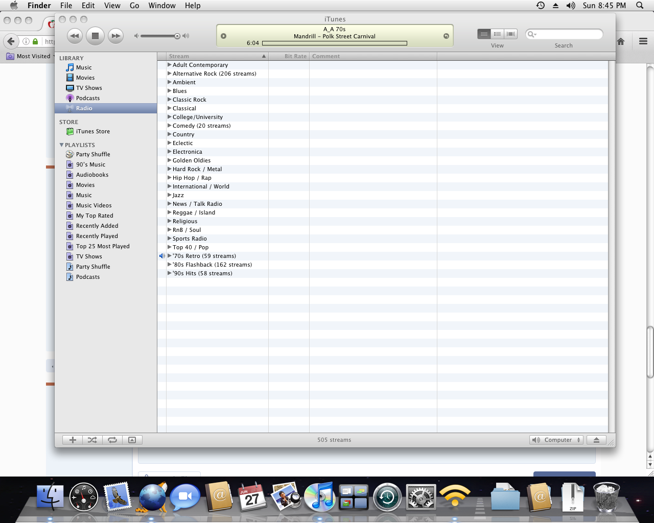

I just had to reinstall it to fix it. Updated iTunes to 7.7.1 after said reinstall, as 9.2.1 has broken radio functionality and like stated the HUD that displays track names is super glitchy (when changing tracks) and is missing it’s background. I’ll be trying nubango with it when it is at a point where it can be remotely hosted.

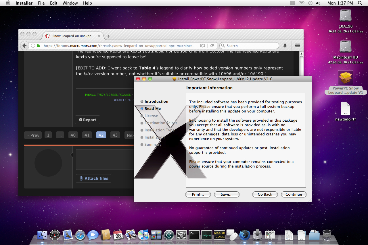

Hi all!
In preparation for a future 'Combo Update' for Snow Leopard on PowerPC, which will include the files i've been working on as well as essential community fixes discovered in this thread, i have prepared a test update package.
The attached installer will update the system LibXML2 library and binary files.
Please test and report findings on this thread. If this update is received well, i will aim to provide more substantial combo updates in the future.
Many thanks
  • PowerPC Snow Leopard LibXML2 Update V1.zip

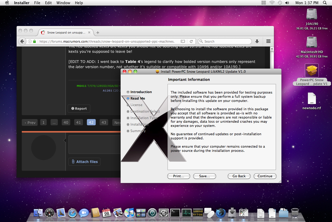

Hi all!
Many thanks
