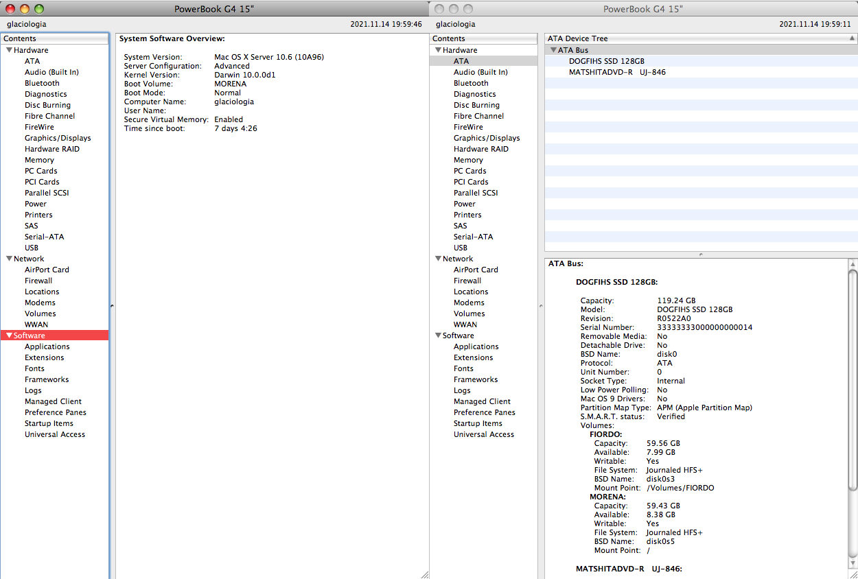

SSD works fine. My testing Mac runs with an m.2-to-PATA adapter.
It’s the protocol negotiation you need to be aware of.
If you’re on a PATA bus Mac, the adapter renders the m.2 or mSATA SSD as a PATA/IDE drive (as seen by the Mac). That’s what you see above.
For SATA bus Macs, such as the G5s, the trick is the m2-to-2.5" adapter needs to be able to auto-negotiate to SATA I/II speeds. In my experience, current m.2-to-SATA adapters tend to do fairly well with this. It’s what I use with an earlier MacBook Pro.
The challenge here is that some SATA 2.5-inch SSDs, especially earlier SATA III SSD models, will only work at SATA III speeds and will not auto-negotiate down to SATA II or SATA I on a slower SATA bus (generally, SATA II will work without trouble on a SATA I bus). When this happens, your SATA Mac will not boot from that drive (or will have a very difficult time doing so). This was an issue I had with a 2011-vintage 2.5-inch SATA III SSD and my G5. At the time, I chose to buy an older, SATA II SSD as the workaround and I traded the SATA III drive to someone who needed it. Were I to replace that SATA II SSD nowadays, I’d probably get an m.2 SSD and buy another m.2-to-SATA adapter, as this solution is pretty cheap these days. These adapters tend to work pretty well, and the on-board circuitry in these adapters appear to auto-negotiate in the presence of a slower protocol bus (either that, or else the auto-negotiation is happening at the m.2 controller).

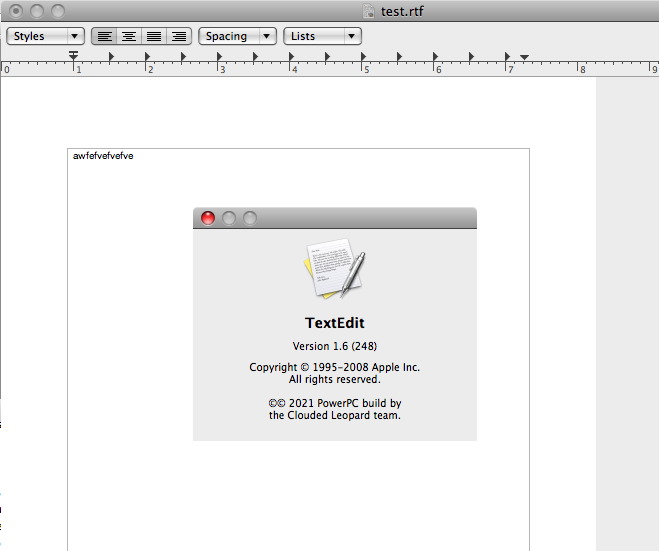

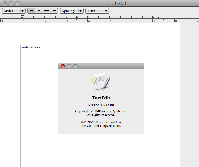

I must know… what exactly did you do here? It’s a PowerPC binary, version 1.6, and it works (i.e., it saved a test .rtf), but TextEdit is not part of AOSP. How did you build it? EDIT: n/m I now see what you wrote in a separate post… dang this thread is fire tonight.

I explored the folder and built this the first time last year and also attempted to build the versions from Lion and Mountain Lion but they require some later frameworks according to my recollection. It’s possible with modifications to the code we could get them working down the line or at least port some features into 1.6 but as I’m focused on parity with 10.6.0 still i set that aside for the moment. It was only when i was looking back through the thread that i realised I hadn’t already shared this with you guys - so i thought i’d offer it up now.

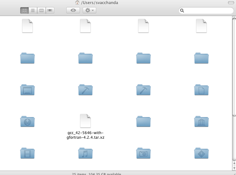

Yes, Finder is hopeless, I just quit it on start up.
A curious thing in Xcode 3.2 from 10A96 is I found two different “example” project directories for TextEdit.
The first one, at /Developer/Examples/TextEdit, failed to build (with 3 warnings and 5 errors). I noticed this source had 14 source files.
The second one, at /Developer/Examples/AppKit/TextEdit, successfully built (and with no warnings or errors). This one had 13 source files.
Not to leave good enough alone (and also bemused by the irony that the TextEdit 1.6 which shipped with 10A96 won’t save RTF documents but this home-build will)…
I would have liked to build it with the same four-language support as Build 10A96 on the whole, but this is good enough for now. :)
Also, it would have been nifty had there been other example projects we could have used.

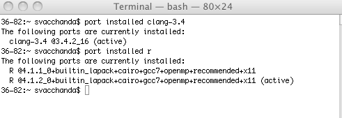

Not sure of its utility, but in addition to the latest R, I also compiled Clang, though an archaic one:
