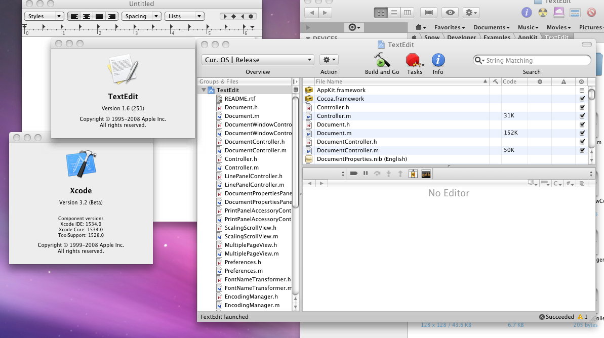

I have just built TextEdit with Xcode 10A190:

  • I can confirm that the build of TextEdit @barracuda156 compiled on Build 10A190, using the Build 10A261 Xcode sample sources, launches and runs correctly on Build 10A96. Thanks for sharing that! :D
