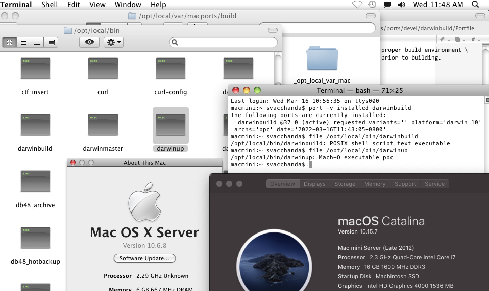

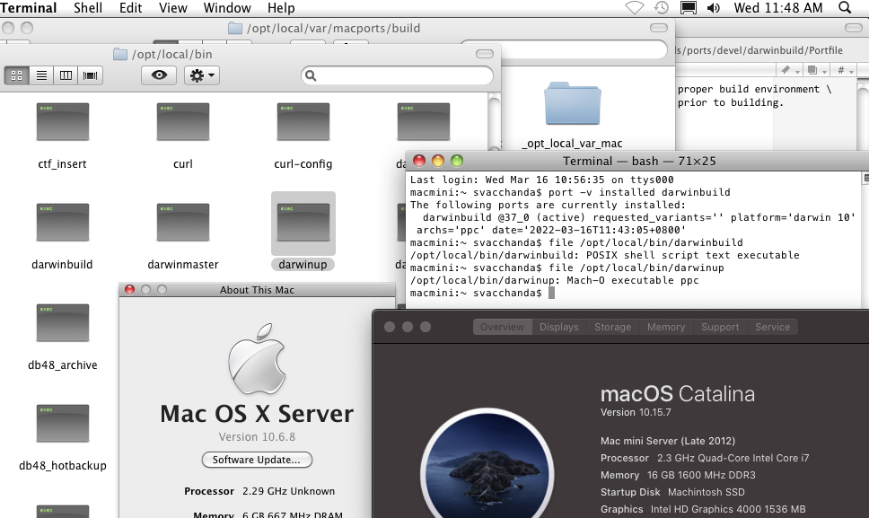

macmini:~ svacchanda$ sw_vers
ProductName: Mac OS X Server
ProductVersion: 10.6.8
BuildVersion: 10K549
macmini:~ svacchanda$ port -v installed darwinbuild
The following ports are currently installed:
darwinbuild @37_0 (active) requested_variants='' platform='darwin 10' archs='ppc' date='2022-03-16T11:43:05+0800'
This was surprisingly easy: all I had to do is edit away +universal requirement in portfile and edit arch in prefix.xcconfig (plain text file).

2. Thank you for clarifying, I wanted to make sure if darwinbuild is broken just for me or inherently. Xcode project of it lists ppc archs as valid, only darwinbuild itself is set to build as Intel (which can be changed manually). But yeah, I guess some frameworks or w/e may be just missing on PPC. I will give it a try, when I have mood. I suspect I tried on 10.6.8 before and it failed.
So when you build system components from AOS, you do it without a specific environment? I wanna work on this part, but dunno really where to start.

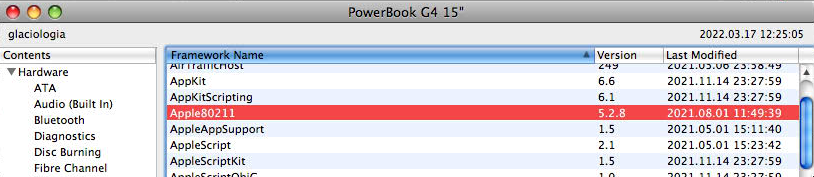

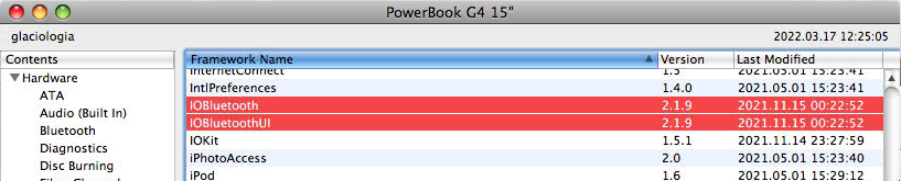

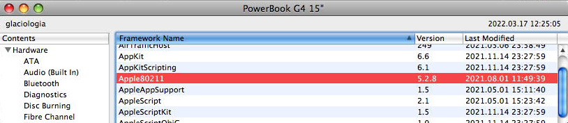

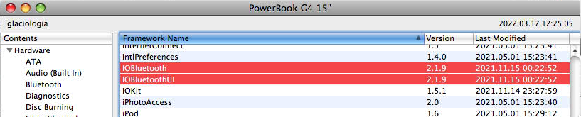

Has anyone been able to fix Blutooth on 10A190 by the way?
Airport fails for me. Replaced airportd, all kext, frameworks etc with ones from 10A96 – airport can be turned on, it sees networks, but fails to connect.
/S/L/CS
/S/L/CS
/S/L/CS
/S/L/CS
/S/L/CS
/A/U
/S/L/F
/S/L/FAVRCPAgent
Bluetooth Setup Assistant
Bluetooth Audio Agent
BluetoothUIServer
OBEXAgent
Bluetooth File Exchange
IOBluetooth
IOBluetoothUIBluetooth service 2.1.8
2.1.8
2.1.8
2.1.8
2.1.8
2.1.8
2.1.9
2.1.92.1.1
2.1.1
2.1.1
2.1.1
2.1.1
2.1.1
2.1.1
2.1.1PASS* / TBD 10.5.8 elements load in 10A96; untested w/ BT hardware
F /S/L/PrivateFrameworks/Apple80211 wifi service 5.2.8 5.2.1 PASS* loads; unknown impact
/A/Utilities AirPort Utility 5.6.1 5.3.1 YES* TBD
/S/L/CoreServices
/S/L/CSAirPort Base Station Agent
Apple80211Agentwi-fi service 1.5.5
5.3.31.5
5.3TBD
TBD
Have you been trying to drop on the 10A96 components into 10A190, or have you been trying to drop in the 10.5.8 components into 10A190?
Although I haven‘t been able to test BT/AirPort hardware directly on my test Mac, I have been able to verify that the following components brought over from 10.5.8 do load correctly on 10A96. The following are those elements brought over from 10.5.8 which have loaded and/or launch in 10A96 (emphasis here on the Frameworks):
Thank you. I was using 10A96 components (with no luck). Will try those from 10.5.8.

I don’t yet want to complicate this too much, but…
I’m having a closer look at the solution presented in #513 and seeing how the 10A190 fix relies on components from 10A96, even as I was moving components from 10.5.8 into 10A96 in my testing (emphasis for a reason). The components brought over to 10A190 from 10A96 in #513 aren’t entirely homologous to what’s in 10.5.8.
For instance, there’s an AirPort.framework in 10A96 (and 10A190); there isn’t one in 10.5.8. How this change impacts functionality is likely vital, but something I don’t yet know.
Additionally, there’s an AirPort-related component from 10.5.8 whose version number is lower than in 10A96/10A190 (and also why it’s no longer listed in Table 4): IO80211Family.kext. In 10.5.8, it’s version 2.1.6; in 10A96, it’s version 3.0.0. I don’t know what version is in 10A190.
Keep these in mind when making your moves from 10A96 and/or 10.5.8. I’m curious to learn what you discover.
