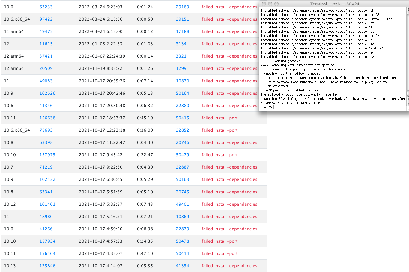

offtop mode on / I recall we had a discussion about a case when a port is showing as failing on Macports port health status. I forgot where, but anyway. I wanted to create an illustration of my point that port health does not translate into "port cannot build" and found a port that was failing on literally every system and had 0 successful installations - gnotime.
Well, here we go:
I had to fix guile, gnuregex and libgnome dependencies for 10.6 PPC and file a ticket for qof dependency, which yesterday got fixed. (So now you will see that gnotime has few successful builds - that's because qof now builds.)
Hasn't been as neat as I expected, since qof turned out to have an annoying bug, but anyway, I guess point is proven.
/ offtop mode off

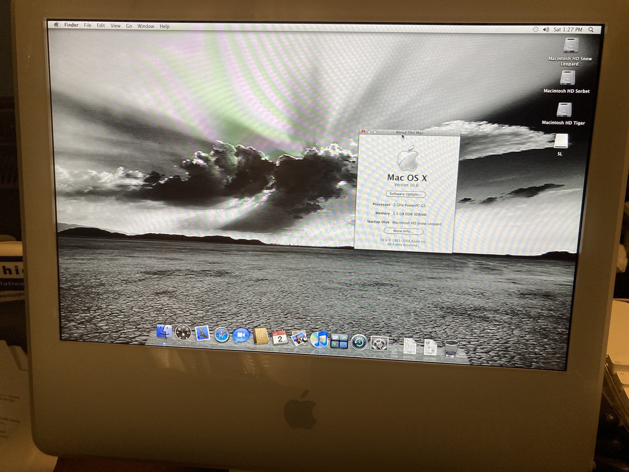

I’ll let you know, it’s the first machine I’m going to try
A lot of us have been wondering about the final iMac G5s with iSight, as these do feature a redesigned logic board and PCIe buses. Given what we known to date regarding video support, only PCIe (and rare PCI) systems have shown full hardware support with the SL-PPC test environment.
Our hope is that we can determine whether these iMacs are able to provide hardware-level support of Core Image and Quartz Extreme with the Radeon X600 Pro and XT variants bundled with the 1.9 and 2.1GHz variants. Said hardware support may work without needinging bring in 10.5.8 components/kexts/frameworks, or it may require copying those over 10.5.8 ATI-related kexts.
Reactions: ChrisCharman
I hope it wil, providing that this Mac will survive the day... you know about the memory controller (thermal paste is fresh and new)Picture 1.png
