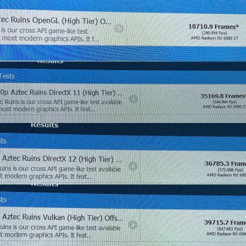

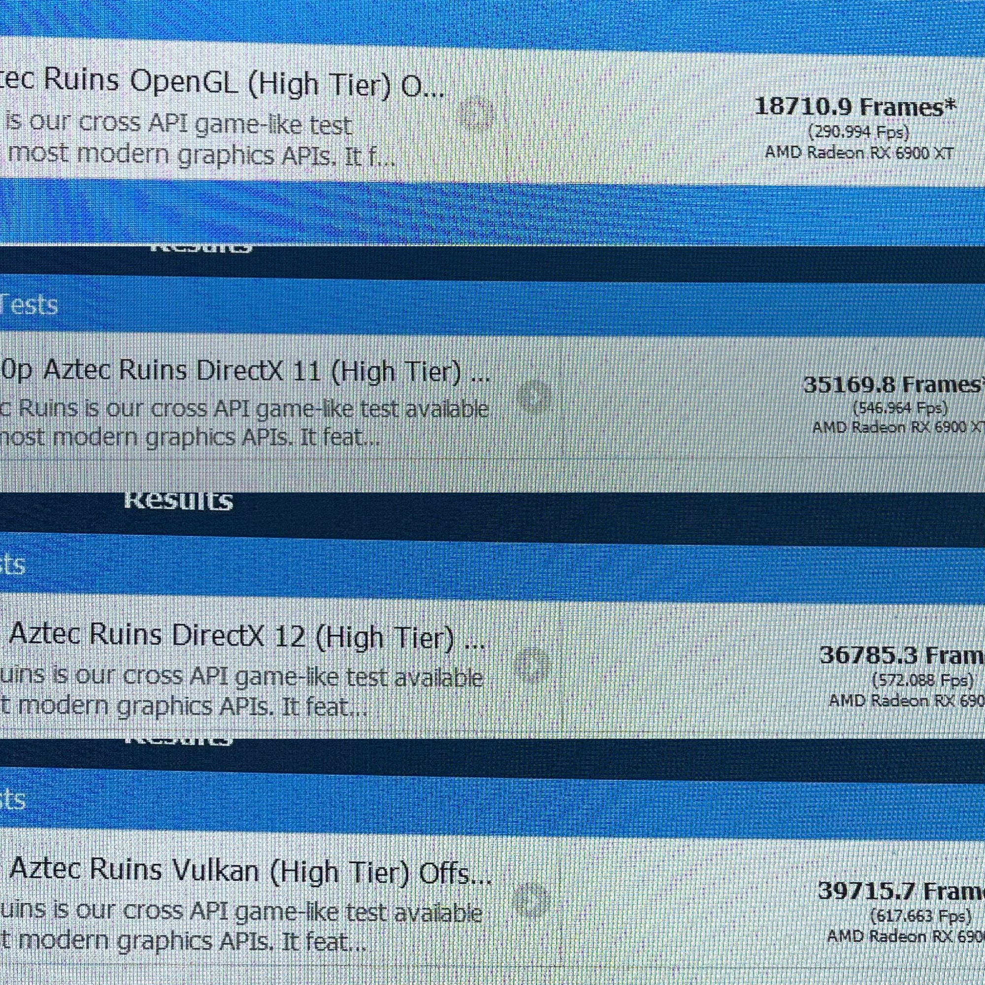

Okay I am not sure how I feel about this. I ran a quick test on my 6900xt and got vastly different scores depending on API chosen.
I wouldn't say the 3080 Laptop scores are suspect, but they could be missing results (if you sort it appears the Vulkan and DX12 tests were not ran).
Which also is ridiculous as there is a vanilla M1 with a 800FPS score.API overhead and implementation details have a non-trivial impact at these high framerates. That’s also why GFXbench is not very good, it’s simply not demanding enough. But it can be used to approximate things to a limited degree. It’s best to compare the best score to the best score.

I say that because on the score browser the 3080 laptop gpu is missing Vulcan/DX12 scores just like the 6900XT is missing those scores as well. It shows up as failed/not supported which isn't true (clearly I ran the test).I’m not sure I understand the last comment about “appearing to not having been run” but the first part is expected.
GPU benchmarks like these test: how optimally the benchmark was coded in the API; how optimally the driver for the API was written for the hardware; and the underlying hardware.
Creating tests for just the last part is almost impossible. So you just accept that there’s going to be more variation across different tests and more variables underlying the result. And, ultimately, when you are using the GPU all three are indeed what you care about: how well the program was coded for the API, how well does the API run on your GPU, and how good is the hardware at that specific task.
