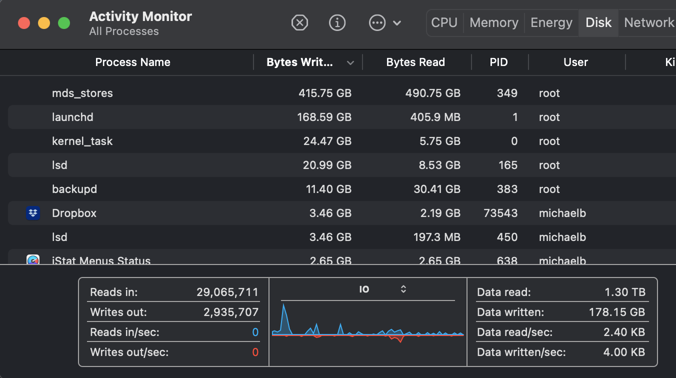

I am OK looking at DriveDx and Smartmontools but don't understand what to look at in Activity Monitor for the same data over the current uptime period. Is the screenshot below (27hr uptime) the one to look at?
Data written is 178GB but the numbers in the "Bytes Written" column add up to much more than that? Even the 178GB number calculates as 6.6GB/h ... ie more than 5GB/h from Smartmontools and DriveDx.

First off your SSD usage is fine, even at the highest number you have. Secondly, it looks to me that you are also writing to an external drive?

Thanks very much. Yes I am using an external so that explains why AM shows bigger numbers. I remember reading that somewhere in this thread now. Is there any way of using AM to monitor this issue if an external drive is involved?
I'm "guessing" (maybe someone else can confirm) that the "Data Written" number at the bottom reflects the local disk only, and that the numbers in the "Bytes Written" column reflect everything. If that's the case, the marginally higher number (than your usual bytes-written/hour, STILL well within acceptable limits), might just be a small spike in usage over that particular period of time.

No, yesterday I transferred about 100GB between 2 external drives and it showed up in the bottom right. But, as soon as I unplugged the external drive that I had written to, the data written number dropped.

Dropped the amount xferred to the external drive?
Actually as related in a video cited a while back the Data Written on Activity Monitor supposedly represents all data written to all drives and not just what is written to the boot up drive. But the number being shown paint a different picture so I have no idea.
Based on his response, it seems that "Data Written" in Activity Monitor gives the total of ALL connected drives UNTIL the drive is disconnected, then falls back to the number for the host drive only. In any case, the "real" number is easily extracted by tools or terminal commannds.
