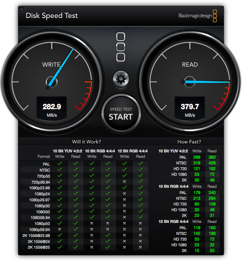

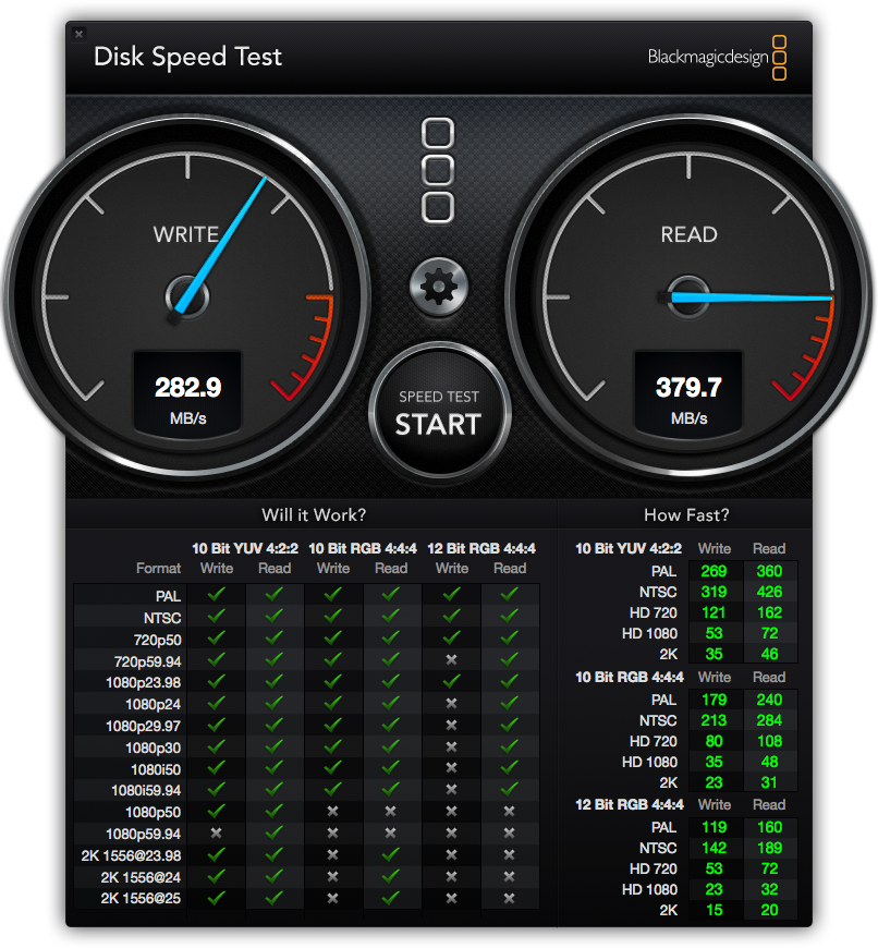

Here is my Transcend 240GB Thunderbolt drive. Used it as a boot drive on my 2011 iMac before upgrading to a Retina iMac. Worked like a charm.
FYI, I get the same speed from this drive using Thunderbolt or using USB 3.0 so, that seems to be the limitation of the drive itself.
