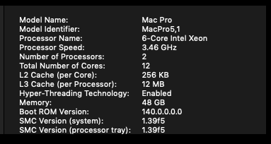

Yes ,but this is a screenshot of his MP:
Or is there a 3,46gHz Nehalem?

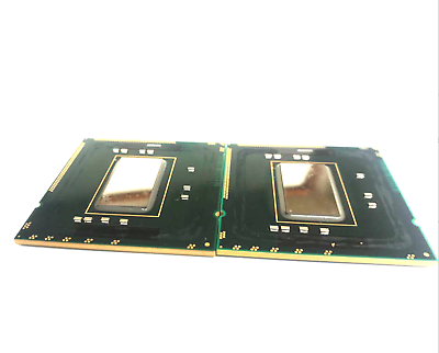

For a dual CPU early-2009 Mac Pro, you need to get a pair already de-lidded, unless you want to do it yourself. If you are asking this, you probably don't know how to do it, so buy an already de-lidded pair. Like this one below:

Only early-2009 dual CPU Mac Pros and the Xserve3,1 models use de-lidded Xeons. Single CPU early-2009 and all models of mid-2010/mid-2012 Mac Pros use lidded Xeons.
De-lidded Xeons are more efficient thermally, but the hassle of installing/upgrading it probably is the motive that made Apple change course.

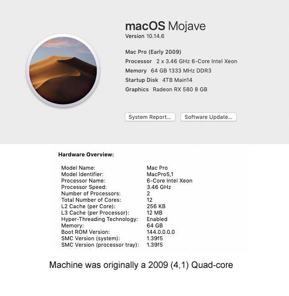

I also want to thank all those who have contributed to this thread. Like others here, I managed to slog thru firmware upgrades and OS versions to Mojave on my early-2009 quad-core MacPro (4,1), then had the stuttering audio issue (which is what brought me here).
After replacing CPUs, stutter is gone on Mojave. So far, all seems to function as expected.
Again, thank you one and all.
