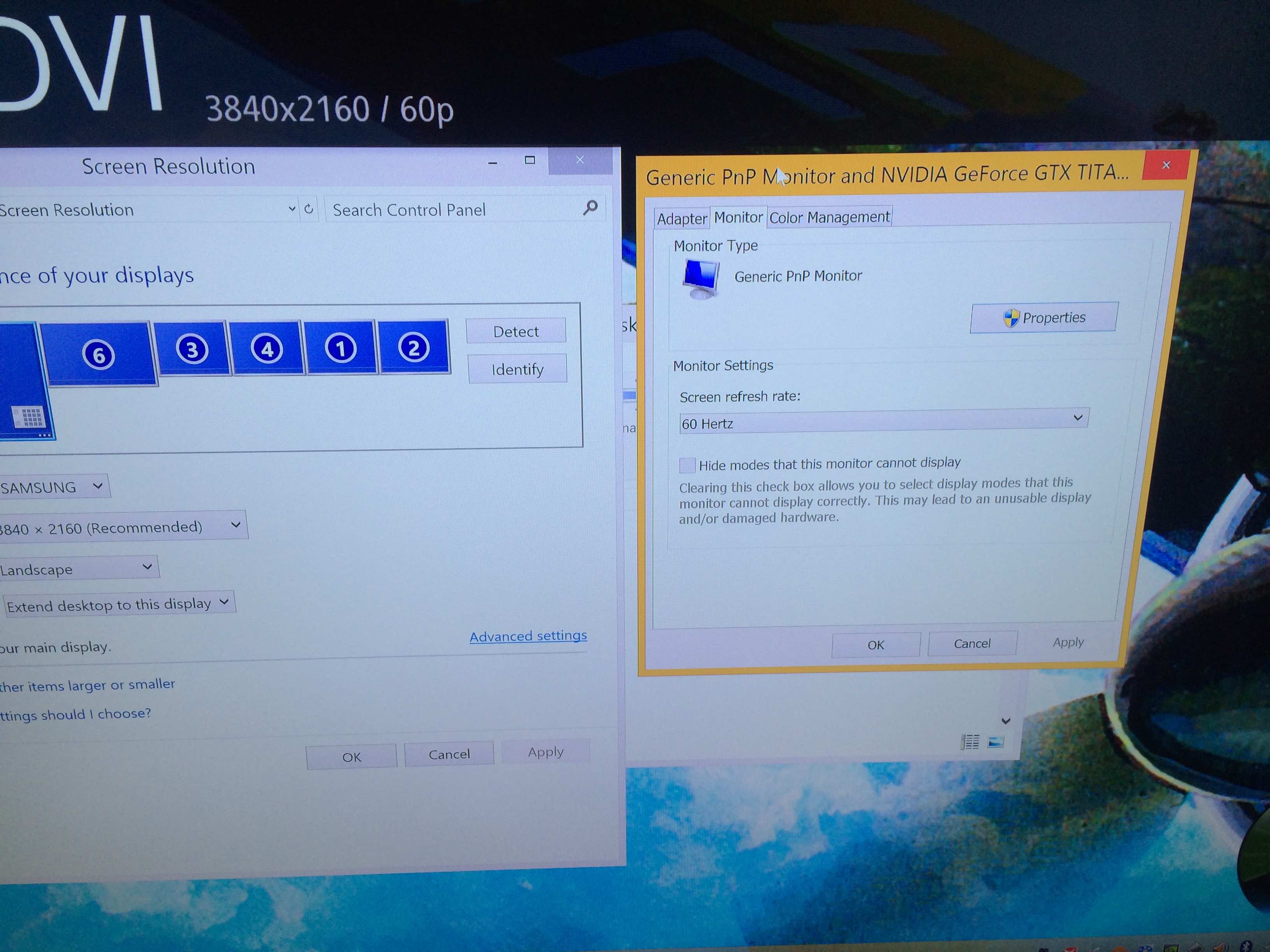

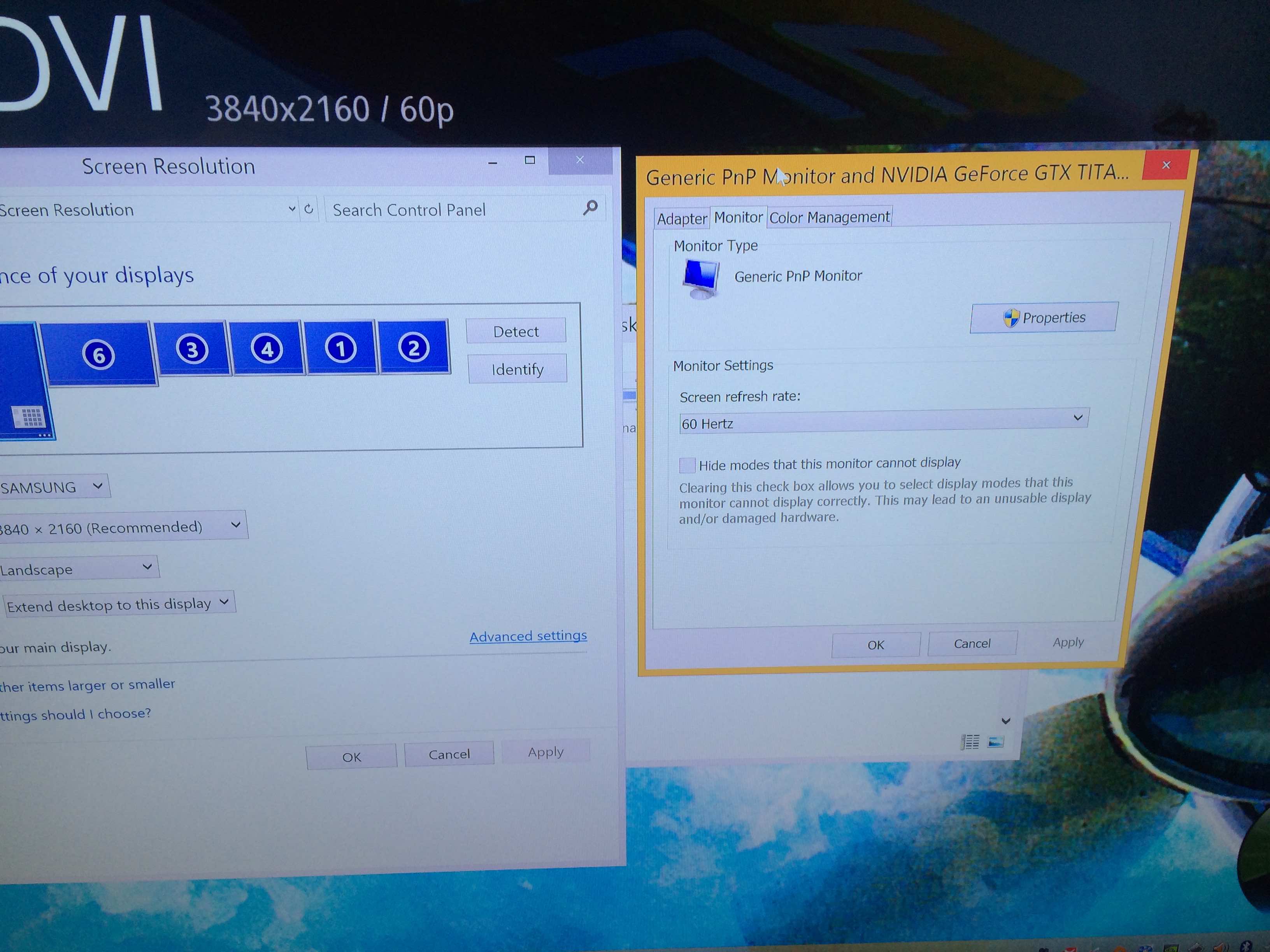

GTX Titan Black HDMI -> 4k 60Hz
Hi I've got trouble getting 4K at 60Hz working under Mac OS X (Yosemite)
In Bootcamp it works fine at 60Hz but in mac its locked to 24Hz and i can't change it because it's greyed out :/
Do you have a solution for this Problem ?
I read about changing of the .kext files, but didn't quiet understand what exactly I should change in the file
Thank's !!
Regards Yackip

Tell us about your setup. Mac, graphics card, monitor?
Mac Pro 5.1, 12x3.33GHz, 128GB RAM, GTX Titan Black, OWC 240GB PCIE-SSD, 2x ATIRadeon
It's a
Mac Pro 5.1, 12x3.33GHz, 128GB RAM, GTX Titan Black, OWC 240GB PCIE-SSD, 2x ATIRadeon 2600 XT
The Titan drives a 23" cinema display over DVI and a 4K Samsung TV (UE55HU6900) via a HDMI 2.0
the two ATIRadeon 2600 XT's drive 4 Lenovo Displays over DVI
I've got the latest CUDA and NVIDIA Web drivers installed.
As I said on Bootcamp it works all fine 60Hz at 3840x2160 :)
I hope it helps :)
PS: The card is a Stock PC card -> therefore unflashed

Titan doesn't have HDMI 2
mhm but I thought 3840x2160 a 60fps was only possible through HDMI 2.0
And I'm getting exactly this at my Samsung tv
Or is there a HDMI standard below HDMI 2.0 that supports 3840x2160 a 60fps ?
Thank's :)

Graphics card and monitor both have to support HDMI 2.0 or Display Port 1.2.
Sell your Titan and get the GTX 980 or wait for the nine series based Ti or Titan.
