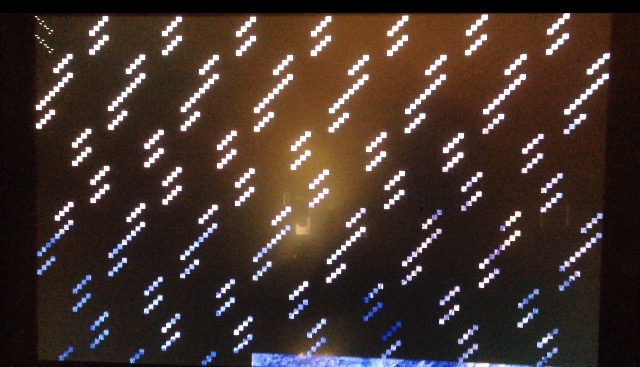

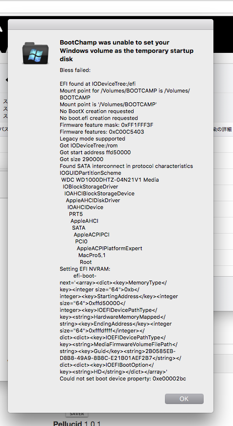

I tried but...
(screenshot)
Edit: Performed NVRAM reset, still bless fail.
[doublepost=1534605913][/doublepost]And now when I shut down it does this:
(Screenshot)

Did you disable SIP? (PRAM reset will ENABLE SIP, you MUST kepp that disable for BootChamp to work)
Are you using any NTFS software in MacOS?

Hello,
No luck, it is still enabled. I do not know why.
So, I would like to try the bless command.
According to my diskutil list, should I write:
Code:
sudo bless -device /dev/disk3s1 -mount /Volumes/BOOTCAMP -setBoot -nextonly
I will attach a screenshot.
Thank you very much.
You could just try disabling NVRAM in SIP, that's all BootChamp actually needs to be able to boot in to Windows.
Code:
csrutil enable -–without nvram
Reactions: h9826790
