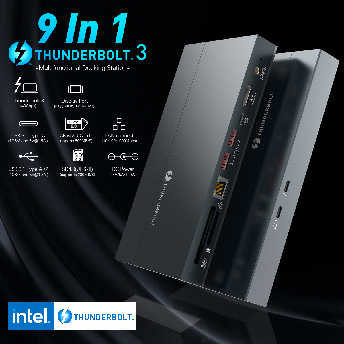

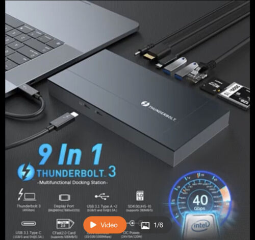

Dirt cheap Thunderbolt 3 hub! $30 USPS priority shipping included.
Normally I would not post limited deals here, but because I have received very good advice on these forums, I am sharing a deal I found. I have no connection to the seller and have no financial interest in any company related to this.
The link is on ebay:
There are 3 left.
It is a TB3 hub, has one TB3 to your computer and 1 TB3 out. It also has 3 USB 3.1G2 10Gbit ports, 1 Gbit ethernet and SD, CF slots, and a 8k displayport, which means it has a modern intel chip. It has a huge power brick.
This no name hub I think is made by rocketek and relabeled.
I have been using a Rocketek version for the last several months on my Studio Max system with no issues. I have a 5k LG monitor connected to the passthru TB3 port, which then limits the available bandwidth remaining. I use that remaining bandwidth to connect to a sabrent USB C 3.1G2 NVMe drive and these 2 fill the 40Gbps bandwidth of a single TB3/4 port on the Studio Max.
It sleeps, wakes without issue. The only minor downside I have found is that the unit runs warm and when the Studio Max is turned off, it still pulls a few watts of power, unlike my TB4 hub from Caldigit.
I paid $70 for my used Rocketek and thought it was a good deal. $30 shipped is a screaming deal. The ebay ones do not come with a TB3 cable. Normally TB3 docks got for $250+.
I ordered one and am running it right now in place of my Rocketek. Works the same. Is the same.
Thanks! I just ordered one on your suggestion. I'm hoping it will work well with my MBA M2. The challenge will be to see if I can run my old 30" cinema display via the display port. I know it's hit or miss and have all the dual link display adapters, etc... which I've gone over in another forum. I was able to get the display to work with an old OWC TB 2 dock, but everything else was painfully slow. I'm hoping this can replace that old TB2 dock and allow me to maybe, just maybe, run two monitors from a MBA. Wishful thinking, I know, but at $30 it's worth a shot (well $30 actually, as I need to order a TB3 cable).

Following up on this. I received my dock and can report it seems to work with a few exceptions:
- The CF card slot will not accept CF cards from my Canon 5DmkII or other CF cards I have. They physically do not fit. I'm not sure what CF card this is designed for, but it doesn't work with the common CF cards used in cameras. The SD slot works as advertised.
- I'm having trouble with getting the Ethernet port to work. It will not recognize the signal. I'm not sure if that is on my end or the device. It finally did connect once, but when it did, I was not getting the full 900 Mbps rate I get when connected directly into my cMP ethernet port. It seems like this is slower. Again, this might be something I'm doing. I'm happy to hear any suggestions. I'm only getting 550 Mbps down and 395 Mbps up, vs the 920 Mbps up and down I normally get. Using a ethernet adapter connected directly to my MBA I'm getting my usual 930 Mbps, so it's definitely something with the dock having slower speeds.
- I cannot get it to recognize my 24" Apple Cinema Display with the Display Port adapter, despite that working when connected to my cMP into the Radeon RX580 graphics card same Display Port jack.
So, bottom line is it's pretty good, especially for $32 delivered, but unless I can get the ethernet port speed and Displayport to work, it might not be good enough.
will check it out. suspect it needs an ethernet driver. I have a monitor that uses dual a dual dvi adapter so I can verify if it works with that.
Which Dual DVI Adapter are you using? I have the Apple one that goes to mini display port. From there I went through the Apple thunderbolt to thunderbolt 3 adapter. What do you mean by a ethernet driver?
I use an apple dual dvi that comes from a mini display port. I also have a displayport to mini displayport that I will test and connect that to the displayport output from the hub. Under the about this mac, ethernet devices, I see the apple ethernet and then I see a USB 10/100/1000 LAN, which is the one associated with the hub. The vendor is realtek and it shows the USB link speed as up to 5Gb/sec which is faster than Gbit ethernet. The default driver is com.apple.DriverKit.AppleUserECM. I know realtek has its own drivers. So first I will test the default apple driver speed and then if it is low, I willl upload the realtek driver and see if it changes,
OK. Tested it with my M1 mac mini. First, the Apple dual DVI display adapter.
I connected the hub to my M1 mac mini using a passive .7M TB3 cable. I connected my displayport cable to the dock. The other end is a Apple mini-displayport, which I connected to the Apple Dual DVI display adapter. The monitor kept trying unsuccessfully to sync. To verify everything was working, I moved the displayport cable over to my CableMatters 201046 USB C to Displayport/ethernet/USB 2 dongle. And it worked with the dual displayport adapter to provide the proper resolution to my display. Next I went back to the hub setup but this time I connected the hub to my M1 mac mini using the Apple .8m passive TB3 cable. And the display worked! I then tried with a another 1m TB3 cable. That also worked. Went back to the passive .7m TB3 cable. Didnt work.
So the hub WILL drive the Cinema Display with the Apple Dual DVI displayport adapter. You need a proper TB3 cable (apple works). Also you need a displayport to mini displayport. I used this one $8: https://www.amazon.com/gp/product/B003N3DTKY/ref=ppx_yo_dt_b_search_asin_title?ie=UTF8&psc=1
Ethernet:
I looked on about this mac and looked at the ethernet port from the hub. It said the GBit was active. Everything seemed to work OK. I did not test it using iperf3 to find out the actual speed. I am wondering if you had a bad TB3 cable, if it would also cause slow ethernet.... BTW, there are 40Gbps and 20Gbps Tb3 cables out there. I bought ONE apple TB3 cable just so I can debug connections. Apple is expensive, but apple products tend to work. The .7m TB3 passive cable that did not work came with one of the accessories (TB3 external NVMe case). I find less than half the cables made in China from no-name brands dont work reliably,.

Some updates. I purchased the displayport to mini displayport adaptor you recommended and it works! The only issue is the brightness keys don't seem to work on the display, which is a bummer. It works on both my 30" Cinema Display and my smaller 24" one. But I can't seem to get it to work at the same time as my 5k Apple Studio Display. I believe that might be an issue with the M2 MBA. I was hoping this dock might be a work around, but I guess not. Any ideas on how I might be able to get that to work?
Re; the ethernet port. There's definitely something on the dock's ethernet port that is throttling the speed. I tried attaching the ethernet cable, via some dongles to the thunderbolt port on the dock and it gets the full 930 Mbps up/down speeds. But when connected directly to the ethernet port on the dock, I'm still stuck around 490 Mbps downs and 348 Mbps up. I'm not willing to give up the speed I'm paying for and don't want to use the only thunderbolt port on this dock for ethernet, so I'm not sure what to do.
The apple 5k brightness issue is an OS issue. Google it. Nothing to do with the hub.
Look at your system report under Ethernet. It should have a usb 10/100/1000 LAN. Vendor name is Realtek. Look at the driver. If it says com.apple.driver kit it is using an apple driver. Look at the link speed. If it says 5Gb/sec that is faster than Gbit Ethernet.
Possible causes: wrong or bad cable. R u using the same cable that gives Gbit? Software configuration. Is the config in settings for the Ethernet the same?
Afterthought - you could get a USB to Gbit ethernet for $15, plug and play
or while u are at it, get a USB to 2.5Gbit ethernet for a little more (need cables, switches that pass 2.5Gbit
Another thought
Try attaching the dongle that you have to the USB C port on the back of the dock!
Thanks. The dongle combo I have is an apple ethernet to thunderbolt2 dongle. That goes into an Apple thunderbolt 2 to 3 adapter. When I plug that into the Dock’s thunderbolt port I get the full 930 Mbps speed. When I plug it into the USB C port, it says it can’t read it because it’s thunderbolt, so no luck. It must be something with the Realtek ethernet port or the Apple driver that it’s using that is throttling it to 500 Mbps. It’s definitely a bummer as that is a key feature I need and it said it can do that speed. I’m not seeing it though.
If you want to risk $15, get the TP link adapter I posted earlier. I have one and it also works fine for me.
