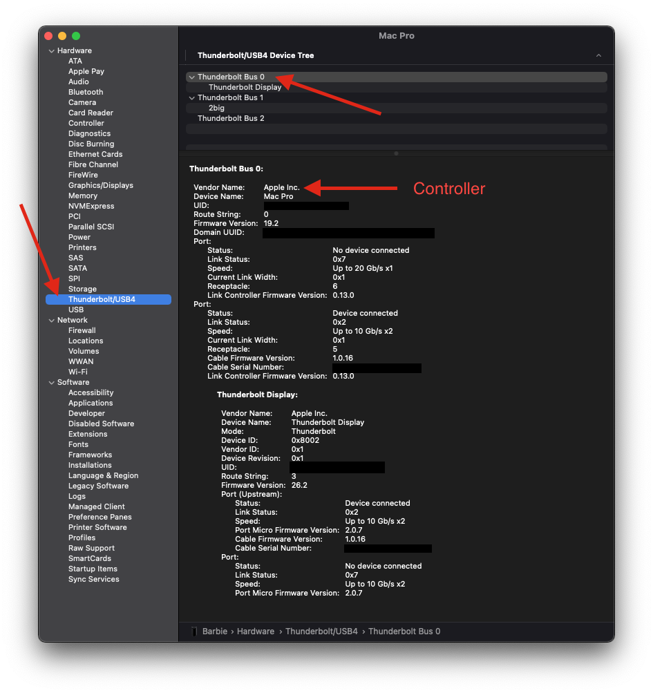

Which TB controller is reported?
I'm not sure what you mean by controller, but the ethernet port on the dock says:
Vendor Name: Realtek
Driver: com.apple.DriverKit.AppleUserECM
When I connect through the faster Apple Ethernet Dongle-->TB3 it says:
Driver: com.apple.iokit.AppleBCM5701Ethernet
I'm still thinking there is something up with the driver on the dock, but am not clever enough to know how to update it.
System Information should let you display the Vendor and Device names for the Thunderbolt controller in the dock.

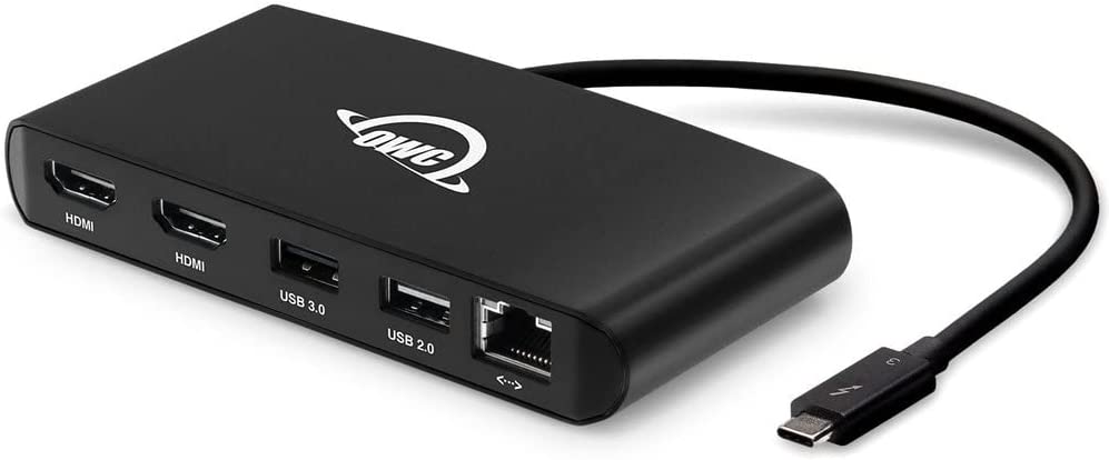

The closest I've found is the OWC Thunderbolt 3 Mini Dock. It has one more HDMI port than I'll use, and I'd have to separately connect a charger, which means this isn't a convenient one-cable solution.
