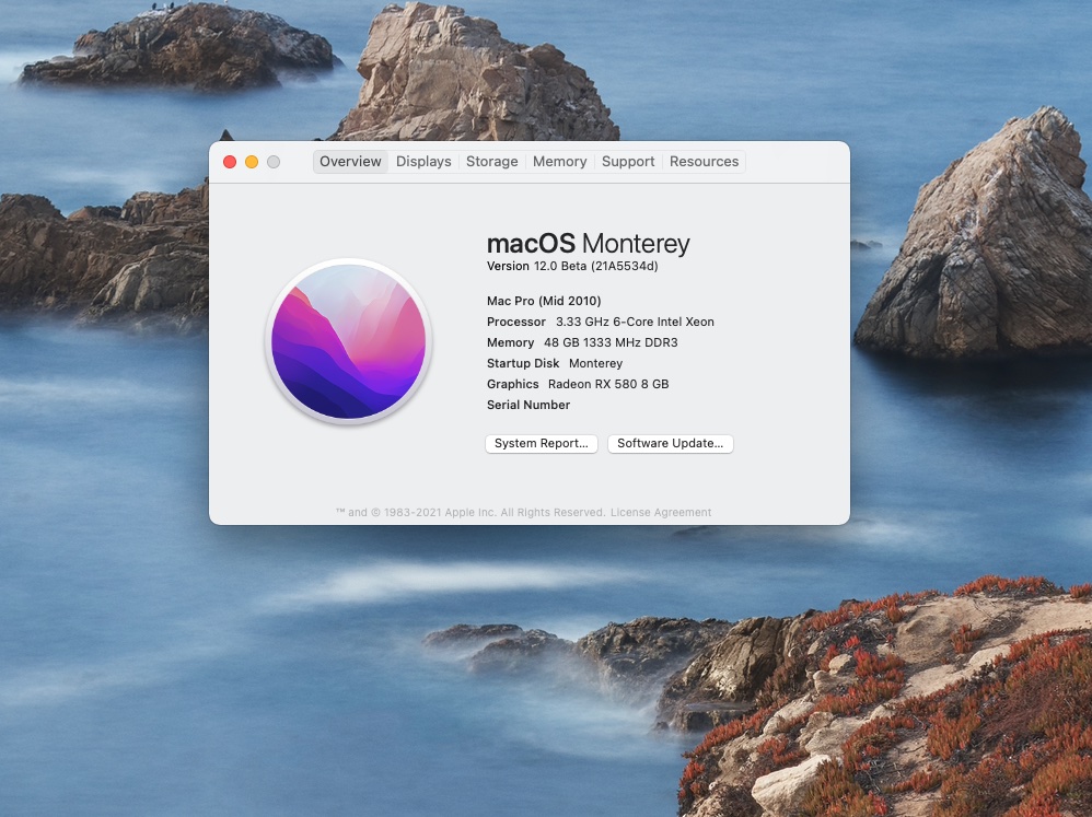

I tried it with installing Monterey Beta 6 (installed from a USB) on NVME drive using a Sonnet card (and Samsung 980 Evo).
This wasn't successful. Installer got to about 80%, did a restart and that was it, black screen, system wouldn't boot up and powered down. I took the Sonnet card out and then the system eventually started up on my normal 11.2.3 but without the Opencore bootscreen. So it looks like that went.
I'm just running the bless script again and about to restart and hoping I get my boot screen back.

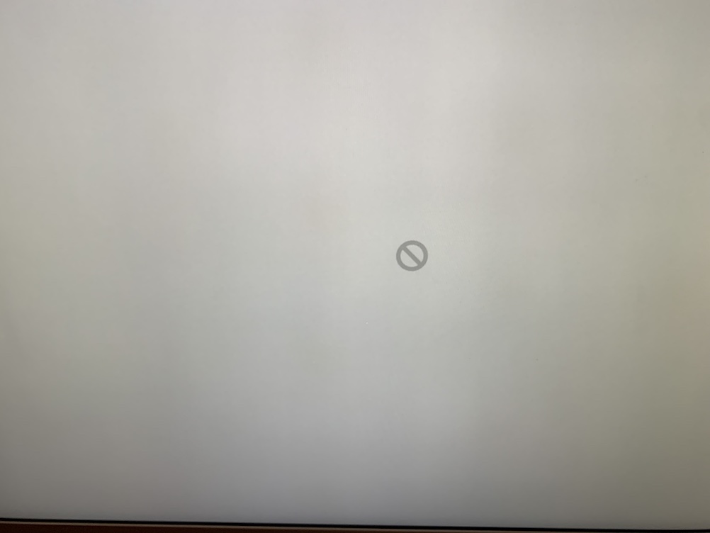

When I did try and let it run (before formatting the NVME) it just gave me the dreaded round circle with the slash through it then switched off.

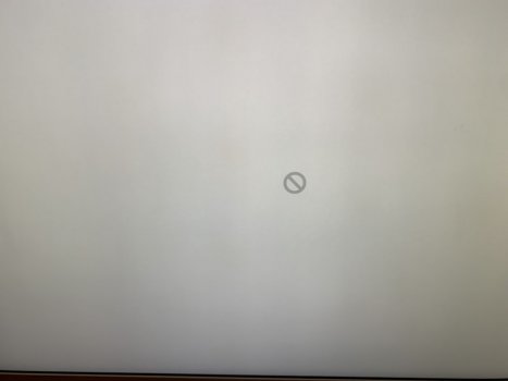

You are not booting from OC.

When I did try and let it run (before formatting the NVME) it just gave me the round circle with the slash through it then switched off.
And yes, I have 0.7.2 config.
That’s a sign that you aren’t booting via OpenCore.
Anyway, do you want to try my pre-configured 0.7.3 V2 package?
This is a known good package. As long as you don’t mod anything, SurPlus should works.
Also, I recommend you completely re-install OC (including run the bless tool) to make sure OC can be activated properly.

I was able to update from Monterey Beta 7 to Beta 8 using SurPlus. Worked flawlessly! I'm still buzzing about this patch. In order to get the update, I had to turn on VMM. Seems like that's going to be the way moving forward.

Hi, just updated my mac pro 5,1 from 11.2.3 to 11.6 with Martin Lo’s package and now im stuck in a reboot loop. Bootpicker comes up, then i see apple logo followed by progress bar and reboot. Has been going on for a couple of hours now. Probably just something i overlooked. Any help would be appreciated.
Force shutdown, wait a few seconds, then start up again, see if the installation can continue after that.
If not, perform a 3x NVRAM reset.
So far, I received one report about racing condition may still there. But I am not sure if that user installed OC and SurPlus correctly. Need more time to confirm what’s happening there. [Update: confirmed that's user error. He hasn't install SurPlus properly.]
Also, his case shows the same symptom as the patch is not there (about 70% chance the cMP hangs during boot, but not infinite reboot). So, I suspect your problem isn’t SurPlus related, but just coincidentally fall into a boot loop due to another reason.
