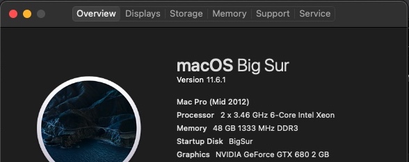

this was unexpected... RC Beta(i think) 11.6.1 went perfect. SurPlus
