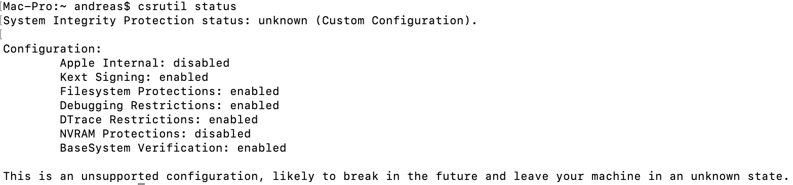

today i update my "handmade" oc install via Martin Lo's latest package (0.7.3 V2).
After everything went fine, i wanted to reenable sip. I did this and now i see the following if checking sip is enabled or not.
In my custom Martin Lo's config plist I just 'commented out' his SIP configuration an enabled the 'AllowToggleSip' instead. Works perfect, you disable SIP on boot when you need it, and it will automatically fall back to disabled on next reboot.
You comment out parts of the config with '<!--' and '-->'. So find the 'csr-active-config' (the first one in Martins config.plist, not the second) and add those so it looks like this:
<key>csr-active-config</key>
<data>fwgAAA==</data>
Then you find 'AllowToggleSip' and change it from 'false' to 'true':
<key>AllowToggleSip</key>
<true/>
This should give you a new icon on the right side in OC boot menu where you can toggle SIP on or off... this is a lot quicker than have to boot into Recovery mode first to disable SIP.

i did like you wrote.
but it makes no difference if i turn sip on or of via oc menu.
if i boot into big sur and run "crsutil status" within terminal, the output stays the same.
Did you try a cold reboot, or just warm?
Edit: Like @internetzel mention in next post, maybe you need a (3x) NVRAM reset?
