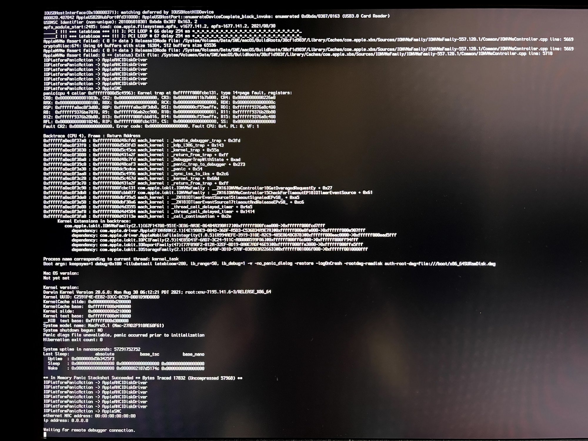

Anyone have any idea... I'm getting kernel panic after installing 11.6
Are those some latebloom arguments there, not sure you are supposed to have those anymore now that there is SurPlus. I'm not the expert on these, but I remember removing them from my OC setup when applying the SurPlus fixes. Do you have any other way to get in and modify that?
You have latebloom installed, and it's unclear if you have SurPlus installed. Please post your config.plist file as an attachment.
eh sorry
I was used to the Tonymacx86 community and over there when someone use a "bump" without anyone got offended 🙃
Thanks for pointing me on the "Force" area of Kext: I read fastly and I placed the SurPlus code in the wrong place.
That said even the updated plist, after some reboot attempt, my cMP 5.1 (4.1) is not able to run Big Sure, so there's something wrong.
The plist you posted earlier has SurPlus in the Kernel/Add section, it needs to be in Kernel/Patch. If you're still having problems, please post your updated config.plist file as an attachment.

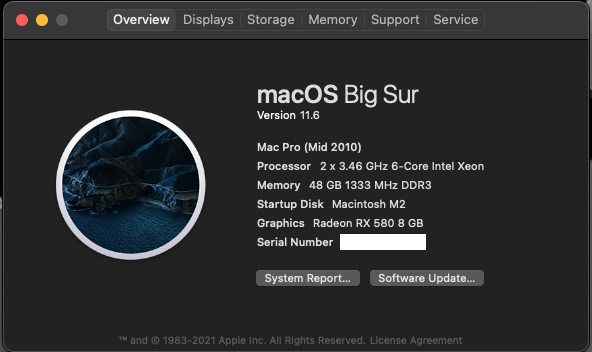

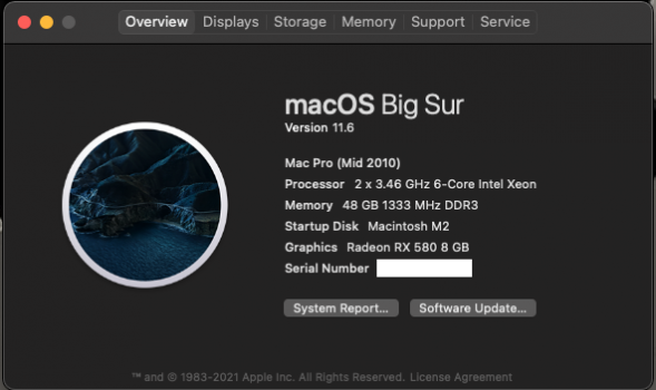

Just another positive data point. I upgraded my 2010 MacPro 5,1 from Catalina to Big Sur 11.6 tonight. I'm using Martin's 0.7.3V2 package, unmodified. I have an updated WIFI/BT card that is recognized natively in Big Sur. The update went very smoothly. I've also got a full PCIe complement of cards with an M.2 NVMe startup drive, a Pro Tools HDX card and a UAD Octo card. Music software is running great, no issues at all!

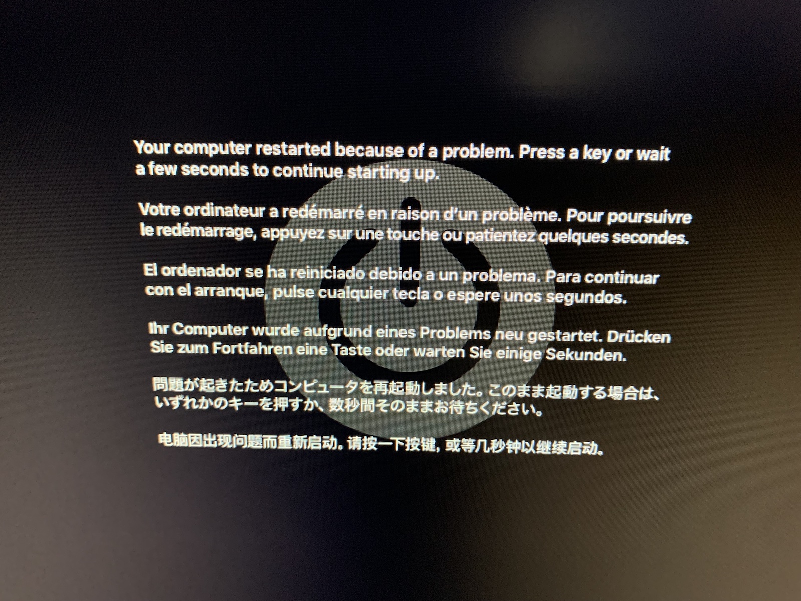

I just had a random restart when attempting to turn on the computer:
I have the PLIST I downloaded before in this topic, no changes made since.
1. turned on computer
2. chimed
3. OC boot menu
4. chose the 11.6 Big Sur on the NVME Samsung 980 Pro (connected via Sonnet card)
5. black screen/restart then it worked
Note: the OC 0.7.3.1 is not on the NVME drive, it's on a normal 2.5" SSD drive connected via SATA.
If there is somewhere I can look, I'll post a log if you advise me where to find it.
I had no issues before this - everything seemed to run perfectly. So if I can find anything that will be of use, I'll provide it.
