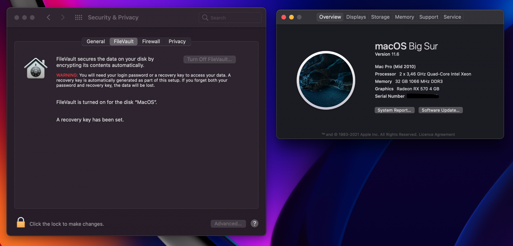

OCLP 3.0 updated on my Mac Pro 5,1 - 11.3 to 11.6 installation went smoothly. Thank you so much.
Saw the donation link and acted on it. TY.

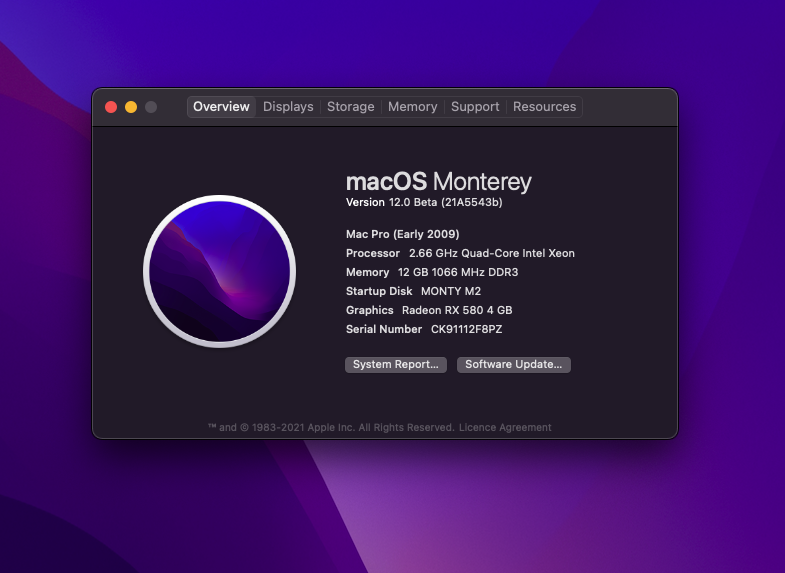

success with beta 9 installed from desktop with the full installer from mr Macintosh
opencore 0,7,4 with SecureBootDevice disabled and the vmm flag enabled
