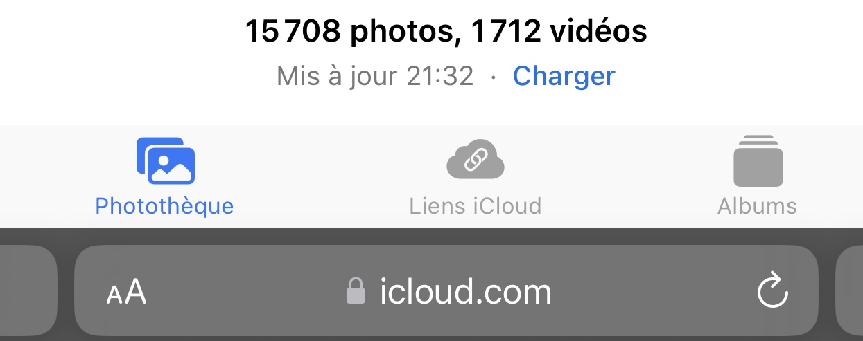

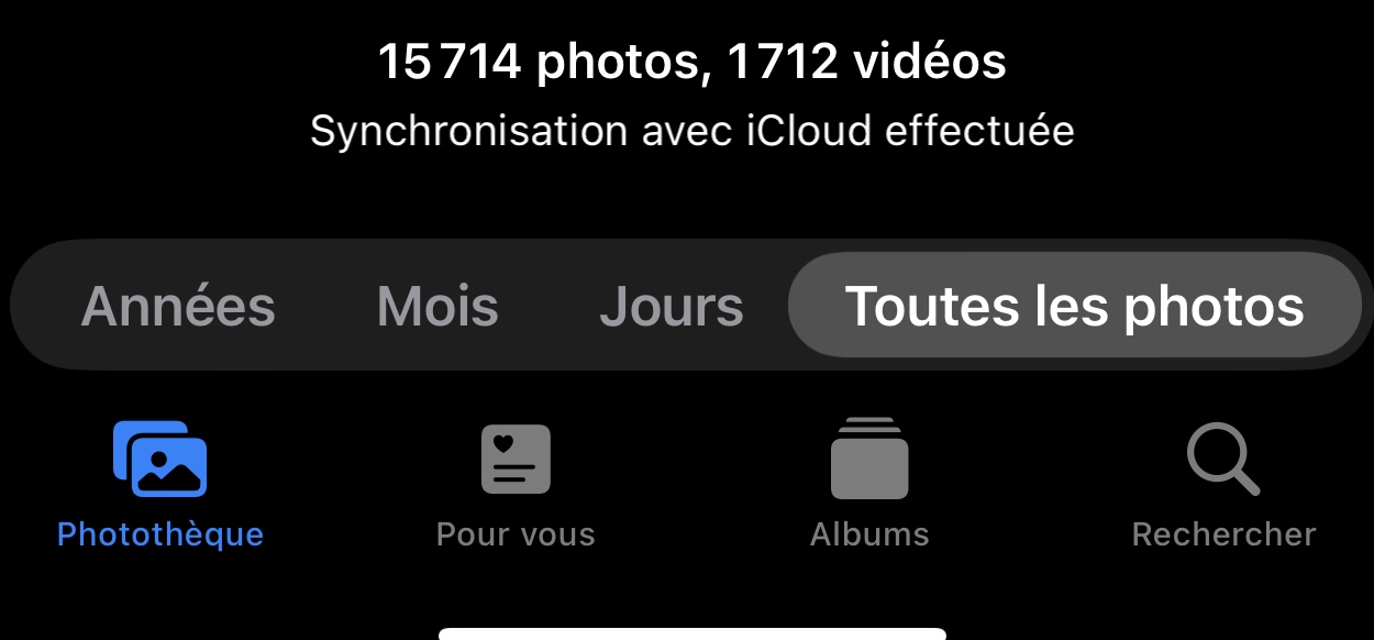

It depends on your Photo settings. Do you use Optimize iPhone Storage or Download and Keep Originals. First option only downloads thumbnails and the second downloads photo's in original full state.
Wondering if a setting like this could be your issue.

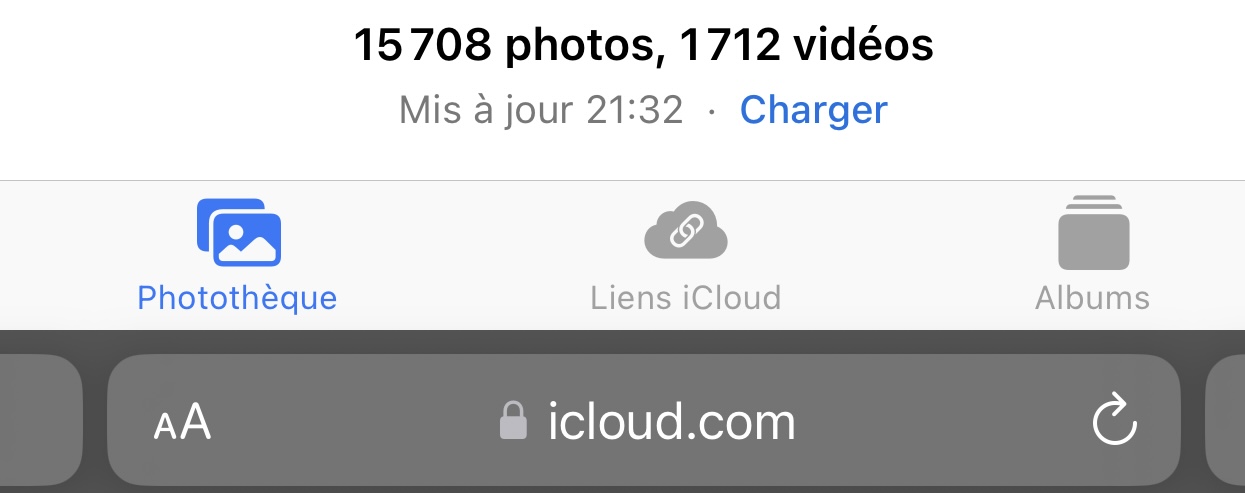

I always had the optimize iPhone storage settings. I am at 26GB storage data now. Oscillating b/w 25/27GB. No idea why.
iCloud.com vs photo about the same.

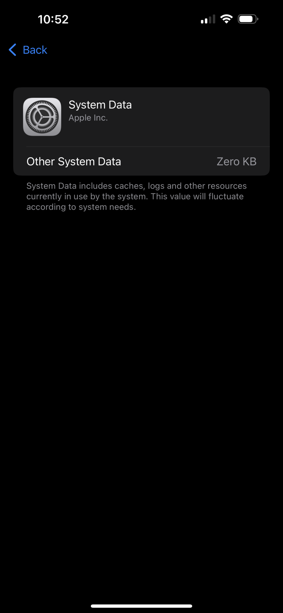

I had a similar issue after upgrading from iPhone Xs Max 512gb to 14 Pro Max 512gb using the Bluetooth transfer from the old phon to the new one (il the new phone did crash during the upgrade) I only notice this issue after upgrading to 16.02 and then 16.03 within a week. I have less than half of the storage used but system data would creep up during the day which I had to use a hard reset to clear the system data.
Rang Apple support which was not much help telling me it’s photo sync issue and reinstall using iCloud. The thing is I don’t use iCloud photo back up at all ( got a NAS for that). I was going to sign up to a larger plane until I found this thread.
Tried initially deleting WhatsApp and reinstalling it. This worked for half a day than the data creeped back again.
I did a hard reset until the picture to connect to computer than rest again but this action did not resolve the issue either. Saw that TV app could be the cause, went ahead downloaded all the possible movies I had in my old phone and more and saw the system data hovering between 25.5 to less than 30gb. After 10+ moves later I did a hard reset, the system data went to “ZERO BYTE”
It stayed at zero for the whole time since! I did check some other people’s iPhone, one had zero byte also and other’s had up to approx 18gb. One person’s iPhone was particularly interesting to me that only Facebook and one or two other app’s used (total storage usage of 30gb) and system data took up about 8.5gb which seems a lot to me.
Hopefully this may help someone and it stays like this for my phone from now on.
Cheers

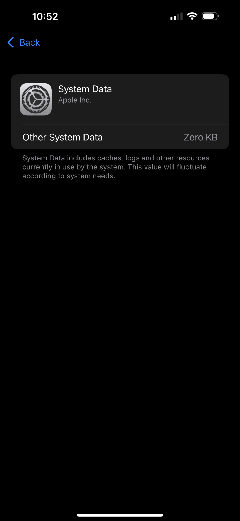

Cheers
