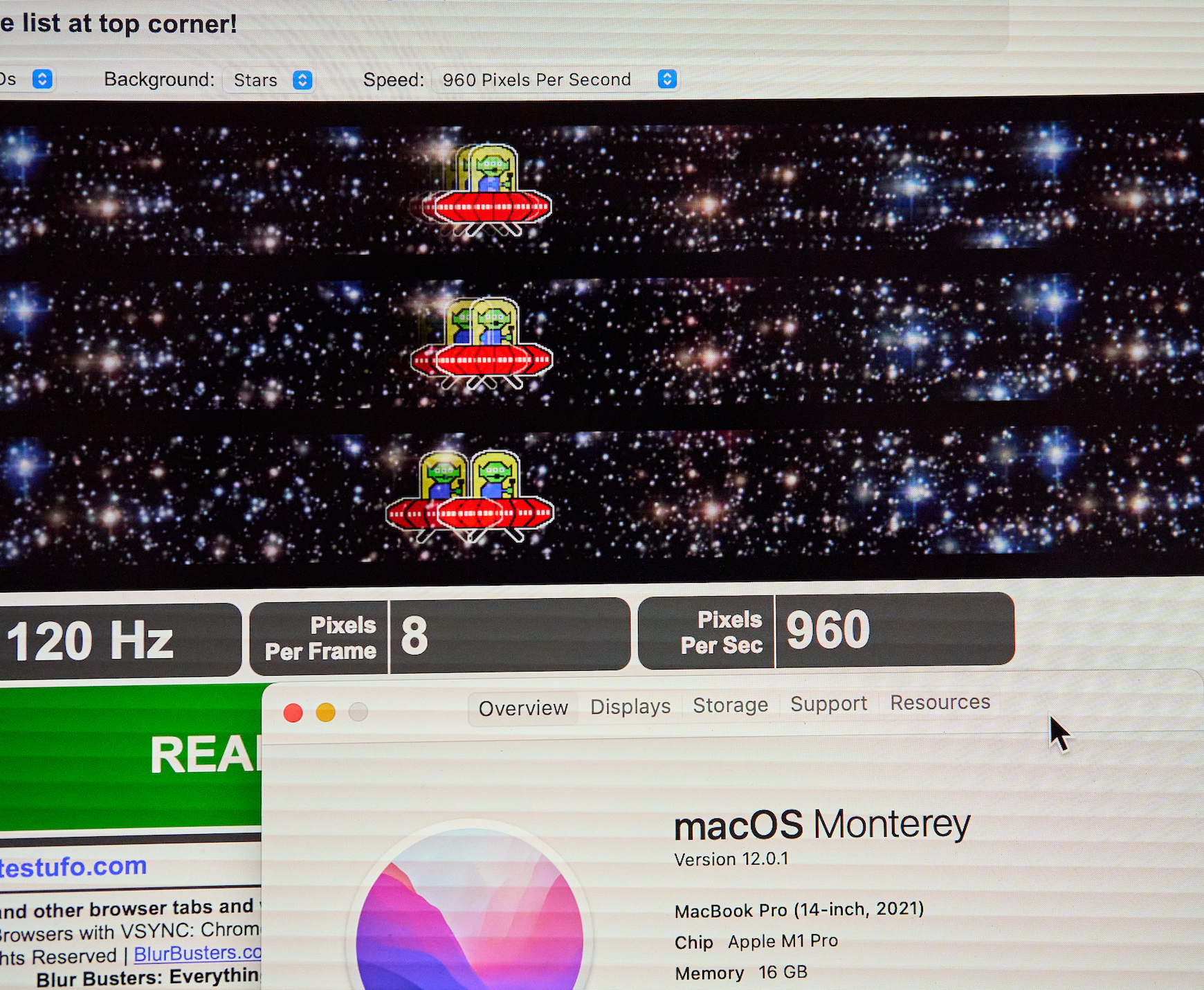

Might be relevant for those who want to see it. I took my camera out, set it to high speed and took a photo of the 120Hz UFO on my 14":
To my naked eyes and to the camera at 1/4000th of a second, 120Hz (on top) is much less blurry (previous frames have pretty much merged into the UFO in the current frame) versus 60Hz and 30Hz. In fact, 30Hz is just a blur to my naked eyes because the previous frame is still mostly there but the current frame has already finished rendering.
This is where we can clearly see that 120Hz actually helps this display tremendously and makes it look clearer than if it was at 60Hz and 30Hz.
Interesting! Looks like the higher refresh rate does affect the response time, quite a bit.
