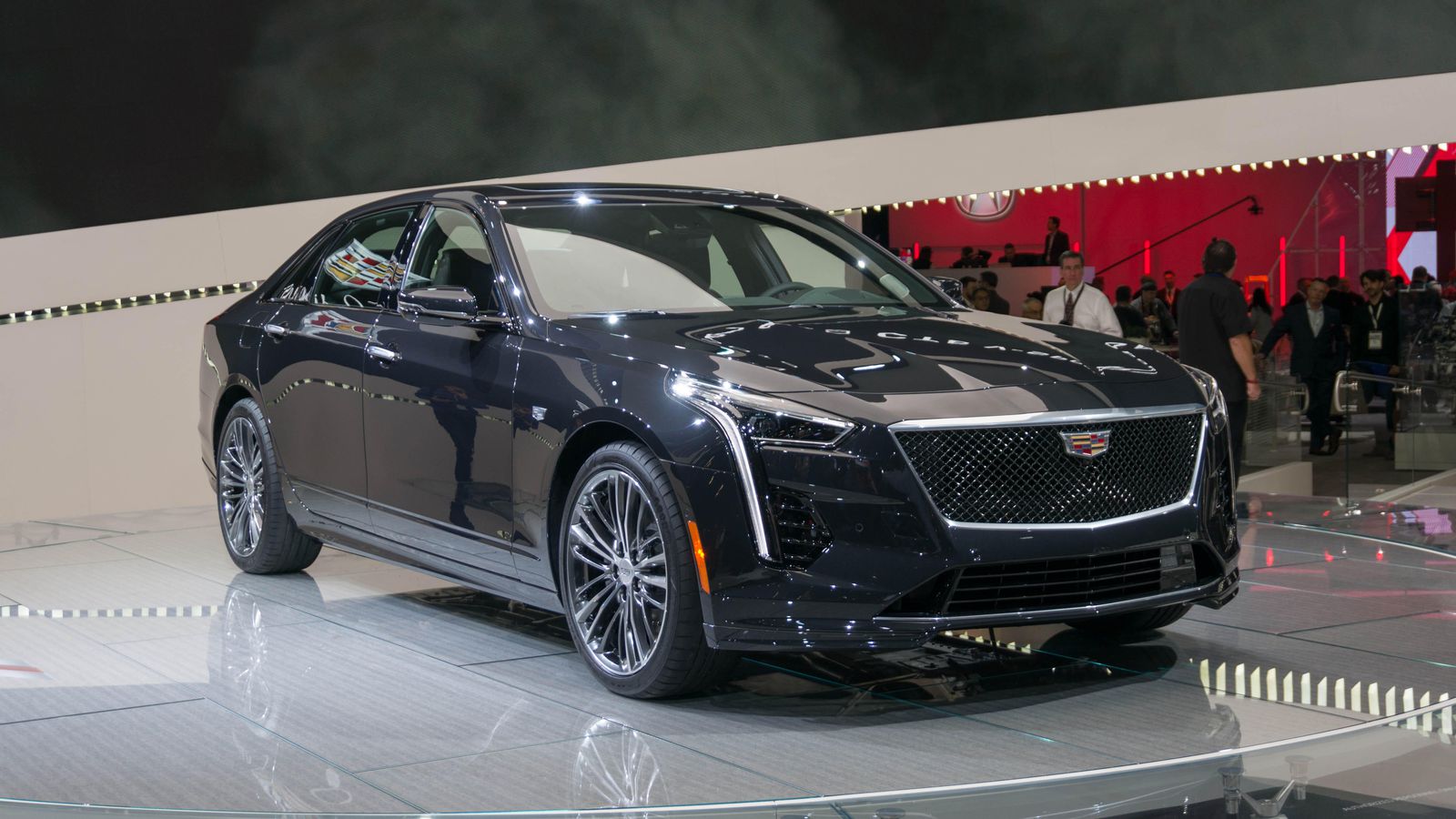

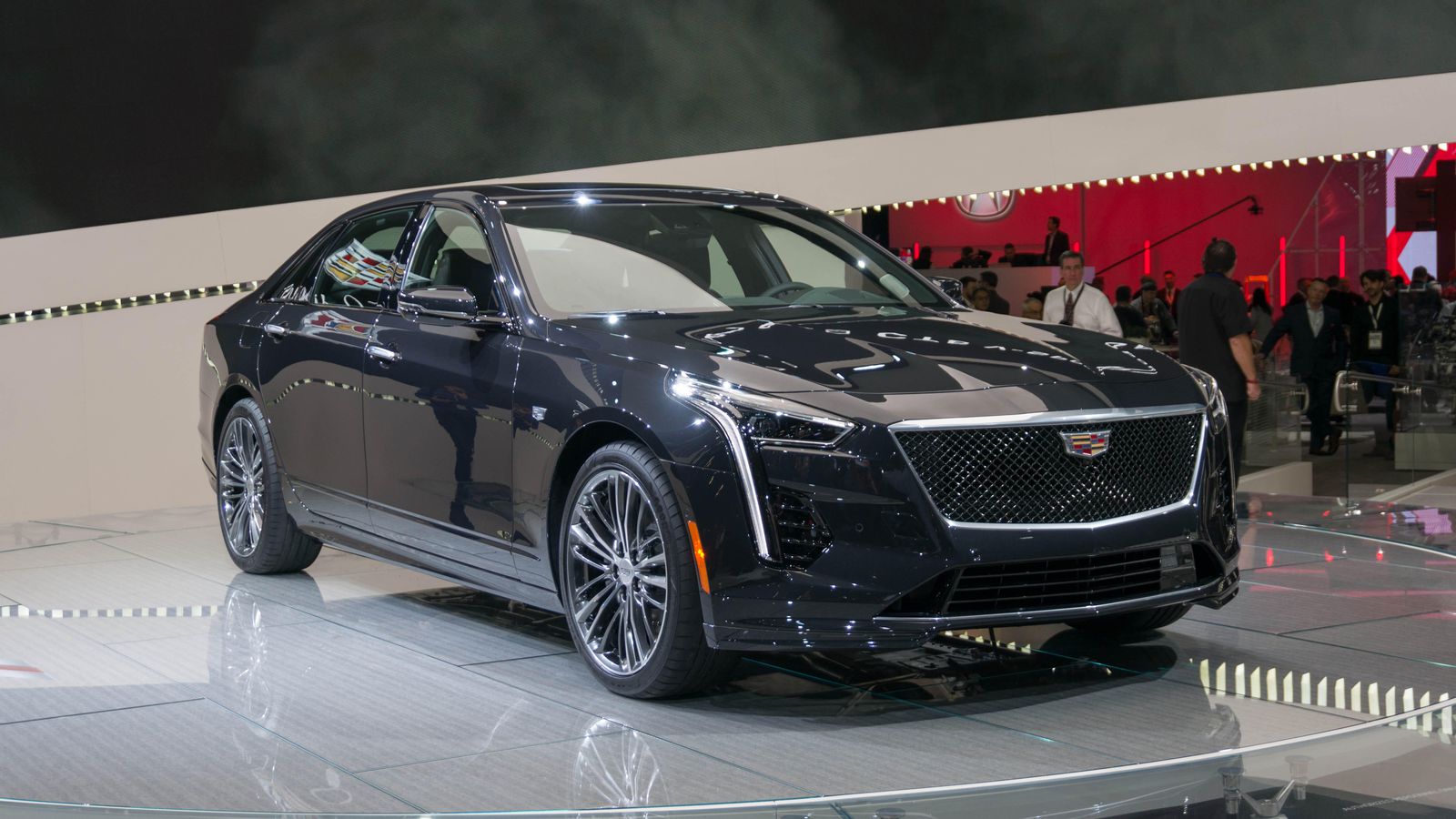

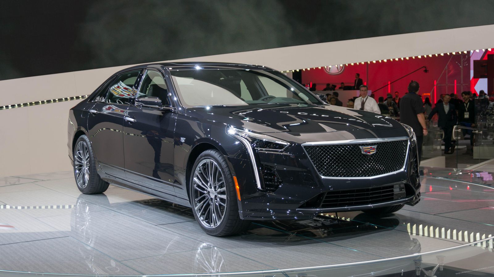

I think this was one of the winners from the New York Auto show. 2019 Cadillac CT-6 V Sport. Carbon fiber package. It has a very profound 550 HP/627 torque, 4.2 TT V8. 12 inch display, uses touch capactive controls, (Which I do like in my SHO). No price announced, but I’m assuming it’s well over $100,000. Not a huge fan of the wheels. I think the CT-6 looks relevant compared to Japanese and German competition. It has similar modern appeal to Audi and creates more of a timeless, sumptuous look. Good lease option.
Really like the updated styling, especially on the front end. Looks like the headlights are crying though.
Not a fan of the crying Cadillac look and I'm not sure the lighting or the color of the car really create a flattering image, but it's a beast and that's cool.
