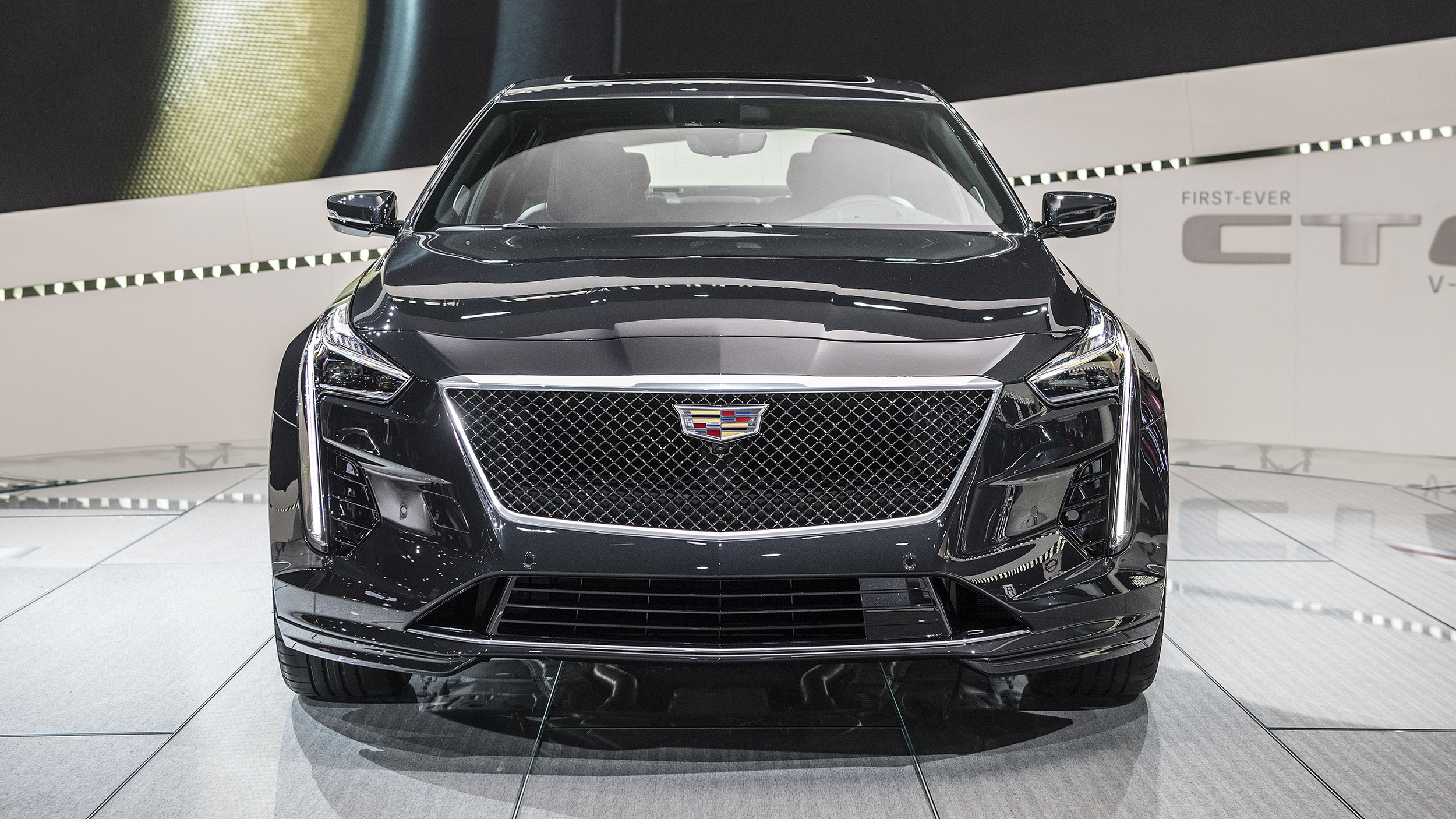

Really like the updated styling, especially on the front end. Looks like the headlights are crying though.
I don’t Care much for the extended headlights running in a downward position. If they would have deleted that strip and integrated LED’s somehow into the lower half of the front bumper, that would have been much more aesthetically pleasing.

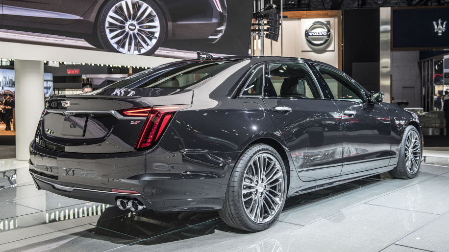

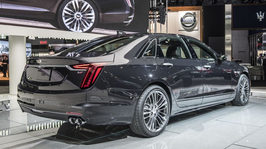

The rear design is a complete trainwreck..
Personally I don’t mind the tail lights/rear of the vehicle, even though they are shaped like the number seven. My biggest complaint is the wheels. The wheel package looks like it’s just not fitting for this specific car, it doesn’t emphasize sporty at all to me given its the “V” Series. But then again, Cadillac is about lots of chrome accents and the wheels look something off a dated Chrysler. The Quad tipped exhaust was a nice touch.
This view makes it look more menacing. Seeing the headlights from this angle isn’t as off putting as compared to a side angle from the previous photo. I think GM did a nice job inside and out.

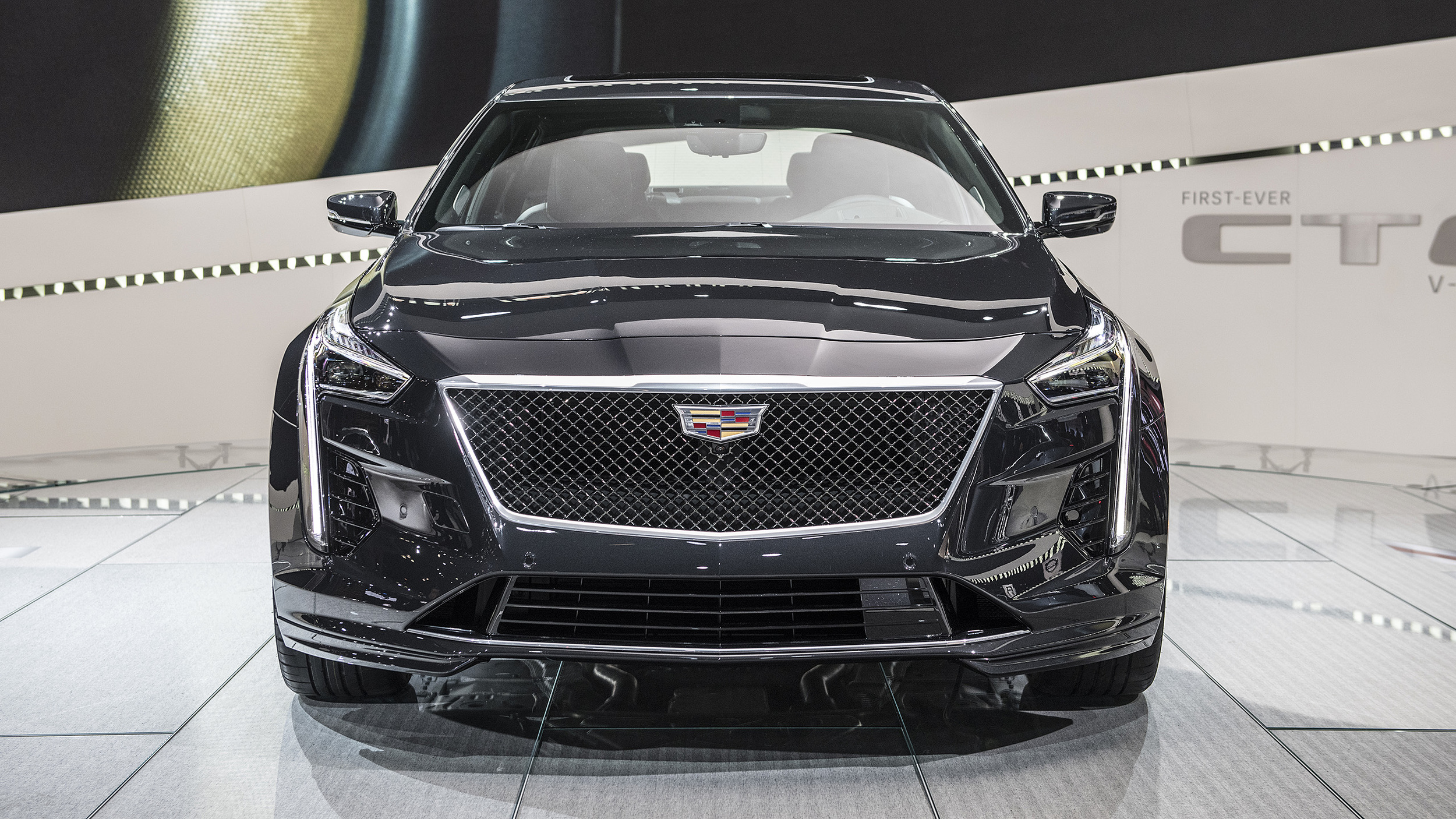

That’s a terribly confused rear end. It don’t think the area decklid quite works with the angular trunk/bumper theme. The back of the car is way too sloped, I think a more upright line would be more appropriate as the angular theme over exaggerates it. The horizontal, inner parts of the tail lights doesn’t quite fit and I don’t like the bends in the horizontal silver trim. And for all the hard angles of the car, I’m surprised they went with round exhaust ports.
That said, I do like the front. The side profile reminds me a bit to much of the STS or something though- it’s too boxy and looks very dated, whereas the front and rear look far more modern.
