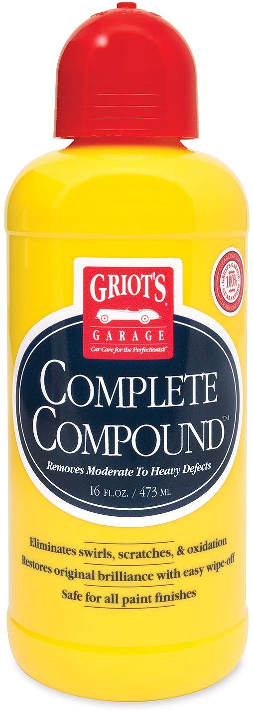

Also, black car, with tiny white scratches. Any way to correct this ...
See attached. Griots Garage Complete Compound. You’re welcome. I’m on my fourth black car now, for light surface scratches into the clear coat, this is an outstanding product in my detailing lineup of professional products.
How I would apply this:
Make sure paint is clean prior. Use a quality microfiber towel slightly damp (Like, spritzed with water damp, you don’t need much), apply compound remover to cloth, apply lightly on scratched surface area, let it sit for approximately a minute or so, buff off with dry/clean microfiber cloth. Then, reapply choice of wax to surface area once complete with compound remover.
Depending how deep the scratches are, this should minimize/remove them.

Griots makes some excellent products, I've been using them for a long time (even before "boutique" type products became more mainstream, before a bunch of you were driving :D) Definitely read the application directions carefully, while it's an extremely mild polishing compound, it is very slightly abrasive (otherwise it wouldn't do anything).

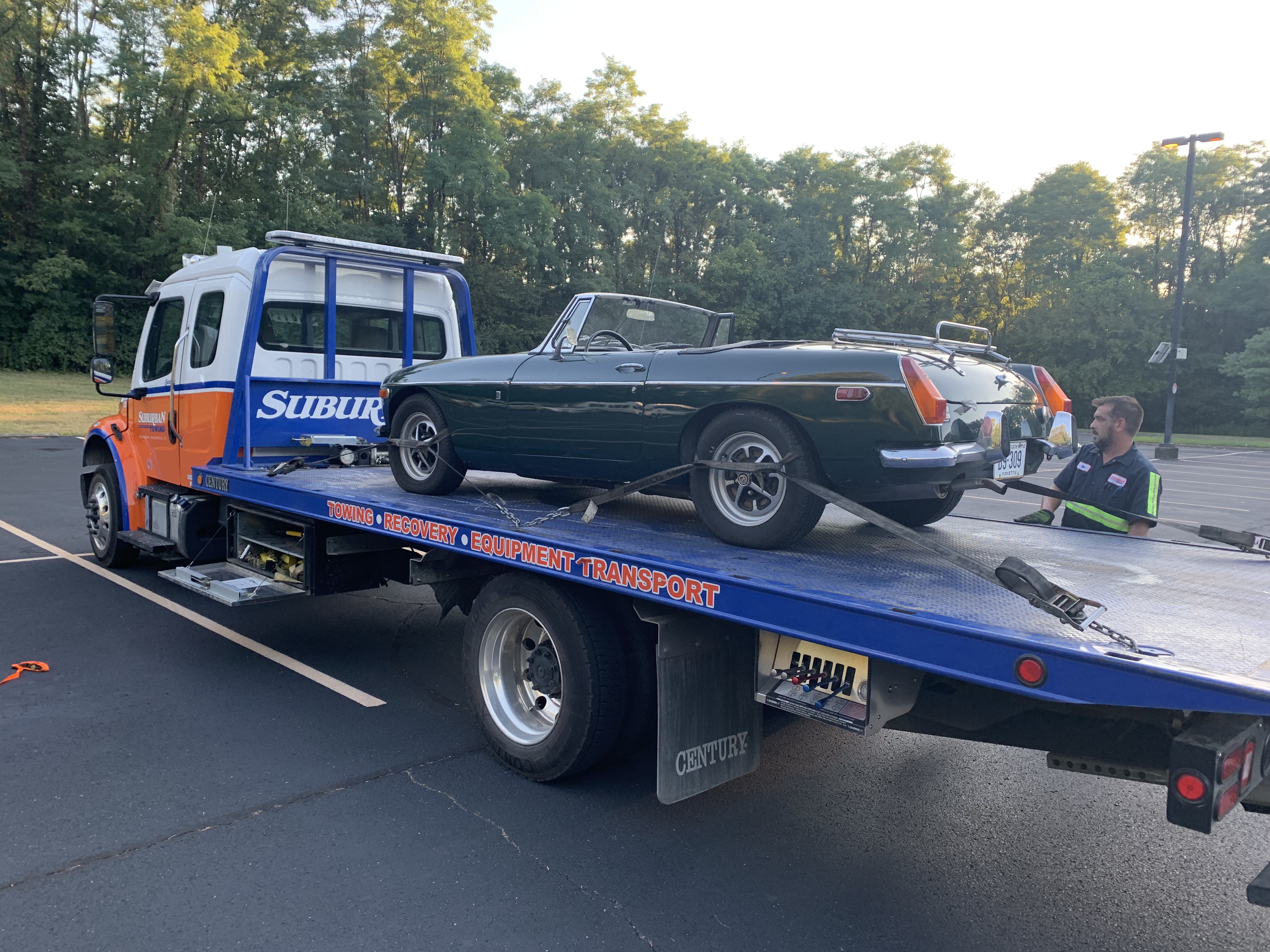

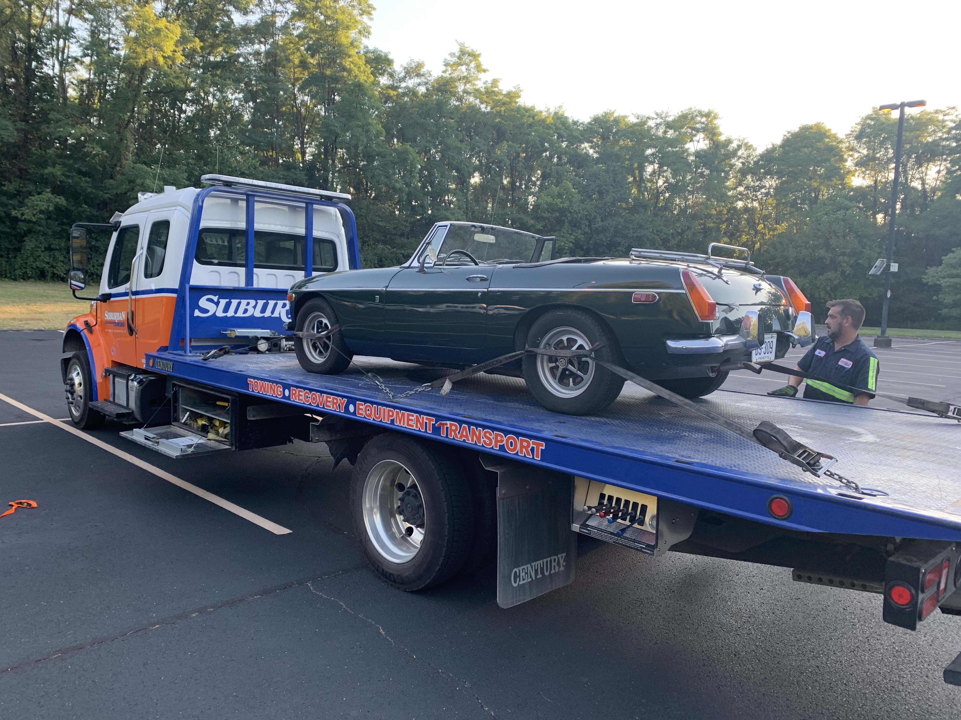

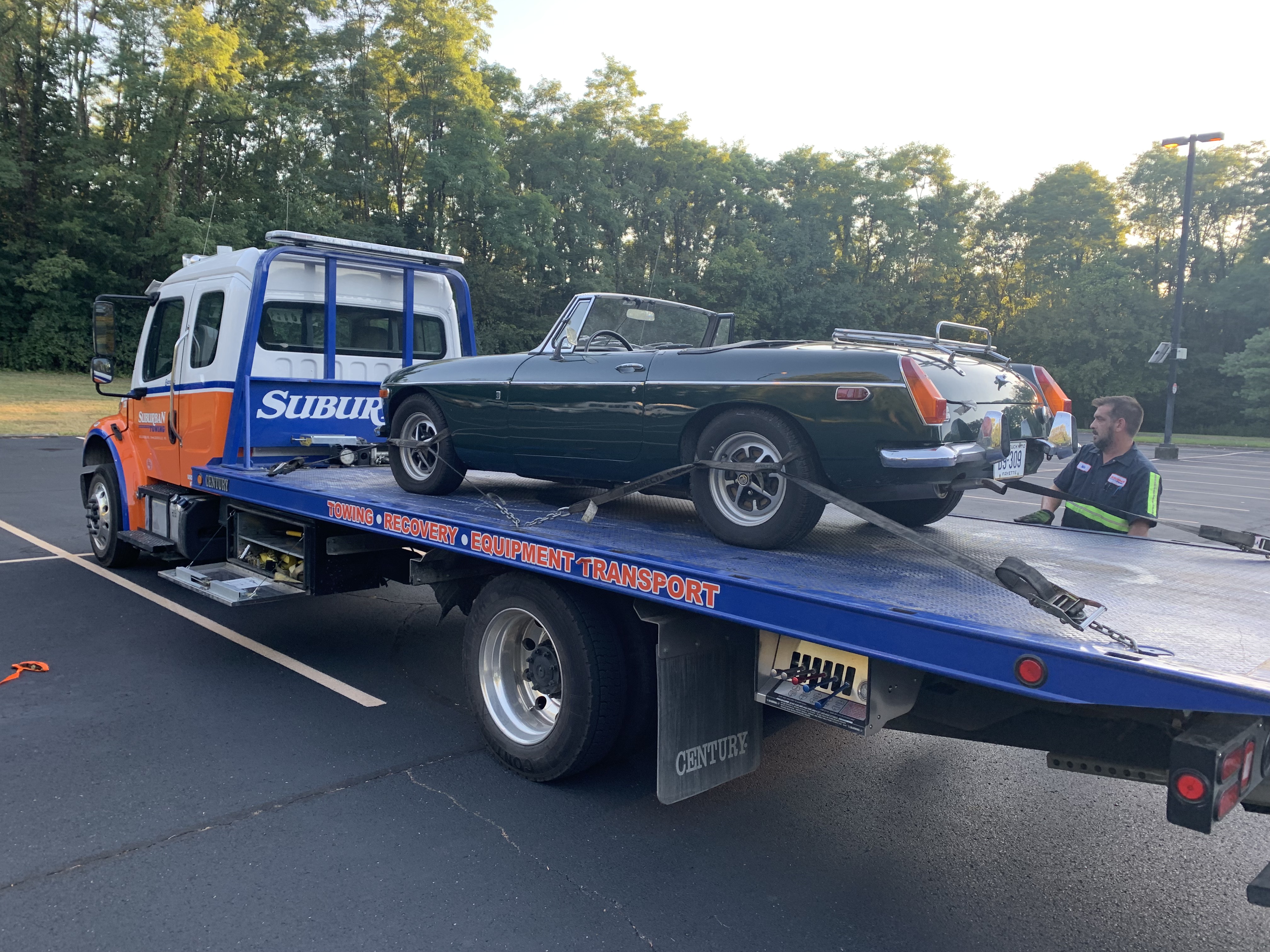

I guess the day comes in the life of every British car owner where you ride home in a vehicle much larger than the one you drove to the place in...
Oh dear. Nothing serious I hope?
Well, the good news is that the $1.50 can of carburetor cleaner the cooling fan decided to suck up came out totally unscathed. The radiator and cooling fan sacrificed themselves for it.
Aside from that, I'm looking at ~$275 for a new radiator and fan, plus about two weeks for them to get here. The repair should be straight forward-my least favorite part of changing a radiator is draining the coolant, and at least that part has been taken care of for me.

Because I'm curious, just how did that happen?
I pulled the carbs/heatshield/intake manifold last week to replace the oil mist separator(an operation that was successful, since I'm no longer misting oil out the side of the engine).
For a while, I was using genuine Burlen Fuel Systems(SU branded) carb mounting gaskets-there are 6 of these total(3 per carb "stack"). These are impregnated with a waxy adhesive that melts the first time it heat cycles to theoretically make a tight seal. Even though they seal well, every time you remove the carbs they have to be replaced(especially since they usually get torn up when separated) and are usually reluctant to come loose. I'll usually end up using generous amounts of carburetor cleaner to get them loose. Incidentally, I'm now using plain rubber that gets a light coating of grease, but most places still had the Burlen product.
It was after dark when I finished up that job, and my light out in the garage is poor(plus I have no power to do better-I work mostly with flashlights) so I'm GUESSING that I left the can of carb cleaner laying on the inside of the fender after I was done. With the air cleaners in place, it's also not super easy to see this spot.
From there, as best as I can figure, it got disloged and knocked into the engine fan. This is a direct drive fan bolted to the front of the water pump pulley.

I'm familiar with those types of gaskets albeit for other applications. This makes a lot of sense. I'm sorry that you opened up another line of expenses for yourself. On the other hand, this may inspire you to seek garage lighting or a work light. I once broke a radiator fan by accidentally tugging on it while wearing a long sleeve sweater. Which is considerably more silly if you think about it.

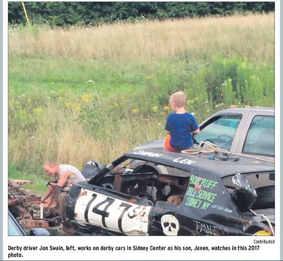

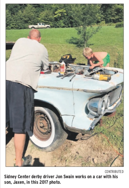

Here in my county it's Fair Week, which also means Demolition Derby time! It's the culmination of another year's painstaking efforts to turn a bunch of parts from assorted wrecks into one roadworthy one that when fitted with the now mandatory steel four point cage and halo for the driver, can pass inspection and make it into the fair for a hoped-for spectacular crash on Demo Derby Day.
:D File these under "watched one, doing one, en route to teaching one":
The local paper ran a piece on the longstanding traditions of getting cars ready for a demo derby. Here's a kid watching Dad show how it's done, probably same as Dad watched his dad when he was the kid. And the same kid then helping Dad get a car ready... There's certainly an art to converting a collection of parts into something can pass the inspection and make it into a candidate for a spectacular crash on Demo Derby Day.
