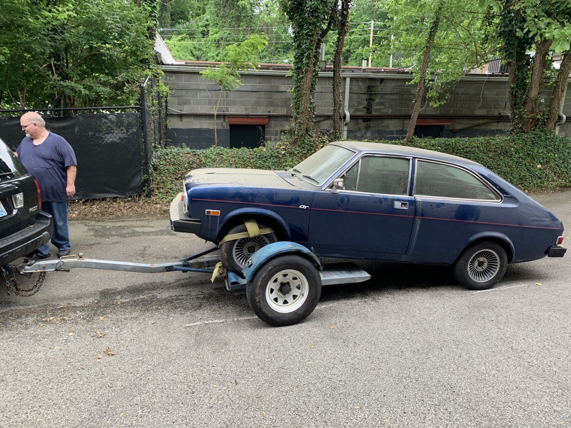

Unfortunately, had to let this one go after not really having time to do anything with it.
It's going to a good home with the know-how and motivation to get it back on the road.
BTW, they also took a bunch of spare MG parts I needed to move(my MG mechanic is taking it in trade for work). I guess I'm just proving how weak I am-I had a spare short block sitting there, which is in the ballpark of 350lbs. I never try to move one without a hoist, but I watched the two guys who came for the car reach down and grab the that engine like it was nothing...
Also, getting it on the dolly was...fun...the rear brakes are out completely(fronts work great) and the shift linkage decided to pop loose again while we were moving it around. I climbed under it and stuck it in neutral by the lever on the side of the transmission, but with the front wheels on the dolly and no good way to get it in park or put the handbrake on, it was a bit iffy once the front wheels were on the ramps. We shoved it up the ramp but couldn't get the wheels into the cradle. My cheap plastic wheel chocks weren't up to the job, so we ended improvising chocks with jack stands(that's the scrapes on the pavement) and also two of us standing behind and pushing forward while one guy backed the truck/dolly up. All done, though, it was loaded and gone, and I can concentrate on getting the MG in tip top shape.
