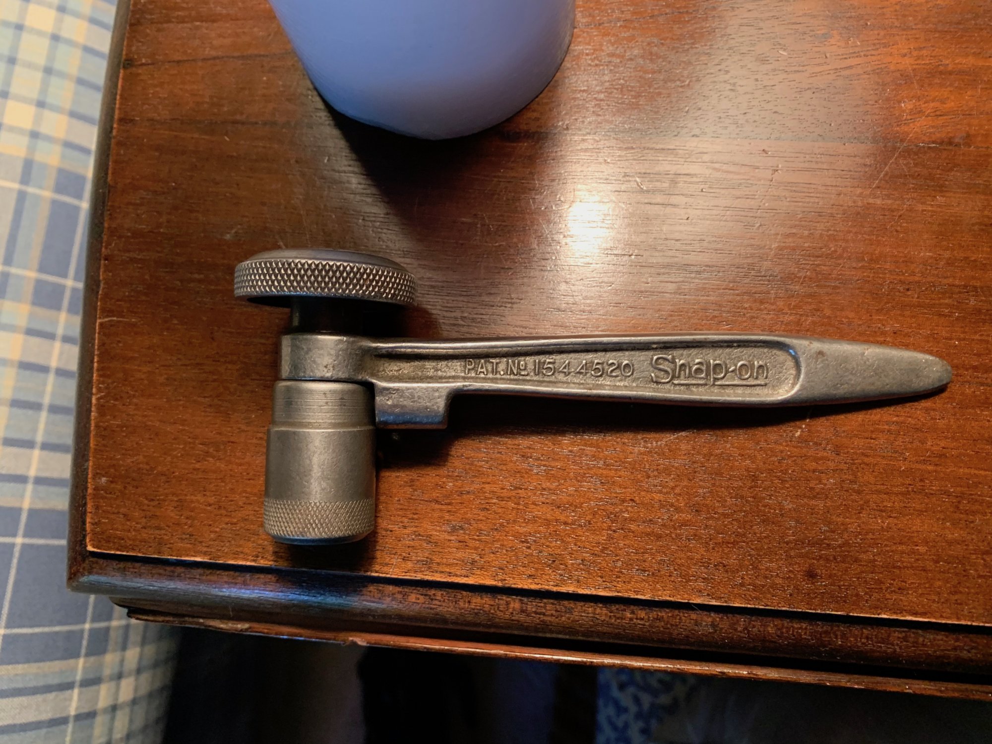

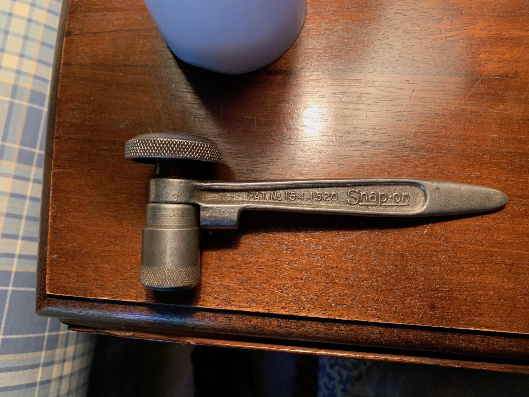

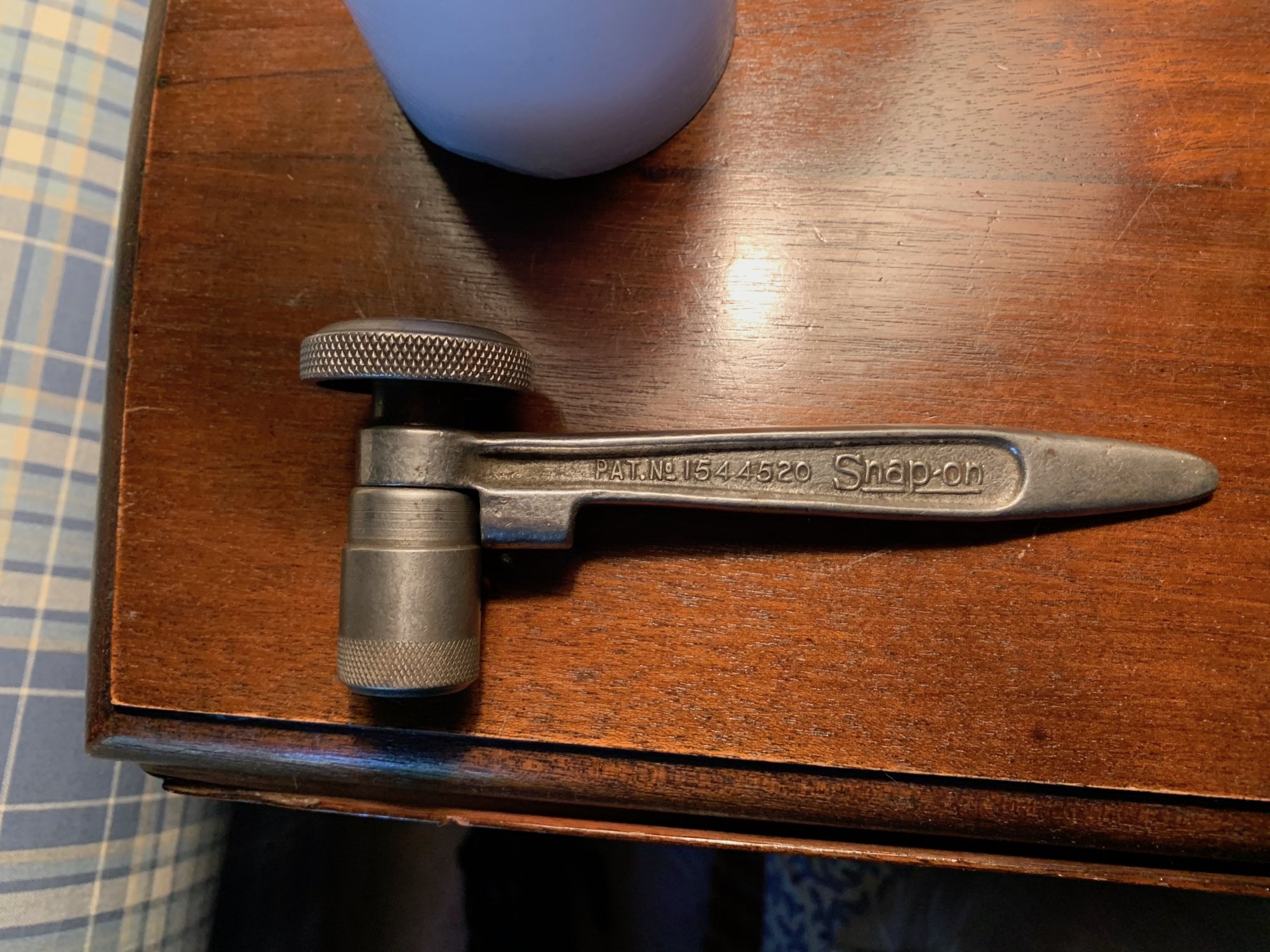

Got a new toy in the mail today. Does anyone here know what this is used for? (yes, I know)
Yeah, I do too. There's one that got passed down. Fairly sure it was bought overseas and migrated here. No idea who's garage it's in among family now. Probably got cobwebs all over it. Are they worth anything?
It’s a push-rod adjusting tool. It assists in adjusting tappets in OHV’s. [Yup, I’m that good. 😁] By the looks of that tool, it’s likely 70+ years old.
Ok, Ok.... I researched the patent # on the tool in the picture-[That would be the detective in me.]
Link here-
For the last 35-40 years, my hot-rodder / builder Dad and I would've just referred to it as a valve / valve adjustment tool. Hahaha, searching the internet != Batman ...

You all are correct!
More specifically, though, the tool is pretty much obsolete since it's used to adjust solid lifters. Hydraulic lifters, which all current production pushrod engines(and most anything designed in the last 50+ years) have, are more or less self adjusting.
On solid lifters, such as the old British stuff I tinker with, you need to manually adjust valve clearance periodically. I've always done it with a 1/2" box end wrench, a big flathead screwdriver, and a feeler gauge. My mechanic was raving about these, showed me how to use it, and I said "I need to get one of those." Basically it combines the wrench and screwdriver into one tool, and makes it easy to not change the clearance when you snug down the locknut on the adjusting screw.
I didn't realize it when I bought the above, but the round knob dates it to 1935 or earlier.

There's a lot of interesting physics behind solid lifters, especially combined with a flat tappet.
Most people who run/build pushrod engines are use to the valves running with "zero lash". The oil used to adjust the lash also "cushions" the stresses that opening the valve would otherwise inflict on the tappets.
With solid tappets, the valve lash(15 thou cold on an MGB) makes up for this and lets the slack in the valve train cushion the valve opening. Given how badly flat tappet cams can get beat up anyway, you might as well make life a bit easier on them.

I don’t mean to pry, but I wonder what a tool like that would cost given its age? I feel like that would probably be worth something today, aside from its functionality. And it’s ‘Snap-On!
They're $20-40 all day on Ebay depending on condition and specific variations.
Used Snap-On honestly is a bargain. It's nowhere close to "truck" prices, and most mechanics won't touch it since the truck is easier. All the Snap-On stuff I have was bought used.
Plus, this particular tool is of incredibly limited use to most any mechanic these days, and probably anyone who needs one already has one.

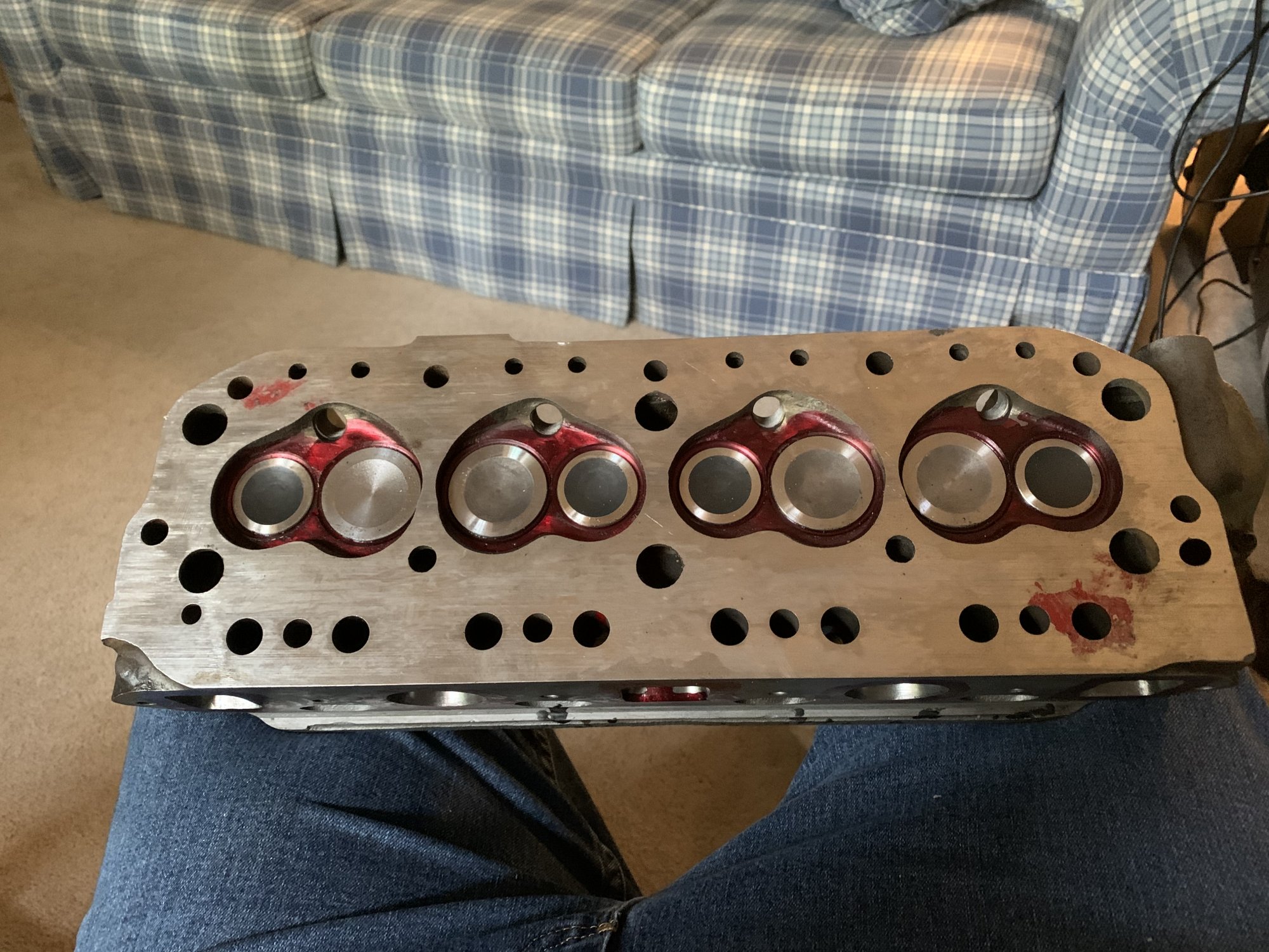

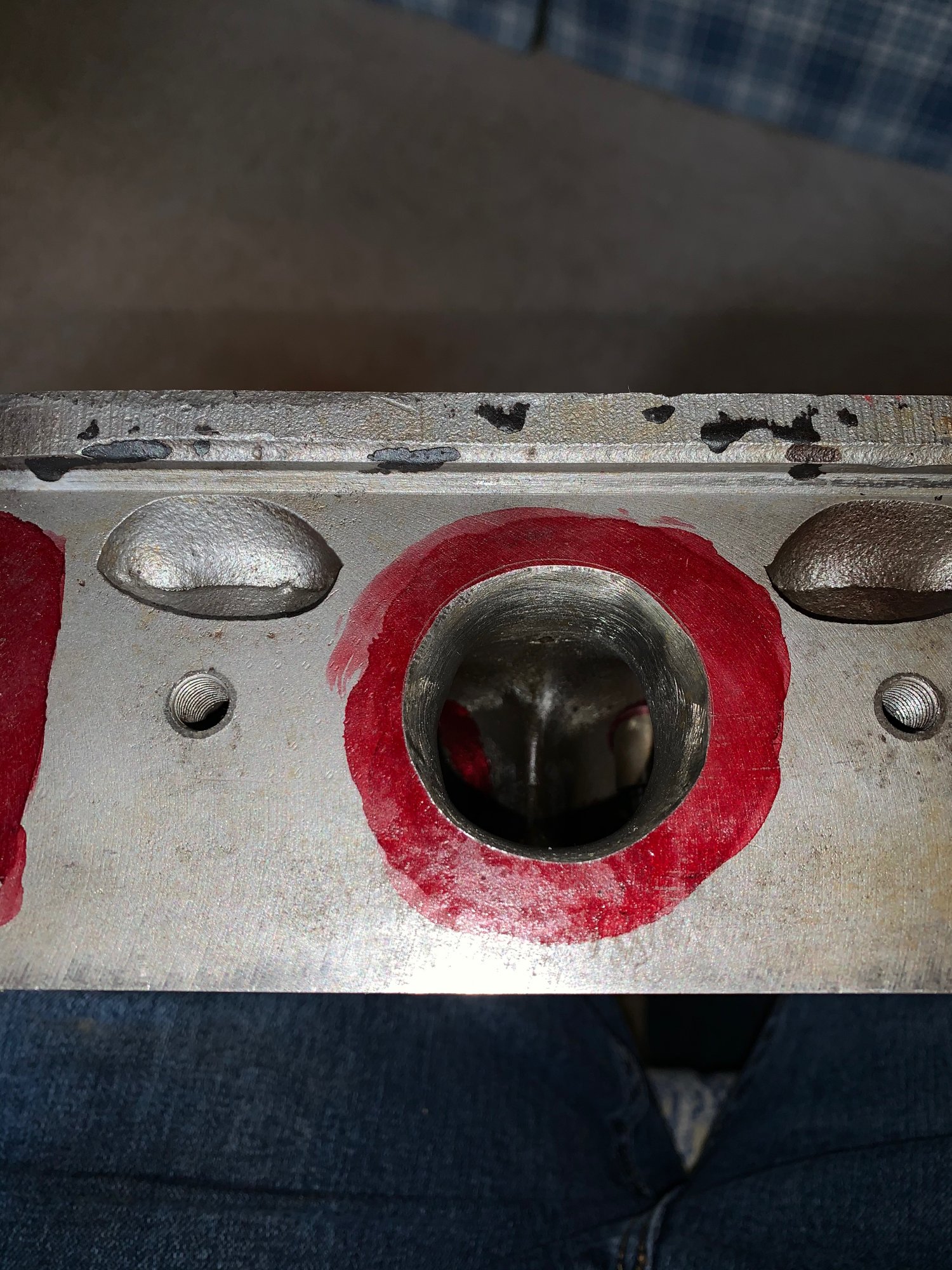

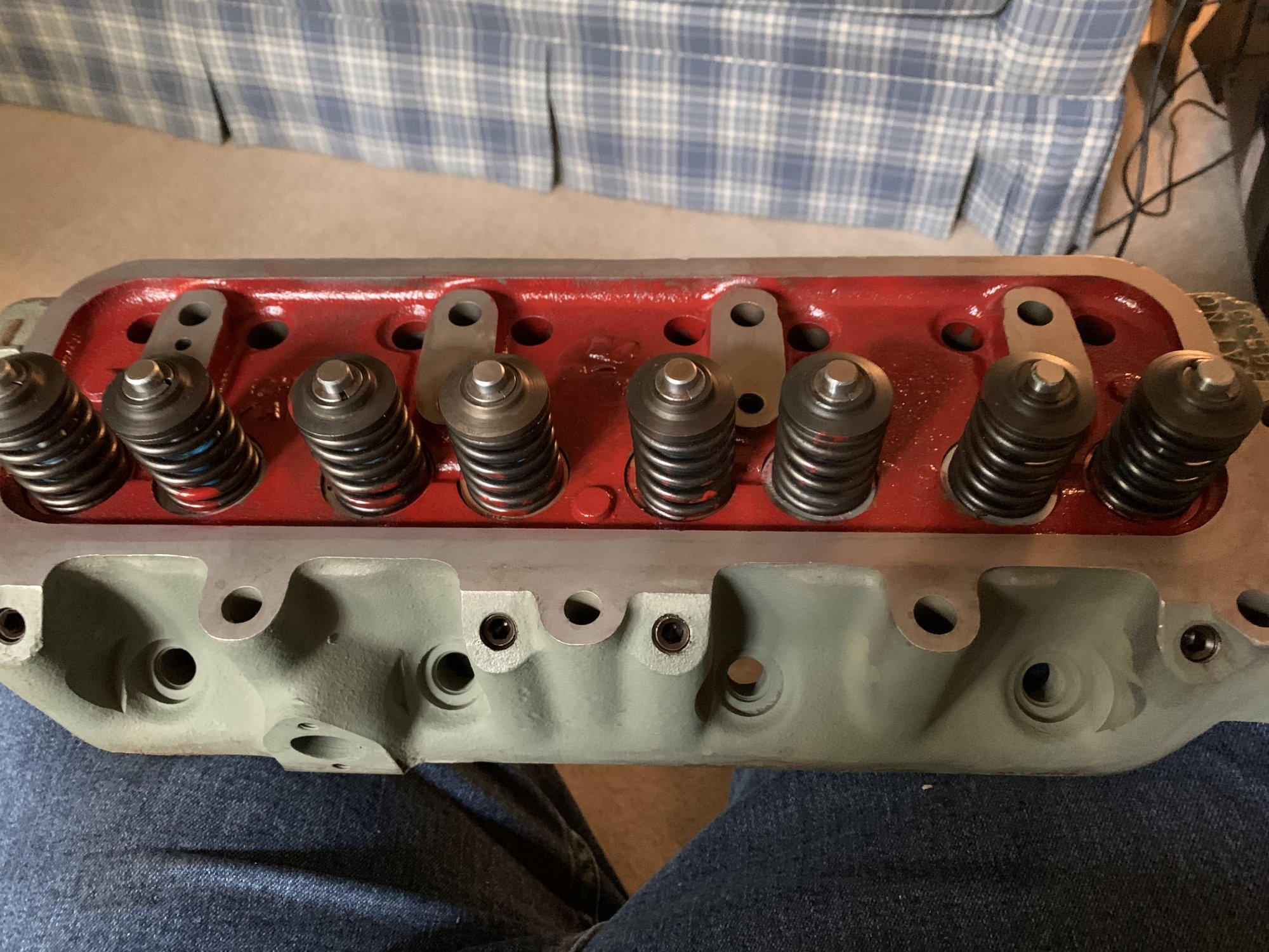

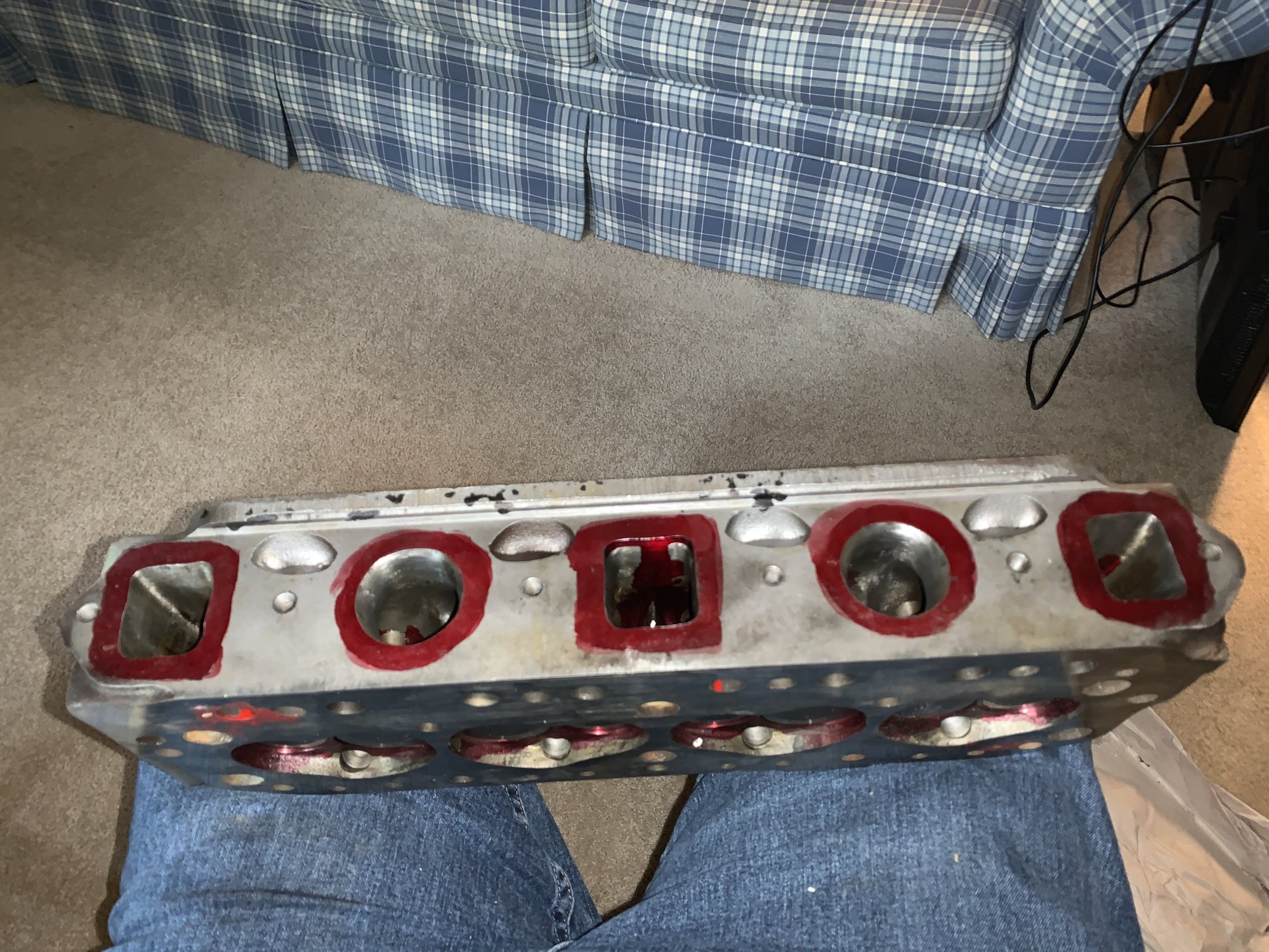

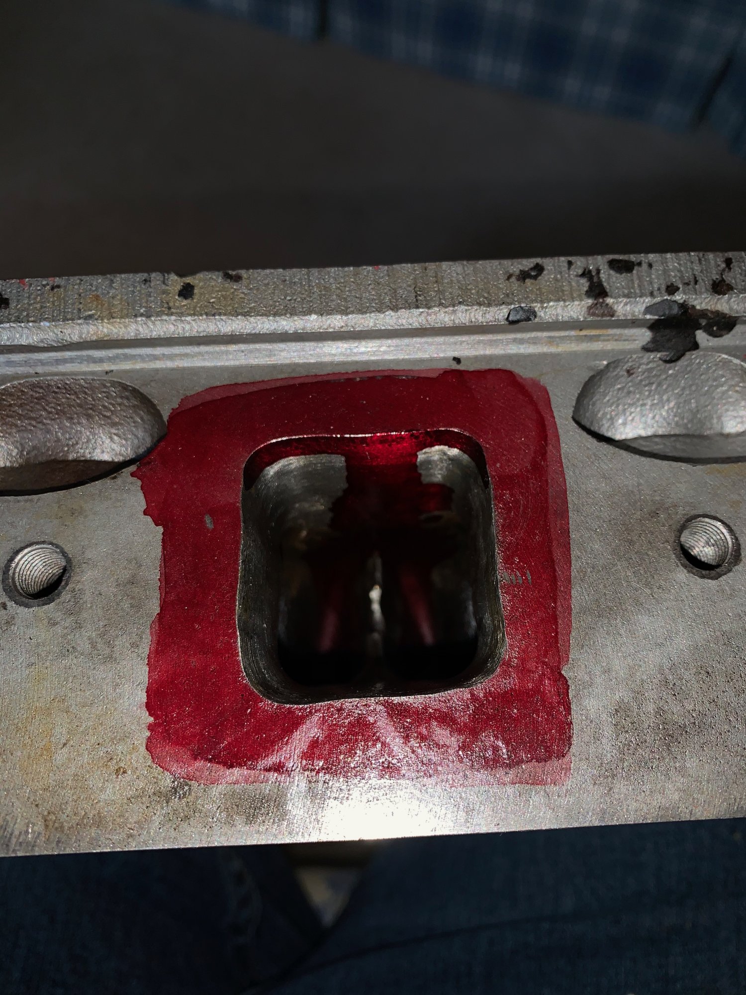

Massive box arrived here today..here are a few quickies of the contents.
The porting work is beautiful-it deserves some more photographs before it goes on the engine!
