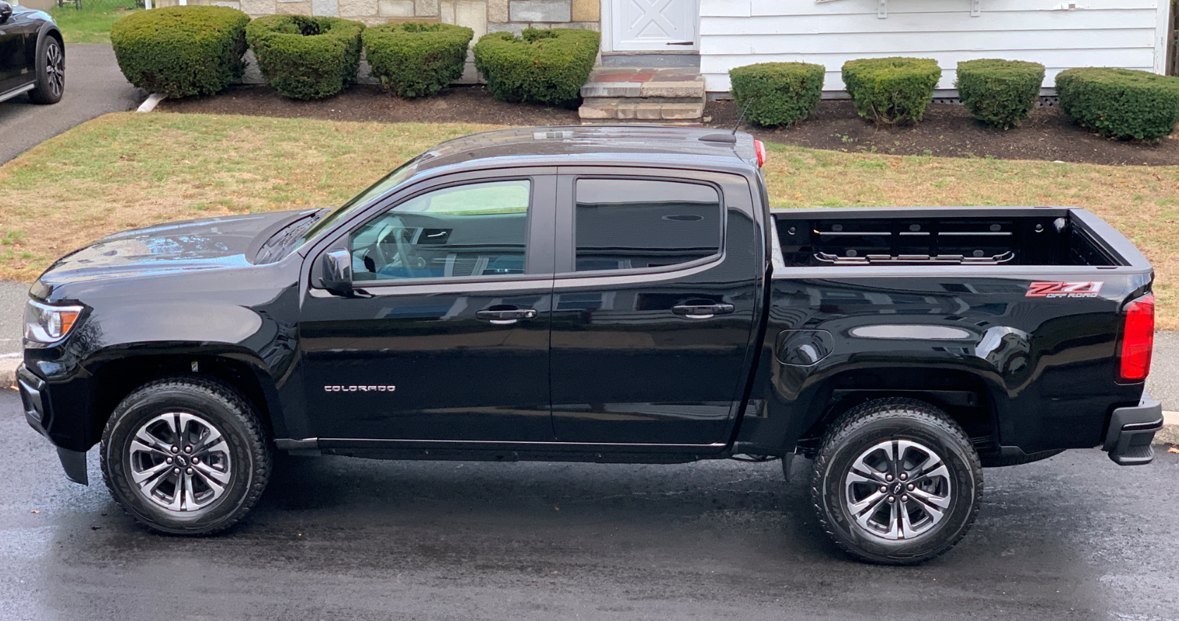

Looks great. I am a huge fan of black. But may I make a worthwhile recommendation? (Well, I’m going to anyways.😁)Whelp, I traded in my Chevy Colorado (model WT) for another truck. I suppose this is the positive thing about leasing, you have opportunities to turn over to a new vehicle a lot sooner then owning. My plan has been to get off the lease carousel and my prior truck was in prime position to do just that, low buy back price, and well, I like it.
The downside was that the truck was the low end trim level, no features, four wheels, and a steering wheel, so to speak.
I wasn't looking, but my dealership reached out to me, both in mail and email stating they're willing to give me 120% value for my tuck and there's a ton of leasing incentives. I think the current world situation that has impacted so many company's profits made both GM and the dealership a lot receptive for deals and lowering prices.
The bottom line, is I got a Colorado, Z71 which is the higher end trim level, with just about every feature GM offers.
I got all that and my monthly payment for the lease went down by 40 dollars per month
I'll be looking for a better tonneau cover (interested in a hard tonneau) and I'll be re-installing my bed rug that was in my older truck.
Thanks, but that's just way out of my price range, and doing a quick google, it seems 2,000 is the low end, and you can spend upwards of over 5k on such a coating.you’d probably be looking around $2000 at a minimum with a warranty).
I've never had such a coating and for all intents and purposes, my vehicles never looked horrible when turning them in. I think I'll pass as spending 5k in this economy seems a bit extravagant
